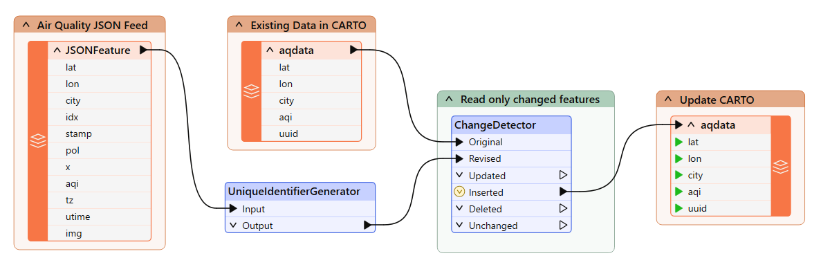

In this workspace, the existing CARTO data is being read in, as well as the JSON air quality data feed.
Both datasets are passed through the ChangeDetector, matching the data on the UUID. Any features that have been added will be sent to the CARTO writer to update the dataset.

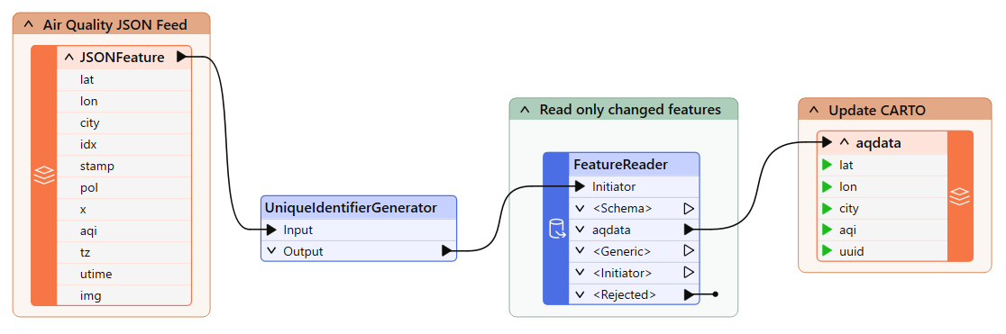

FeatureReader
This workspace is getting the same output as the ChangeDetector by using a FeatureReader. The FeatureReader is connected to the CARTO dataset, but will only read in requested features. In this case this is specified by a WHERE clause:
@Value(uuid) = "uuid" AND @Value(aqi) != "aqi"
The FeatureReader is looking for features where the UUID matches, but the air quality index is different. When these features are read in there will be a conflict between air quality index values, so the FeatureReader is set to ‘Use Initiator’, taking the most current air quality index value and sending it to the CARTO writer to update the dataset.

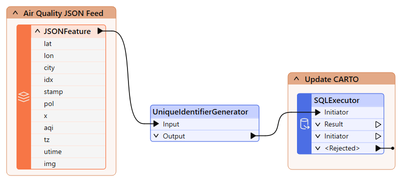

SQLExecutor
One step further is to use the SQLExecutor to identify features in the CARTO dataset where the air quality index value differs from the JSON data feed, then doing the update through SQL.
UPDATE aqdata SET aqi='@Value(aqi)' WHERE uuid=@Value(uuid) AND @Value(aqi) != "aqi"

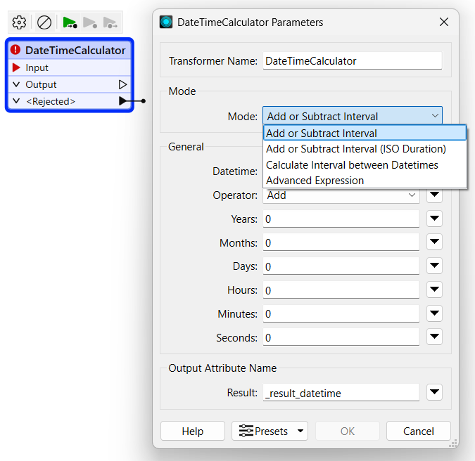

If you have regular schedules, you can use the DateTimeCalculator to determine if a timestamp is newer based on a time interval.

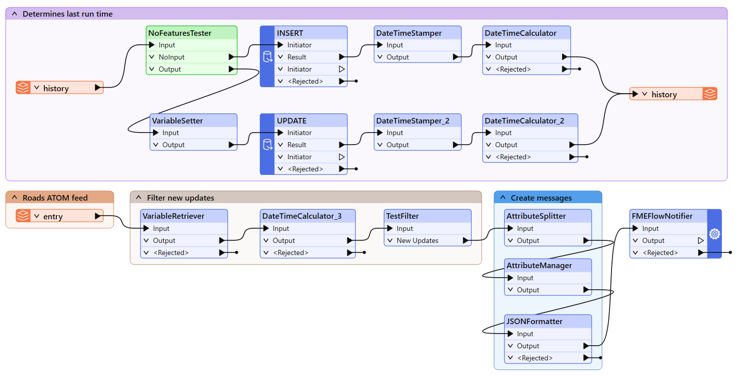

If there’s a chance that your job may be delayed in running resulting in inconsistent time intervals, you can record workspace last run time. This can be stored on FME Flow, to be read in and updated every time the workspace runs.
In this example the workspace is split into two sections. The first section reads in the last run time of the workspace, and passes that timestamp to the other half of the workspace using a VariableSetter and VariableRetriever.
The input data is an ATOM feed of roadworks in Vancouver, containing an updated timestamp. The difference between the workspace runtime and the data update is calculated. Any interval values greater than 0 are new scheduled roadworks or updated existing ones, and these can be filtered for processing or notifying.

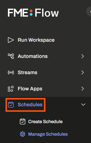

Once a workspace has been published to FME Flow, it can be set to run on schedule or an automation with a schedule. For more information on triggering an automation with a schedule, see Schedule a Workspace to Run with FME Flow Automations
The Schedules tab will bring up a list of existing schedules, showing information about the schedule and whether it is enabled.

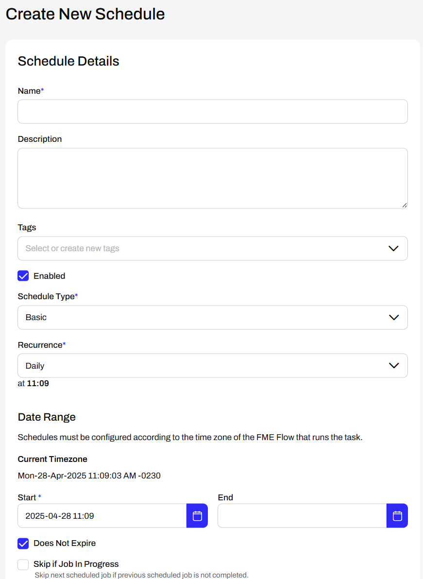

Creating a new schedule allows you to enter a name, category and description for the schedule. The recurrence can be set to run on an interval, once or based on a CRON expression for more complex scheduling.

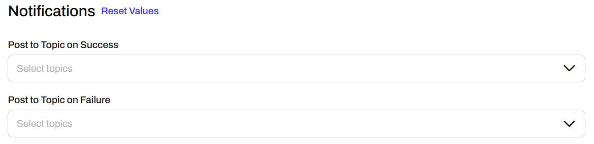

After the correct workspace has been selected, more settings can be applied. To notify a topic on job success or failure, expand the Notifications view.

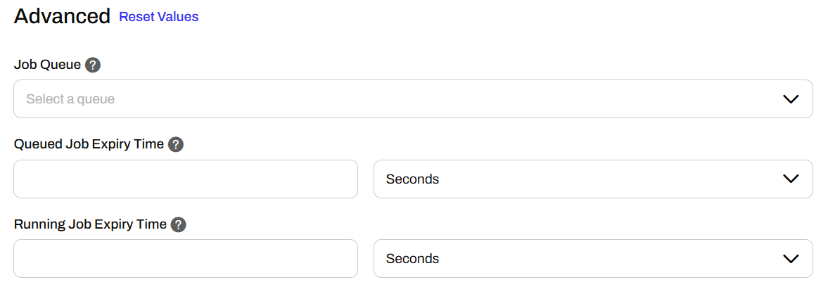

Some additional properties can be set on schedules, such as Run Until Canceled, Queued Job Expiry Time, and Running Job Expiry Time.
