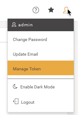

  • To obtain a token open the FME Server web interface, select the User Settings icon in the top right corner and select Manage Token. By default these tokens expire after 30 minutes. Generate a new token with a longer expiration time and then copy and paste this into the Token parameter. Note the expiry date, so you can set a new one when necessary.
Obtain a token and note its expiry date

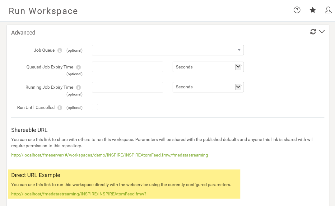

  • Using Internet Explorer, it is easy to obtain an ATOM feed “look”, as it can render ATOM/RSS feeds. In Internet Explorer, go to the FME Server Web Interface, then Run the INSPIREAtomFeed Workspace.
  • Return to the Run Workspace page in FME Server and open the Advanced tab to find the Direct URL.
  • The Direct URL Example shown is the URL required to run this workspace. This link provides users with access to the ATOM feed without needing access to FME Server’s Web Interface. The URL will look similar to:
http://<host>:<port>/fmedatastreaming/INSPIRE/INSPIREAtomFeed.fmw?
Accessing the URL for the ATOM feed service

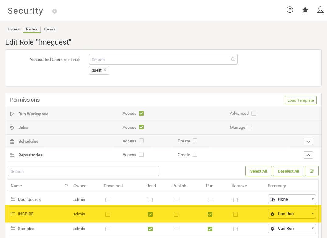

By default authentication is required to run the workspace and stream the ATOM feed via the Direct URL. This link can be made publicly available without the need for authentication by configuring the security settings of the INSPIRE repository to be open to the fmeguest account.
Step 1
  • In FME Server, click on Roles under Administration > Security in the menu on the left.
Location of Security in Menu bar
Step 2
  • Select the fmeguest role
Step 3
  • Under Repositories give Read / Run permissions to the INSPIRE folder. Also ensure that under Services, Data Streaming is allowed.
fmeguest Role Policies to enable access to the service
