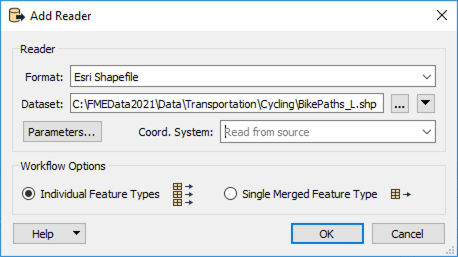

1. Add the Reader
Start a new workspace in FME Workbench. Add an Esri Shapefile writer and browse to the BikePaths_L.shp dataset. Click OK to add the reader.

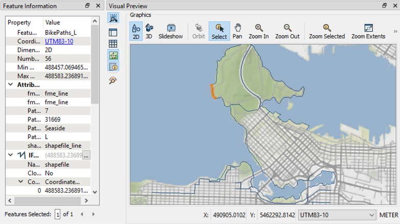

Single-click on the reader feature type to open the pop-up menu, then click on View Source Data to open the data in Visual Preview. Select File > Open Dataset. Set the Format to Esri Shapefile and the Dataset to BikePaths_L.shp.
The Data Inspector will display the shapefile. Select a feature on the display, and the Feature Information window will populate with the feature's properties. Here, we can see that the shapefile coordinate system is UTM83-10.

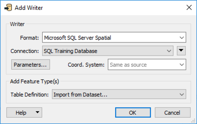

2a. Add the Writer
Add a Writer to the workspace and set Microsoft SQL Server Spatial as the format. The dataset should be set to the SQL Training Database connection created in Viewing and Inspecting SQL Server data.

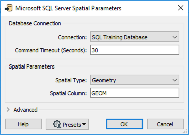

Open the Parameters dialog for the Reader to verify that the Spatial Type is set to Geometry, as we know the shapefile is in UTM coordinates.
If you do not have this named database connection, select the option to Embed Connection Parameters, and after selecting Parameters, enter the parameters manually:
  • Server: sql.fmetraining.ca
  • Database: fmedata
  • Authentication: SQL Server Authentication
  • Username: fmedata
  • Password: SQLtraining2016
  • Spatial Type: Geometry
Set the Table Definition to Import from Dataset. This will import a schema from an existing table for use in the Writer. Click OK.

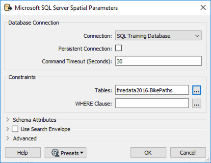

FME will ask where the Feature Types are to be imported from. In this case, they are in the same location as the Writer dataset. This may not always be the case. Keep the Format as Microsoft SQL Server Spatial and the Dataset as the named connection (SQL Training Database).
Click on the Parameters button and select BikePaths from the Table List. If you clicked OK instead of Parameters, FME will prompt you to verify that the parameters are correct.
Leave all other fields in this dialog as is.

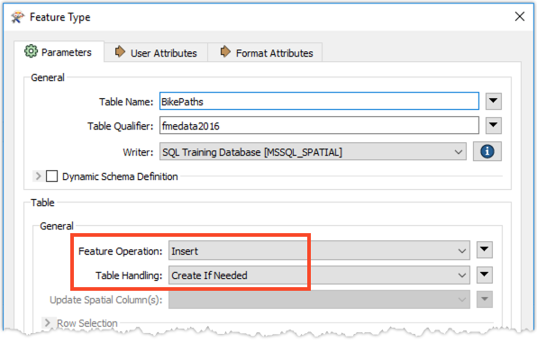

3. Set Feature Operation and Table Handling on the Feature Writer
Open the Feature Type Properties for the feature writer. Under the Parameters tab, verify that the Feature Operation parameter is set to 'Insert', and change the Table Handling to 'Use Existing'. Leave the Spatial Type as 'Inherit From Writer'.
