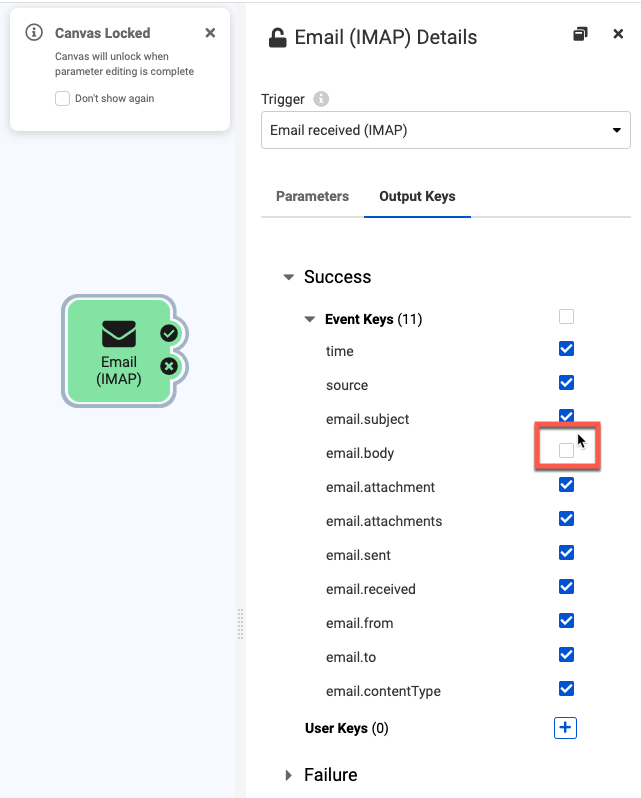

Option 2: Remove the offending key from the event message parsed to the workspace
The invalid XML was caused by something in the email body, but in this case, only the email subject was actually being used in the downstream workflow. Therefore to resolve this error we unchecked the email.body event key so it was not included in the output message that was parsed into the run workspace action:
