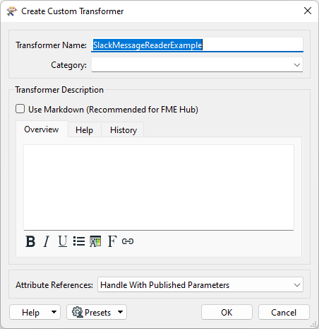

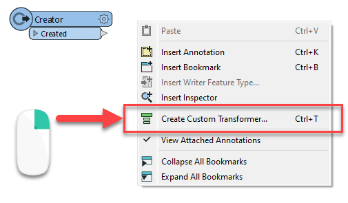

Pagination is one of the few use cases that requires looping in FME, which can only be done within a custom transformer when using FME 2026.1 or older. Right-click the canvas, then select Create Custom Transformer…
Create custom transformer
Give the custom transformer a name. We’ll use SlackMessageReaderExample here, because there is already a SlackMessageReader in the FME Hub.
SlackMessageReader
There are now two tabs in FME Workbench: Main for our main workspace and SlackMessageReaderExample for our custom transformer.

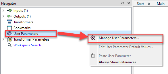

Let’s add some parameters to the customer transformer that will be passed from the Main workspace. From the Navigator, Right-click User Parameters and then select Manage User Parameters….
User parameter configuration

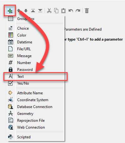

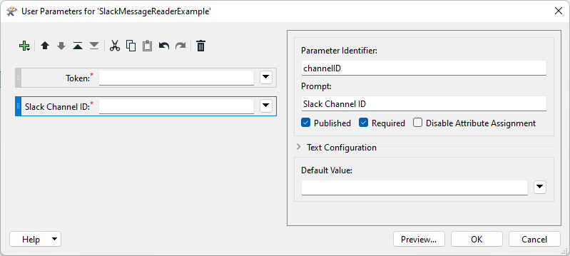

Click the ‘+’ button and add a text parameter.
Add user parameter

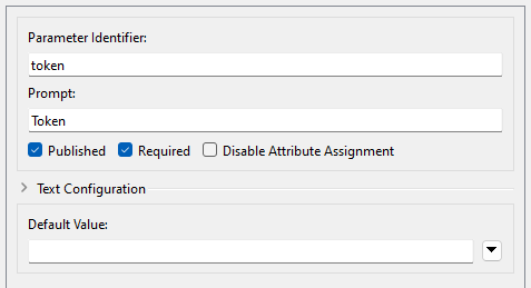

Enter the following:
  • Parameter Identifier: token
  • Prompt: Token
Token parameter
Add a second text parameter and enter the following:
  • Parameter Identifier: channelID
  • Prompt: Slack Channel ID
Click OK to save and close the User Parameters.

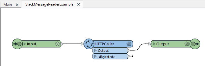

Temporarily connect the HTTPCaller to the custom transformer output.

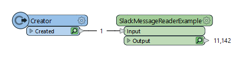

Back on the Main workspace, connect the SlackMessageReaderExample transformer to the creator and configure its parameters as follows:
  • Token: the bot token (starting with xoxb-) from your Slack app configuration
  • Slack Channel ID: the channel ID of the Slack channel that your bot has been added to
Custom Parameters

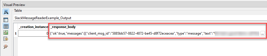

Run the workspace and inspect the SlackMessageReaderExample output in Visual Preview. There is one feature with a _response_body attribute containing the first 200 Slack messages in JSON format (since we set the API limit to 200).

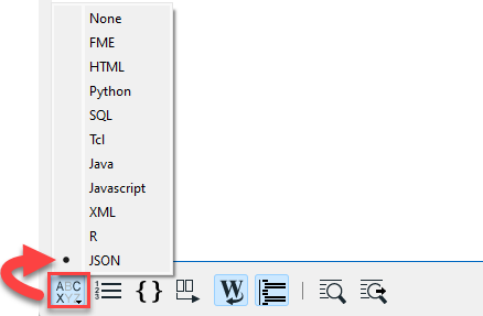

Let’s inspect the structure of the JSON response a little further. Click the ellipses [...] next to the _response_body value to view the full response.
Format as JSON.
View JSON format

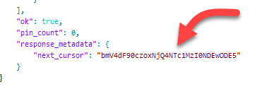

Scroll to the bottom of the response. There is another object called ‘response_metadata’ that contains the next_cursor ID. This is the value we need to pass to the API to get the next 200 messages.
Next_cursor JSON

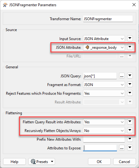

Add a JSONFragmenter to the canvas and connect it to the HTTPCaller output. Configure the parameters:
  • JSON Attribute: _response_body
  • Flatten Query Results into Attributes: Yes
  • Recursively Flatten Objects/Arrays: No
Other fields can remain with their defaults.
JSON Fragmenter
Click OK. Run the workspace. Inspect the results in Visual Preview. There are seven JSON keys that have been output, but we only care about two: messages and response_metadata.

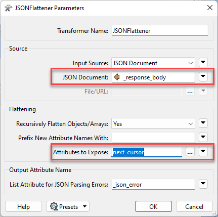

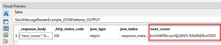

Connect a JSONFlattener to the response_metadata output port. Set the JSON Document to _response_body and, in the Attributes to Expose, type next_cursor. Other fields can remain with their defaults. Click OK.
JSON flattener
Run the workspace again and inspect the JSONFragmenter output. We now have a next_cursor attribute on the response_metadata feature to pass to the API.
Parsed next cursor

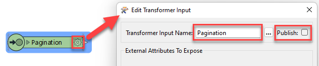

Name the new transformer input Pagination and uncheck Publish. Click OK. Connect the Pagination input transformer to the HTTPCaller input.
Pagination input

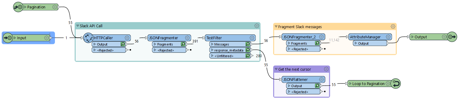

Connect the Loop to Pagination transformer loop to the JSONFlattener output. The workspace should now look like this.
Workspace

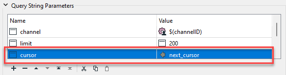

Now that the loop has been set up and the feature with the cached next_cursor attribute is connected to the HTTPCaller, open the HTTPCaller parameters again and set the cursor parameter to the next_cursor attribute that was exposed.

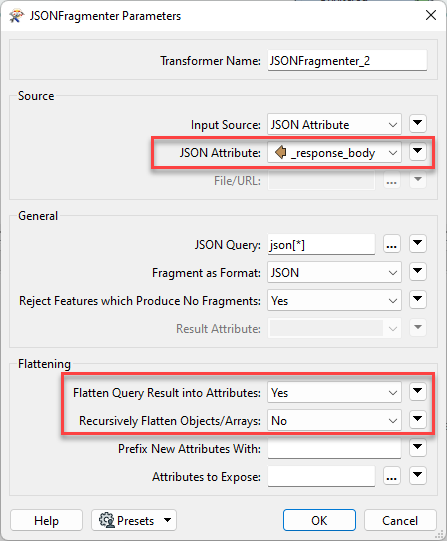

Go back to the SlackMessageReaderExample canvas. Add a JSONFragmenter and connect it to the TestFilter's messages output port. Choose _response_body as the JSON Attribute. Set Flatten Query Result into Attribute to Yes and Recursively Flatten Objects/Arrays to No.
JSON Fragmenter
We aren’t recursively flattening in this case because Slack sends a lot of data for each message, like attachments and reactions. We’ll leave those as JSON objects for now, and just extract the key message attributes.
Run the workspace. Each message from each API call is now output as a feature. Our 56 features have become over 11,000.

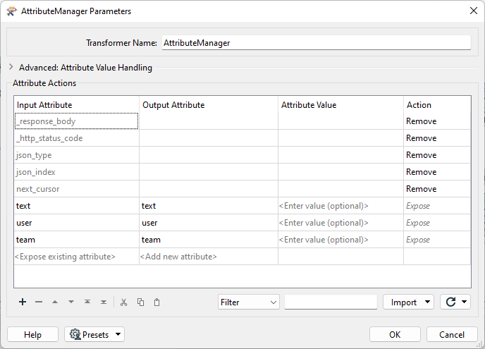

Add an AttributeManager to the canvas and connect it to the JSONFragmenter output. Remove all currently exposed attributes and expose the message text, user, and team instead.
Clean up attributes
Finally, let’s clean up the workspace a bit. Add a bookmark around the JSONFlattener and name it ‘Get the next cursor’. Add another bookmark around the second JSONFragmenter and AttributeManager and name it ‘Fragment Slack Messages’. The workspace should now look like this.
Cleanup workspace

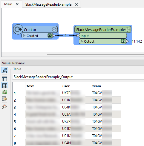

Run the workspace. Inspect the SlackMessageReaderExample output in Visual Preview. The Slack message text, user, and team are all displayed. Additional attributes can be exposed as needed.
