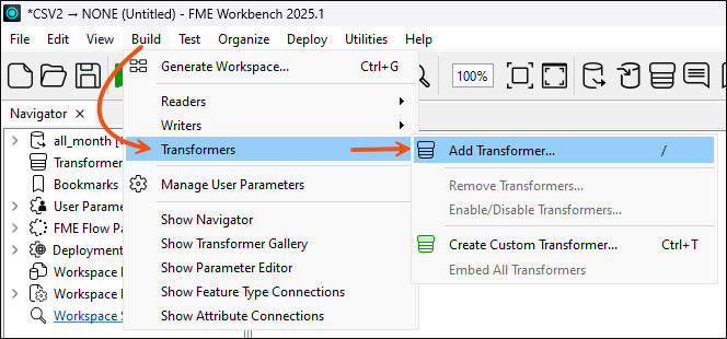

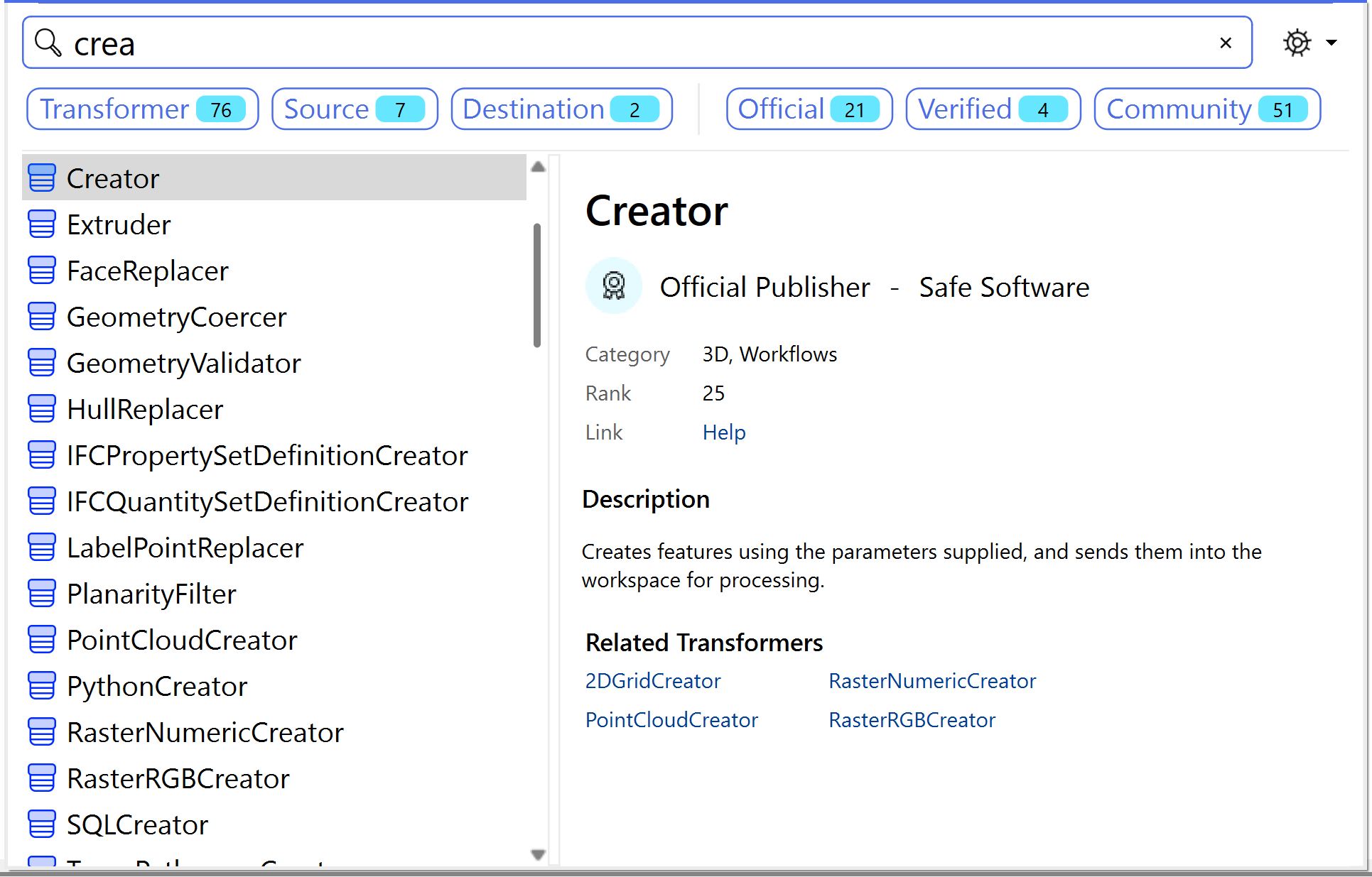

  • Transformers can be added to the canvas in multiple ways

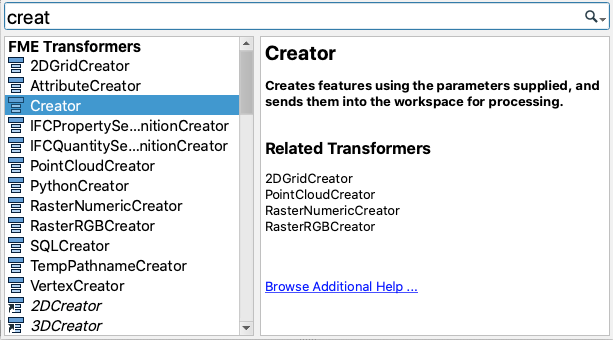

    Click anywhere on the blank canvas and start typing the transformer name to access the quick add menu
    Click on the Transformer button on the toolbar
    On the top menu bar, click Build > Transformers > Add Transformer.
    Click on the green + on the canvas and select Transformer

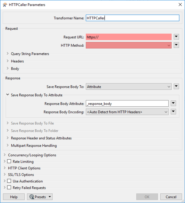

    Add an HTTPCaller to the canvas and double-click on it to open the parameters or click the cog icon in the mini toolbar.

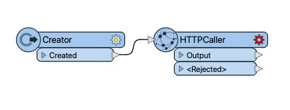

  • Because we will be getting our data from an API, we don’t need to use a reader for incoming files or connections. The Creator transformer enables us to initiate a workflow by creating new features that can be processed later in the workspace. Add the Creator transformer by clicking anywhere on the canvas and typing “Creator”.
    Add an HTTPCaller and connect your Creator to the input port of the transformer. Double-click on the HTTPCaller to open the parameters
As of FME 2025.2, many transformers have been updated to not require input from the creator transformer. For a list of all the transformers with this improvement, please see Transformers with an Optional Input Port

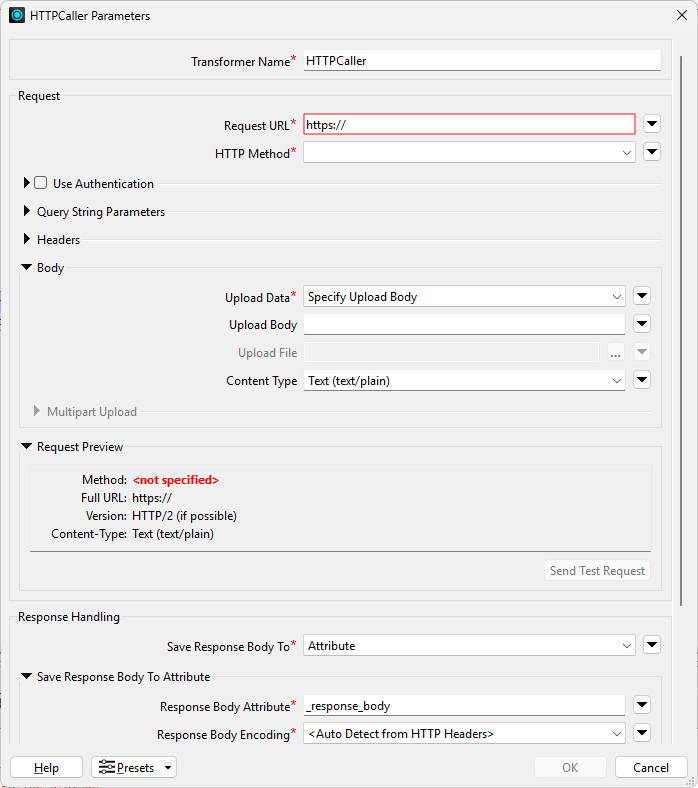

Open the HTTPCaller and take a look around. Note that there are two required fields: Request URL and HTTP method. We will need at least those two pieces of information to make a call. There are many other parameters we can optionally fill out. For now, select Cancel to leave the parameters empty.

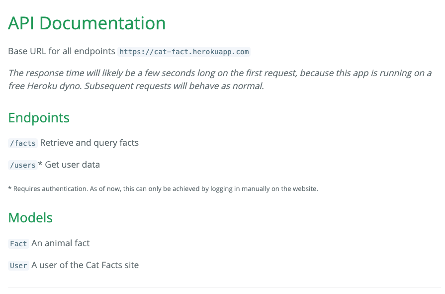

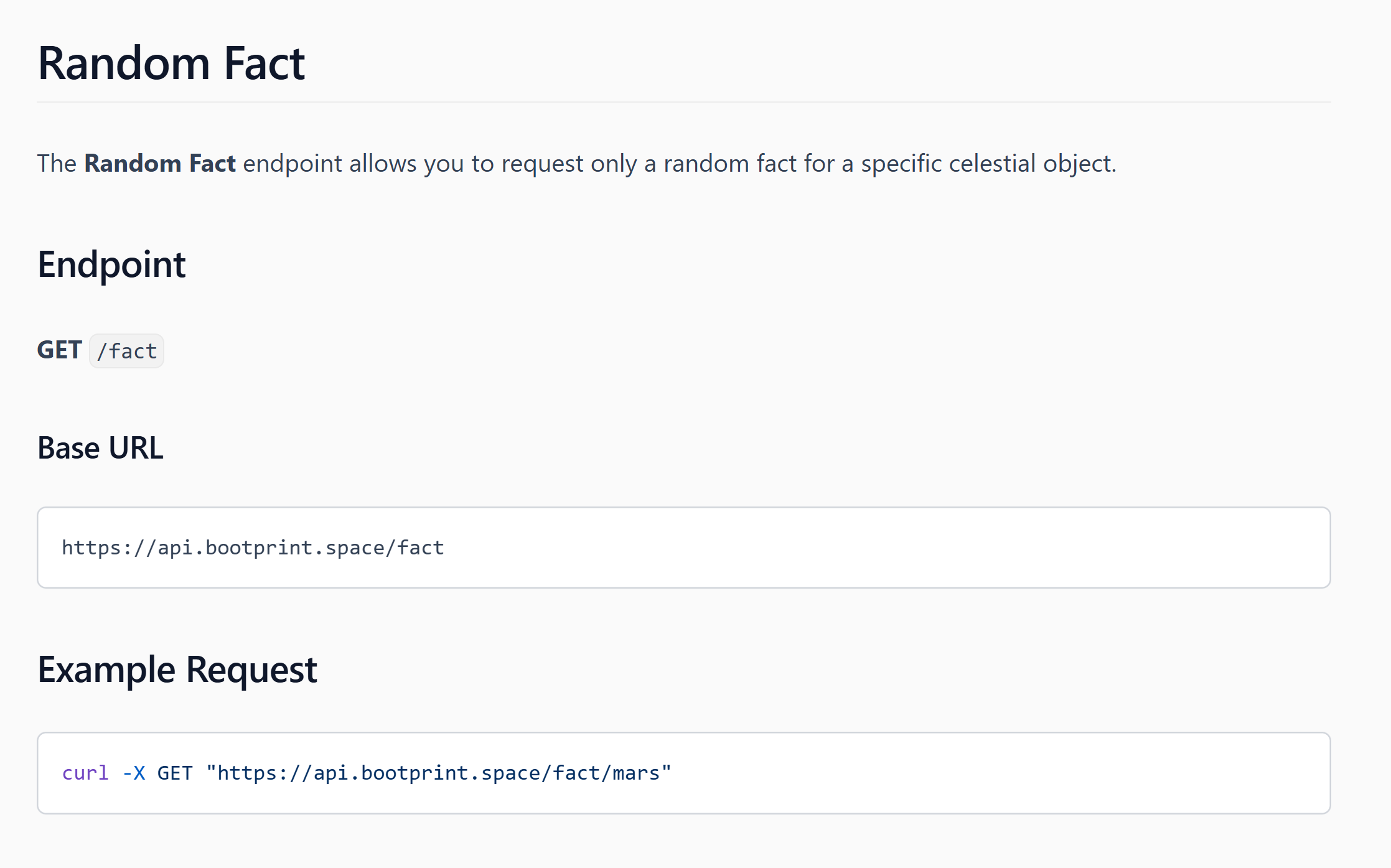

Before we can fill out the HTTPCaller parameters, we should consult the API’s documentation. For this example, we will use the Bootprint API. This is a simple API designed to do one thing: send facts about space.
When choosing an API, always review the Terms and Conditions to ensure it fits your needs. Navigate to the Random Fact heading on the Endpoints page.
The endpoint for random facts here is /fact, with a base URL of:
https://api.bootprint.space/fact
Since we would like Earth facts, we'll use the following request URL:

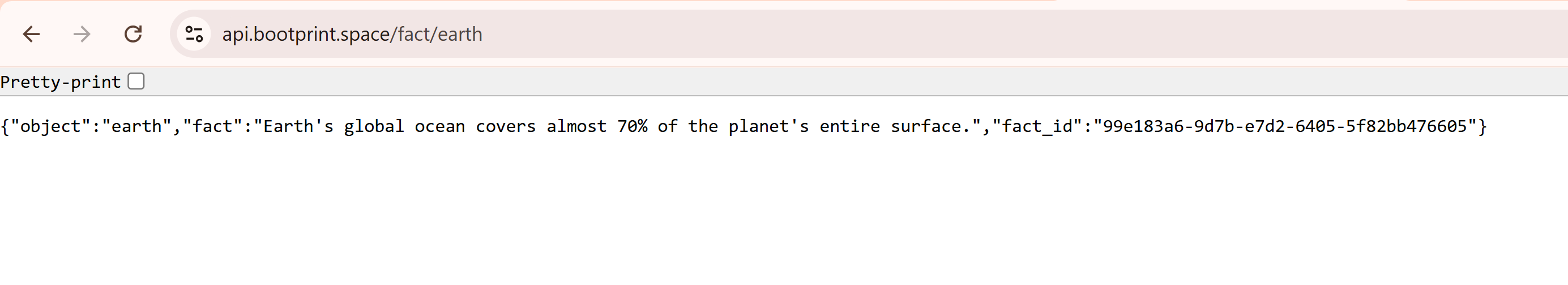

https://api.bootprint.space/fact/earth
This is a GET endpoint. Opening the above in a browser will display the JSON returned by the API call:

3. Start Building the API Call
Our goal is to retrieve a fact about the Earth from the API and bring it into the workspace. With this in mind, we can start building our API call. Return to the workspace and open the HTTPCaller parameters.
In the Request URL, enter the base URL that you have just constructed.
Set the HTTP method to GET, as this is the method specified in the API documentation. GET requests are usually used to retrieve data.
You have the option to write the API response to an Attribute or File. For this example, we’d like to save the response body to an Attribute _response_body so that we can use it downstream.
Though the HTTPCaller offers many other optional parameters, we only need to modify the Request URL and HTTP method for this request.
Note that the Bootprint does not require authentication, so we do not need to select the Use Authentication parameter. However, many other APIs typically require some type of authentication for access.
Select OK.

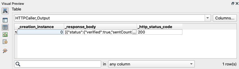

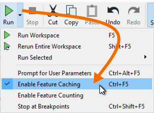

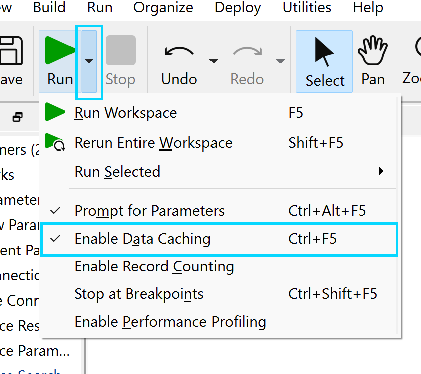

Turn on Data Caching and select Run.

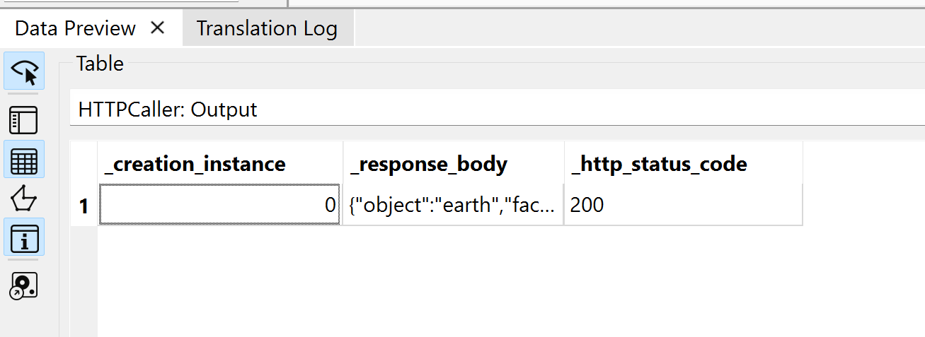

Examine the output by selecting the "Looking Glass" icon on the HTTPCaller transformer. A successful translation returns a 200 value to the _http_status_code attribute. This means that the request was received OK and the message has been fetched from the API server. There are many response codes you may receive; it is good practice to familiarize yourself with them.

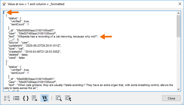

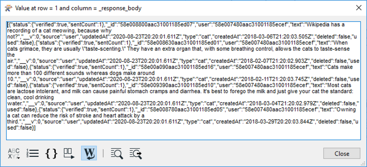

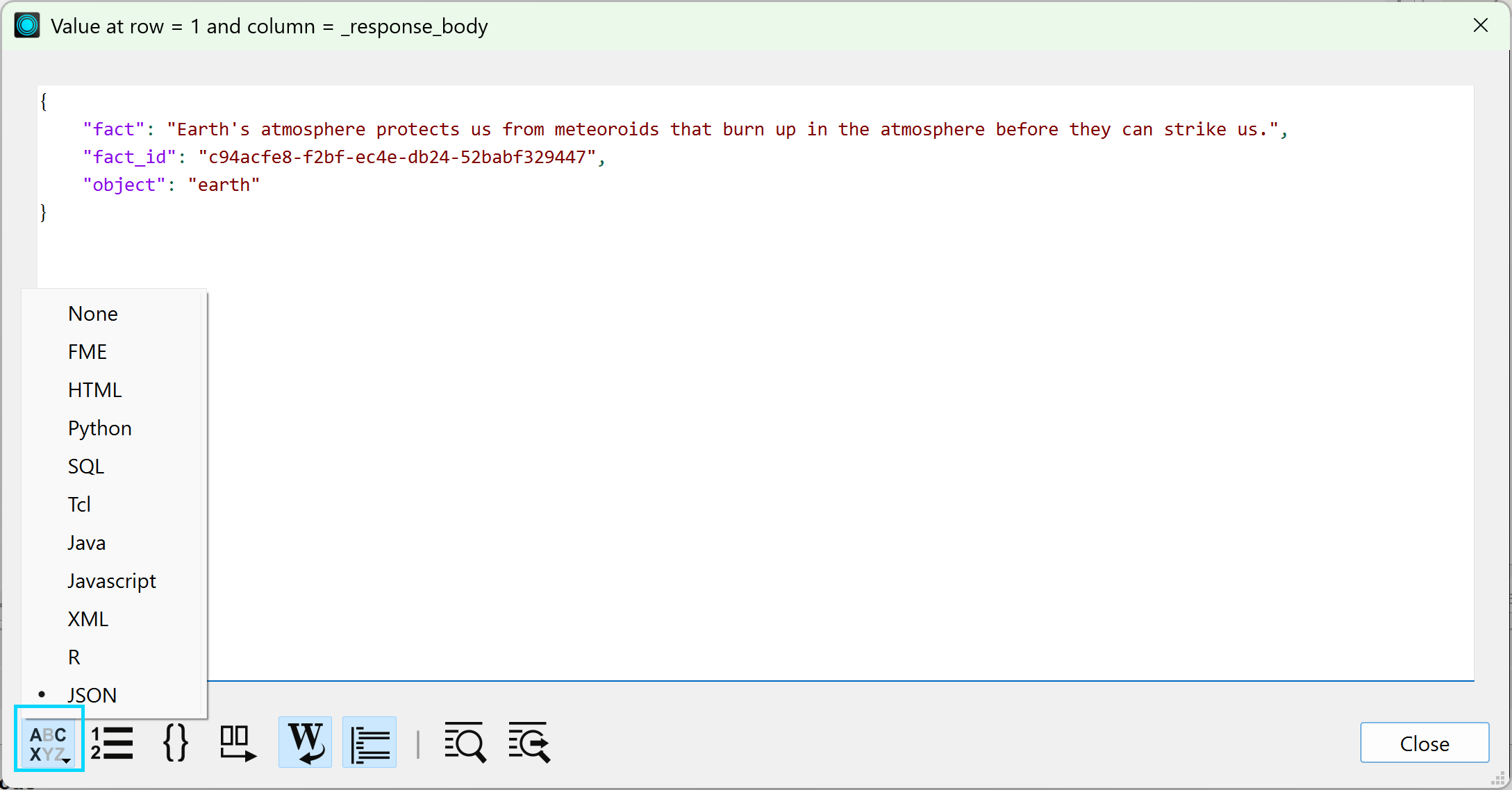

From the table, we can double-click the _response_body attribute to inspect what the API has returned. Use Syntax Highlighting to make the JSON easier to read.
6. Parse the JSON Body

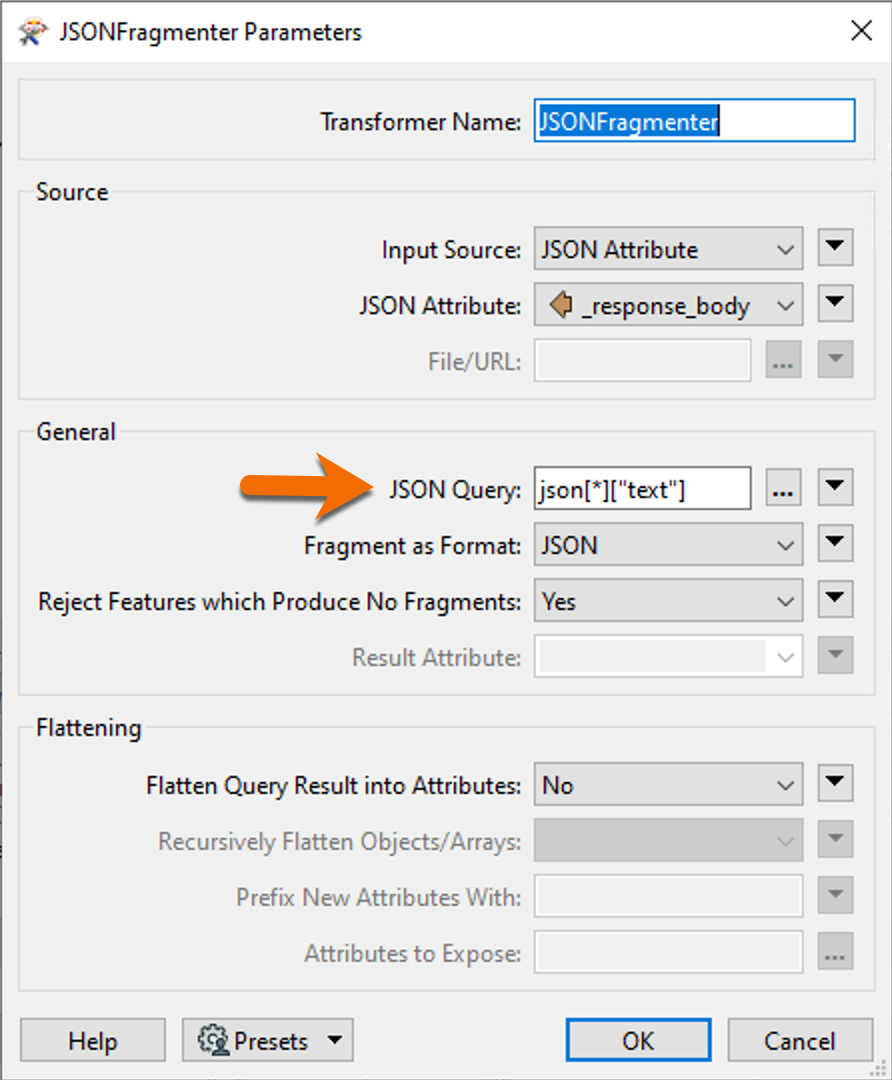

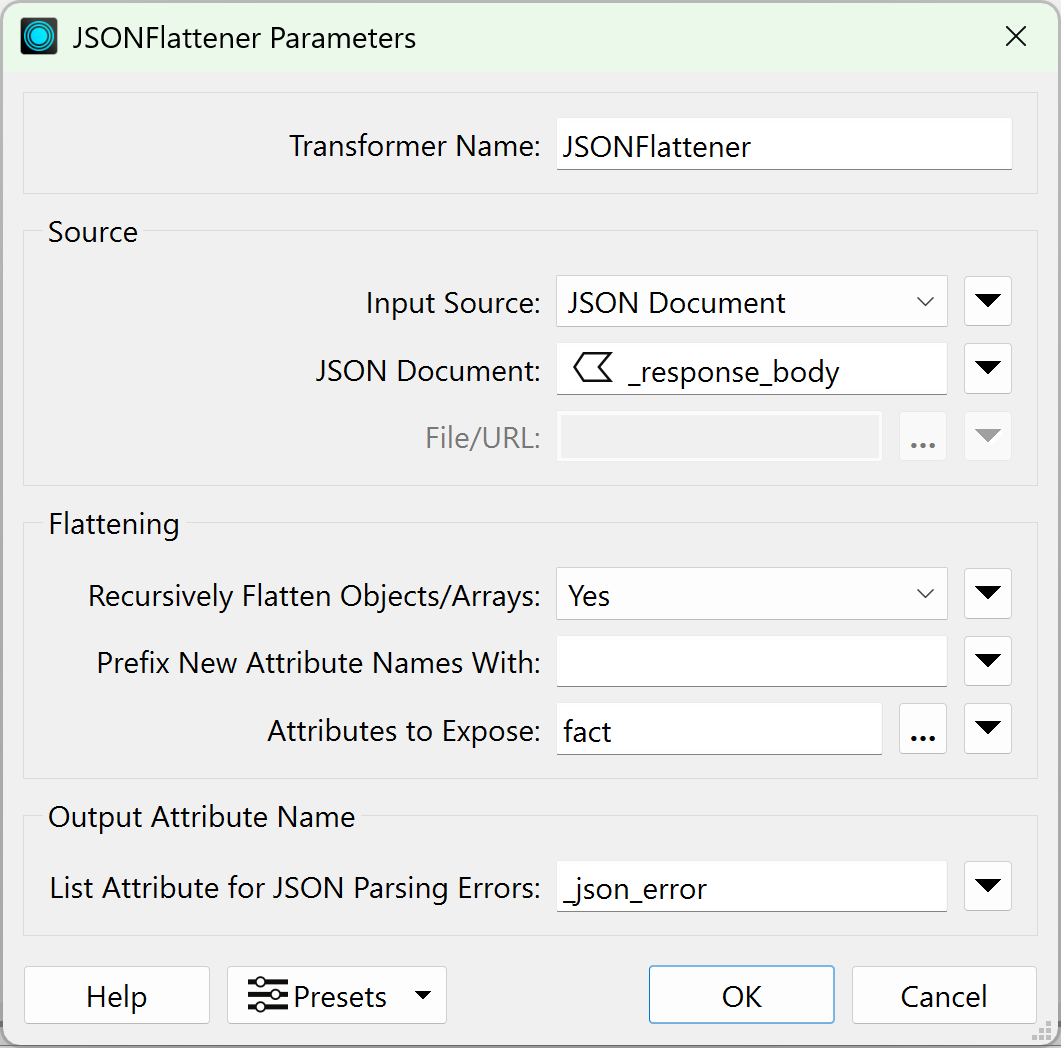

From the JSON shown above, we can see that the "fact" attribute needs to be extracted.

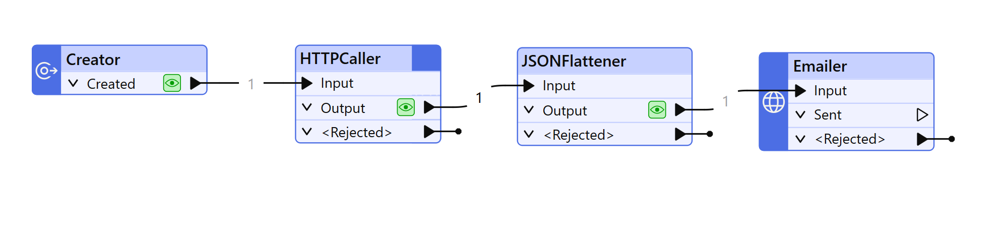

Add a JSONFlattener and connect it to the HTTPCaller. Set the JSON Document to _response_body and the Attributes to Expose to fact.
Hit Run, and ensure the fact attribute has been created correctly.
7. Configure the Emailer

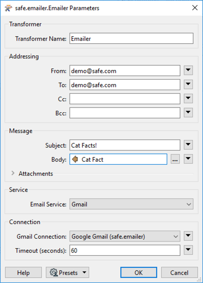

Finally, we can use our workflow to send our randomly selected Earth fact to the recipient of our choice. Add an Emailer and connect it to the JSONFlattener. Open its parameters.
This transformer requires a Gmail/Microsoft Web Connection, or SMTP configuration to work. Enter your Service or SMTP details and continue.
For testing, set both the From and To parameters to your email. Add a Subject line, like “Earth Facts”, and select the fact attribute as the body.

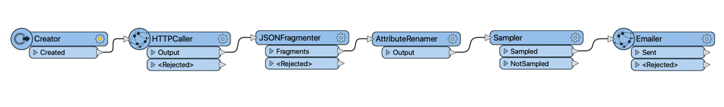

Select OK. Your final workspace should look like this:

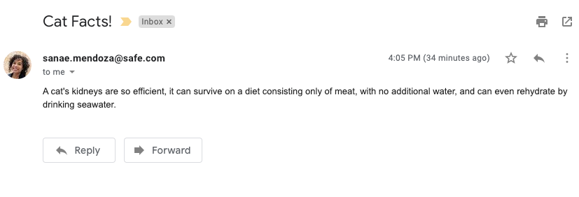

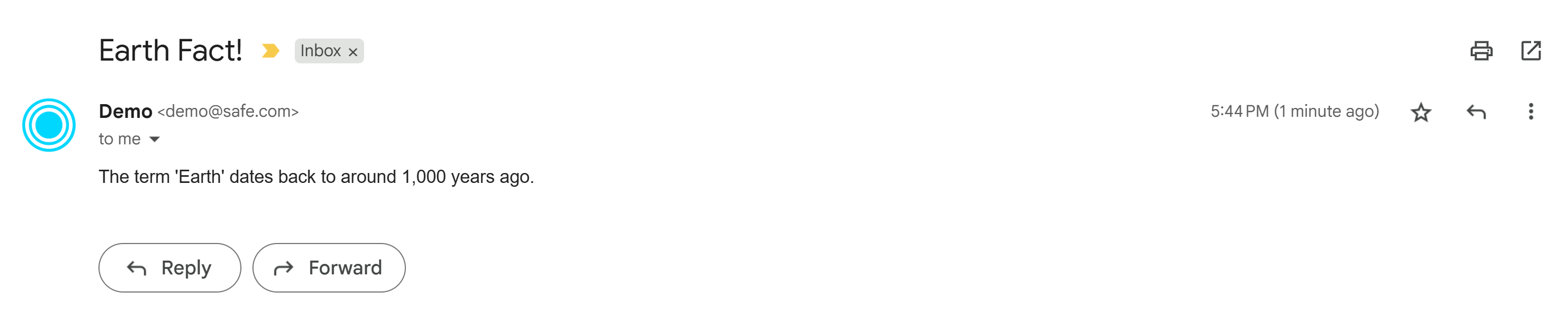

8. Check your Email
Run the workspace. Check the inbox of the recipient's email address. Inside, you should find a new email with the subject “Earth Fact!” sent from your workspace.
