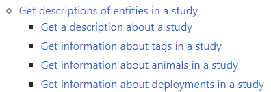

3. View Movebank’s API Documentation
Movebank’s API Documentation is shared on GitHub, where additional security, data access, and authentication information is also detailed. Since we are creating a workflow that allows users to select a specific eagle at run time, select “Get information about animals in a study” from the Contents.
Note that the request URL that we will be using to obtain a list of unique eagle IDs will take the form: https://www.movebank.org/movebank/service/direct-read?entity_type=individual&study_id=2911040

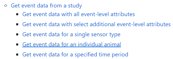

Referring back to the Contents, select “Get event data for an individual animal” now.
Note the request URL that we will be using to obtain tracking data for our selected eagle will take the form:
https://www.movebank.org/movebank/service/direct-read?entity_type=event&study_id=2911040&individual_id=2911059

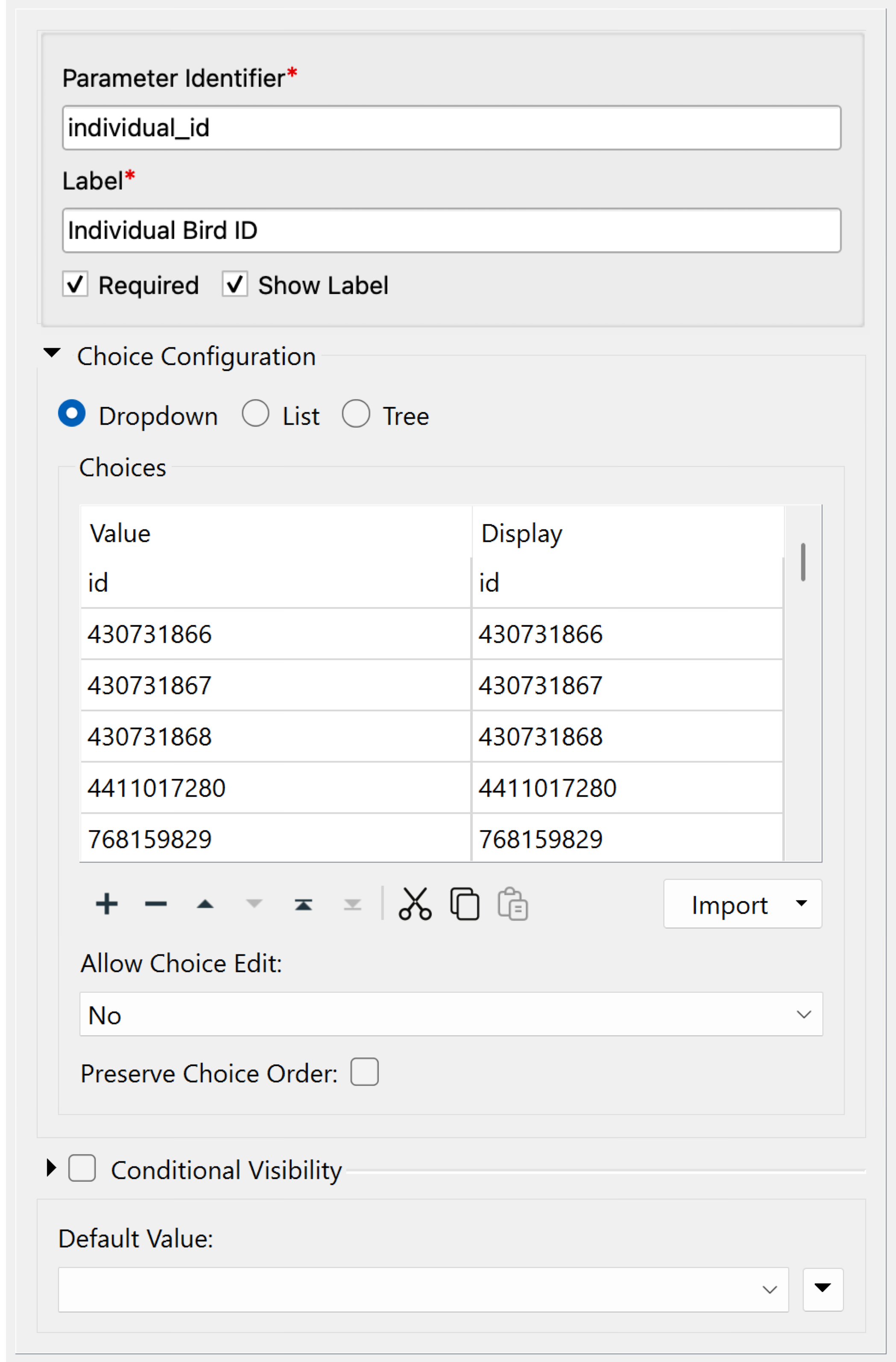

7. Create a User Parameter to Select an Individual Eagle at Run Time
Right-click "User Parameters" in the Navigation pane and select "Manage User Parameters". In the User Parameter manager, click on the green plus sign (+) in the top-left corner, and then select "Choice". This parameter provides the user with a drop-down list of Bird IDs at runtime.
On the right-hand side of the parameter manager, configure the parameter as follows:
  • Parameter Identifier: individual_id
  • Label: Individual Bird ID
  • Required: Enabled
  • Visibility: Always Show
  • Choice Configuration: Dropdown
Next, we'll import the values. Click on the Import button, then select "From Dataset". The Import Wizard will open, prompting you for a Format and a Dataset.
  • Format: CSV (Comma Separated Value)
  • Dataset: CSV file from the previous step
Click Next. Change the "Import from" to "Attribute values".
Click Next, then select "id" for both Value and Display. Click Import.
A list of individual eagle IDs will appear. Ensure the Default Value is blank, then click OK.

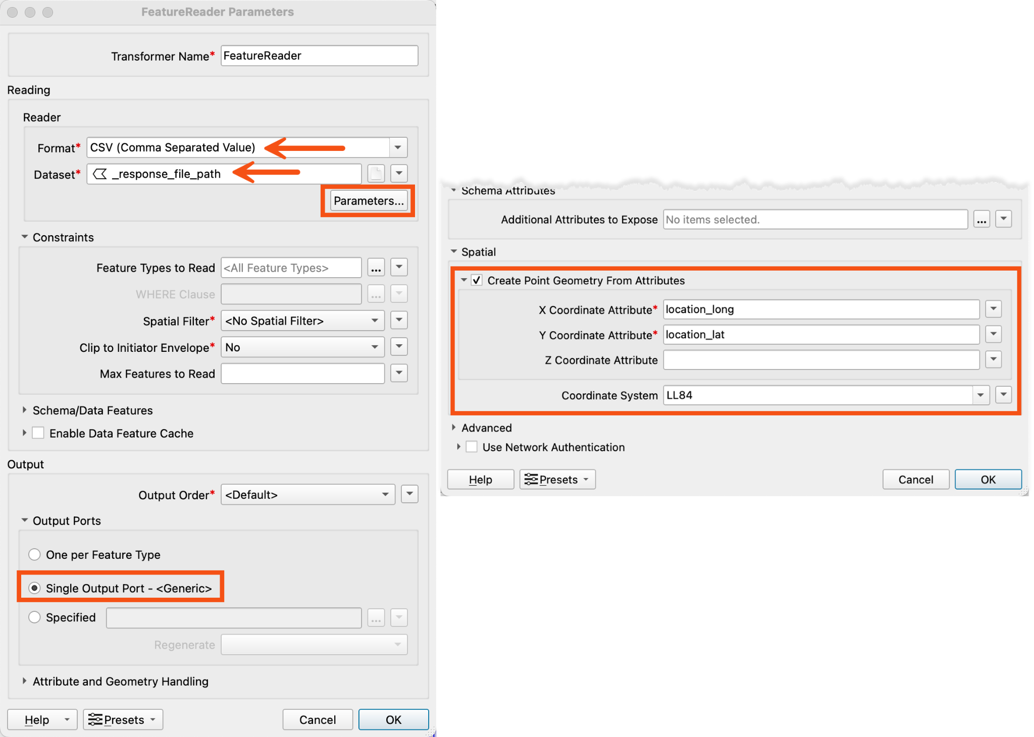

  • Connect your HTTPCaller Output port to a FeatureReader Initiator input port. In the parameters, set the following:
      • Dataset: _response_file_path
          ◦ Click the drop-down arrow and select the attribute under Attribute Value
    Expand the Output Ports section and set to Single Output Port:
      • Single Output Port - Generic: Enabled
    Click the Parameters button to set the coordinate system:
      • Create Point Geometry from Attributes: Enabled
      • X Coordinate Attribute: location_long
      • Y Coordinate Attribute: location_lat
      • Coordinate System: LL84
    FeatureReaderCSV2025.2
    Click OK twice to exit the parameters.

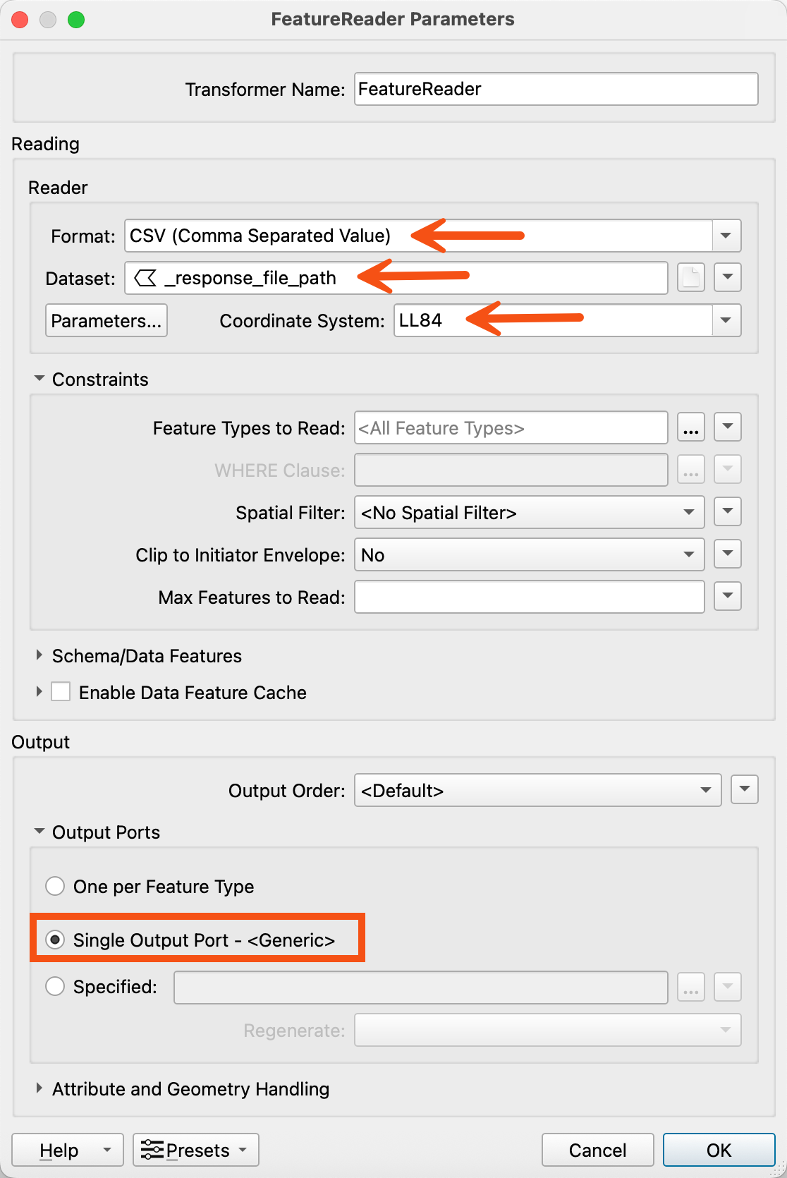

    FeatureReaderCSV2025.1
    Click OK to exit the parameters.
