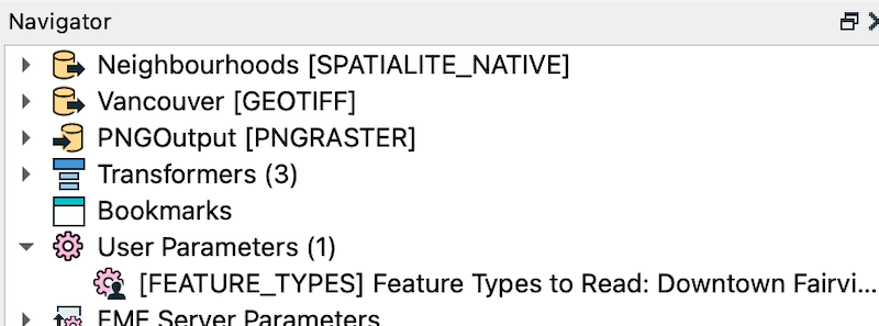

We can control what the client (our user or application) can change by carefully considering the workspace’s User Parameters. Any user parameters can be accessed and modified from a webhook URL.
Our FEATURE_TYPES parameter determines which tables are read from the Spatialite database. Each table contains a polygon of a different Vancouver neighborhood. Our webhook will allow the client to choose which neighborhoods they’d like to view imagery for.
Whenever possible, run the translation in FME Workbench to ensure everything is working correctly. When all the Feature Types to Read are selected, the workspace writes a PNG Raster image (NeighbourhoodSat.png) clipped to the City of Vancouver’s boundaries. Please note that to run this workspace from Form successfully, you must set local file paths for all the readers and writers.

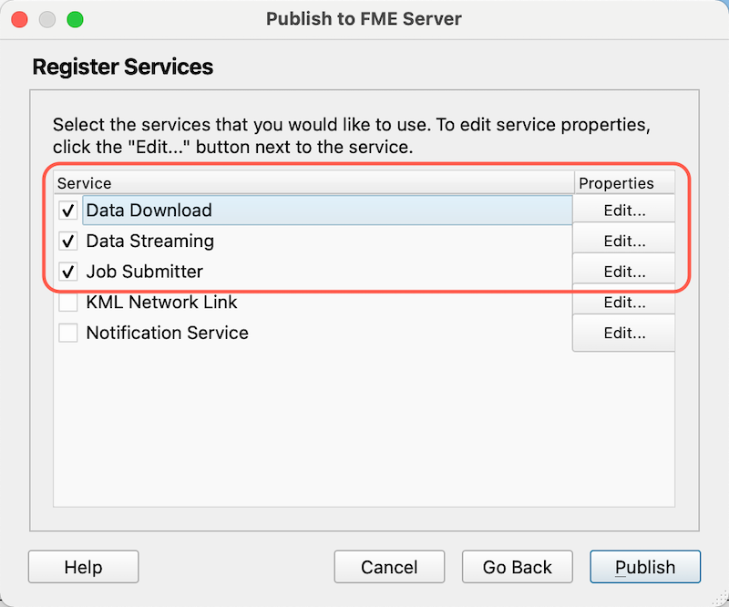

3. Register Web Services
FME Flow Services enable us to control how end users receive translation results. Select Data Download, Data Streaming, and Job Submitter. Publish.

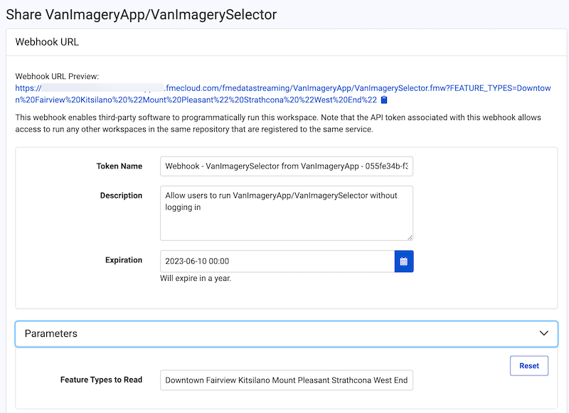

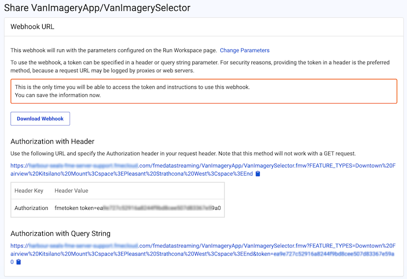

The Share page allows us to preview our final API Token and Webhook URL.
FME Flow automatically creates a new API token for every Webhook URL. The API token allows another application to run the workspace and any other workspaces saved to the same repository without an FME Flow account. Permissions are automatically restricted to the workspace repository and its dependencies, but this can be modified after creation on the Manage Tokens page.
The Webhook URL Preview contains all the required information to run a particular workspace from the web: the FME Flow domain, web service, repository, and workspace. Finally, any parameters and their values are followed by a query string.
To modify the default URL, expand the Parameters panel. Try removing one of the values (e.g., “Downtown”) and watch how the Webhook URL Preview changes in real time.
If the workspace uses a geometry parameter, the webhook URL will need to be URL-encoded geojson.

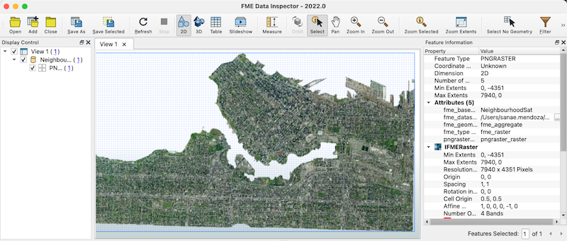

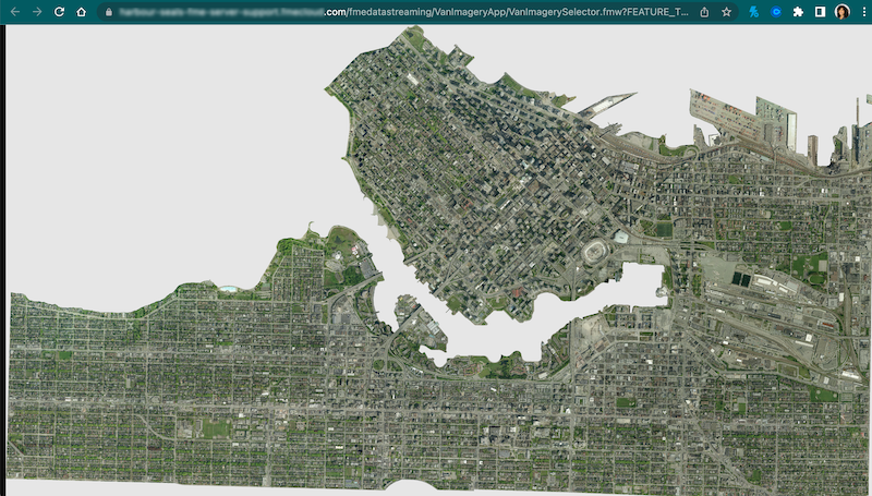

We can also preview what the results from our Webhook URL will look like. Select the clipboard next to the Webhook URL Preview to copy the link. Open a new browser tab and paste the link into the search bar. (You may be prompted to log into FME Flow again. This is because our Webhook URL Preview link does not yet include authentication).
View our clipped PNG Raster now from a browser window. If you removed any values from the Feature Types to Read parameter, your raster may be clipped differently from the one pictured below.
On the FME Flow Share page, select Reset to restore the default parameter values. Select OK.

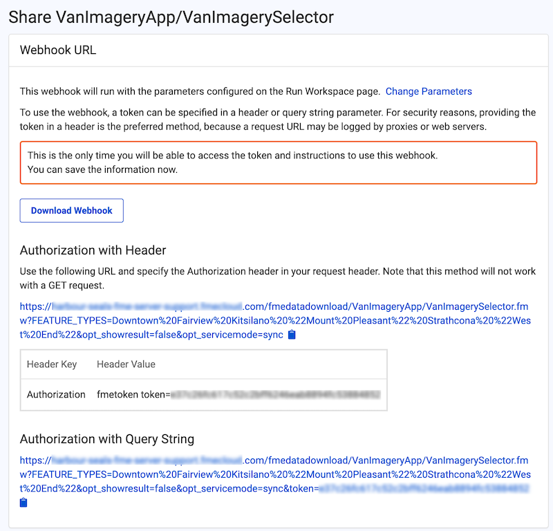

4. Save the Webhook
Before proceeding, select the Download Webhook button to save a record to your desktop. This file contains information about our new Webhook URL, and it is the only opportunity we have to save its newly created token.
To authenticate a job run via a Webhook URL, a token is included in the request headers or the query string. View examples of each on this page (or inside the saved file). In most cases, headers are used for the most secure and reliable approach. For our example, select the clipboard next to the Authorization with the Query String link to copy.
TIP: If you forget to save the file or a token is lost, you can manually create a new one to run the same Webhook URL. Read more about FME Flow Token Management at Authorization in the FME Flow REST API | Token Management.

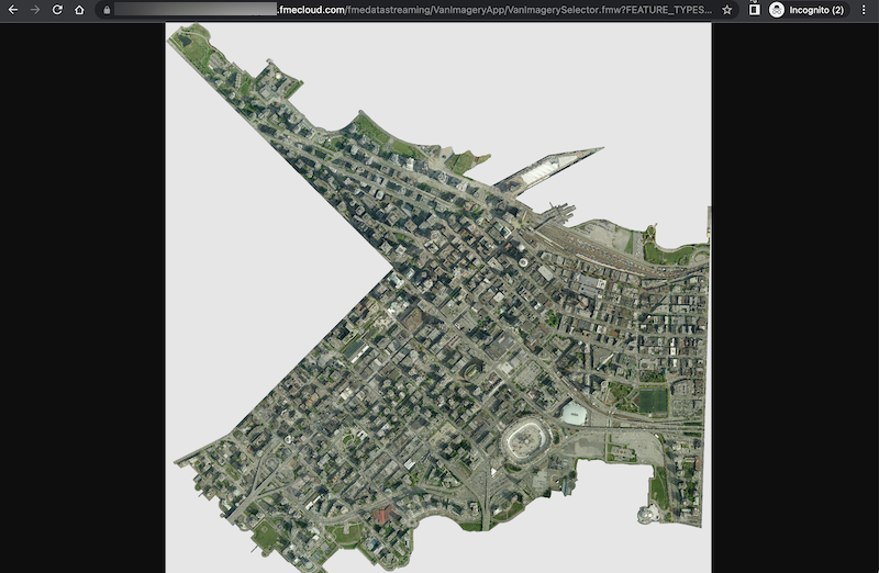

Open another browser window in incognito mode to test our new token. Paste the Webhook URL into the search bar and submit. Our PNG Raster, with all selected neighborhoods, will be streamed back. But this time, we didn’t have to log in! Try sharing this link with a trusted colleague or friend; they can get results even without an FME Flow account.
TIP: Tokens are a secure and recommended authentication method for integration. However, a token grants access to all workspaces within that repository. Therefore, share tokens only with applications and people you trust.
6. Submit a Job by Webhook URL with Updated Parameters
Webhook URLs can use different parameter values at runtime. Next to the query string’s FEATURE_TYPES parameter, delete all the values except “Downtown” (including the URL encoding). The result will look like this URL:
https://<your FME Flow>/fmedatastreaming/VanImageryApp/VanImagerySelector.fmw?FEATURE_TYPES=Downtown&token=<token>
Submit to view the updated result. This time, the output PNG Raster is clipped only to the “Downtown” selection.

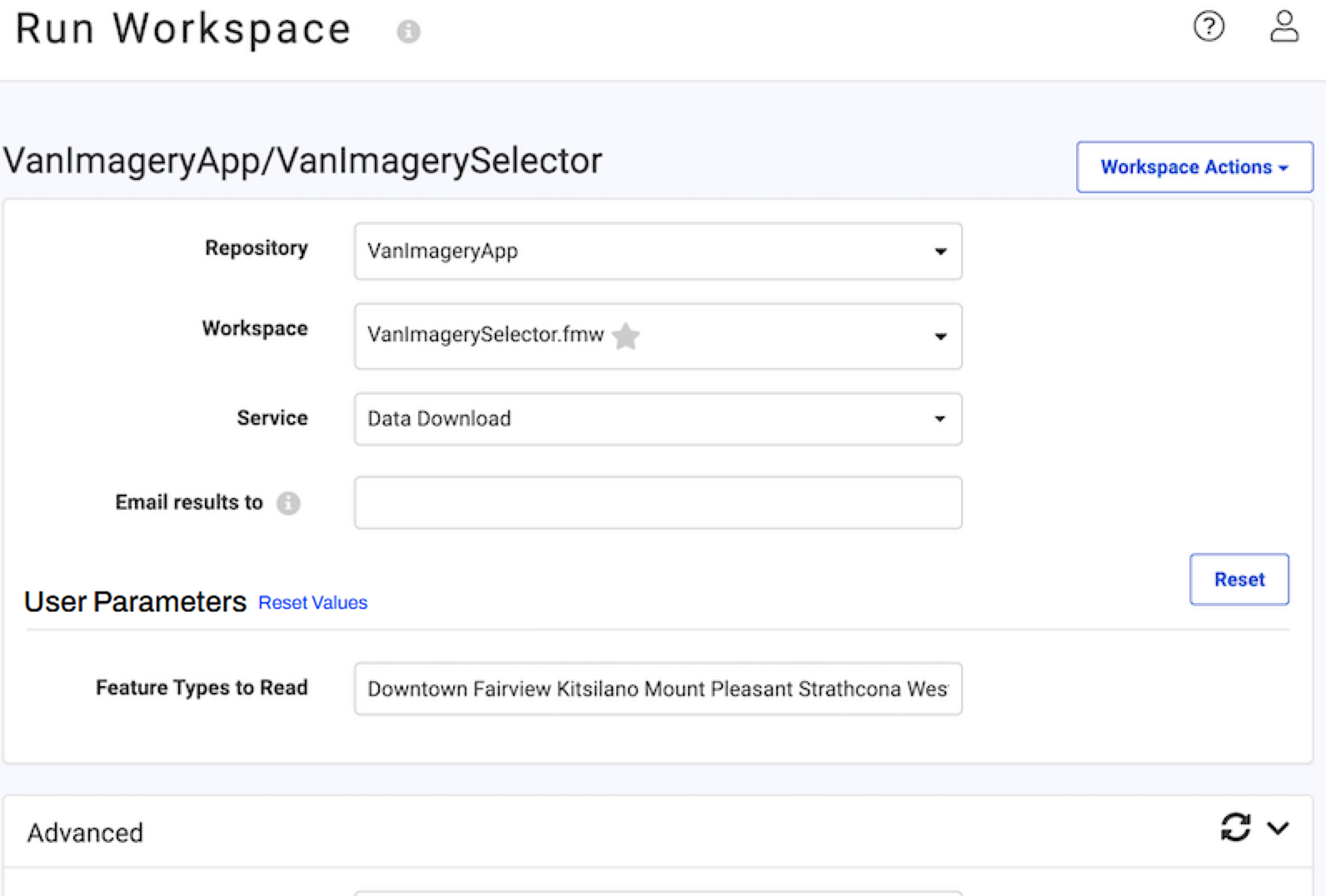

Open FME Flow in a browser. Select Run Workspace from the sidebar.
Select the “Webhook URL Tutorial” Repository, “VanImagerySelector.fmw” Workspace. This time, select “Data Download” Service. Leave the default values Feature Types to Read.
Select the Advanced panel to expand. Scroll down to find the section Other Ways to Run this Workspace and select Create a Webhook.

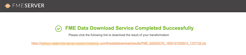

The URL preview and API token are almost identical to those in Part 2, but there is one key difference: this time, our URL specifies the fmedatadownload service. Select the clipboard next to the Webhook URL Preview to copy the link.
Open another browser tab and paste the link in the search bar (logging in again, if prompted).
A page containing a link to our results is returned.

3. Create a Token
Select the Download Webhook button to save a record of this information to your desktop.
Select the clipboard next to the Authorization with Header link to copy.

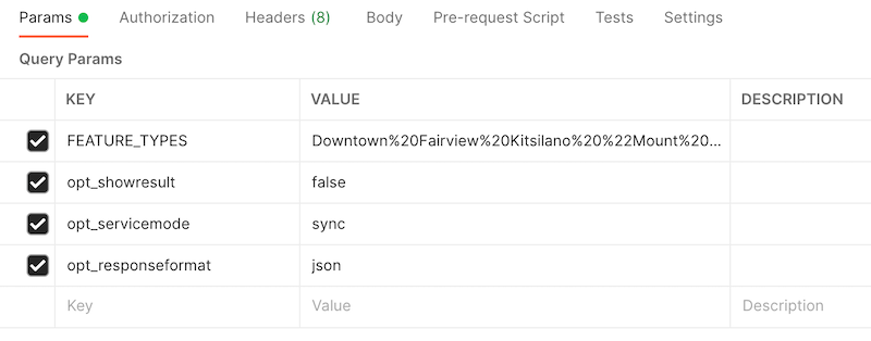

In Postman, open a new tab to begin building the request. Paste the URL into the space provided in Postman. Use the dropdown menu to change the method from GET to POST.
You may notice that the request contains additional query parameters: opt_showresult and opt_servicemode. These are examples of parameters specific to the data download service. Each transformation service has parameters that control how the job runs and how the service is delivered. For this request, opt_showresult=false indicates that the full translation details should not be returned in the response, and opt_servicemode=sync submits a synchronous job.
Add an additional header to format the response in JSON: opt_responseformat=json

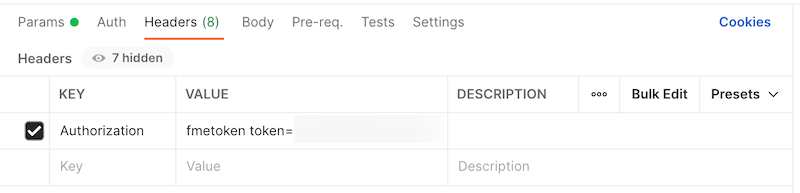

5. Create Headers
Passing tokens as a request header is the preferred method of authentication.
In FME Flow, copy the Header Value given under the Authorization with Header URL.
In the Postman request, select the Headers tab. Create a new header with Authorization. Paste the copied value as the VALUE.
Once the header is completed, select SEND to submit the request.

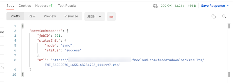

6. Get the Results
A successful request returns a link to the results compressed in a zip file. Subsequent requests can use this link to download the results.
Copy the value given for the “url” and paste it into a new browser window. Instead of a results page, you’ll immediately be prompted to download a zip file to your local desktop.

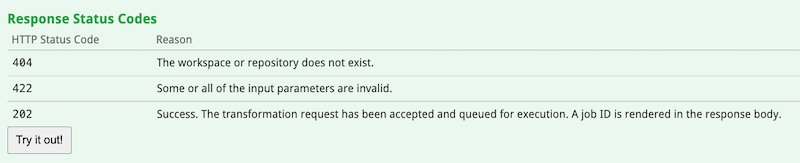

The FME Flow REST API returns an error when it rejects a request. The API response contains the error code and message.
For an overview of general error codes and their corresponding messages, review the HTTP Response Codes and Errors section of the FME Flow REST API documentation.
Error messages can also be specific to the request type. For example, a job request may be rejected when a user parameter is invalid. Select a request in the documentation to view the Response Status Codes:
