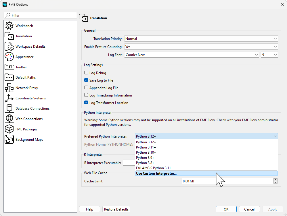

In FME Form, select Tools > FME Options from the menu bar.
In the FME Options dialog, select the tab for “Translation", and navigate to the Preferred Python Interpreter setting under the Python Interpreter section. Click on the drop-down and select “Use Custom Interpreter…”.
Enter the location of the Python DLL you wish to use. If you are having trouble with determining the location of the python*.dll, please see the section titled Where to Find the Python DLL below.
You can also set PYTHONHOME using the Python Home field. It may be necessary to set this for users with multiple Python installations, so the interpreter knows to use which set of standard libraries should be used. More information on the PYTHONHOME environment variable can be found here.
NOTE: This option controls FME as a whole, and not just the current workspace. Therefore, all FME workspaces that have a Python Compatibility value that is compatible with the specified interpreter will use this alternative version of Python, until you revert this option.
