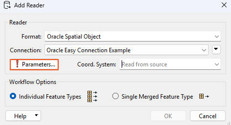

Click on the Add Reader icon. Select ‘Oracle Spatial Object’ as the format. Select ‘add database connection’ for the dataset and connect to your Oracle database instance. If you need additional details for connecting to Oracle, refer to the Viewing and Inspecting Oracle Data article.

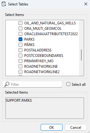

For our example, we will be making use of the Parks dataset. If you are following along with the FME sample datasets, then select ‘Parameters...’, and from Table List choose ‘Parks’

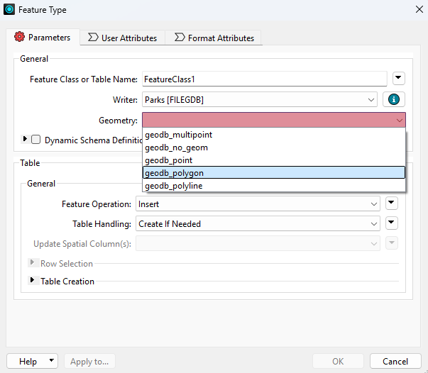

Click on the Add Writer icon. Select Esri Geodatabase (File Geodb Open API) as the format, browse to a location, and set a name for the dataset. Open the Feature Parameters for the Writer. Under the General tab, change the Table Name to ‘Parks’ and the Geometry to ‘geodb_polygon’. Connect the Reader and Writer.

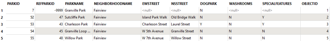

Run the workspace and view the results in FME Data Inspector. Using the WHERE clause, we have constrained the parks being read from the Oracle database to the five parks appearing in the Fairview neighborhood.

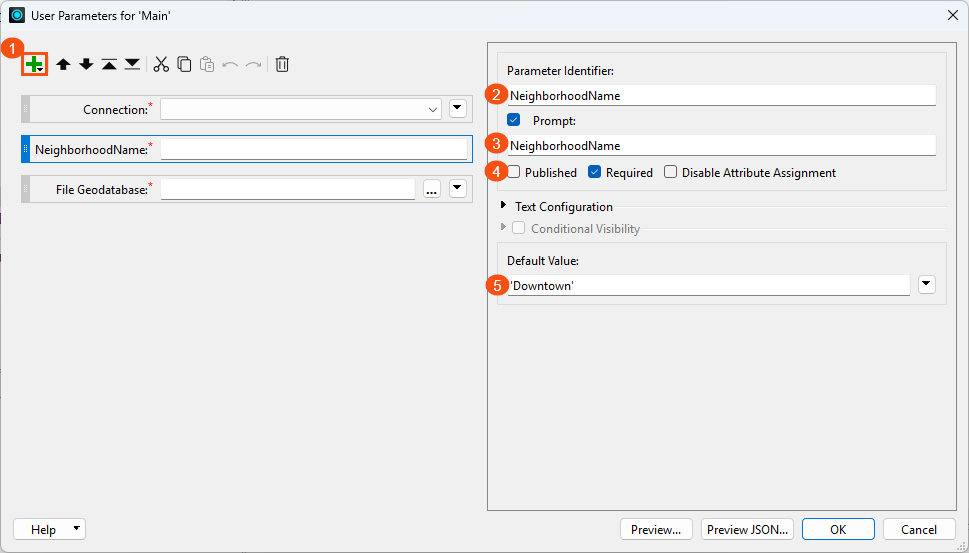

1. Add a User Parameter

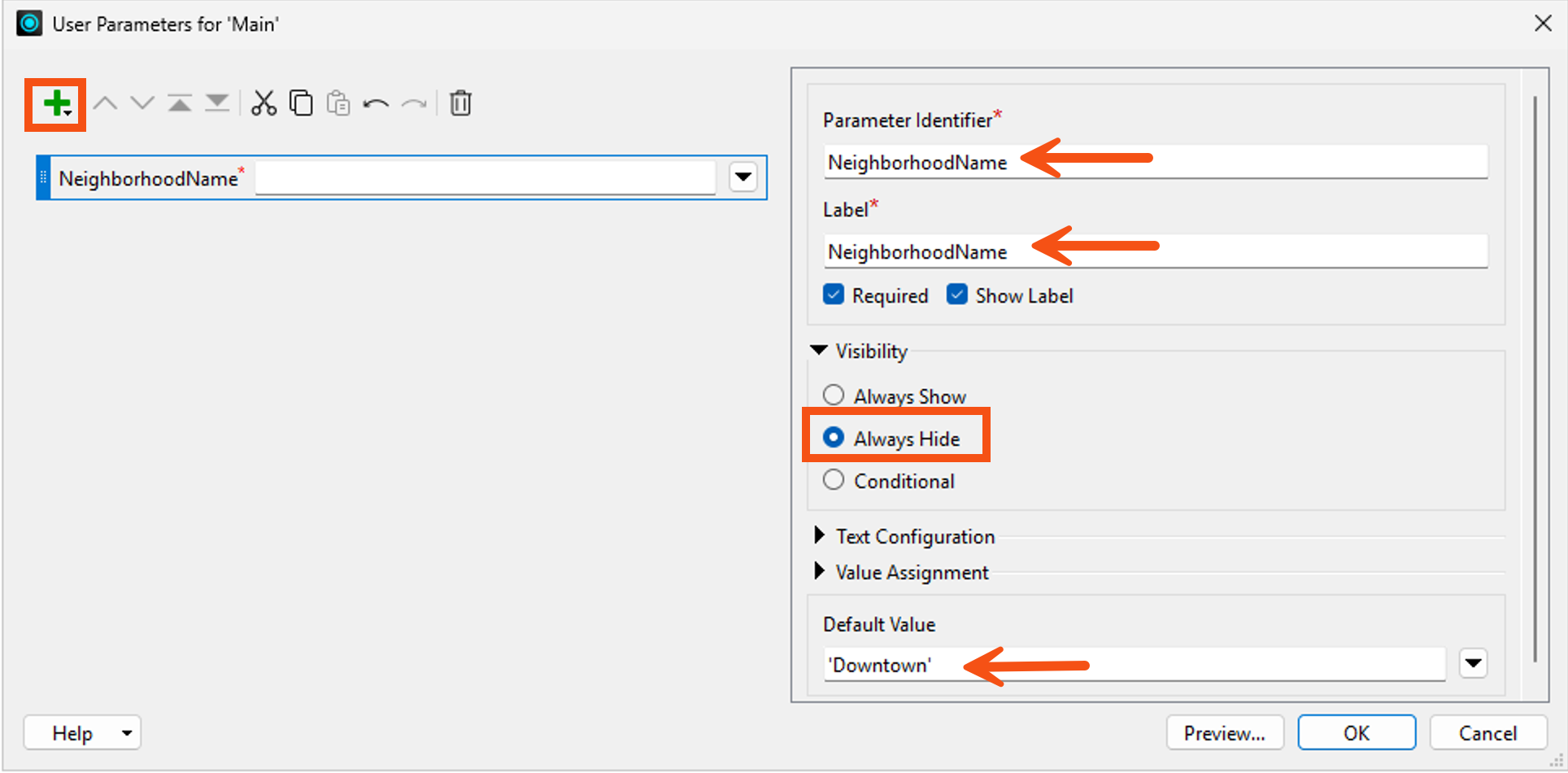

Right-click “User Parameters” in the Navigator window and choose "Manage User Parameters". When prompted, click the green plus sign and select ‘Text’. Set the name to ‘NeighborhoodName’ and the prompt to ‘NeighborhoodName:’. Under Visibility, select 'Always Hide' so the user is not prompted, setting it as a hidden parameter. Set the Default Value if desired (e.g., ‘Downtown’ with single quotes. Click OK to save the user parameter.
