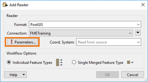

Start FME Workbench and create a blank workspace. Add a PostGIS reader to the canvas and connect it to the FMETraining Database created in step 1.

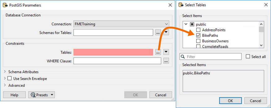

In the parameters, click on the ellipsis next to tables, then select the BikePaths table from the public schema. Click ok three times to finish adding the reader.

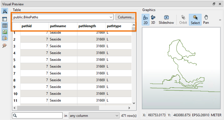

Click on the public.BikePaths reader feature type to open the mini toolbar. Then click on View Source Data to view the data in Data Preview (formerly Visual Preview).
In Data Preview, you can see that there are multiple bike paths throughout the city of Vancouver, all of which are L (large) path types. The important part of viewing the data is not the data itself but the dataset's structure (schema). To ensure the new data can be added successfully to this table, we need to import the schema.

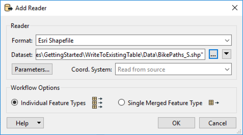

The PostGIS reader can be deleted if desired, as we won’t be using it anymore. Next, add an Esri Shapefile reader to the canvas. Browse to the BikePaths_S.shp dataset; this dataset is available in the Files section of this article. Click OK to finish adding the reader.

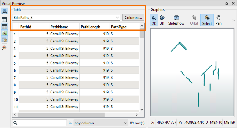

Before we write out the data, let’s inspect the shapefile data to see what the starting schema is. On the BikePaths_S reader feature type, click on View Source Data to open Data Preview.

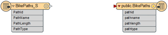

In Data Preview, you can see that the schema is similar, but there are capitalization differences in the attribute names. The database uses all lowercase, whereas this dataset uses CamelCase.

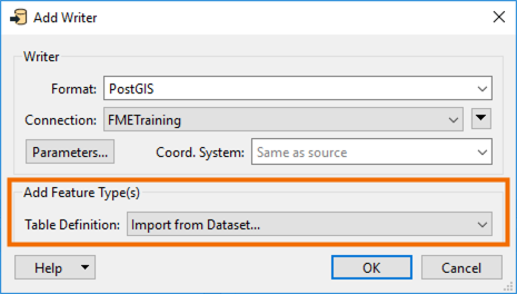

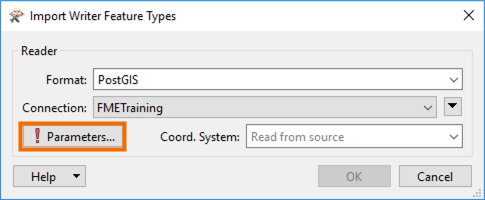

Add a PostGIS writer to the canvas and connect to the FMETraining database. To import the schema from the existing table, change the Table Definition to Import from Dataset, then click OK.
After clicking OK, an Import Writer Feature Types dialog will appear. This dialog can be used to import feature types from any source. Since we already read in the Training PostGIS database earlier in this tutorial, the parameters should already be set. Confirm that the Format is set to PostGIS and the connection is FMETraining. Then open the Parameters.
The parameters are the same as when the table was read in earlier. Click on the ellipsis next to Tables and select public.BikePaths, click OK three times to finish importing the schema.

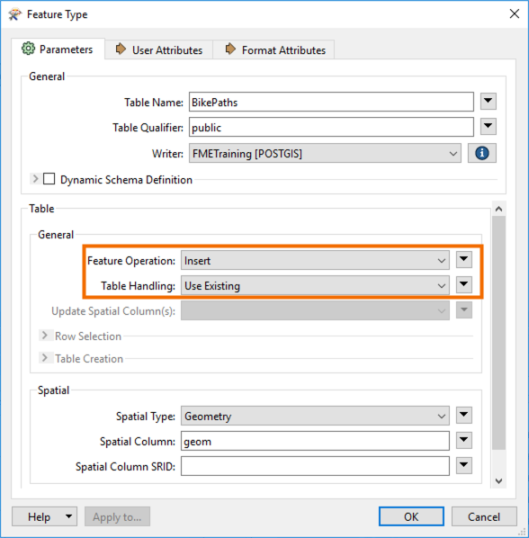

Double-click on the public.BikePaths writer feature type to open the parameters. Check that the Feature Operation parameter is set to Insert, and then change the Table Handling to Use Existing. This will allow us to add more data to the table without overwriting or removing existing data. For more information on the database operations available in FME, please see the Feature Operation documentation.

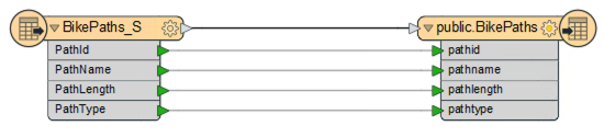

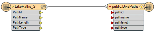

The reader and writer feature types must now be connected. Connect the BikePaths_S reader feature type to the public.BikePaths writer feature type. If you click the drop-down arrow next to each, you will notice that the arrows are yellow and red, which means that the attributes are not correctly mapped. This is due to the lowercase and CamelCase attribute names.

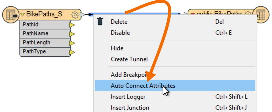

To quickly correct this, right-click on the connection line and select Auto Connect Attributes. If you were planning to modify the attributes or further transform your data before writing it out, it is recommended that you use the Replace Link with AttributeManager option instead.
