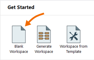

Open FME Workbench and create a blank workspace.

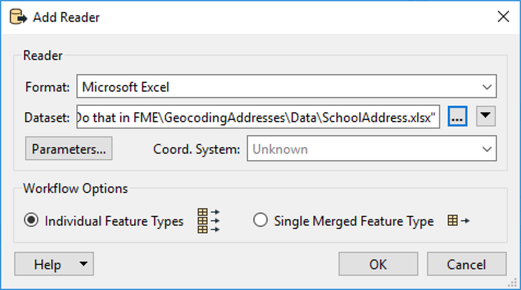

Add a Microsoft Excel reader to the canvas by clicking on the Reader button on the top menu bar or by going to Readers > Add Reader. In the Add Reader dialog, select Microsoft Excel as the Format, then for Dataset, browse to the SchoolAddresses.xlsx dataset, which is available for download from the Files section of this article.

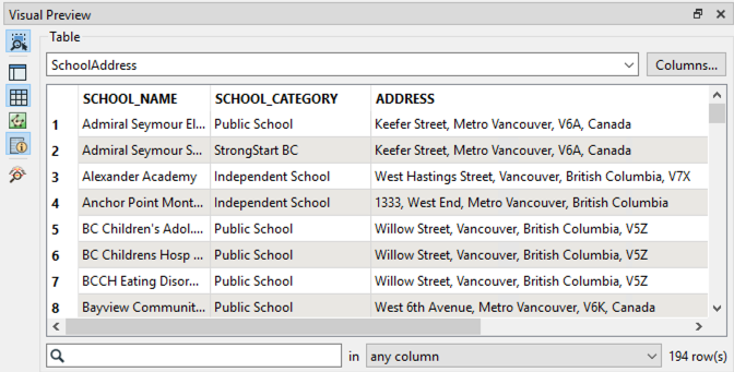

The Excel Workbook contains three attribute columns: School Name, School Category, and Address. Use the Address column to geocode the schools and obtain their coordinates in the LL84 coordinate system.

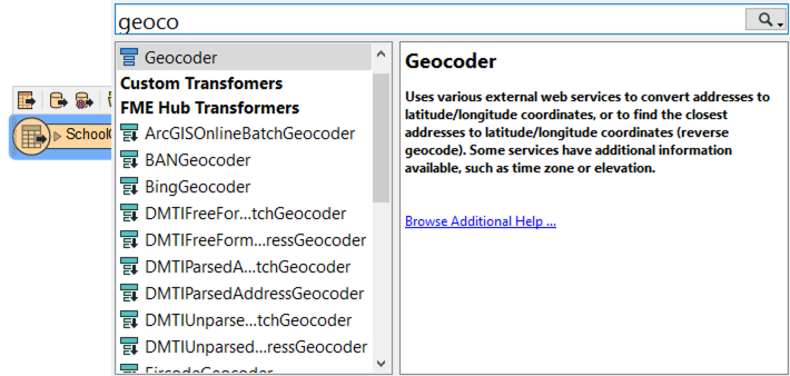

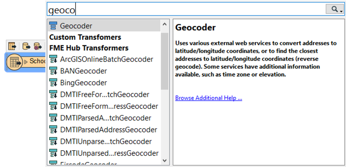

Click on the SchoolAddress reader feature type to select it. Then add a Geocoder transformer to the canvas by typing “Geocoder” to bring up the list of FME Transformers in the Quick Add Search. Select the Geocoder from the list of Transformers by double-clicking it, or use the arrow keys and Enter to add it.

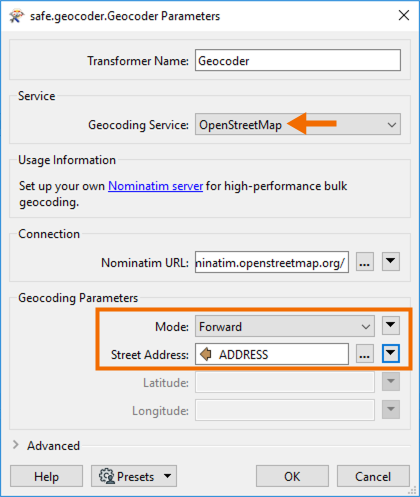

Double-click on the Geocoder to open the parameters. In the parameters, change the Geocoding Service to OpenStreetMap. Then set the Mode to Forward and select the ADDRESS attribute for Street Address.

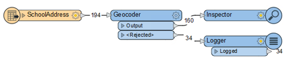

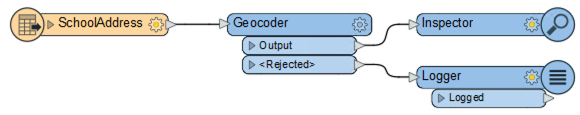

Add an Inspector to the canvas and connect it to the Geocoder Output port. Additionally, connect a Logger to the Geocoder <Rejected> output port. If the geocoding service can’t find any addresses, log them via the Logger and continue the translation.
Run the workspace by clicking the Run button on the top toolbar, or by selecting Run > Run Workspace from the top menu bar.
After running the workspace, the Visual Preview will show point features for all the schools, including their addresses and Lat/Long.
34 addresses were rejected. These may have been rejected due to spelling or address format.

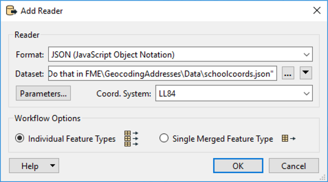

2. Add a JSON (JavaScript Object Notation) Reader

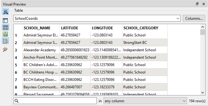

Add a JSON (JavaScript Object Notation) reader to the canvas by clicking on the Reader button on the top menu bar or by going to Readers > Add Reader. In the Add Reader dialog, select JSON (JavaScript Object Notation) as the Format, then for Dataset, browse to the SchoolCoords.json dataset, which is available for download from the Files section of this article.
As of FME 2025.2, the Coordinate System parameter is now configured within the Parameters dialog of each reader/writer format. For more information, including details about the change and affected transformers, please see Coordinate System Parameter Location Change.

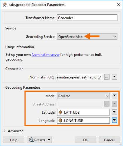

Double-click on the Geocoder to open the parameters. In the parameters, change the Geocoding Service to OpenStreetMap. Then change the Mode to Reverse and set the Latitude and Longitude parameters to their corresponding values.

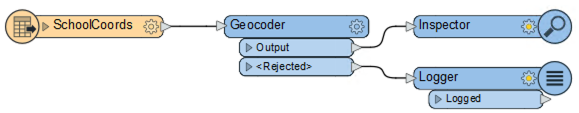

Add an Inspector to the canvas and connect it to the Geocoder Output port. Additionally, connect a Logger to the Geocoder <Rejected> output port. If the geocoding service can’t find any coordinates, log them via the Logger and continue the translation.

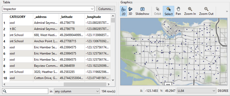

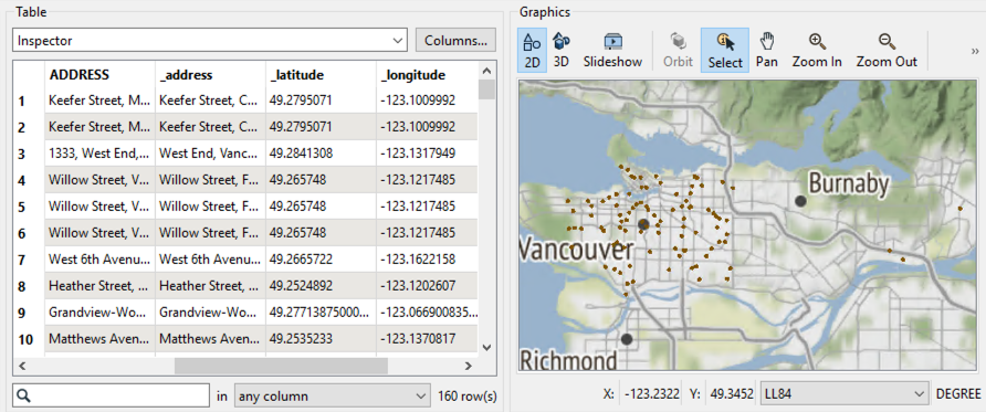

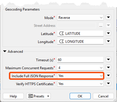

2. Enable the Full JSON Response
Open the Geocoder parameters and expand the Advanced section. Set the following parameter:
  • Include Full JSON Response: Yes

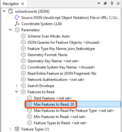

Geocoding services meter requests, so limit your input while testing queries. You can do this through a Sampler, or by setting Max Features to Read on the reader.

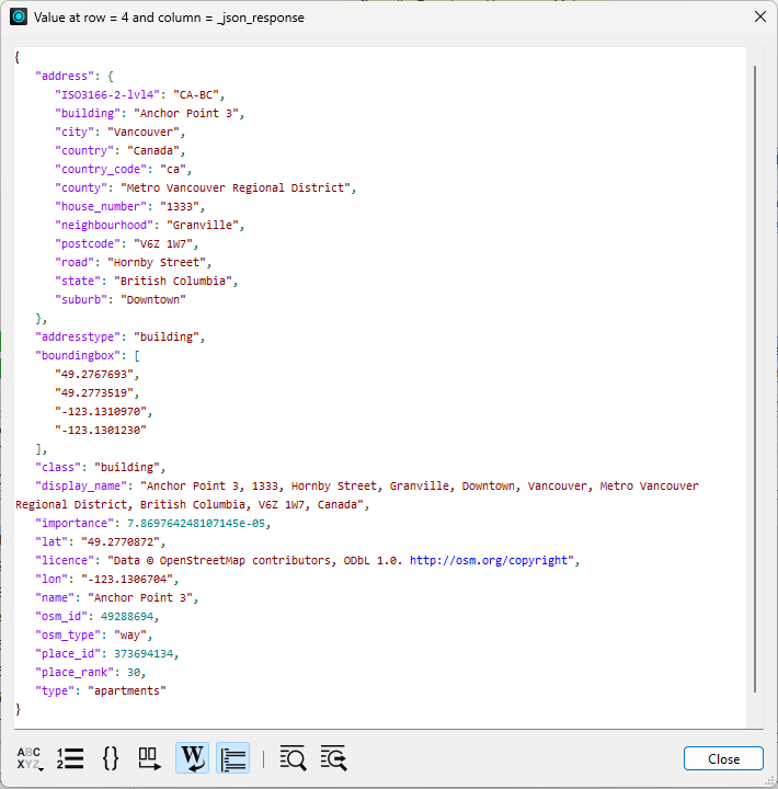

Run the workspace with caching enabled, then click the green eye icon on the Geocoder Output port to view the cached data. Alongside the usual output attributes, an attribute called _json_response now holds the complete response from the service.
Select a feature and preview the _json_response. The address components are nested inside an address object:
Compared to the flat _address string for the same feature, there is much more detail.

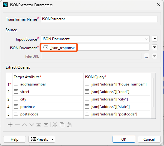

Add a JSONExtractor and connect it to the Geocoder Output port. In the parameter dialog, set the following:
  • JSON Document: _json_response
  • Extract Queries:
    • Query 1:
      • Target Attribute: addressnumber
      • JSON Query: json["address"]["house_number"]
    • Query 2:
      • Target Attribute: street
      • JSON Query: json["address"]["road"]
    • Query 3:
      • Target Attribute: city
      • JSON Query: json["address"]["city"]
    • Query 4:
      • Target Attribute: province
      • JSON Query: json["address"]["state"]
    • Query 5:
      • Target Attribute: postalcode
      • JSON Query: json["address"]["postcode"]

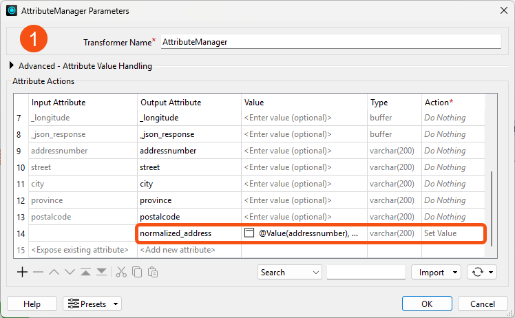

5. Add an AttributeManager

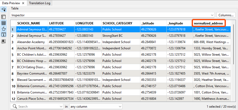

Add an AttributeManager and connect its Input port to the JSONExtractor Evaluated output port. Create a new attribute:
  • Input Attribute: normalized_address
  • Output Attribute: normalized_address
  • Value: @Value(addressnumber), @Value(street), @Value(city), @Value(province), @Value(postalcode)
  • Action: Set Value

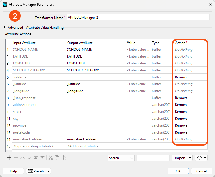

Finally, remove any attributes you don’t need in a second AttributeManager. This leaves each feature with only the attributes you need.
6. Run the Workspace
Move the Inspector from the Geocoder Output port to the AttributeManager Output Port. Run the workspace and inspect the output.
