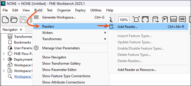

1. Create a New Workspace and add a PostGIS Reader
In a blank workspace, there are a few ways to accomplish adding a reader.
Click on the Reader button on the toolbar
On the top menu bar, click Build > Readers > Add Reader
In FME 2025.1+, you can click on the canvas to add a data source.
In the Search for Transformer window, start typing PostGIS and select PostGIS [Reader]. In the Add reader dialog, select your PostgreSQL database connection. If you do not have this, please see the credentials in the Introduction section.

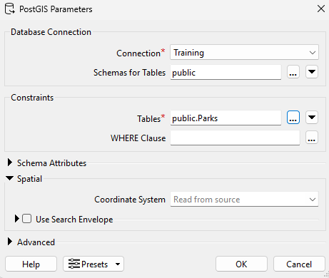

Click on Parameters and set the following:
  • Database Connection:
    • Connection: Training
    • Schemas for Tables: public
      • Click on the ellipses to open the 'Select Schemas for Tables' dialog. You can select the individual tables from here
  • Constraints:
    • Tables: public.Parks
      • Click on the ellipses to open the 'Select Tables' dialog. You can select the individual items from here
Click OK to accept the PostGIS Parameters. Click OK again to finish adding the reader to your canvas.

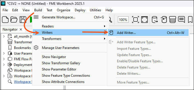

2. Add a FeatureWriter
As with readers, there are multiple ways to add a writer to the canvas.
Click on the Writer button on the toolbar
On the top menu bar, click Build, then select Add Writer.
In FME 2025.1+, you can click on the green + on the canvas and select Destination
In the Search for Transformer or Format window, start typing FeatureWriter and click on it to add it to the canvas. Connect the public.Parks reader to the transformer. Double-click on the FeatureWriter to open the parameters and set the following:
