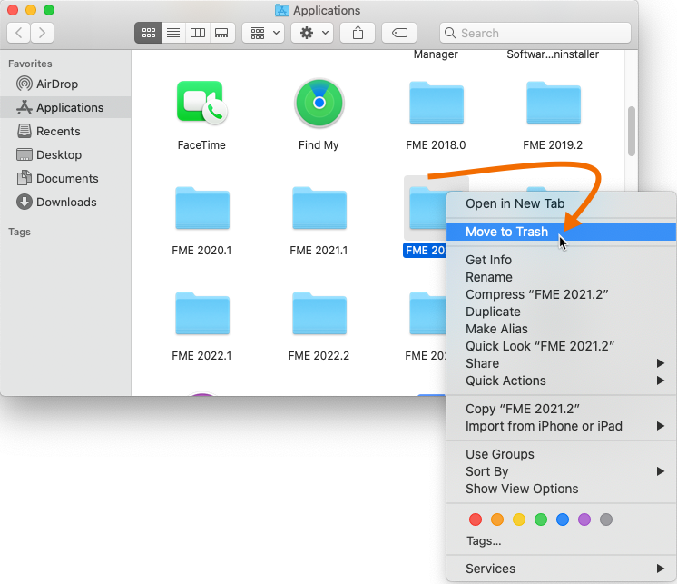

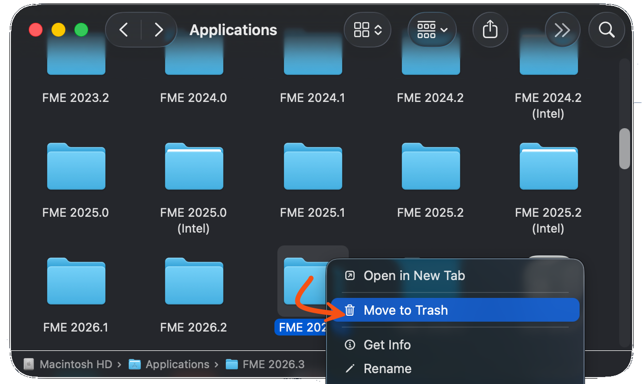

In a Finder window, navigate to /Applications/, then delete the FME <version> folder.

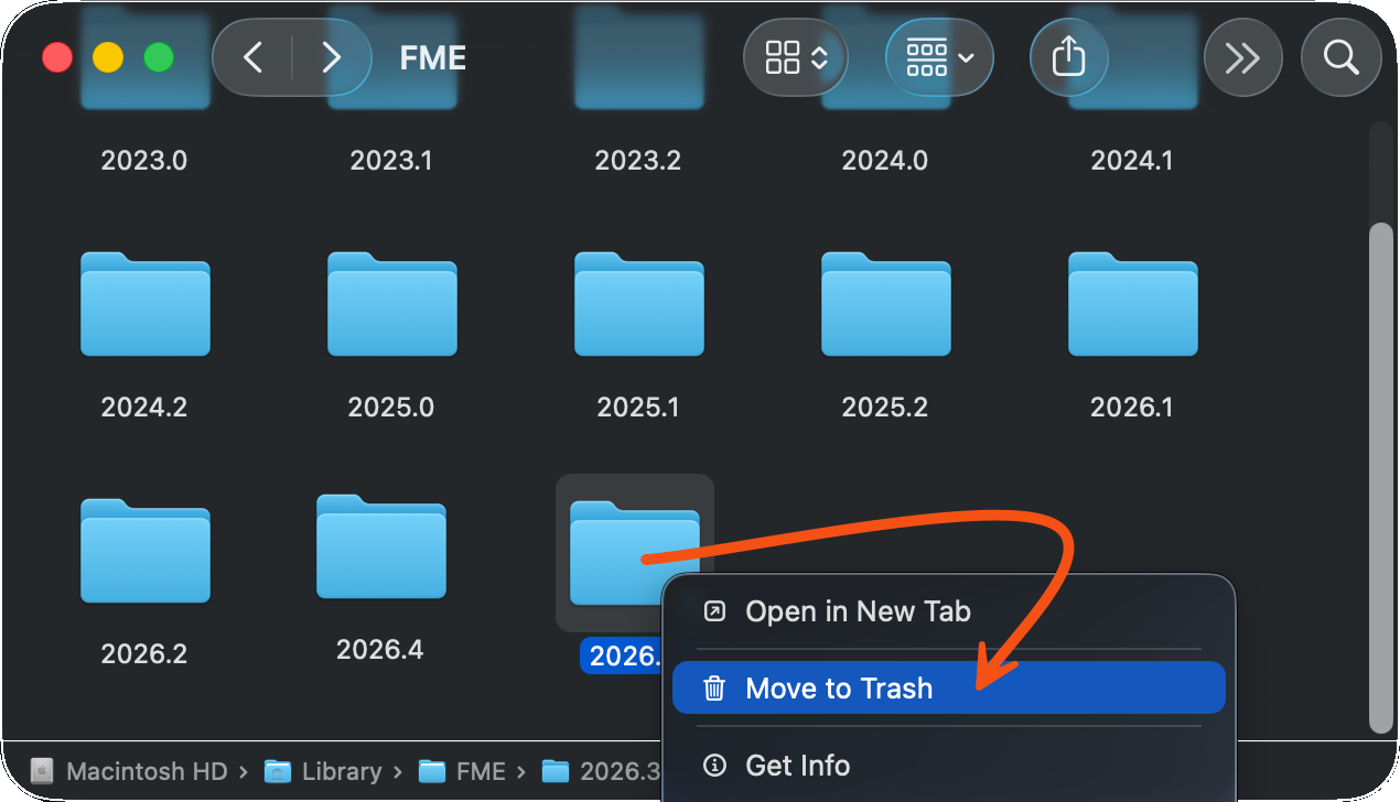

Next, navigate to /Library/FME and delete the <version> folder.

To fully uninstall all versions of FME, first navigate to the /Applications/ folder in a Finder window. Delete all FME <version number> folders.
