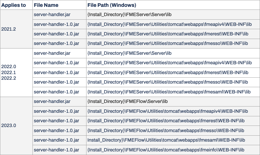

Alternatively, if you are unable to upgrade or update FME Flow, administrators can apply the following patch to any affected version.
Steps:
  1. Stop your FME Flow or FME Server instance.
  2. Download the patch file for the release you are targeting. Patch files are attached to this article.
  3. Navigate to the file paths listed below that are applicable to the release you are patching.
  4. Move the existing server-handler.jar or server-handler-1.0.jar to a safe location.
  5. Place the downloaded patch file where the old server-handler file was. Rename the patch file to match what is shown in the table below.
  6. Start your FME Flow or FME Server instance.
There are 4-6 locations where the patch file needs to be replaced, depending on the release version.
For Windows, they can be found in the directory where you installed FME Server or FME Flow (Releases 2023.0+). This is similar for all other platforms, it will be where FME Flow or FME Server is installed.
Example:
If you are using FME Server 2021.2, download the patch file server-handler-1-2021-2-0-1.jar. In the four locations indicated in the table below, replace the existing server-handler file with the patch file. Then, in each location the file was placed, rename server-handler-1-2021-2-0-1.jar to either server-handler.jar or server-handler-1.0.jar, according to the below table.
