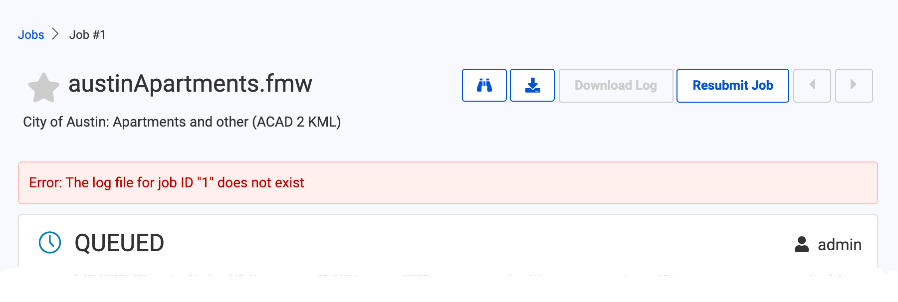

When a job is submitted to run on FME Flow, it can remain listed indefinitely under Jobs > Queued in the FME Flow Web UI. Opening the job details shows an error stating that the log file does not exist.

No Engines are available to run the job. Common causes include:
  • The FME Flow Engines Service is not running.
  • FME Flow is not licensed.
  • The Engines cannot connect.
  • The job was submitted to a user-defined queue with no Engines assigned.
  • The Engines are occupied running other jobs.
This list covers the most common causes. It is not exhaustive.
