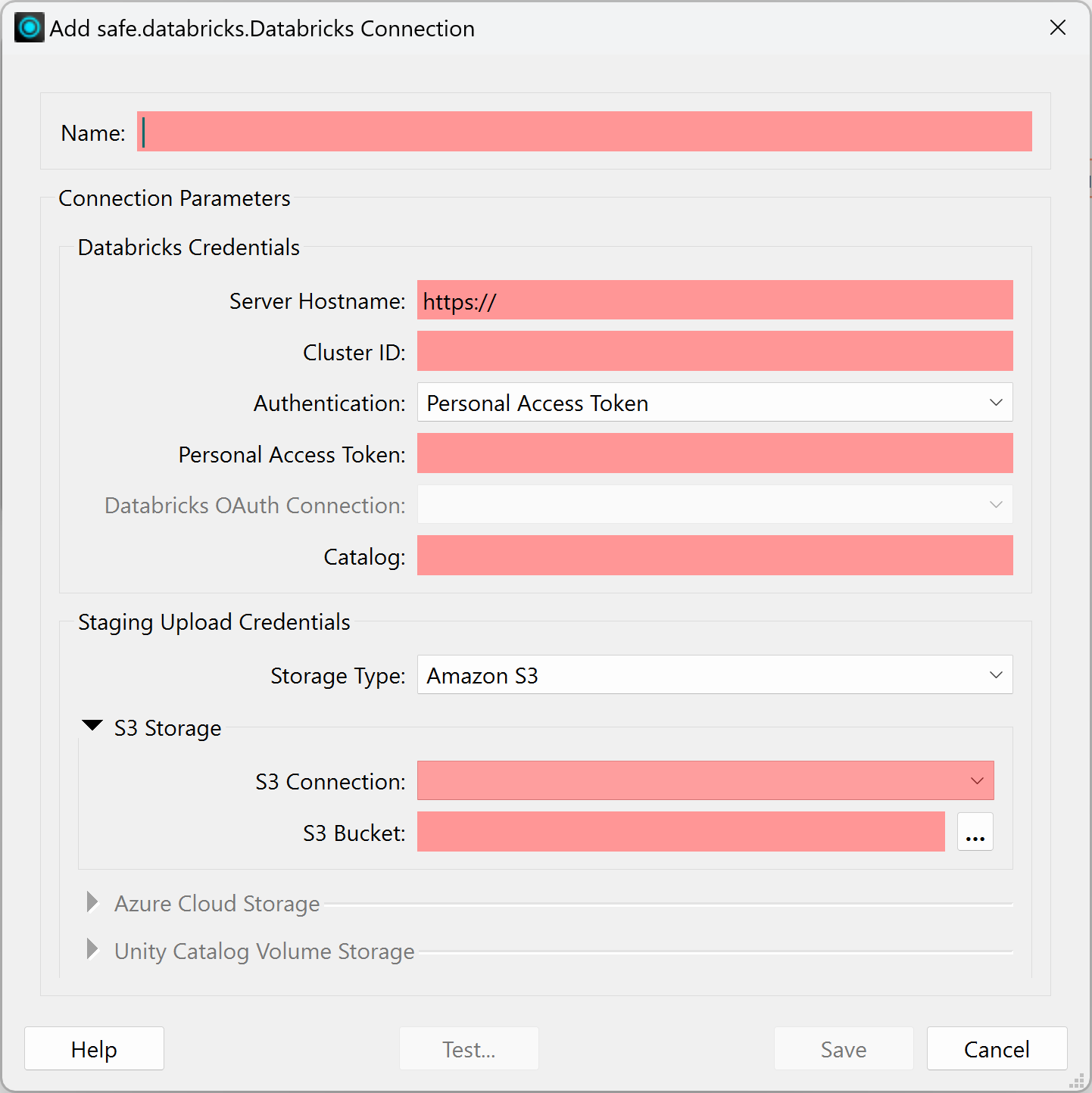

To write to new and existing Databricks tables, you will need to create a Databricks writer connection. When creating a Databricks writer connection, you are required to provide a few different parameters. When creating a Databricks writer connection, the dialog will look as follows:
To fulfill all the Databricks writer connection parameters, follow the next steps.

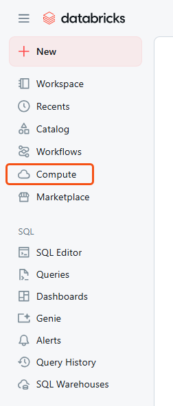

Open your Databricks Workspace in a web browser and go to the Compute tab.

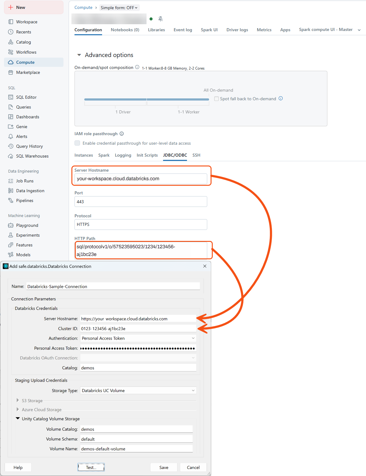

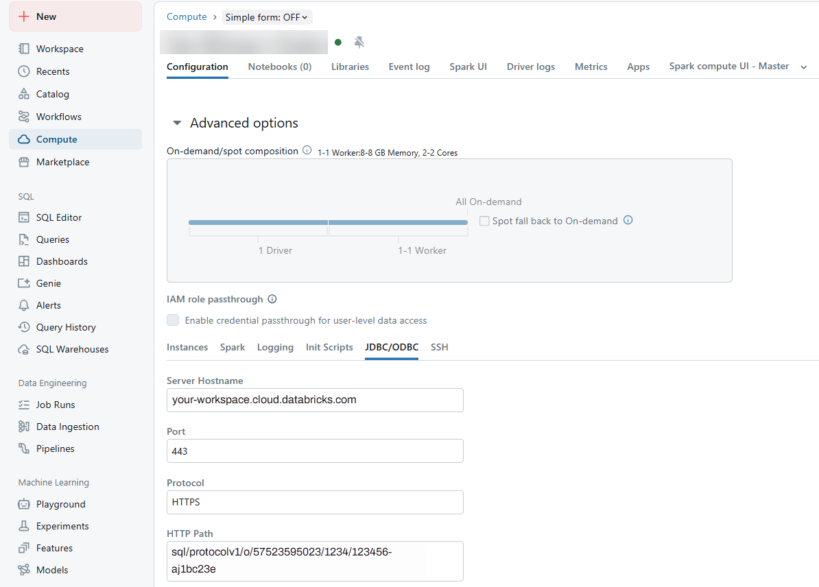

On the Cluster Details page, scroll down to the bottom and expand the Advanced Options. Click on the JDBC/ODBC tab, and you will be presented with the parameters required to create a Databricks writer connection.
Server Hostname
This value is the same value as the Server Hostname parameter with https:// added in front. For example, if the Server Hostname in the Cluster Details is your-workspace.cloud.databricks.com, then the Workspace ID should be set to https://your-workspace.cloud.databricks.com.
Cluster ID
In Cluster Details, this can be found in the HTTP Path as the last set of alphanumeric characters. For example, if our HTTP Path is sql/protocolv1/o/57523595023/0123-123456-aj1bc23e, then the Cluster ID is 0123-123456-aj1bc23e.

When writing features to a table in Databricks, the writer requires a staging location. For the Databricks writer, there is the option to use a Unity Catalog Volume, Amazon S3 or Azure Data Lake Storage Gen2 (ADLS).
If you decide to use Amazon S3 or Azure Data Lake Storage Gen2, your Databricks workspace MUST have access to the cloud storage location you use.
AWS: For instructions on how to connect to an Amazon S3 bucket from Databricks.
Microsoft Azure: For instructions on how to connect to Azure Data Lake Storage Gen2 from Databricks.
Storage Type
For cloud storage type, you can select Amazon S3, Microsoft Azure Data Lake Gen 2, or Databricks UC Volume.
S3 Storage
If you selected Amazon S3, you will need to fulfill two parameters.
S3 Connection:
  • Create a new (or use an existing) AWS Web Connection. See Working with Amazon Web Services for more information.
S3 Bucket:
  • Enter the name of the S3 bucket you want to use as a staging location. The name must match exactly.
Azure Cloud Storage
If you selected Azure Cloud Storage, you will need to fulfill the following parameters:
Cloud Authentication Method:
  • Web Connection - allows you to connect via a Web Connection in FME
  • Microsoft SAS - allows you to connect via a Shared Access Signature (SAS)
Azure Data Lake Container:
  • Enter the name of the Azure Data Lake Container you want to use as a staging location.

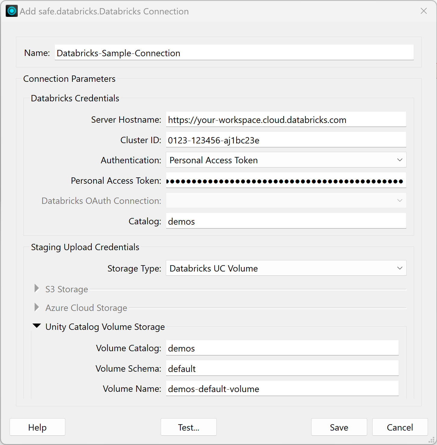

Using a Unity Catalog Volume as our Staging Location in this example, the Databricks web connection would look something like the following:
Click Test… to check that the connection is valid. Click Save to save the connection for future use.
Below is a visual representation of where the corresponding parameters are located in Databricks.
