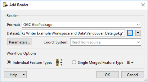

Add a reader to the workspace by clicking the “Add Reader” button in the toolbar. Enter the following parameters:
  • Format: OGC GeoPackage
  • Dataset: Vancouver_Data.gpkg

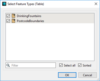

Click OK, then in the Select Feature Types dialog, select both PostcodeBoundaries and DrinkingFountains. Click OK.

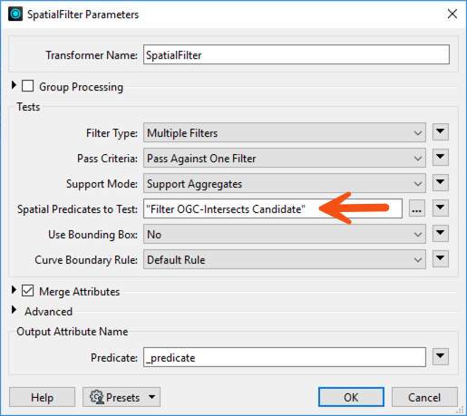

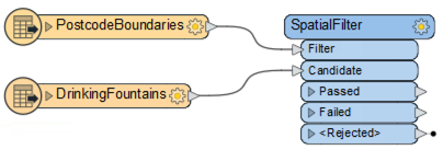

We want to perform a spatial intersect between the two feature types to see which PostcodeBoundaries the DrinkingFountains fall within. To do this, we can add a SpatialFilter to the workspace. Connect the DrinkingFountains reader feature type to the Candidate port. Connect the PostcodeBoundaries reader feature type to the Filter port.
Open the SpatialFilter parameters. Set the Spatial Predicates to Test parameter to “Filter OGC-Intersects Candidate”. Leave the rest of the parameters as the defaults. Press OK to accept the new parameters and close the transformer.

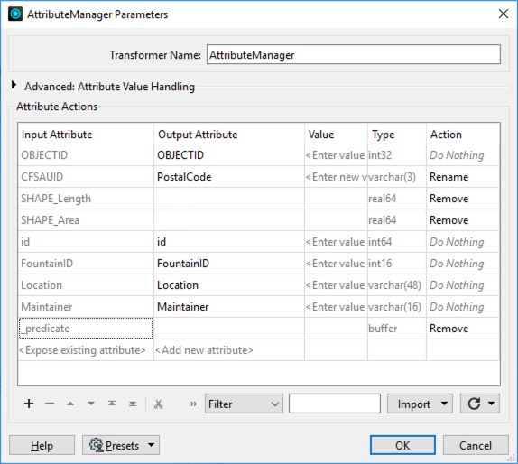

Add an AttributeManager to the workspace and connect the SpatialFilter Passed output port to it.
Open the AttributeManager parameters. Remove the SHAPE_Length, SHAPE_Area, and _predicate attributes by clicking on each Input Attribute and clicking the “-” button to remove them.
Rename the CFSAUID attribute to “PostalCode” by clicking on the Output Attribute named CFSAUID and renaming it. Press OK to accept the new parameters.

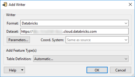

Add a writer to the workspace by clicking the “Add Writer” button in the toolbar. Enter the following parameters:
  • Format: Databricks
  • Dataset: <your_databricks_connection>
  • Table Definition: Automatic…

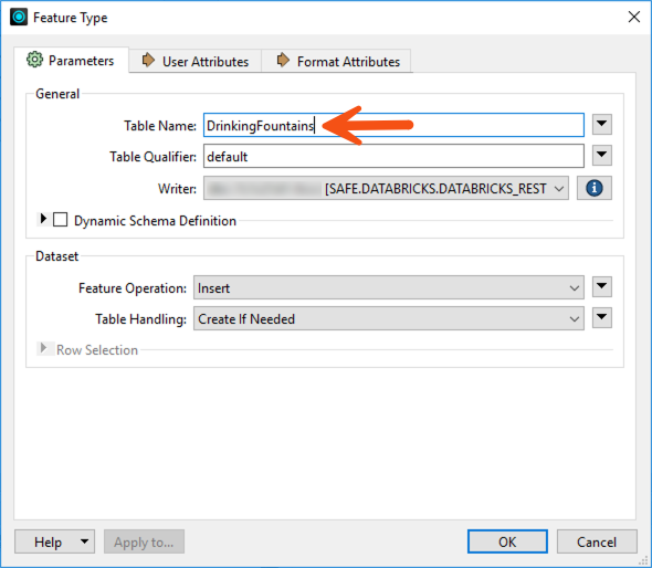

Press OK to add the writer to the workspace. In the Feature Type dialog that pops up, set the Table Name to DrinkingFountains and press OK. Connect the AttributeManager output port to the DrinkingFountains writer feature type.

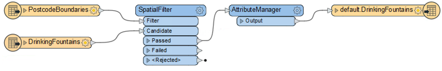

With the writer added to the workspace, you can now run it to see the table created in Databricks. The final workspace should look like this:
By default, the schema is set to "default". If you are using a different schema name, open the Databricks writer feature type and change the Table Qualifier.

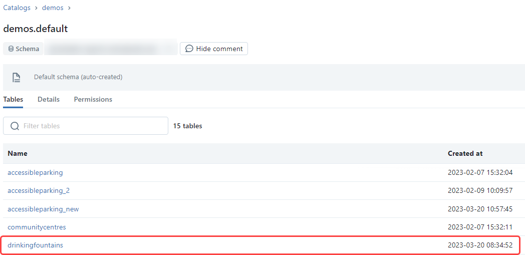

7. View the Output in Databricks
Now go to the Data Explorer page in your Databricks Workspace. We can see that the DrinkingFountains table was uploaded as a new Delta Table.
