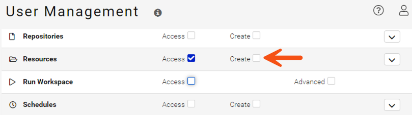

1. FME Flow administrators can limit the permissions of Roles or individual User Accounts.
  • Select any Role or User Account on the User Management pages in the Web Interface and remove the ‘Create’ permission for Resources.
  • This will also limit the ability for users to create AWS S3 Resource Connections.
