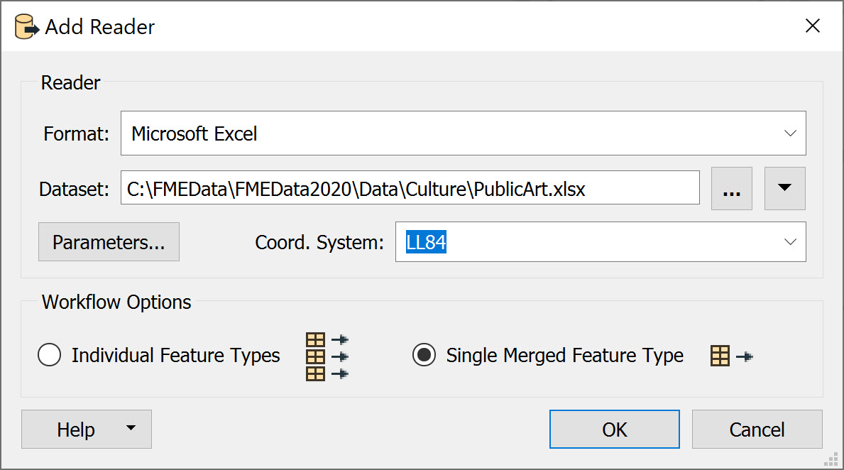

In a blank workspace, add a Microsoft Excel Reader to the canvas. Browse to the PublicArt.xlsx file, set the Coordinate System to LL84, and the Workflow Options to Single Merged Feature Types.
As of FME 2025.2, the Coordinate System parameter is now configured within the Parameters dialog of each reader/writer format. For more information, including details about the change and affected transformers, please see Coordinate System Parameter Location Change.

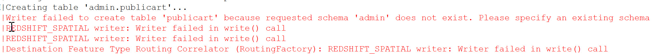

Save the Workspace and then run it. If you get the following error message, ensure that you have the correct schema name, or the credentials used in your connection have sufficient privileges:
