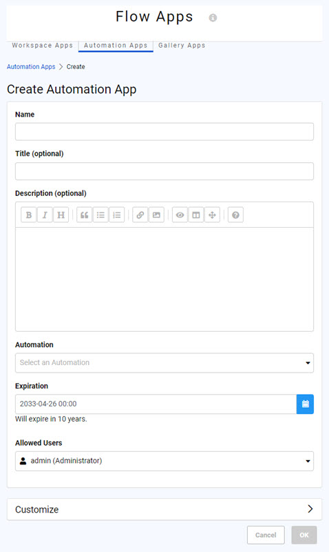

There are a few parameters you will need to configure when creating your Automation app.
  • Name: Provide a name for the app. The name appears on the app's run page and will also be part of the run page URL. App names are case-insensitive. The name will appear as <Name> Automation app on the run page.
  • Title (optional): The title will be displayed at the top of the app in the browser tab.
  • Description (optional): Provide a description or additional information about the app. The body text will appear below the name on the run page.
  • Automation: Select an Automation with Manual Trigger. Ensure the Automation is started.
  • Expiration: FME Flow generates a token that is used to authenticate the Automation app. The token automatically has the necessary permissions required for the user to run the application. You can set the expiration date for the app's security token. After the token expires, the Automation app will no longer run. The default expiration is 10 years from the current date.

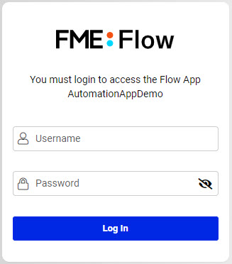

  • Allowed Users: All Automation apps require the creator to specify which users are allowed access to run the application. When a user visits the FME Flow Automation app URL, they must log in to FME Flow before seeing the run app page. Access to the app is restricted to authorized FME Flow Users in the specified Roles.

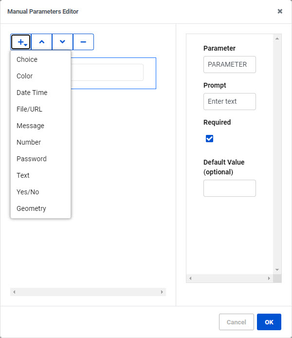

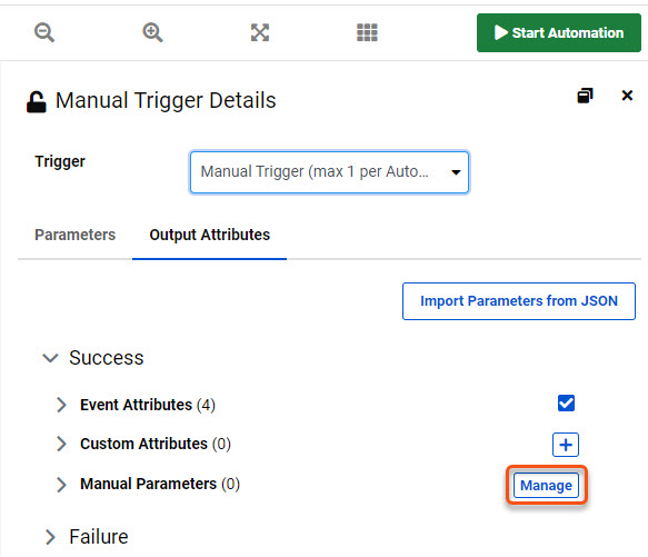

Automation apps enable complex workflows to be run “on-demand” with configurable input parameters. The manual trigger in Automations can now be configured to prompt you with a list of parameters generated from the existing manual parameters. The manual parameters will appear as input parameters on the Automation Apps page. To create manual parameters, go to Automations > Manual Trigger > Output Attributes > Success > Manual Parameters > Manage. See Manual Trigger and Output Attributes for more details.
Once you select Manage, a pop-up window of the Manual Parameters Editor will appear. The left panel allows parameter management, and the right panel allows defining parameter properties. To define Manual Parameters, click the + button to add a Parameter. The Manual Parameters that are supported include Choice, Color, Date Time, File/URL, Message, Number, Password, Text, Yes/No, and Geometry. Properties include Parameter (required), Prompt (required), a Required checkbox, Default Value (optional), and any additional parameters based on the Parameter type. Parameters must be unique in naming convention. In the left panel, you can arrange the ordering of parameters with the up and down arrows or by drag and drop.
The left-hand side of the Manual Parameters Editor is where all of your created parameters are shown, as well as options to add new ones, reorder, and delete. The right-hand side is where you can set the properties for the newly created or selected Parameters.

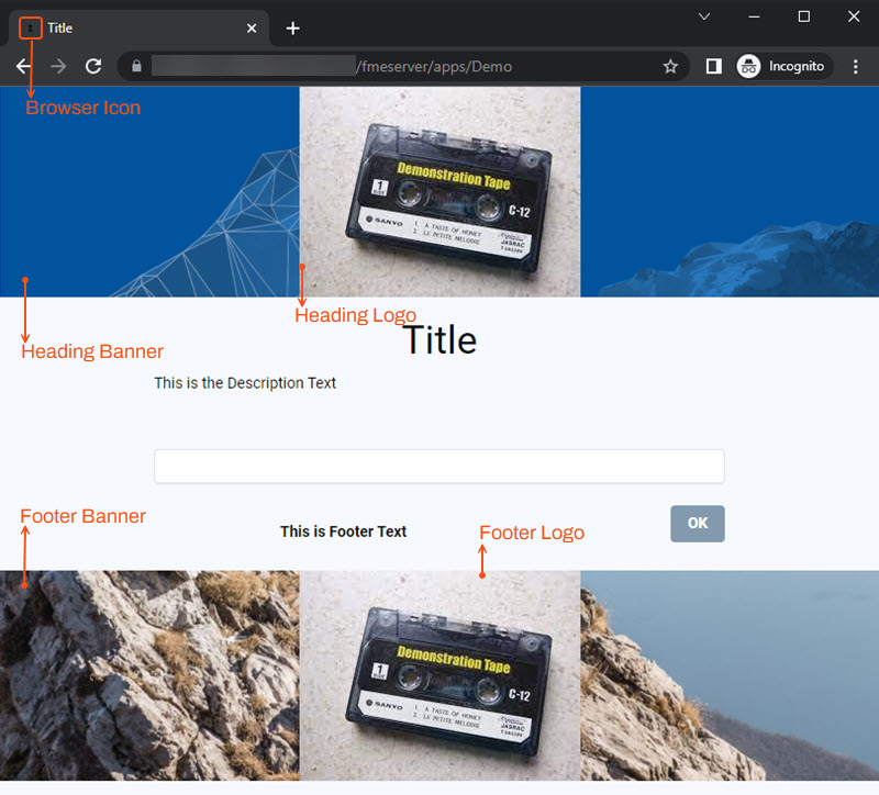

  • The look and feel of your Automation app can be tailored to your organization’s colors, logo, and images. The parameters below used to customize the application run page are all optional.
    The Icon, Logo, and Banner parameters only support JPEG and PNG file formats.
    a. Browser Icon (optional): The icon will be visible in the browser tab. There is a 300 KB file size limit for icon images.
    b. Heading Background Color (optional): You can configure the banner's background color at the top of the app page. If it is transparent, it appears behind the Heading Banner.
    c. Heading Logo (optional): This will appear above the Heading Banner and Heading Background Color. The image has a 1 MB file size limit.
    d. Heading Banner (optional): This image will appear at the top of the app page. If transparent, it will be placed over the Heading Background Color. The image has a 1 MB file size limit.
    e. Footer Text (optional): The text appears below the links on the app page.
    f. Footer Logo (optional): This appears beneath the Footer Text and behind the Footer Banner if it is transparent. The image has a 1 MB file size limit.
    g. Footer Banner (optional): An image to comprise the banner at the bottom of the app page. If transparent, it appears over the Footer Logo. There is a 1 MB file size limit for the image.
    h. Run Immediately: Option to configure the Automation app to run immediately once the URL is invoked without displaying a run page.
Here are examples of an Automation app with and without a customized run page.

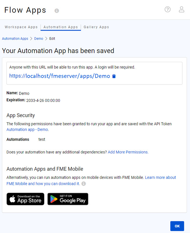

Click OK, and a message will appear indicating that the app has been created and includes its corresponding URL. You may click the Copy icon to copy the URL. To run the app, click the URL. Once your Automation app is created, the security token can be accessed on the API Tokens tab of the Token Management page

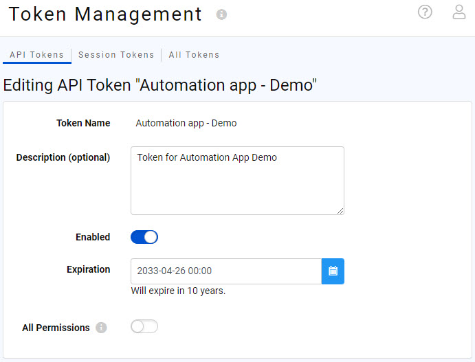

Another option to manage the expiration of an Automation app is via the ‘Token Management’ page. This is because the expiration is managed by the token that authorizes the usage of the app. To access the Token Management page, click ‘Manage tokens’ from the ‘User Settings’ dropdown (top right of the FME Flow Web Interface). On the ‘Token Management’ page, you should see the token created for your app. Click it to edit its parameters. On the page, you can edit the token description, enable or disable the token (disabling the token will disable your app), and change the expiration date.

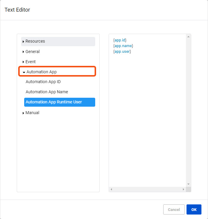

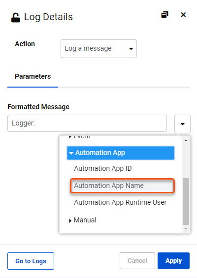

Automation app parameters become accessible after creating an Automation app from an Automation. Once the app is created, any Action downstream from the Manual Trigger can use Automation app parameters. Inside the Action details, find them in the drop-down menu next to a parameter. Automation App is listed alongside other parameter types, such as Manual and Event. Expand Automation App to find the three parameters.
Automation app parameters may also be selected from the Text Editor's sidebar.

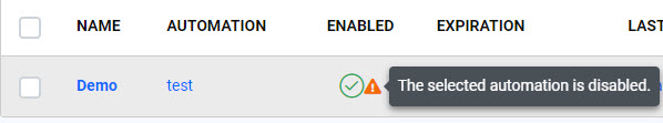

  • If you receive a warning message that says, ‘The selected automation is disabled,’ your app may be enabled, but the Automation it runs may not have been started. Please start the Automation by going to Automations > Manage Automations >  Select the Automation and click Actions > Start.
