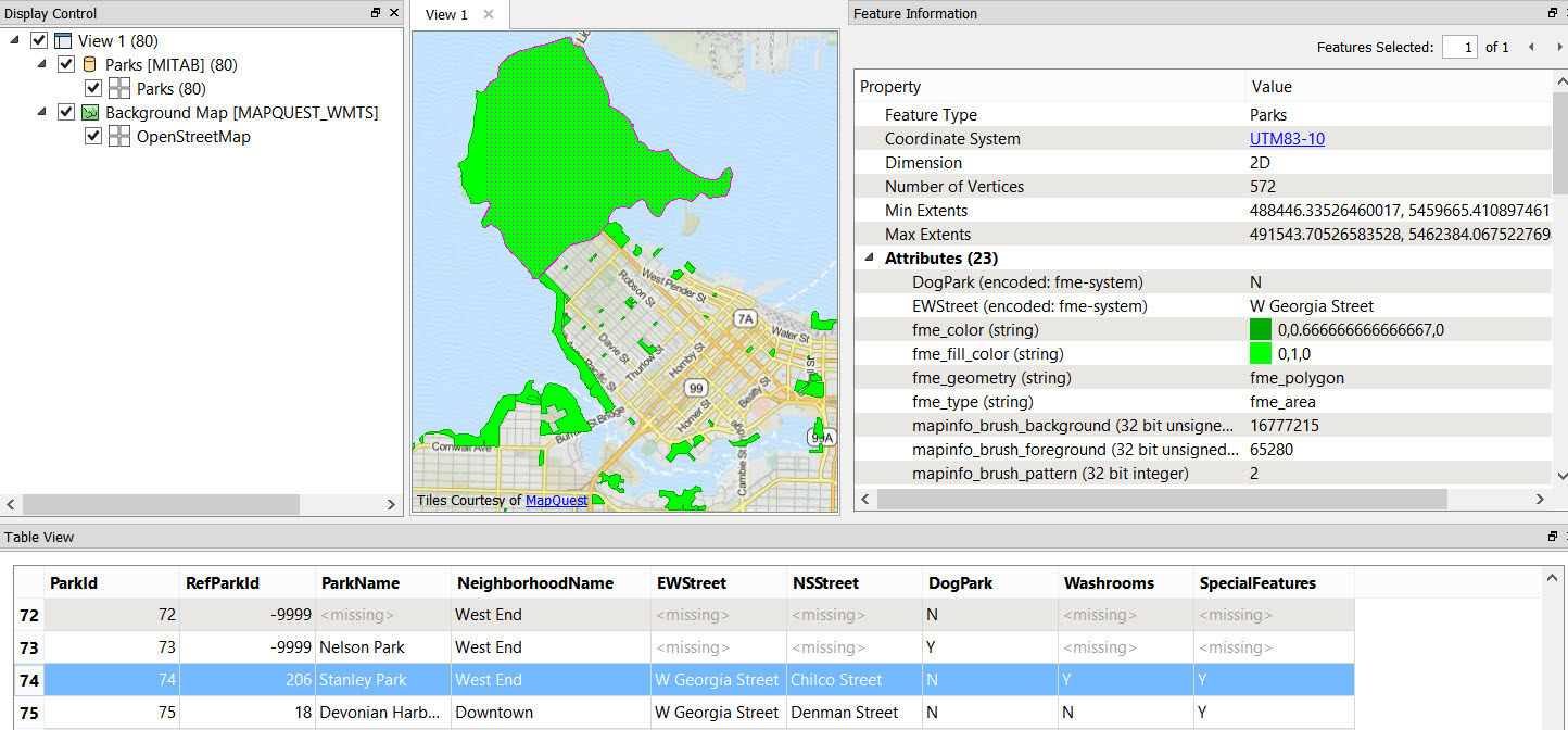

Parks.tab data is read with the MapInfo TAB reader. The dataset contains a number of attributes related to information about the parks, such as park name, whether the park has washrooms, a dog park, or other special features.

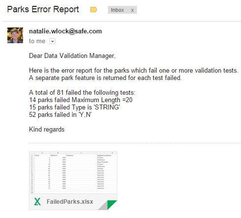

4. Email the Failed Parks Report
Email the failed features report, FailedParks.xlsx, to the Data Validation Manager using the Emailer transformer. The Emailer transformer must be configured to use your from and to email addresses.
  • Attachments: path to FailedParks.xlsx error report spreadsheet
  • Configuration for the SMTP Connection section if Gmail is used
  • Sender Authentication: If you have a Gmail/Google account with two-step verification, you will need to generate an App-specific password for the Emailer. If you don’t have 2-step authentication, you may allow less secure apps to access your Gmail account
  • Once the email is received, the data validation manager can perform data validation and quality assurance on the parks dataset
