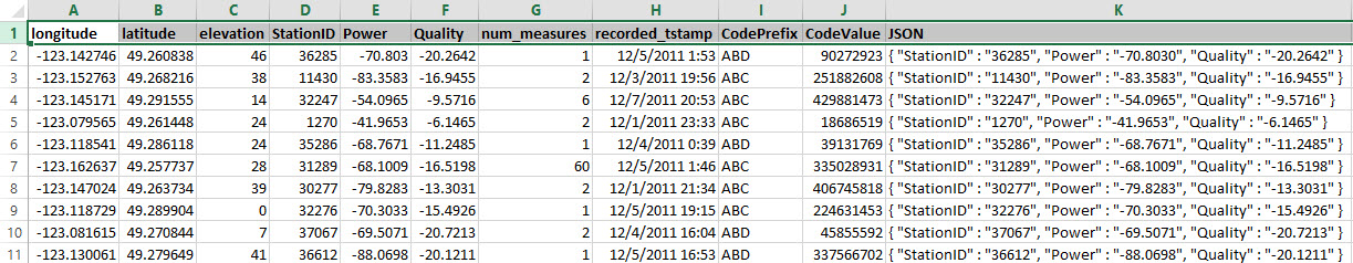

We’ll work with cell phone signal data and validate it for loading into a simple database, generating a validation report as a CSV file.
Here’s the source data:

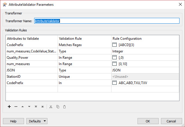

AttributeValidator: Obviously, the key part of this workspace. The validation tests have been configured as shown in the AttributeValidator annotation and are shown below:
Most of the tests are self-explanatory.
  • CodePrefix: We’ve created two tests that perform the same function, primarily for illustrative purposes. The first uses the IN operator (ensure the CodeName is in the list ABC, ABD, TXU, TXV) and regular expressions (ensure that the CodePrefix only has the 3 characters, which can be ABC or D)

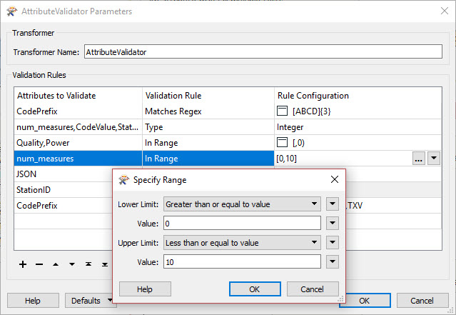

  • Quality, Power: range test. A range assignment dialog helps set up the ranges:
The syntax is ‘[‘ means inclusive (greater than or equal to), ‘(‘ means exclusive (greater than) . So [0,10) means “greater than or equal to 0 and less than 10”. The same syntax can be used with the IN operator to set a range.

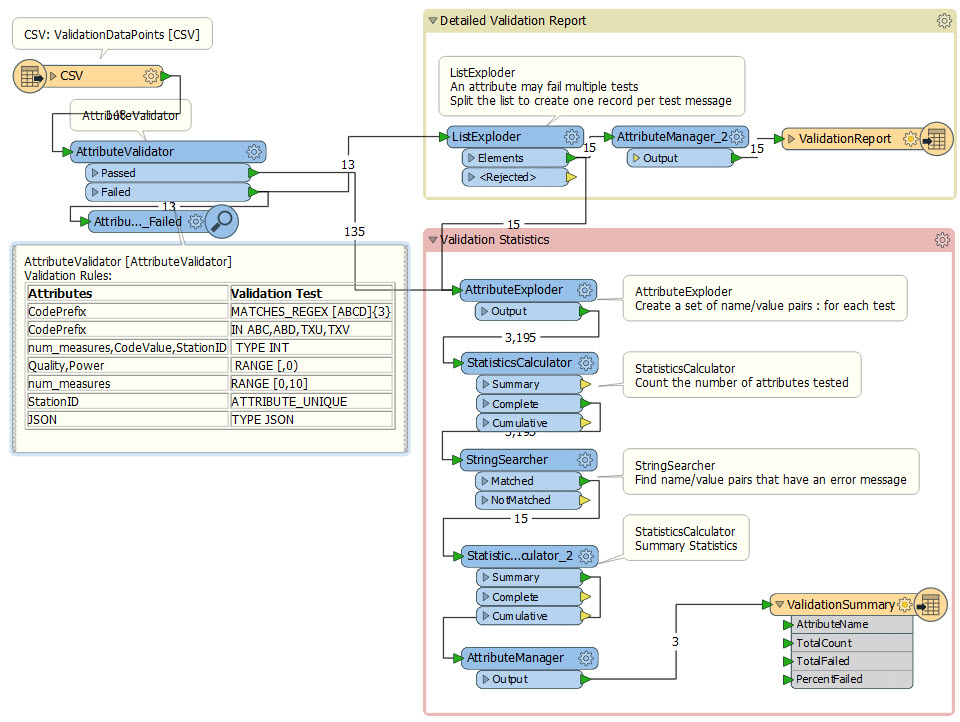

Once you have configured the AttributeValidator, you can configure the workspace to generate a validation report or statistics. Referring to the bookmarks in the workspace:

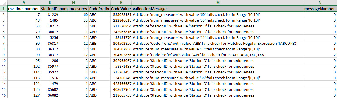

Data Validation Report: The transformers in this bookmark create a list of all the error messages and write to a CSV file. If there are multiple error messages, as above, ListExploder will split the feature into one feature per message (creating three records for the error illustrated above).
Validation Statistics: This bookmark summarizes the errors using the StatisticsCalculator. ISO 19000 standards address data quality for datasets. This bookmark illustrates how you might start to configure FME to conform to ISO19114, where the standard discusses how the data quality test might be used to pass or fail a dataset based on different data quality measures, such as:
  • Boolean: any error causes a failure of the dataset
  • Number of commissions: a  specific number of test failures causes the dataset to fail
  • % of commissions: a percentage of test failures causes the dataset to fail
In this example, we’re calculating the percentage of failures.
AttributeValidator can be paired with the GeometryValidator to give complete validation of your spatial and non-spatial data. You can use the AttributeValidator in conjunction with the FeatureWriter. If the data fails validation, you can roll back the load if the dataset does not meet the set pass criteria. Typically, you’d have one AttributeValidator per feature type in your workspace.

Run the workspace and inspect the results. The output from the Failed port of the AttributeValidator is shown above. The output from the workspace is two CSV files:
  • Detailed failure messages (some of the columns have been hidden)

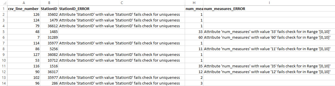

The second example workspace, AttributeValidatorExample_pivot.fmw, introduces an alternative report format. This workspace pivots the error report so that each feature has a summary of all the attribute errors (some columns have been hidden for clarity):
