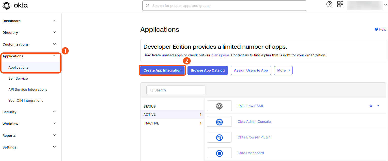

1. Create an App in OKTA
 Open OKTA, in the Admin Console, go to Applications > Applications, and Click Create App Integration.1.png

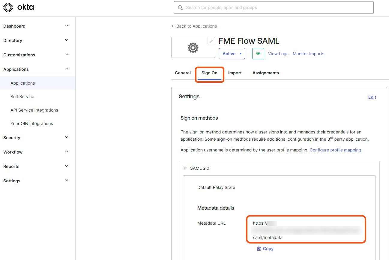

3. Save Metadata
On the application page, go to the “Sign on” tab settings and copy and paste the Metadata URL into your web browser to open the Metadata XML file. Right-click and Save As XML document.

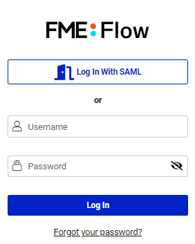

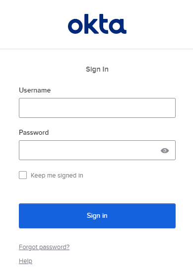

1. Log Out of FME Flow
Log out of FME Flow and you should now have the option to Log In With SAML.  Once selected, you should be prompted with the OKTA Sign-in page, proceed with entering your credentials, and if the configuration is correct, you should be redirected back to the FME Flow home page.
Confirm that the user can log in and that the role and user information is as expected.
