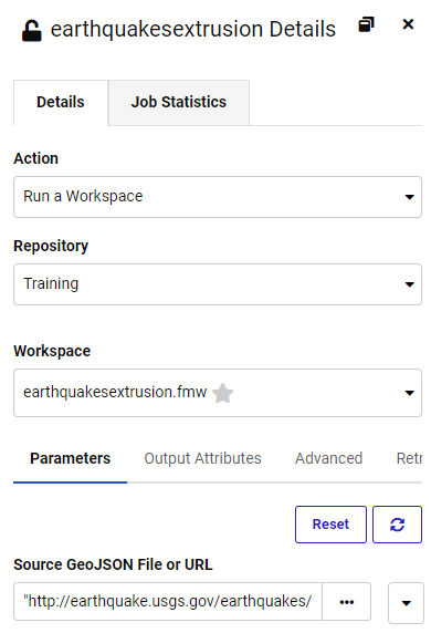

2. Configure a Workspace Action
Click on the plus icon to open the component menu and then add an action. Connect it to the success port on the Manual Trigger. Open the parameters and ensure Action is set to Run Workspace. Next, set the Repository to Samples and select the earthquakextrusion.fmw workspace. This can be any action but in this example, we are going to run a workspace.

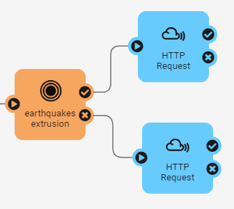

Click on the plus icon and add an external action. Configure it for an HTTP Request (send). Additionally, you could send a separate HTTP Request for failed runs by connecting another external action to the x port on the workspace action.

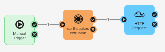

4. Save and Run the Automation
The automation should look similar to the image below. Depending on the trigger and action chosen, the text will be different
