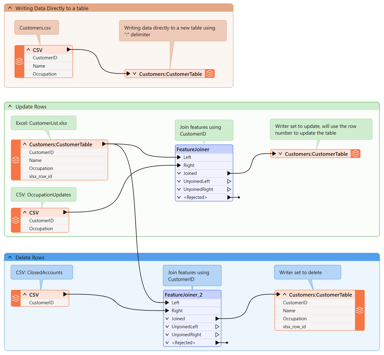

The completed workspace in the Files section has three bookmarks, one for each part. Follow the part that matches the task, or open the workspace to see how each example is set up.

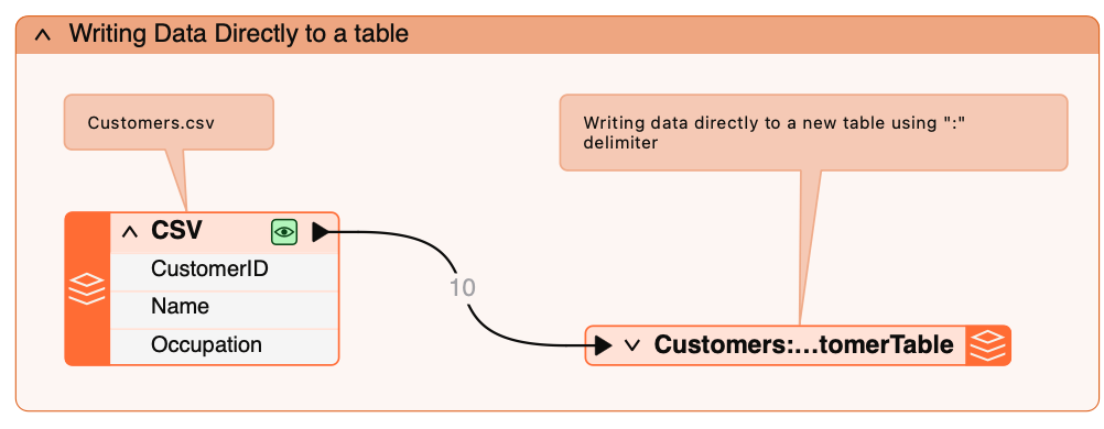

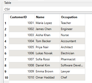

In Part 1, you will read a CSV file of customers and write the records to a new table called CustomerTable on a sheet called Customers. Each customer has a CustomerID, Name, and Occupation. You do not need a template file. If the table does not exist, the writer creates it.
1. Add a CSV Reader
Open FME Workbench and start a new workspace. On the top menu, click Add Reader. In the Add Reader dialog:
  • Format: CSV (Comma Separated Value)
  • Dataset: Customers.csv

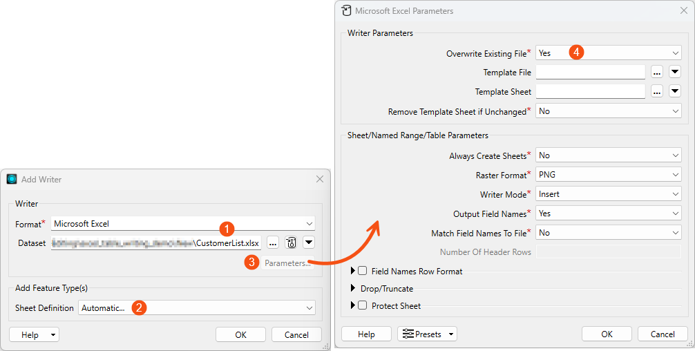

2. Add a Microsoft Excel Writer
Click the Writer button from the Toolbar. In the Add Writer dialog:
  • Format: Microsoft Excel
  • Dataset: CustomerList.xlsx
  • Sheet Definition: Automatic
  • Parameters:
    • Overwrite Existing File: Yes
Leave Template File empty. You do not need a template to write to a table. Click OK.

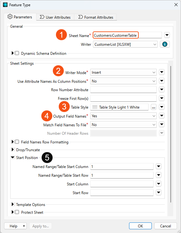

3. Set the Table Name and Style
In the Feature Type dialog, set the sheet name so that it points to a table instead of a sheet:
  • Sheet Name: Customers:CustomerTable
  • Sheet Settings:
    • Table Style: Choose any style from the list
    • Output Field Names: Yes
  • (Optional) Start Position:
    • Named Range/Table Start Column: 1
    • Named Range/Table Start Row: 1
The colon tells the writer to write to a table called CustomerTable on the Customers sheet. If the table does not exist, the writer creates it at the start column and start row. If the table already exists, the writer uses the existing table and ignores the start column and start row.
The writer uses the feature type name to decide where to write:
  • Customers writes to a sheet.
  • Customers:CustomerTable writes to a table in the Customers sheet.
  • Customers/CustomerRange writes to a named range in the Customers sheet.
Use a table when people will sort, filter, or add rows in Excel. Use a named range when a template file has charts or pivot tables that refer to a fixed block of cells.

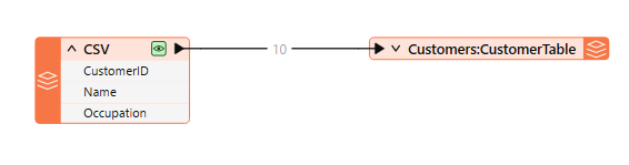

Click OK, then connect the writer feature type to the CSV reader feature type.
4. Run the Workspace and View the Output

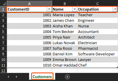

Save and run the workspace. Open CustomerList.xlsx in Microsoft Excel. The Customers sheet contains a table called CustomerTable with 10 customers. The header row has filter buttons, and the Table Design tab shows the table name and style.

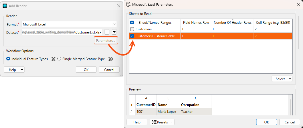

1. Add a Microsoft Excel Reader
Add a Reader and in the Add Reader dialog, set:
  • Parameters:
    • Select Feature Types (Sheet): Customers:CustomerTable
Click OK.

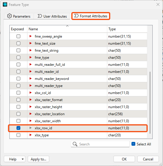

The reader feature type is named Customers:CustomerTable. Each feature has an xlsx_row_id attribute that stores its row number. The writer uses this value to find the row to change.
To expose the xlsx_row_id attribute, double-click the Excel reader. In the dialog:
  • Format Attributes:
    • xlsx_row_id: Enabled

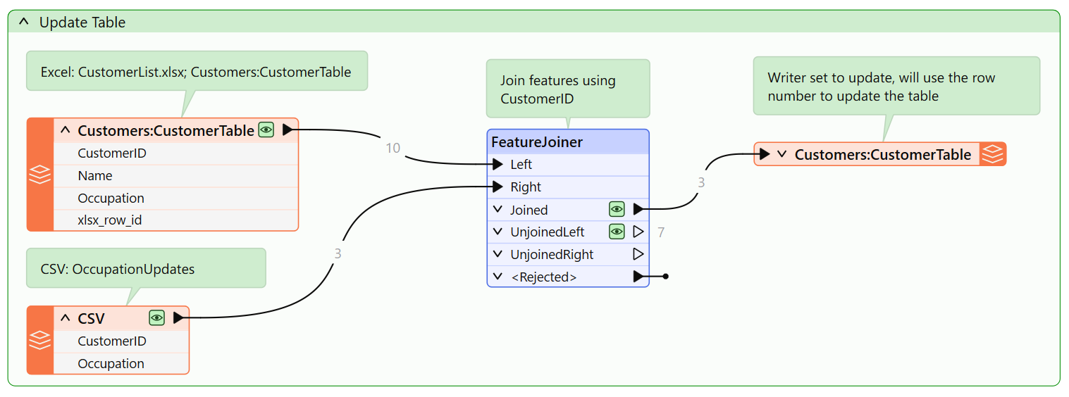

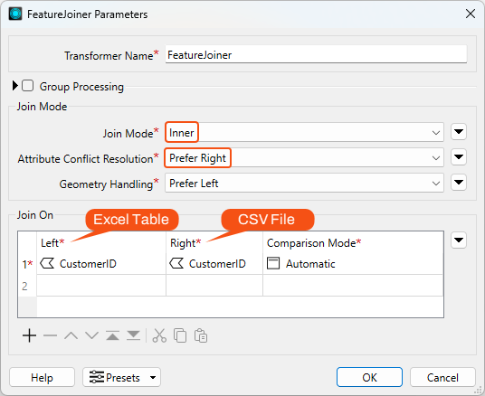

3. Add a FeatureJoiner

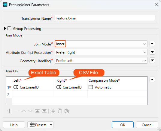

Add a FeatureJoiner to the canvas. Connect the Customers:CustomerTable reader feature type to the FeatureJoiner Left input port. Connect the OccupationUpdates reader feature type to the Right input port. Double-click the FeatureJoiner and set the following:
  • Join Mode: Inner
  • Attribute Conflict Resolution: Prefer Right
  • Join On:
    • Left: CustomerID
    • Right: CustomerID
Click OK.
Only the three customers in OccupationUpdates.csv leave the Joined port. Each joined feature keeps xlsx_row_id from the table and takes the new Occupation value from the CSV file.
4. Add a Microsoft Excel Writer in Update Mode
Add a Writer and in the Add Writer dialog, set:
  • Parameters:
    • Overwrite Existing File: No

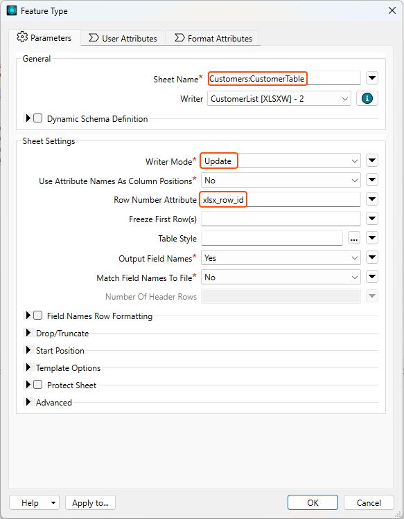

Click OK. In the Feature Type dialog:
  • Sheet Settings:
    • Writer Mode: Update
    • Row Number Attribute: xlsx_row_id
In Update mode, the writer uses the row number in xlsx_row_id to find each row. It then replaces the cell values with the values on the feature. If an attribute is missing from the feature, the existing cell value is kept.
Click OK, then connect the writer feature type to the FeatureJoiner Joined output port.

Part 3: Delete Rows from an Existing Table

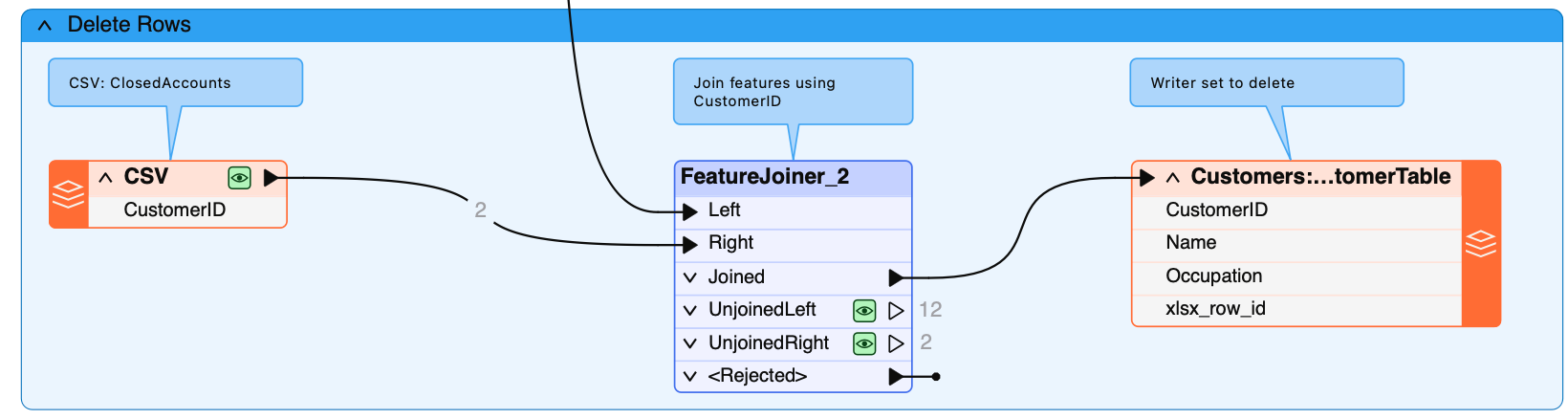

Two customers closed their accounts, listed in ClosedAccounts.csv. In Part 3, you will match those customers to their rows in the table and delete them. The steps are the same as in Part 2, but the writer uses Delete mode instead of Update mode.
1. Add a CSV Reader for the Closed Accounts
Close CustomerList.xlsx in Microsoft Excel. Continuing from the Part 2 workspace, add another reader. In the Add Reader dialog, set:
  • Dataset: ClosedAccounts.csv
Click OK. This file has one attribute: CustomerID.

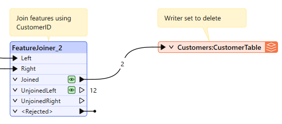

2. Add a Second FeatureJoiner
Add another FeatureJoiner to the canvas. Connect the Customers:CustomerTable reader feature type to the Left input port. Connect the ClosedAccounts reader feature type to the Right port. Double-click the FeatureJoiner and set the following:
  • Join Mode: Inner
  • Join On:
    • Left: CustomerID
    • Right: CustomerID
Click OK. Only the two closed accounts leave the Joined port, each with its xlsx_row_id.
3. Add a Microsoft Excel Writer in Update Mode
Repeat Step 4 from Part 2 of this tutorial, except this time use Delete as the Writer Mode.
  • Parameters:

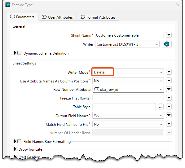

  • Sheet Settings:
    • Writer Mode: Delete
In Delete mode, the writer uses the row number in xlsx_row_id to find each row and deletes it from the table.
Click OK, then connect the Excel writer to the FeatureJoiner Joined output port.
5. Run the Workspace and View the Final Table
Save and run the workspace. Open CustomerList.xlsx in Microsoft Excel. Customers 1004 and 1007 are removed, and the table now has 8 rows. The occupation updates from Part 2 are still in place.
