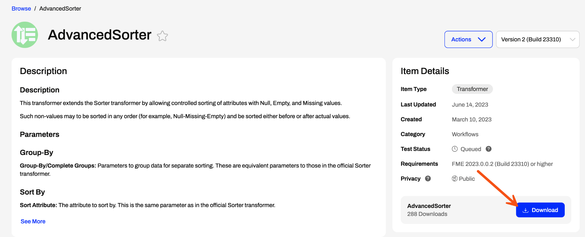

2. Download Transformer
Log into FME Hub and go to the transformer’s page. Click the Download button.

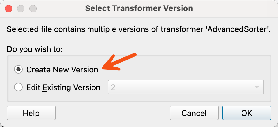

3. Open .fmx in FME
Open the transformer’s .fmx file in the version of FME you wish to deprecate it in.
In the Select Transformer Version dialog, ensure Create New Version is enabled, then click OK.

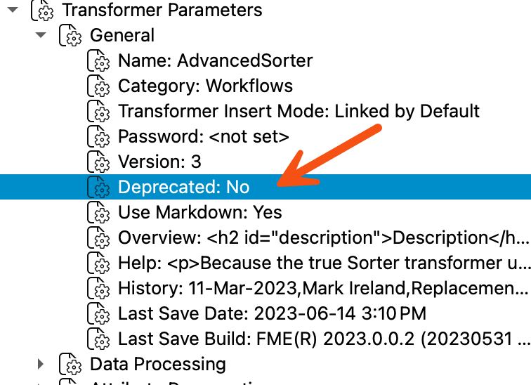

4. Set Deprecated Parameter
In the Navigator, expand Transformer Parameters > General, then double-click on Deprecated to open the parameters.
  • Deprecated: Yes

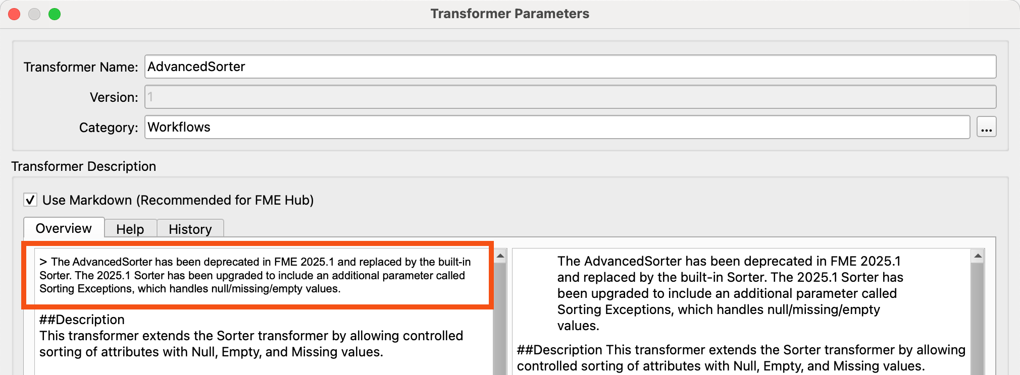

5. Update Overview and History
As best practice, it is advised to update the transformer’s Overview and History about any replacements and who/why the transformer was deprecated.
Double-click on Overview in the Navigator to open the parameters.
For this example:
The AdvancedSorter has been deprecated in FME 2025.1 and replaced by the built-in Sorter. The 2025.1 Sorter has been upgraded to include an additional parameter called Sorting Exceptions, which handles null/missing/empty values.

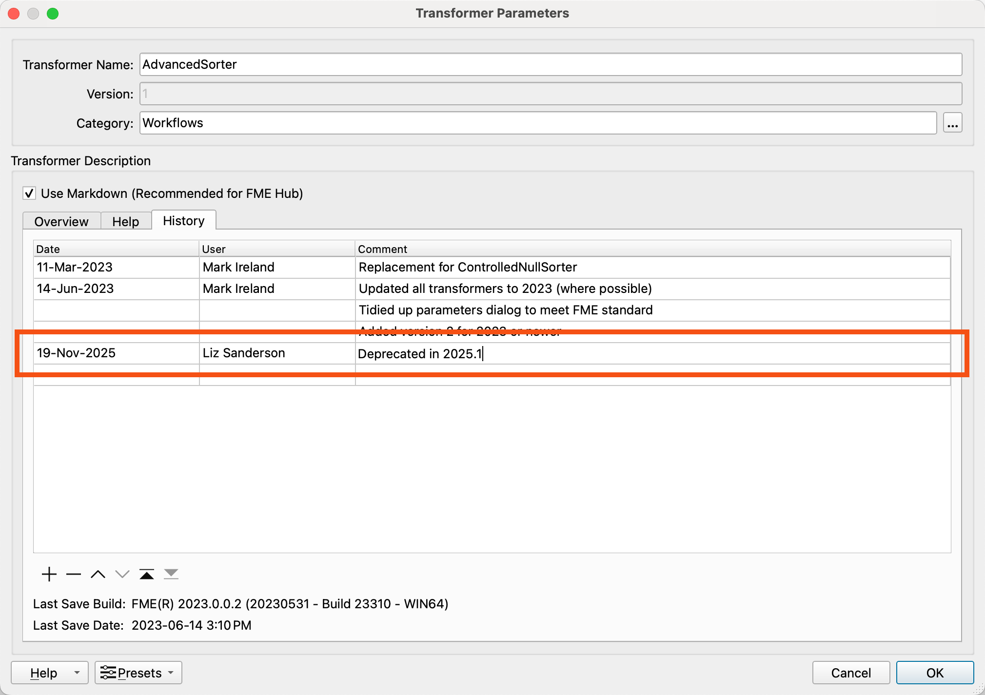

Next, switch to the History tab and enter the following:
  • Name: <your name>
  • Date: <current date>
  • Description: <reason the transformer was deprecated>

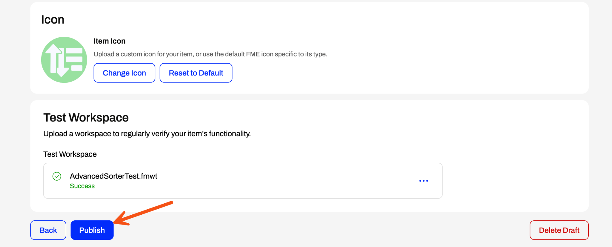

7. Upload to FME Hub
Back in FME Hub, on the transformer page, click the Actions drop-down and select Edit Item.
On the Item Draft page, next to the transformer fmx, click the three dots and select Upload New Version.
In the Upload New Item dialog, browse to the newly saved .fmx, then click Upload Item.

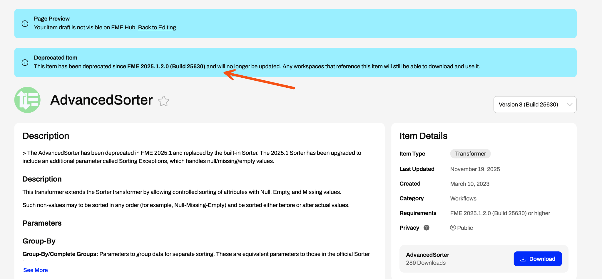

After uploading, click Preview. Confirm the following:
  • The FME Version is correct.
  • The transformer version is correct.
  • A Deprecation banner appears at the top of the page.
At the bottom of the Edit Item page, click Publish. Then in the pop-up dialog, click Publish again.
