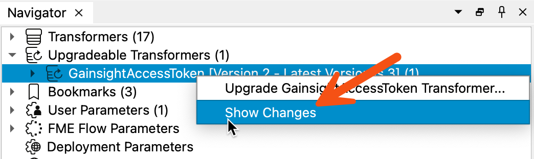

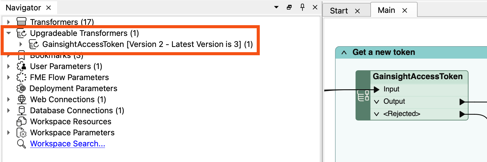

2. Locate the Upgradeable Transformer

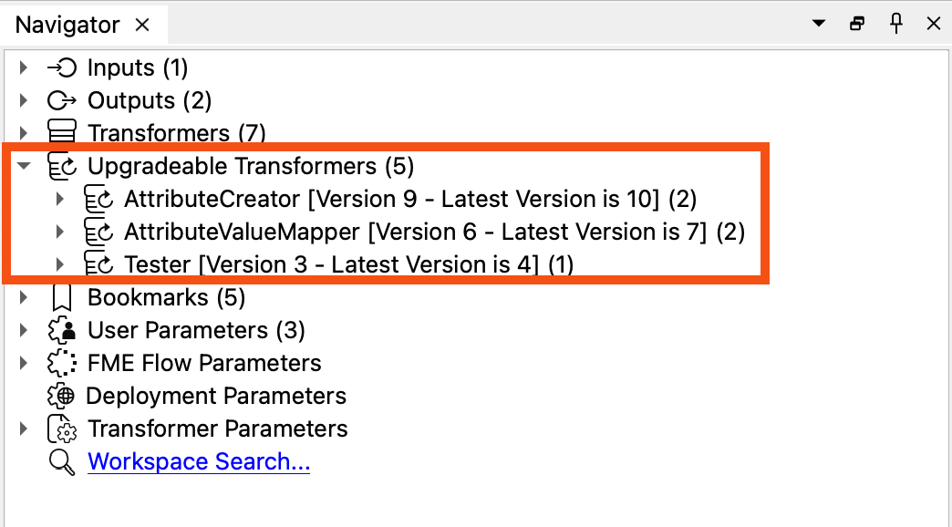

If a transformer has an upgrade, it will appear under Upgradable Transformers in the Navigator. Both built-in and custom transformers will appear here.

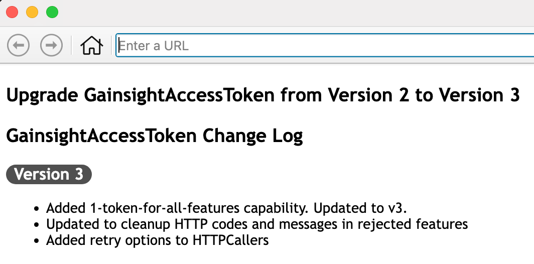

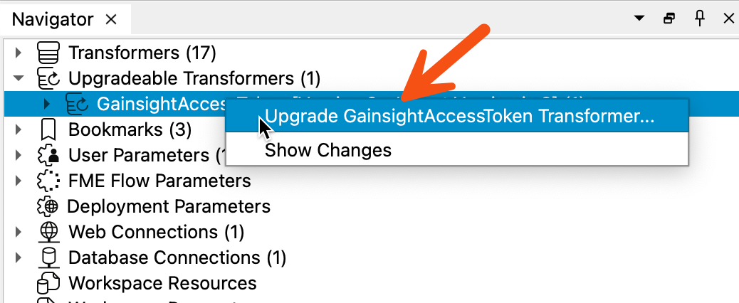

3. View History
Before upgrading a transformer, it is recommended to view the change log. In the Navigator, right-click the transformer name, then click Show Changes to view its version history and change details before deciding whether to upgrade.

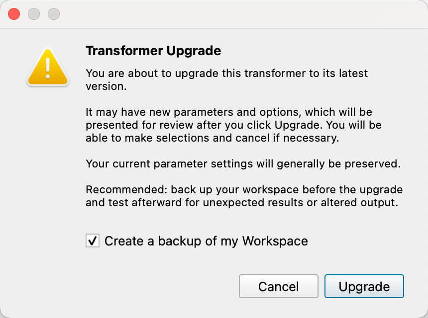

4. Start the Upgrade

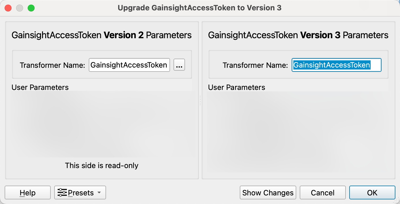

Right-click the transformer instance and click Upgrade <Name of Transformer> Transformer to open the Upgrading Transformer dialog.
You will be prompted to create a backup of your workspace during the upgrade process. It is highly recommended that the workspace be backed up, so it is enabled by default.
One final step before the upgrade is complete is to review the parameters side by side for the current and new version. Before clicking OK, confirm that the parameters look ok.
Click OK to apply the change. The transformer instance now reflects the newer version's parameters and behavior. If the current FME release doesn't support the newer definition, the upgrade option won't appear at all. In that case, an FME upgrade is needed first.

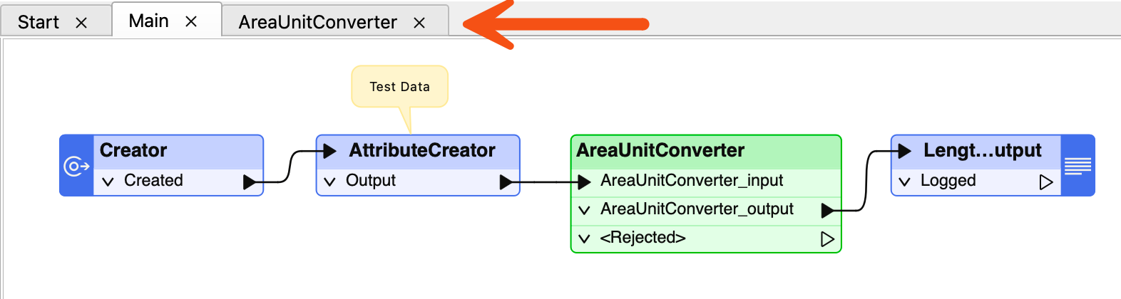

Open the workspace with the embedded transformer in FME Workbench. Then, next to the Start and Main tabs, a tab will appear for any embedded custom transformers. Click on the transformer tab.
Next, upgrade the transformers as described in the Linked section. However, this time it will be individual transformers being upgraded, either built-in or linked. Some custom transformers may have additional custom transformers nested, which may also need to be upgraded.

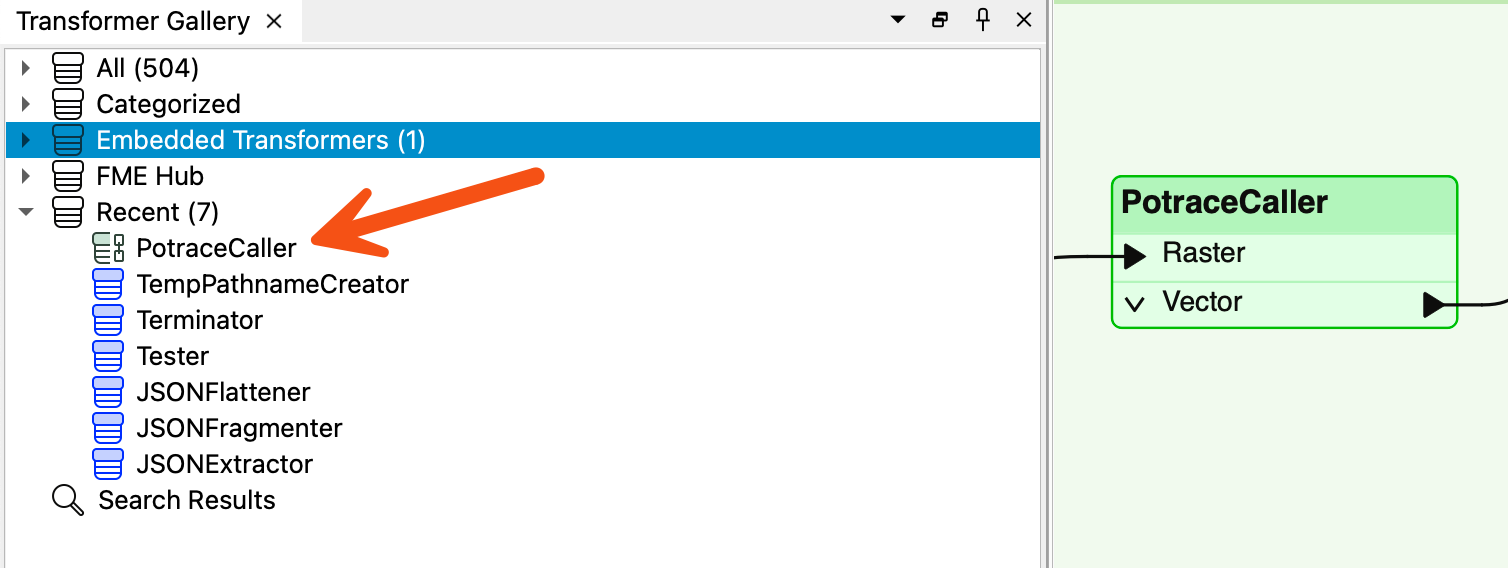

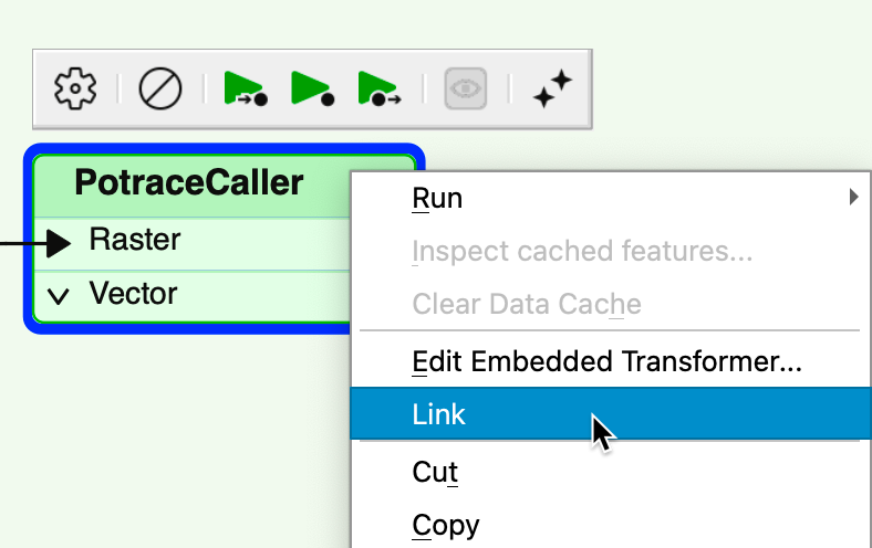

After moving the .fmx to the location above, in FME, click on the Reload Transformers button in the Transformer Gallery (View > Windows > Transformer Gallery). Once the transformers are reloaded, the embedded transformer will now appear in the Transformer Gallery as linked; however, the transformer(s) on the canvas still need to be updated.

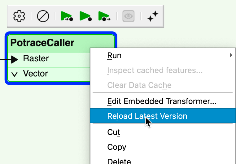

Right-click on the embedded custom transformer and select Reload Latest Version. The embedded transformer will now be updated to the same version as the .fmx file; however, it is not yet linked. The update can be stopped here if linking is not desired.
To complete linking the embedded transformer. Right-click on it once more, and Link is now an option; click on Link.

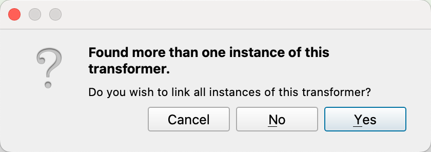

If there is more than one instance of the embedded transformer on the canvas, a dialog will appear about linking all instances.

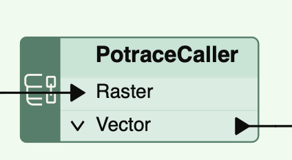

After clicking Yes or No for the multiple instances, the transformer will now be linked and appear as a dark green transformer with the link icon.
The linked transformer can then be upgraded as needed as detailed in the Linked section above. To re-embed the transformer, right-click on it and click Embed.

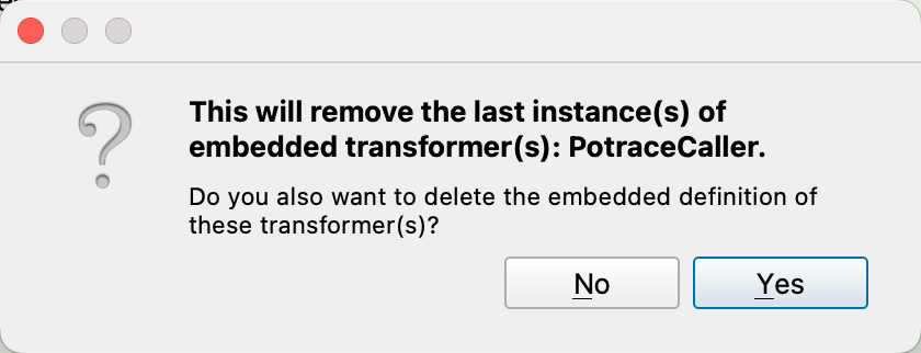

Alternatively, remove all instances of the outdated embedded transformer from the workspace and re-add the current version fresh from the Transformer Gallery. Simply replacing instances one at a time won't work as FME retains the old embedded definition in the workspace until every instance referencing it has been removed. After removing the final instance, a dialog will appear asking to delete the embedded definition, click Yes.

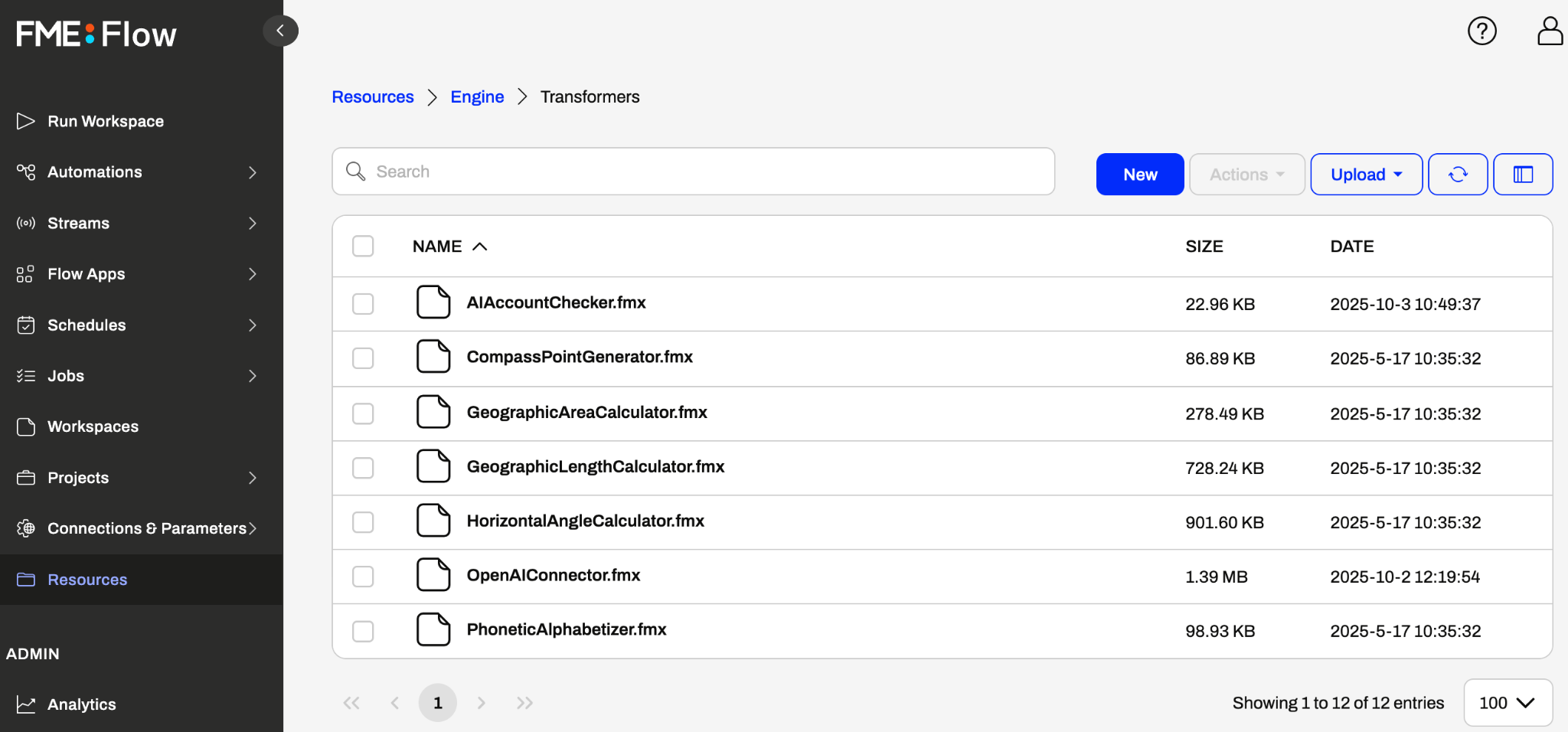

For a linked transformer, go to Resources > Engine > Transformers in the FME Flow web interface and upload the .fmx file. This makes the transformer available to every workspace on that FME Flow instance, across all repositories.
If the .fmx definition already exists on FME Flow, but there is an update. As long as the file name is exactly the same, FME will overwrite it upon upload so the workspaces can access the update.

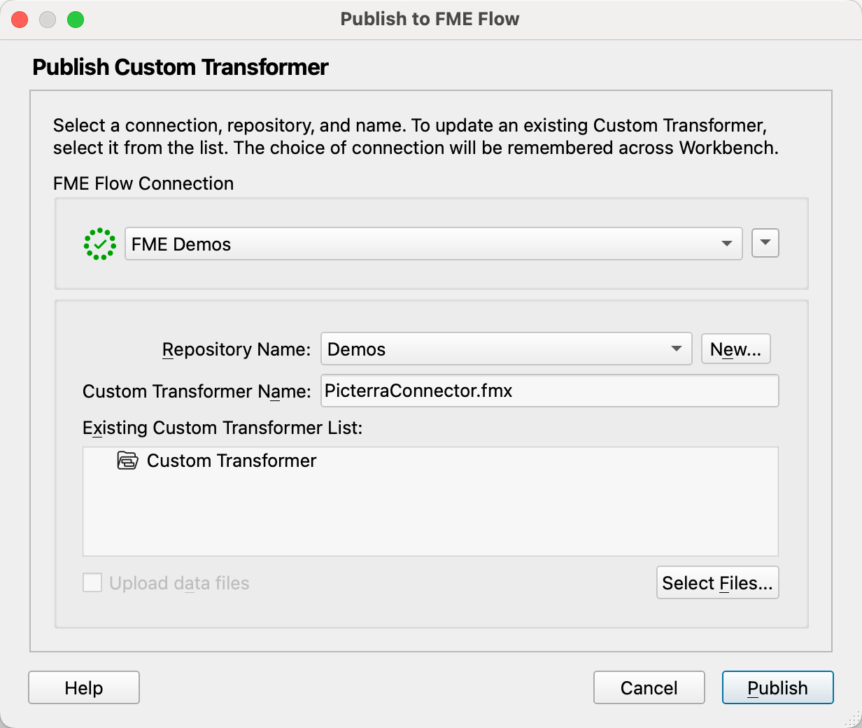

Option 2:  Publish the Linked Transformer from FME Workbench
As an alternative to Linked Option 1, open the .fmx file in FME Workbench and use File > Publish to FME Flow. This makes the transformer available to workspaces in the specific repository it's published to, rather than server-wide.
This method also requires the transformer to be upgraded in the workspace, then republished.

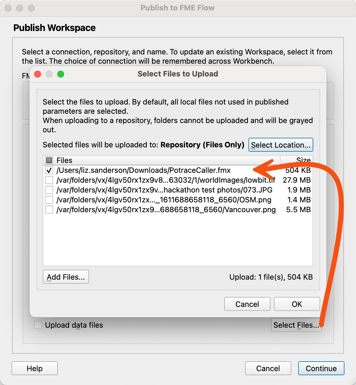

As a third option, when publishing a workspace that uses a linked transformer, upload the transformer's resources at the same time — either into the same repository (available only there) or into the shared resource folder (available everywhere).
