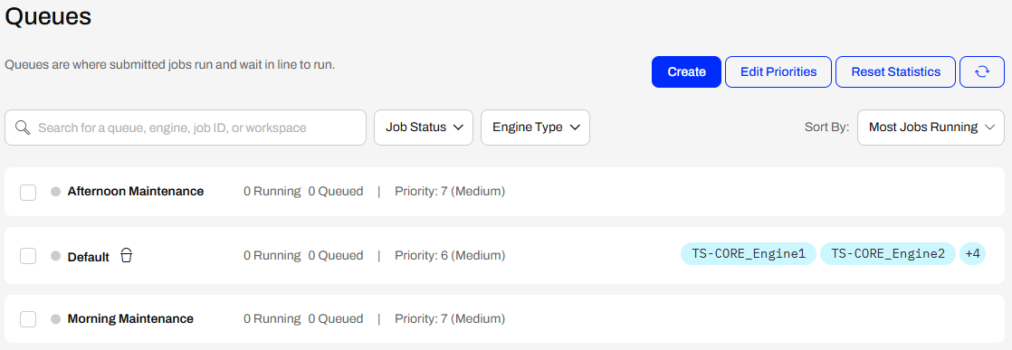

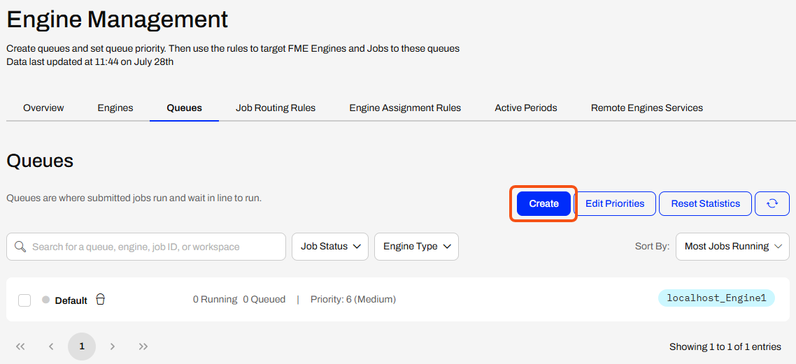

  1. Navigate to “Engine Management” under the “Admin” section and select “Queues” on the FME Flow Web UI.
  2. Click on “Create ” to create a new queue.

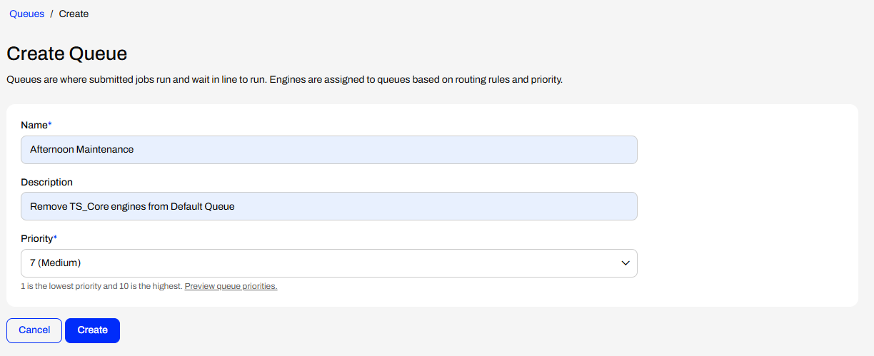

  3. Fill in the appropriate queue name, description, and priority, and click OK. For our demo, an “Afternoon Maintenance” queue with a priority of 7 (Medium) will be created. Basically, any priority higher than the “Default queue” that has a priority of 6 (Medium) should work. We can preview the priorities of other existing queues in the system by clicking “Preview queue priorities”.
  4. Repeat this and create a new "Morning Maintenance queue. You should now have three queues. Afternoon Maintenance, Morning Maintenance, and Default.

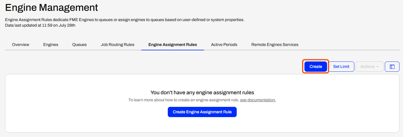

  1. Navigate to “Engine Management” under the “Admin” section and select  “Engine Assignment Rules” on the FME Flow  Web UI and click "Create"

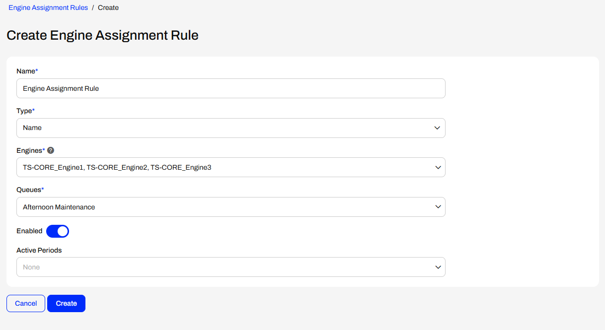

  2. Configure all the parameters as follows, and then select OK:
  • Name: Afternoon Maintenance
  • Type: Name
  • Rule: Select “Standard” from the drop-down menu
  • Engines: Select all engines from one of the cores. E.g. Core 1 (This will be the core that's scheduled to go offline during this period.)
  • Queue: Afternoon Maintenance (e.g. <QueueCreatedInPart1>)
  • Enabled: On
  • Active Periods: Once an active period is created, you can select the option in the drop-down menu. We will come back to this later. You can leave this blank for now.

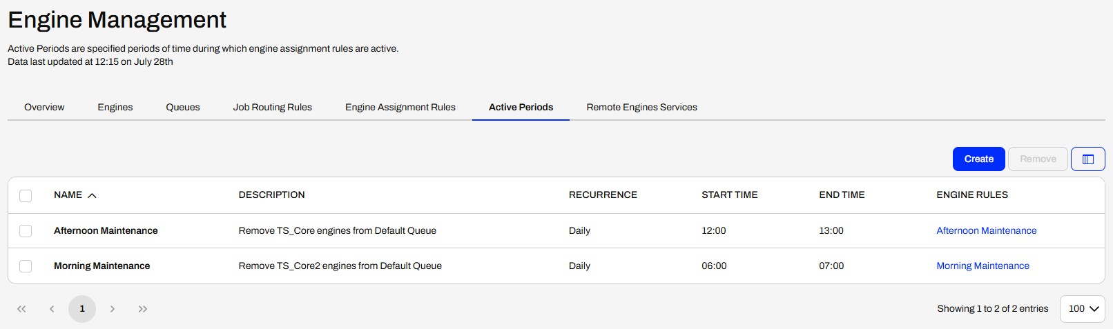

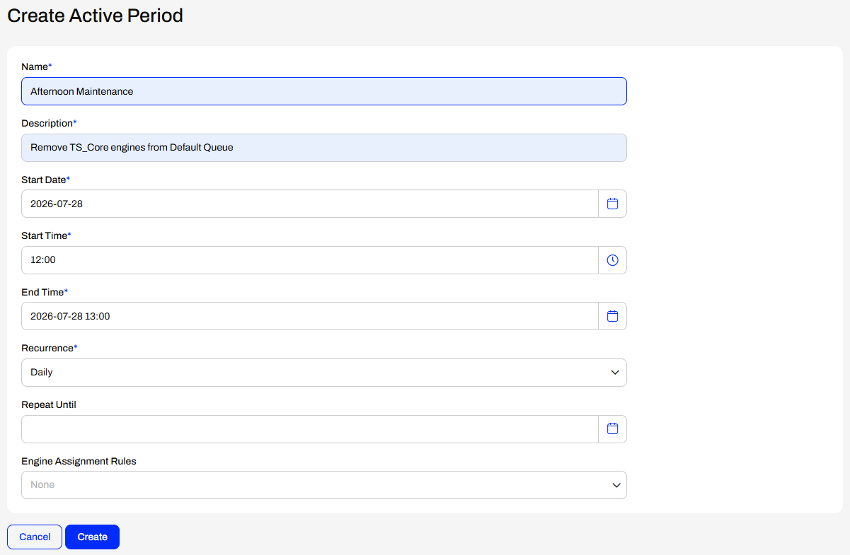

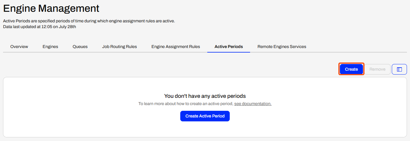

  1. Navigate to “Engine Management” under the “Admin” section and select  “Active Periods” on the FME Flow  Web UI and click "Create".
  2. Fill in the appropriate queue name, description, Start Date, Start Time, End Time, and Recurrence.

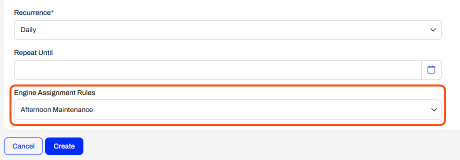

  3. Under Engine Assignment Rule, choose the corresponding Engine Assignment Rule you created in Part 2. E.g. Afternoon Maintenance
  4. Repeat this for the Morning Maintenance Engine Assignment Rule.

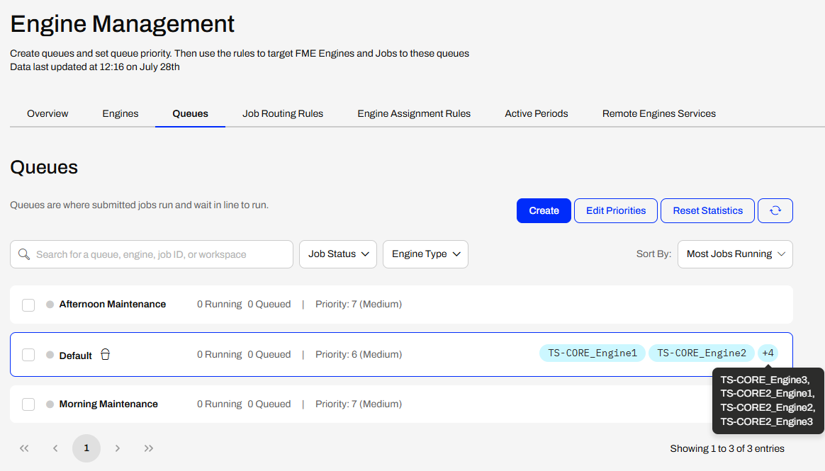

Part 4: Verify the Configuration

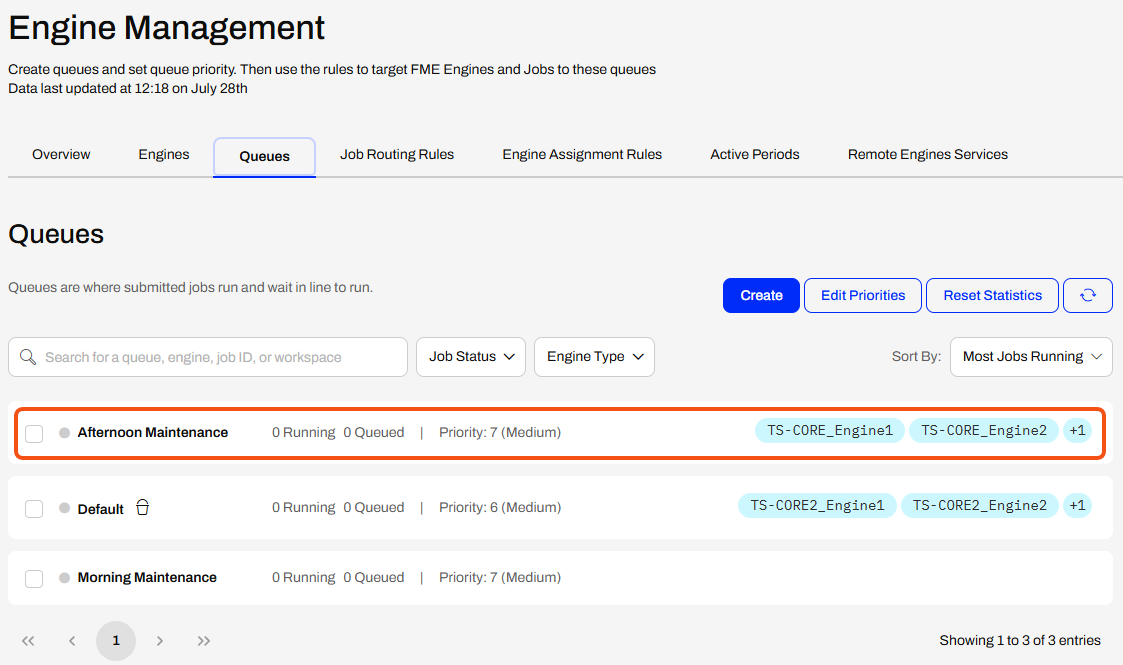

  1. Once the Queue, Engine Assignment Rules, and Active Periods have been set, navigate to the “Overview” or “Queues” page to check the configuration. Outside of the Active Periods, you should see all engines available in the Default Queue.
  2. When an Active Period kicks in, you will see the engines on the core host that will go offline for maintenance (e.g., Core 1) be assigned to the Maintenance Queue and removed from the Default Queue. The Default Queue will now only be assigned engines from the available core. Any job that you run that isn't explicitly routed to a different queue will continue to run as normal using only the available engines.
  3. Once the Active Period is over after maintenance is complete and the core is back online, you will see the engines from that core reassigned to the Default queue and available to run jobs.
