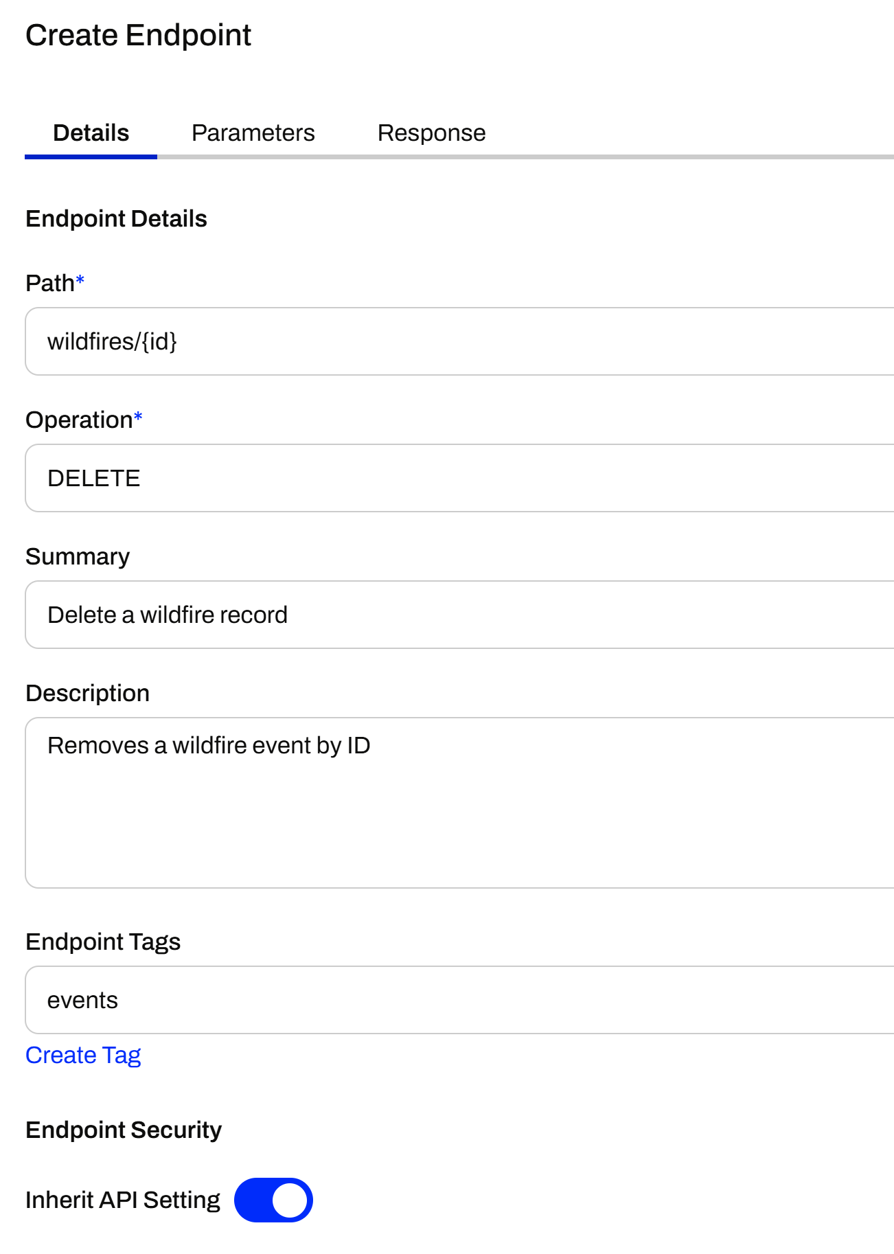

1. Create an Endpoint
Navigate to the Data Virtualization Environmental Impact and Response API in FME Flow. Open the Endpoints tab. Click Create to begin the DELETE endpoint.
In the Endpoint Details, set the following:
  • Path: wildfires/{id}
  • Operation: DELETE
  • Summary: Delete a wildfire record
  • Description: Removes a wildfire event by ID
  • Tags: events
  • Security: Inherit
Unlike POST and PUT, DELETE does not require a request body schema. The resource is identified entirely by the {id} path parameter.

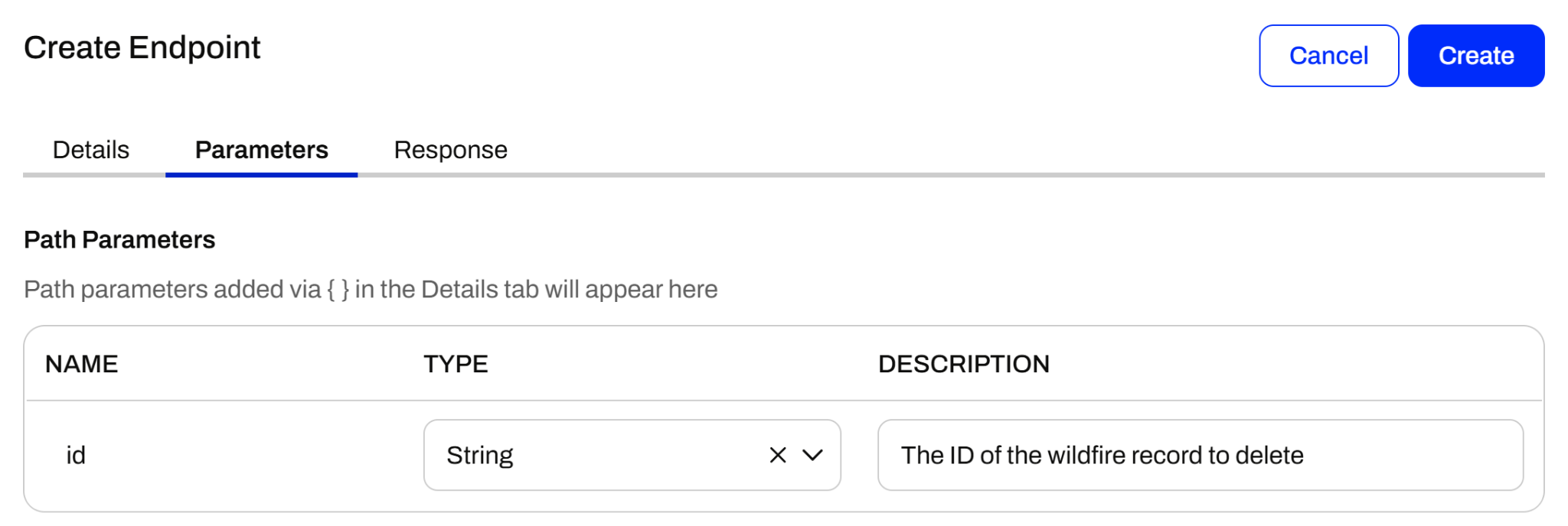

2. Configure the Path Parameter
Because the path contains {id}, a Path Parameters tab is now available. Open this tab and configure the path parameter with the following values:
  • Name: id
  • Type: String
  • Description: The ID of the wildfire record to delete

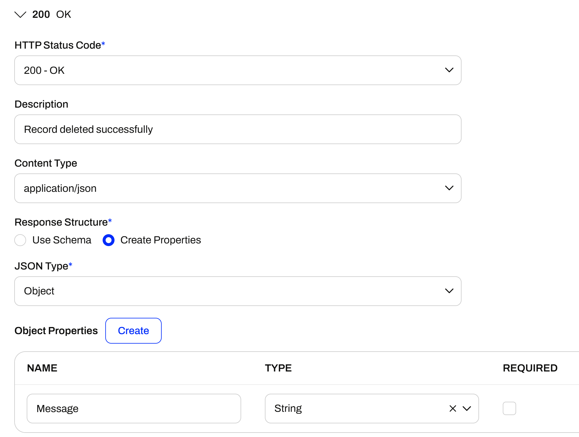

Click Add Status Code to define response codes. Add two status codes.
First, define a 200 – OK status code, used when the record is deleted successfully:
  • HTTP Status Code: 200 - OK
  • Description: Record deleted successfully
  • Content-Type: application/json
  • Response Structure: Create Properties
  • JSON Type: Object
  • Property:
    • Name: Message
    • Type: String

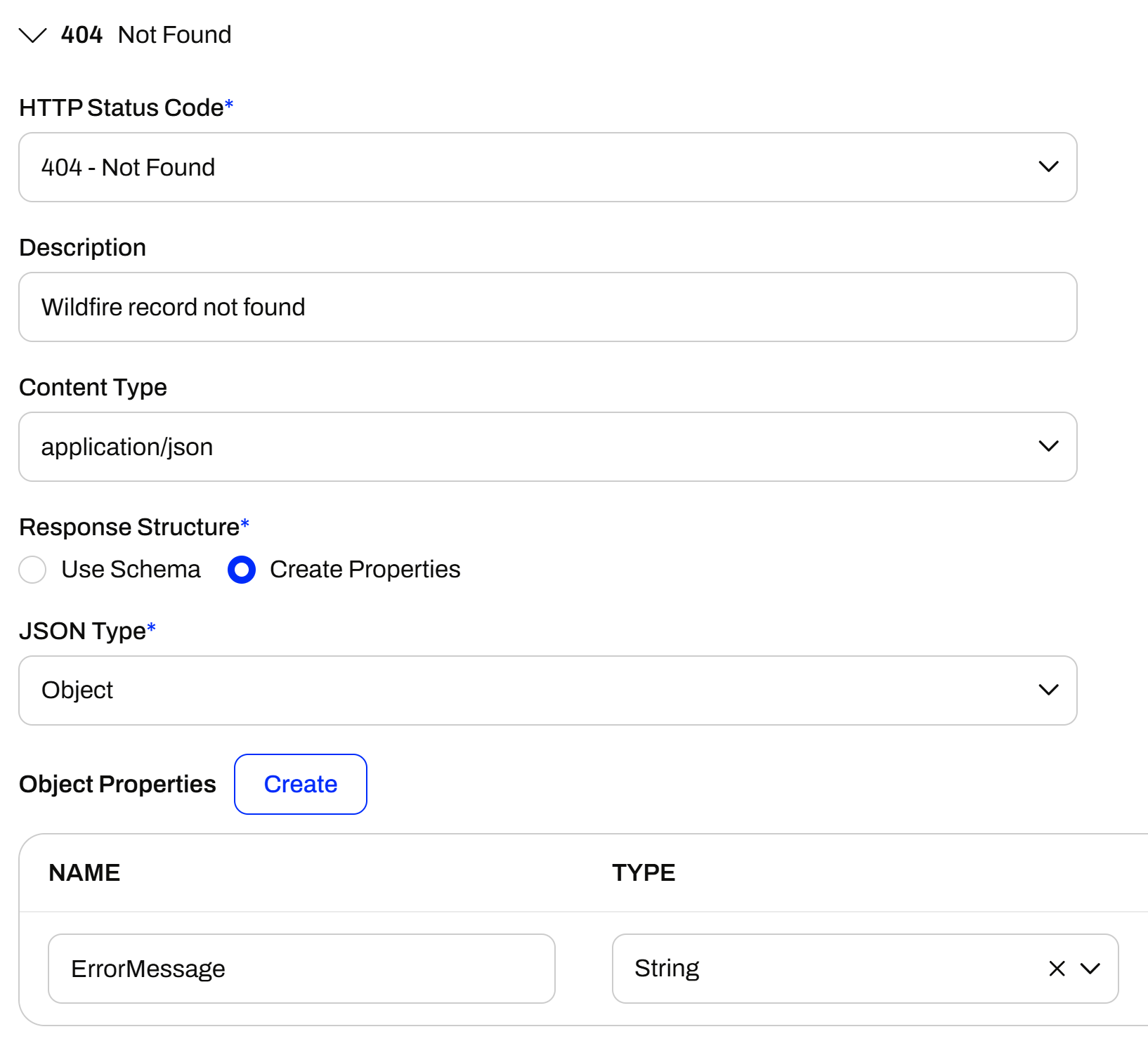

Add a second status code, 404 – Not Found, for requests targeting a record that does not exist:
  • HTTP Status Code: 404 - Not Found
  • Description: Wildfire record not found
  • JSON Type: Object
  • Property:
    • Name: ErrorMessage
    • Type: String
Because DELETE operates on a specific resource by ID, a 404 is the appropriate response when the client references an ID that does not exist, rather than silently succeeding or returning a generic error.

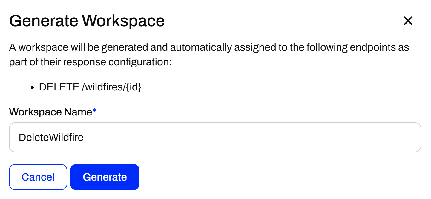

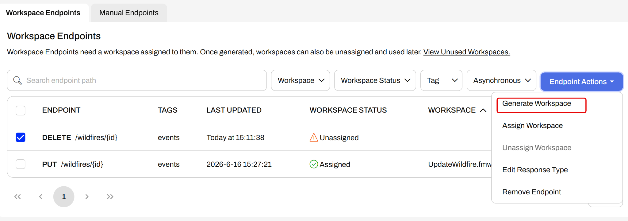

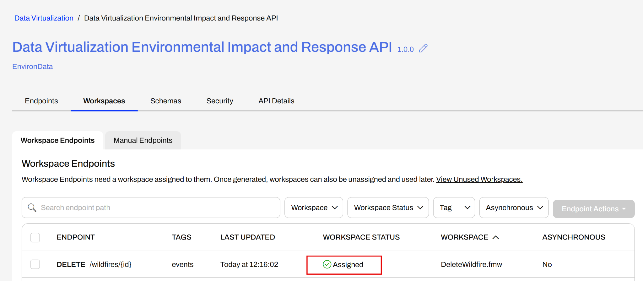

4. Assign a Workspace
Open the Workspaces tab. The new DELETE endpoint is listed with Workspace Status as "Unassigned".
Click the DELETE /wildfires/{id} endpoint and expand the Endpoint Actions menu. Click Generate Workspace. Name the workspace DeleteWildfire.fmw.
Once assigned, the Workspace Status updates to "Needs Authoring".

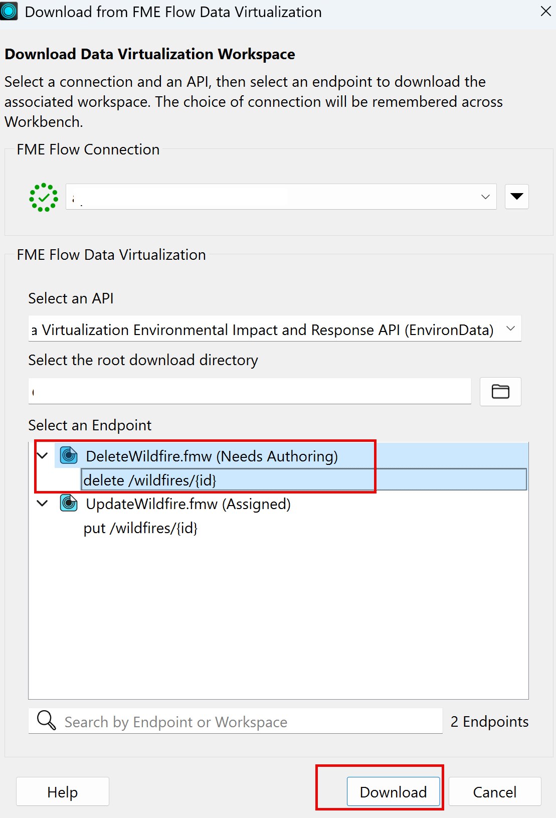

5. Download the Workspace
In FME Workbench, open the Data Virtualization menu and click the DELETE /wildfires/{id} workspace to open it.
The workspace opens with a Data Virtualization reader of type DELETE /wildfires/{id}.

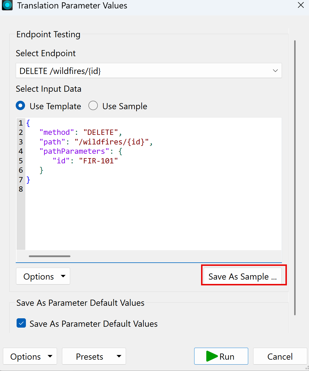

6. Use a DELETE Template
Run the workspace.
In the Translation Parameter Values dialog, click Use Template and update the template with sample data:
   "method": "DELETE",
   "path": "/wildfires/{id}",
   "pathParameters": {
      "id": "FIR-101"
DELETE templates do not include a body section, unlike PUT and POST templates. DELETE carries no request payload.
Click Save As Sample and give the template a name, for example, delete_wildfires_{id}-sample.json.

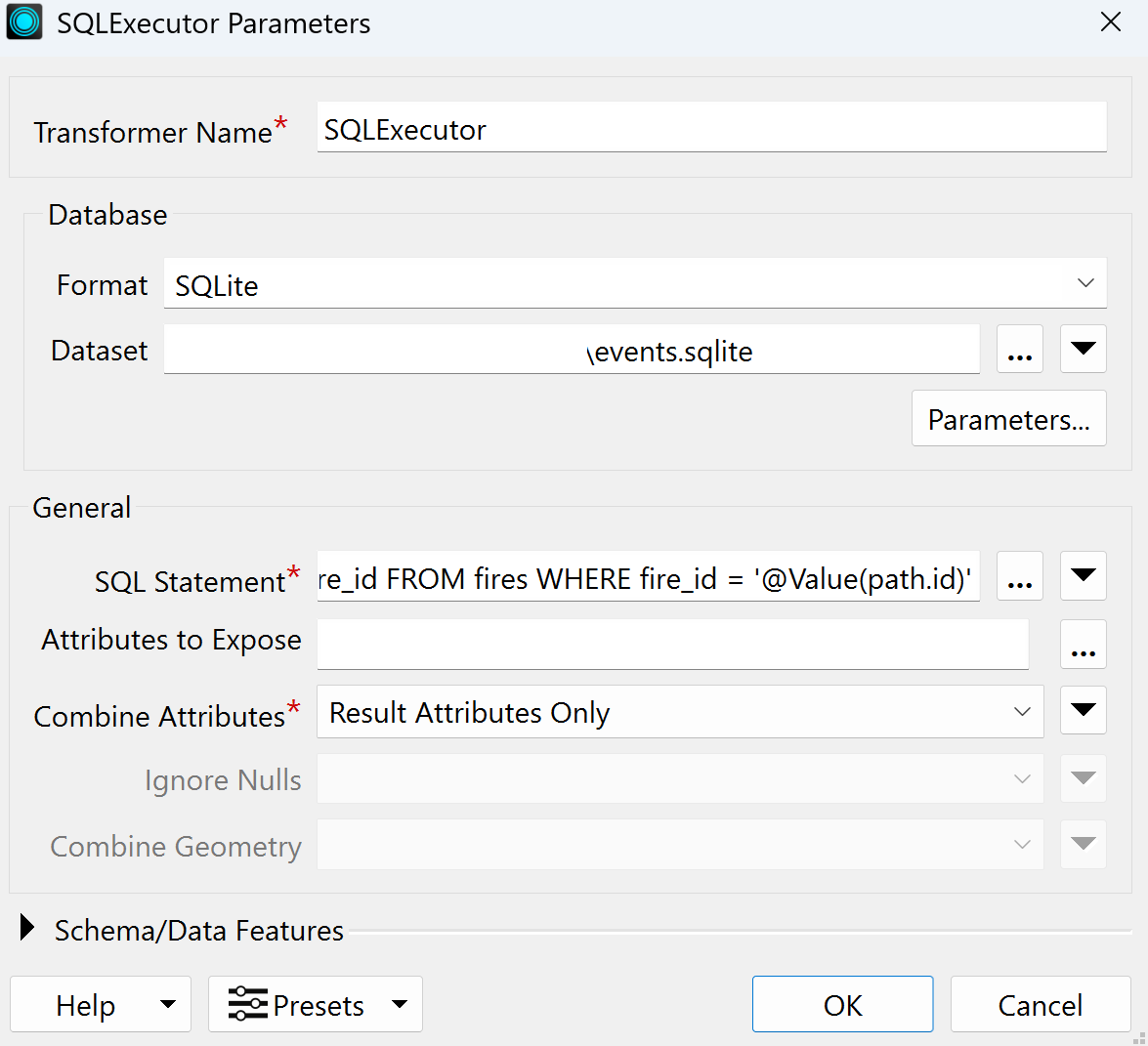

On the top menu, click Add Transformer. In the Add Transformer dialog, search for and select SQLExecutor. Connect it to the DELETE /wildfires/{id} feature type.
Double-click the SQLExecutor to configure its parameters. Set the following:
  • Connection: events SQLite database
  • SQL Statement: SELECT fire_id FROM fires WHERE fire_id = '@Value(path.id)'
This query returns a _matched_records attribute indicating how many matching rows were found.

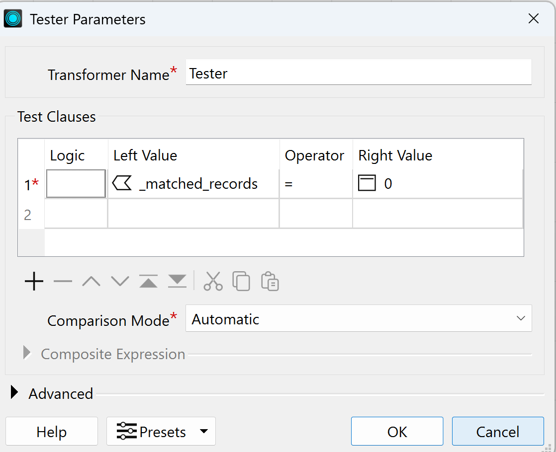

8. Test Whether the Record Was Found
Connect the Initiator port of the SQLExecutor to a Tester.
On the top menu, click Add Transformer. In the Add Transformer dialog, search for and select Tester.
Double-click the Tester and configure the following clause:
  • Clause 1:
    • Left Value: _matched_records
    • Operator: =
    • Right Value: 0
Features that pass this test (no matching record found) return a 404 response. Features that fail it (the record exists) proceed to the deletion step.
Click OK to close.

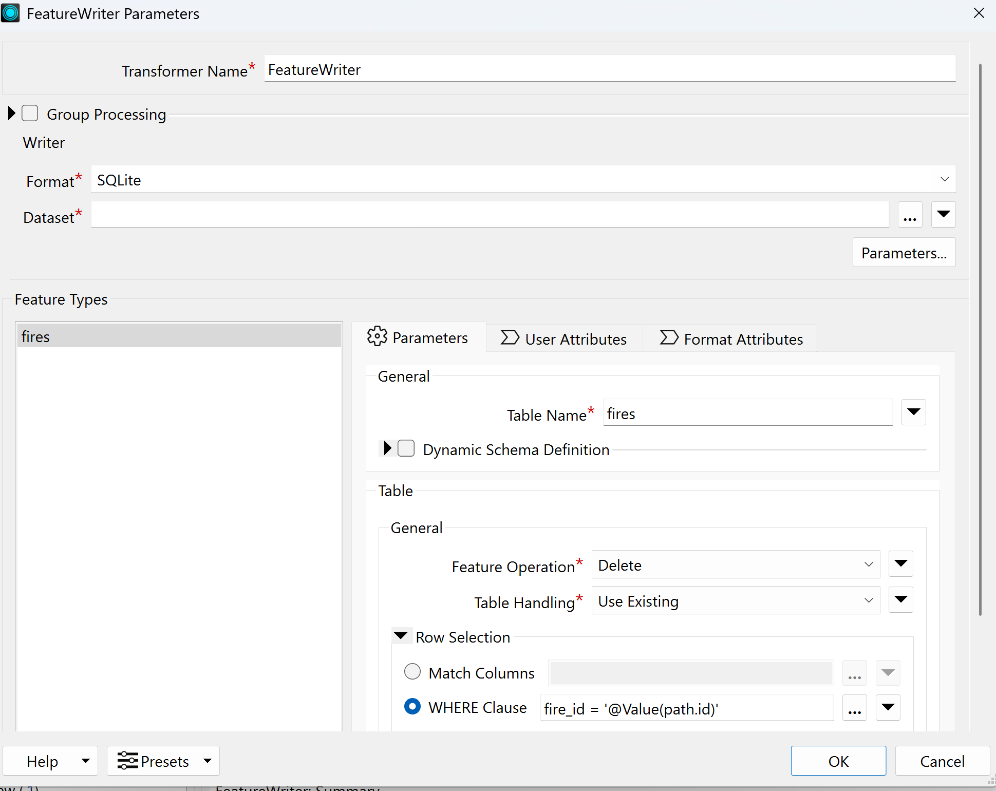

9. Delete the Database Record
Add a FeatureWriter to the canvas and connect it to the Failed port of the Tester from the previous step (where _matched_records is not 0, meaning the record exists).
On the top menu, click Add Transformer. In the Add Transformer dialog, search for and select FeatureWriter.
Double-click the FeatureWriter to configure its parameters. Set the connection to the events SQLite database, and set the following:
  • Table Name: fires
  • Table Handling: Use Existing
  • Feature Operation: Delete
  • WHERE Clause: fire_id = '@Value(path.id)'
The fire_id column is the WHERE clause key. FME deletes only the row where fire_id matches the value from path.id.

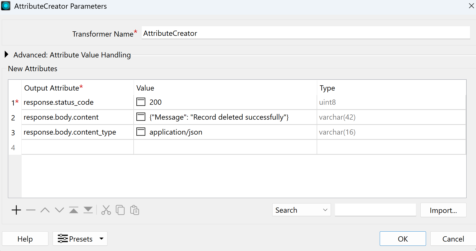

10. Format Successful Response Attributes
Add an AttributeCreator and connect it to the FeatureWriter's Summary port.
On the top menu, click Add Transformer. In the Add Transformer dialog, search for and select AttributeCreator.
Double-click the AttributeCreator and create the response attributes for the 200 status code:
  • Output Attribute: response.status_code
    • Value: 200
  • Output Attribute: response.body.content
    • Value: {"Message": "Record deleted successfully"}
  • Output Attribute: response.body.content_type
    • Value: application/json
Connect this AttributeCreator to the Data Virtualization writer, http_response.

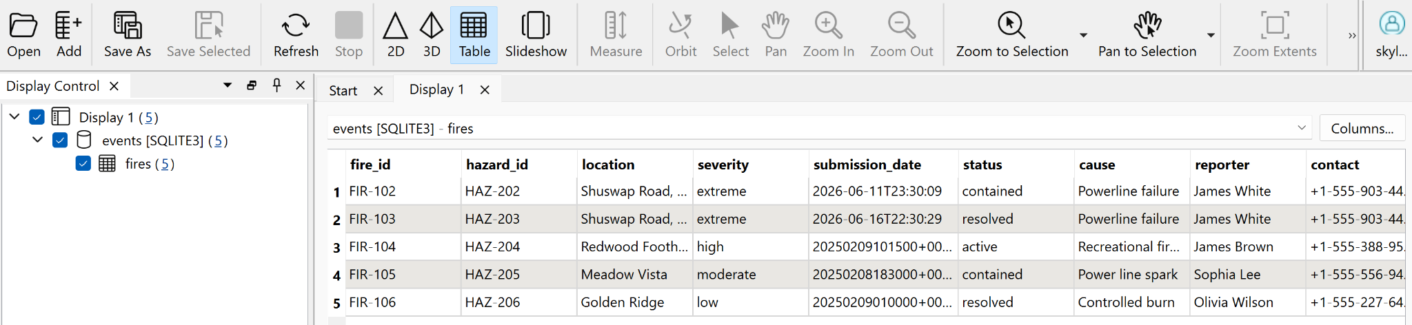

12. Test the Workspace
Run the workspace with the sample template from the earlier step.
To confirm the deletion, open the events.sqlite database in the FME Data Inspector and verify that the targeted row no longer appears.
Save the workspace.
13. Publish to FME Flow
Publish the workspace to FME Flow. Confirm the DELETE /wildfires/{id} Workspace Status is now Assigned.

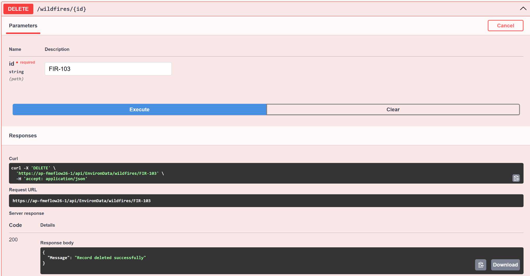

14. Test the Request from a Client
Find the DELETE /wildfires/{id} endpoint in the EnvironData API Swagger documentation. Click Try It Out.
Set the id path parameter to an existing wildfire ID (for example, FIR-103). Click Execute.
A 200 – OK response confirms the DELETE /wildfires/{id} endpoint works correctly.
To test the 404 path, repeat with an ID that does not exist.
