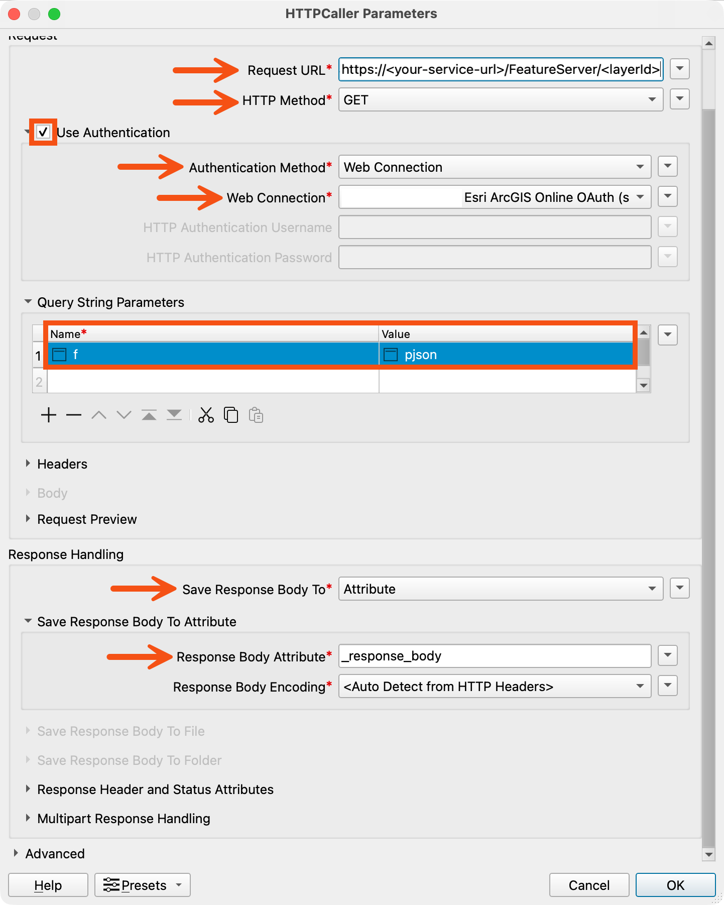

2. Query the Service Metadata
Add an HTTPCaller and connect its Input port to the Creator Output port. Set the following parameters::
  • Request URL: <Your feature service layer root URL>
    • Not the /query endpoint. For example: https://<your-service-url>/FeatureServer/<layerId>
  • HTTP Method: GET
  • Query String Parameters:
    • Name: f
    • Value: pjson
  • Use Authentication: Enabled
    • Authentication Method: Web Connection
    • Web Connection: <Your ArcGIS Online OAuth connection>
  • Response Body Attribute: _response_body
This call retrieves the service metadata, which includes the layer type and its maximum record count capabilities.

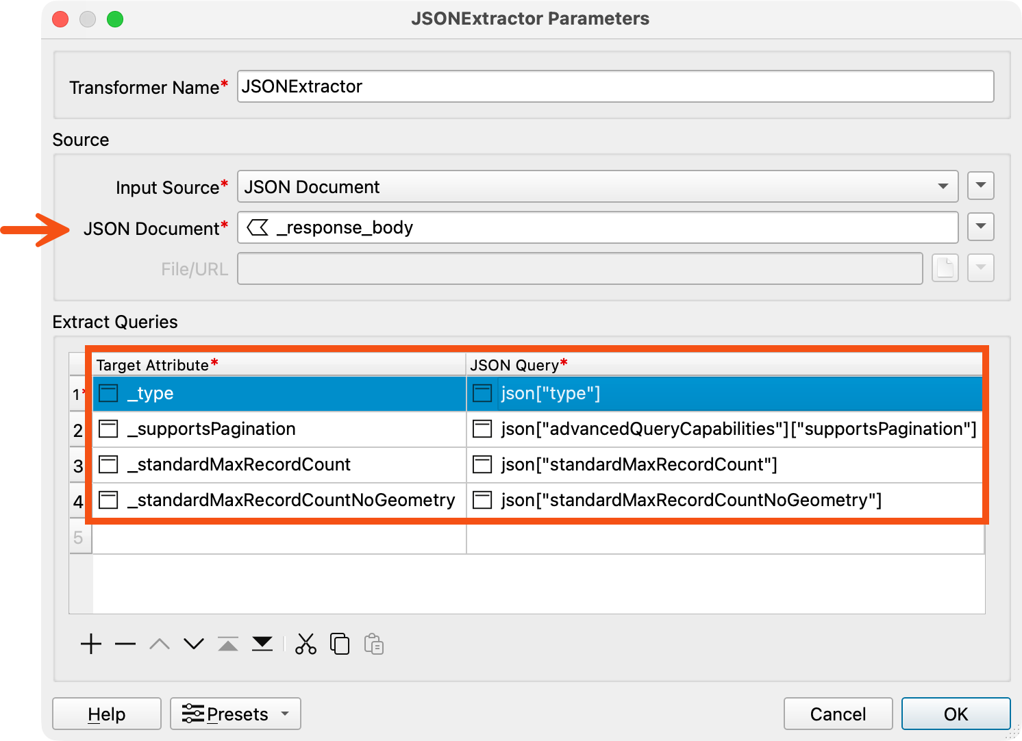

3. Extract Pagination Metadata
Add a JSONExtractor and connect its Input port to the to the HTTPCaller Output port. Open the parameters and set the following:
  • JSON Document: _response_body
  • Extract Queries:
Target Attribute JSON Query
_type json["type"]
_supportsPagination json["advancedQueryCapabilities"]["supportsPagination"]
_standardMaxRecordCount json["standardMaxRecordCount"]
_standardMaxRecordCountNoGeometry json["standardMaxRecordCountNoGeometry"]
These attributes tell you whether the service supports pagination and what its page size limits are.

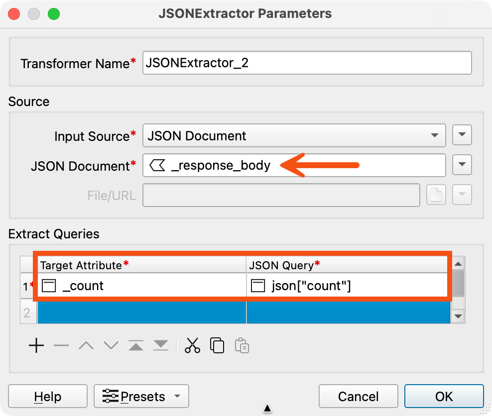

6. Extract the Record Count
Add a second JSONExtractor and connect its Input port to the second HTTPCaller Output port.
Set the following JSONExtractor parameters:
  • Extract Queries:
    • Target Attribute: _count
    • JSON Query: json[“count”]

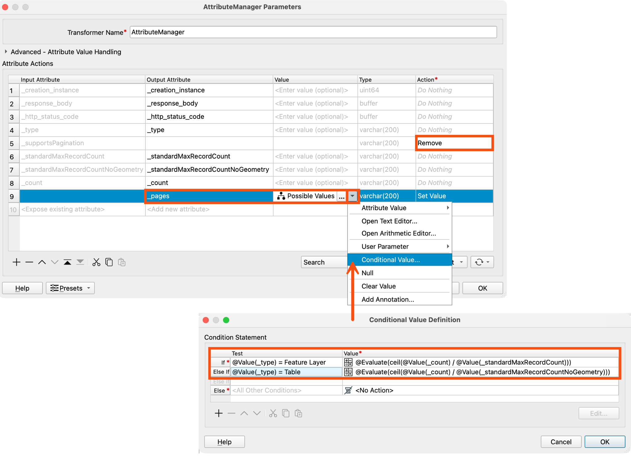

7. Calculate the Number of Pages
Add an AttributeManager and connect its Input port to the second JSONExtractor Evaluated output port.
In the parameters dialog, add a new attribute:
  • Output Attribute: _pages
Click the drop-down arrow under the Value cell and select Conditional Value. In the Conditional Value Definition dialog, double-click into the If Test cell. Set the first test clause:
  • Left Value: _type
  • Operator: =
  • Right Value: Feature Layer
  • Value: @Evaluate(ceil(@Value(_count) / @Value(_standardMaxRecordCount)))
Click OK. Double-click into the Else If Test cell and set another test clause:
  • Left Value: _type
  • Operator: =
  • Right Value: Table
  • Value: @Evaluate(ceil(@Value(_count) / @Value(_standardMaxRecordCountNoGeometry)))
Also remove the _supportsPagination attribute as it is no longer needed:
  • Output Attribute: _supportsPagination
  • Action: Remove
This calculates the total number of paginated requests needed to retrieve all features, using the service's own declared page size.

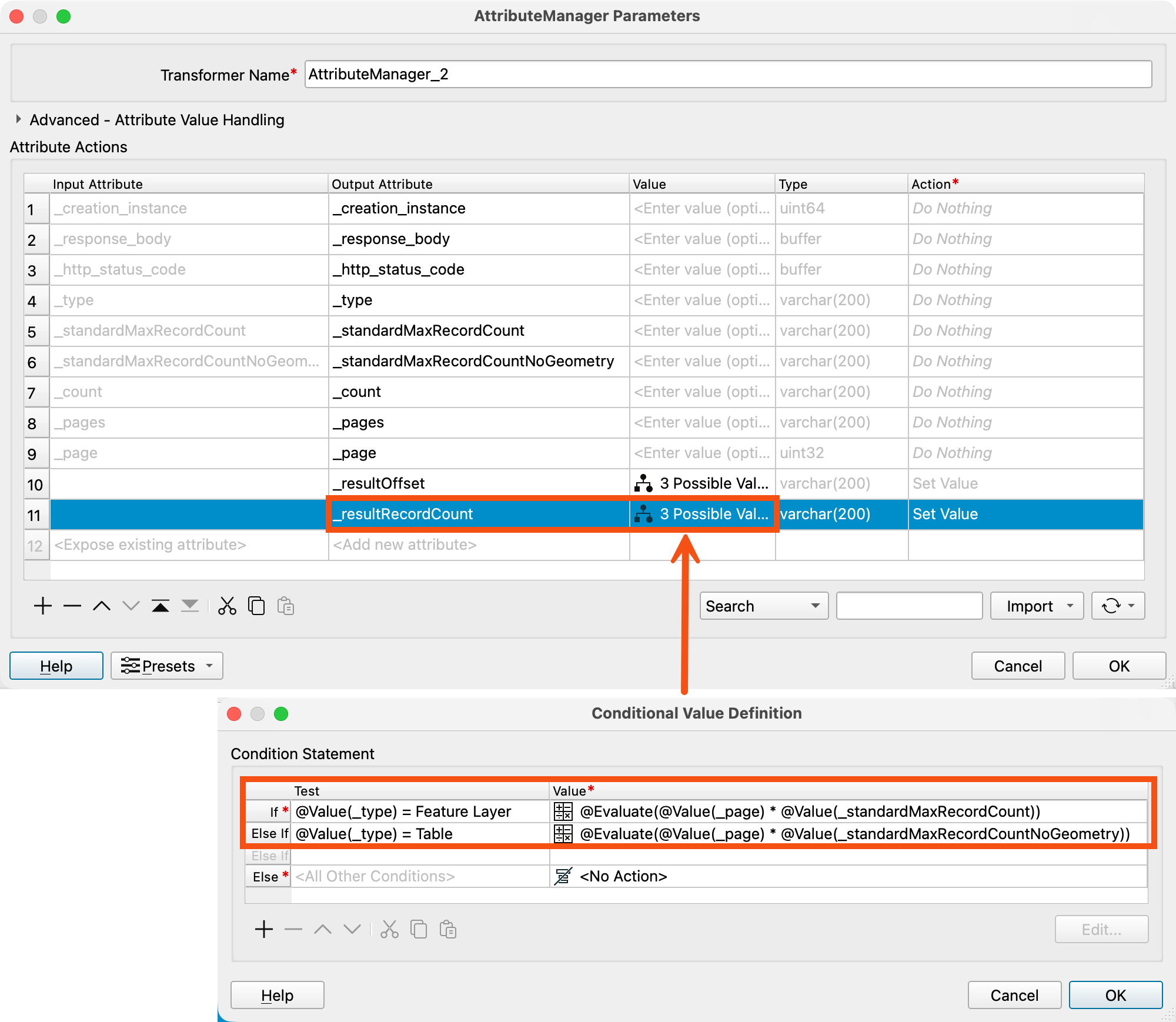

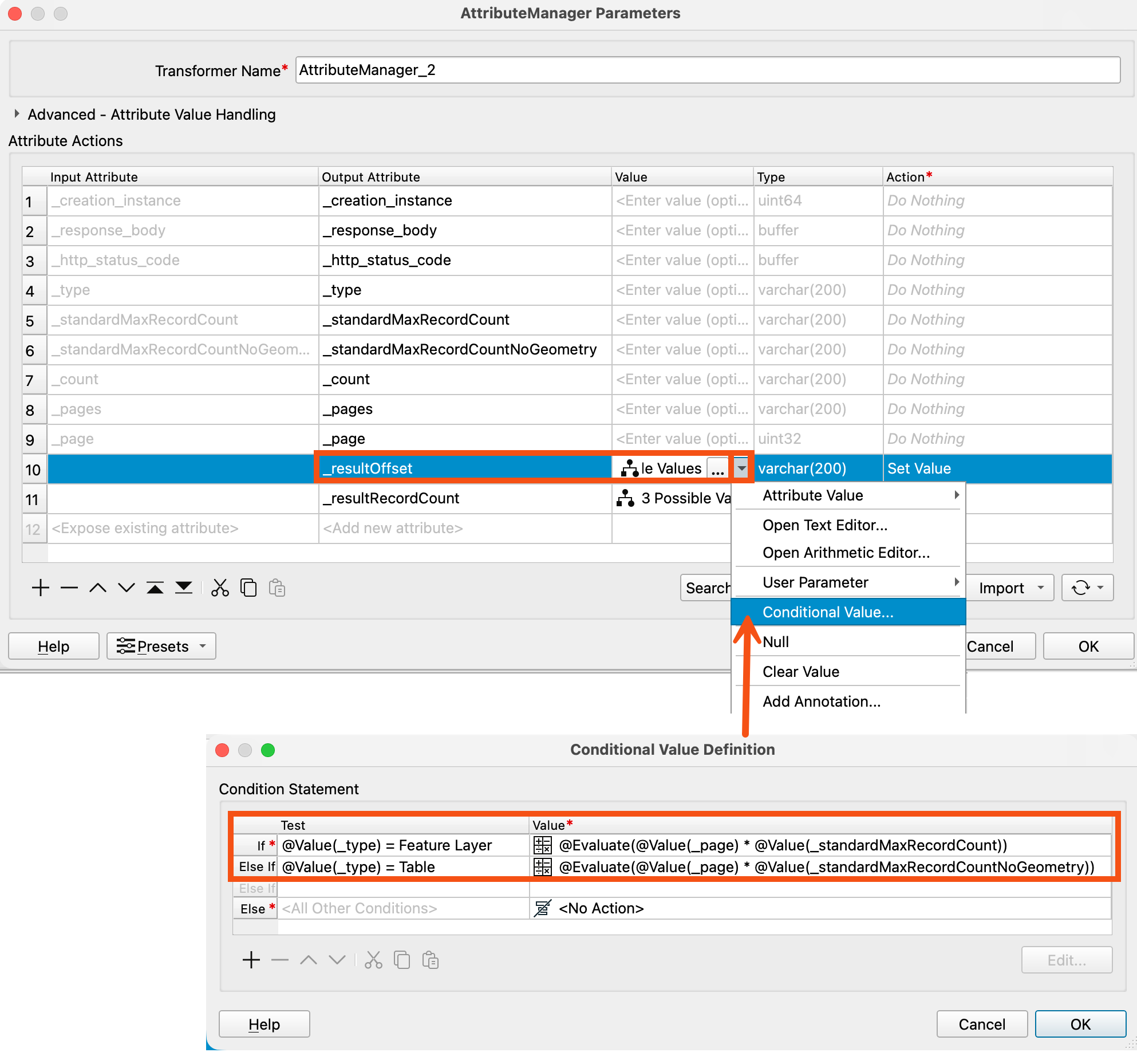

9. Calculate resultOffset and resultRecordCount
Add a second AttributeManager and connect its Input port to the Cloner Copy output port.
Add two new attributes, following the same process as done in Step 7 using the Conditional Values. For the first attribute, enter the following:
  • Output Attribute: _resultOffset
  • Value:
    • If:
      • Left Value: _type
      • Operator: =
      • Value: @Evaluate(@Value(_page) * @Value(_standardMaxRecordCount))
    • Else If:
      • Left Value: _type
      • Operator: =
      • Value: @Evaluate(@Value(_page) * @Value(_standardMaxRecordCountNoGeometry))
Click OK. Then add a second attribute:
  • Output Attribute: _resultRecordCount
  • Value:
    • If:
      • Left Value: _type
      • Operator: =
      • Value: _standardMaxRecordCount
        • Use the drop-down the select the attribute value
    • Else If:
      • Left Value: _type
      • Operator: =
      • Value: _standardMaxRecordCountNoGeometry
These attributes define the exact slice of data each request will retrieve.

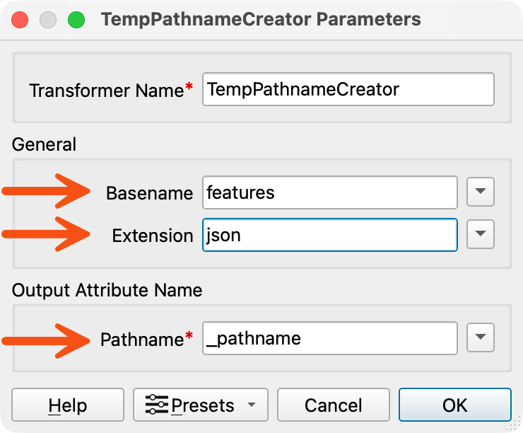

11. Generate Temporary File Paths
Add a TempPathnameCreator transformer and connect its Input port to the FeatureHolder Output port. In the transformer parameters dialog, set the following:
  • Base Name: features
  • Extension: json
  • Pathname Attribute: _pathname
These paths provide temporary storage locations for subsequent use within the workspace. In this specific workaround, JSON content is written to these locations and then retrieved via an Esri-JSON FeatureReader.

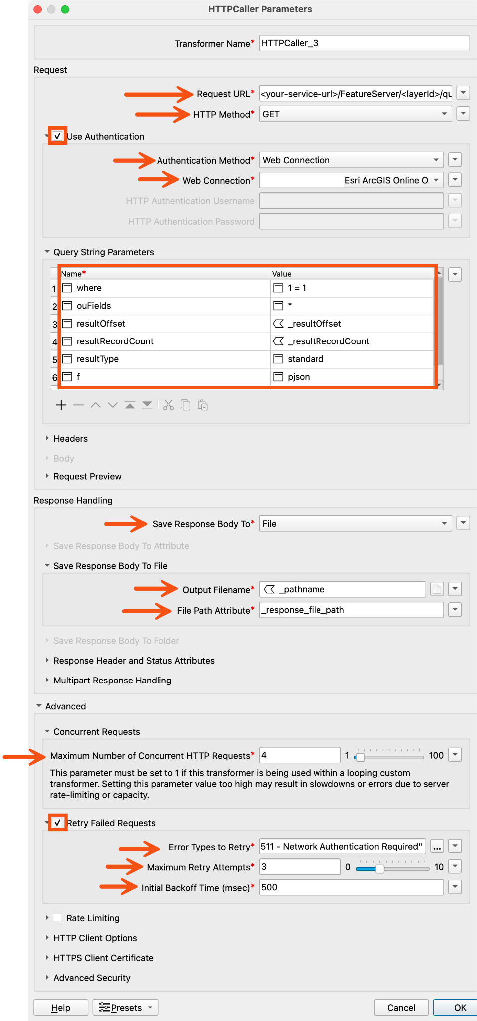

12. Fetch Each Page of Data
Add a third HTTPCaller with its Input port connected to the TempPathnameCreator Output port. Set the following parameters:
  • Request URL: <Your service layer query URL>
    • Example: <your-service-url>/FeatureServer/<layerId>/query
  • HTTP Method: GET
Name Value
where 1 = 1
outFields *
resultOffset @Value(_resultOffset)
resultRecordCount @Value(_resultRecordCount)
resultType standard
f pjson
  • Save Response Body To: File
  • Output Filename: @Value(_pathname)
  • Response File Path Attribute: _response_file_path
  • Maximum Number of Concurrent HTTP Requests: 4
    • This limits concurrent requests to avoid throttling
  • Retry Failed Requests: Enabled
    • Error Types to Retry: Connection Errors, 429, 500-511
      • Click the ellipsis to select the errors
    • Maximum Rettry Attempts: 3
    • Initial Backoff Time (msec): 500
Each feature drives one paginated query, saving the full Esri JSON response to its unique temp file.

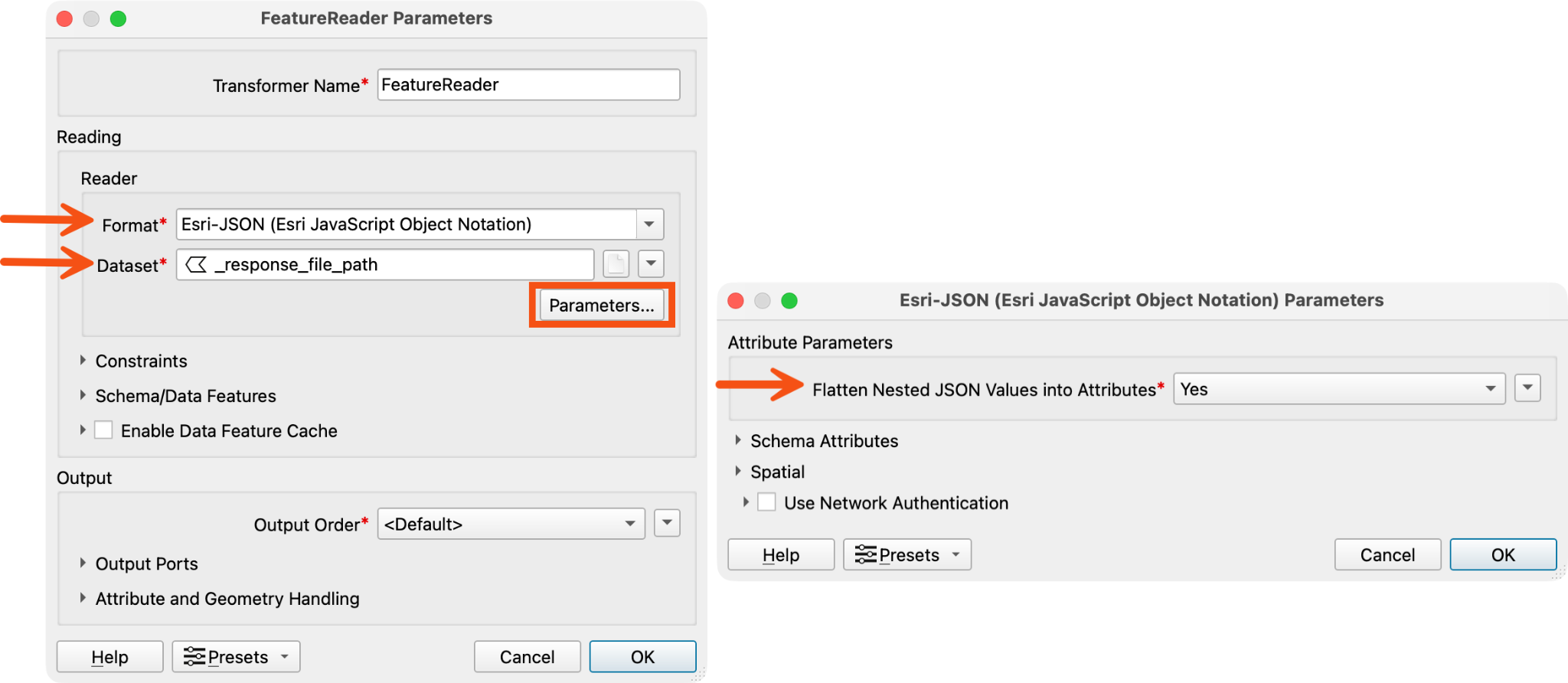

13. Parse the Response into Features
Add a FeatureReader and connect its Input port to the third HTTPCaller Output port. Open the parameters dialog and set the following:
  • Format: Esri-JSON (Esri JavaScript Object Notation)
  • Dataset: @Value(_response_file_path)
    • This is the temp file written by HTTPCaller_3
  • Parameters:
    • Flatten Nested JSON Values into Attributes: Yes
Connect the Result output port to your downstream transformers or writer. The FeatureReader parses each saved JSON response file into features to be used in the workspace.

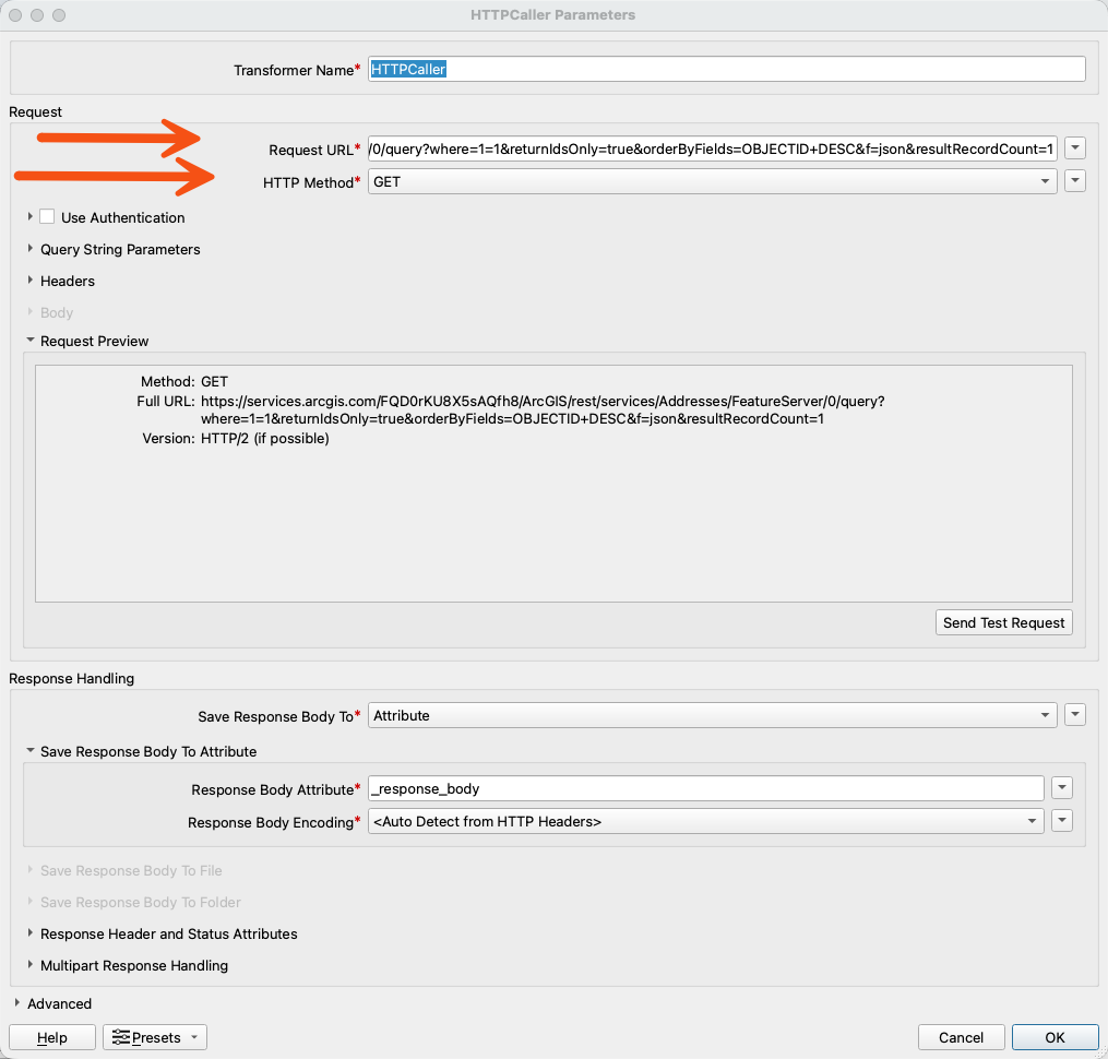

1. Add a Creator to the canvas
2. Get total record count with an HTTPCaller
Add an HTTPCaller. Connect the HTTPCaller Input port to the Creator Created output port. Use the HTTPCaller to fetch the total number of records in the feature layer:
  • Request URL:
https://<your-service-url>/FeatureServer/<layerId>/query?where=1=1&returnIdsOnly=true&orderByFields=OBJECTID+DESC&f=json&resultRecordCount=1
  • HTTP Method: GET
3. Get count with JSONExtractor
Add a JSONExtractor and connect its Input port to the HTTPCaller Output port. Double-click the JSONExtractor to set the following parameters to extract the count value from the response and store it as an attribute:
  • JSON Document: response_body
    • Use the drop-down menu to select the attribute
  • Target Attribute: count
  • JSON Query: json[“objectIds”]

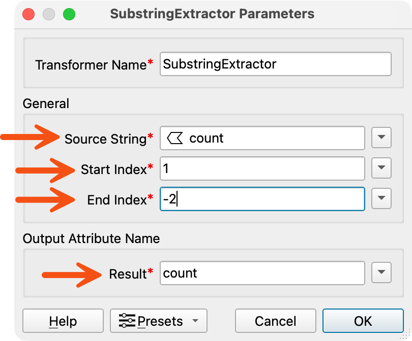

4. Remove the brackets from the result
Add a SubstringExtractor and connect its Input port to the Evaluated output port of the JSONExtractor. In the SubstringExtractor, set up the following parameters.
  • Source String: count
  • Start Index: 1
  • End Index: -2
  • Result: count

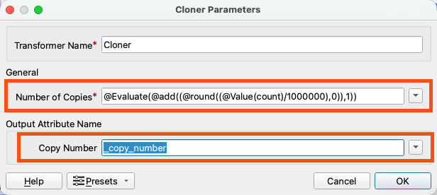

5. Clone one feature per batch
Add a Cloner and connect its Input port to the SubstringExtractor Output port. In the Cloner transformer parameters, set the following:
  • Number of Copies: @add((@round((@Value(count)/1000000),0)),1)
    • Use the drop-down menu to Open Arithmetic Editor and enter the expression
  • Copy Number: _copy_number
This produces one feature per batch, each with a _copy_number attribute starting at 0.

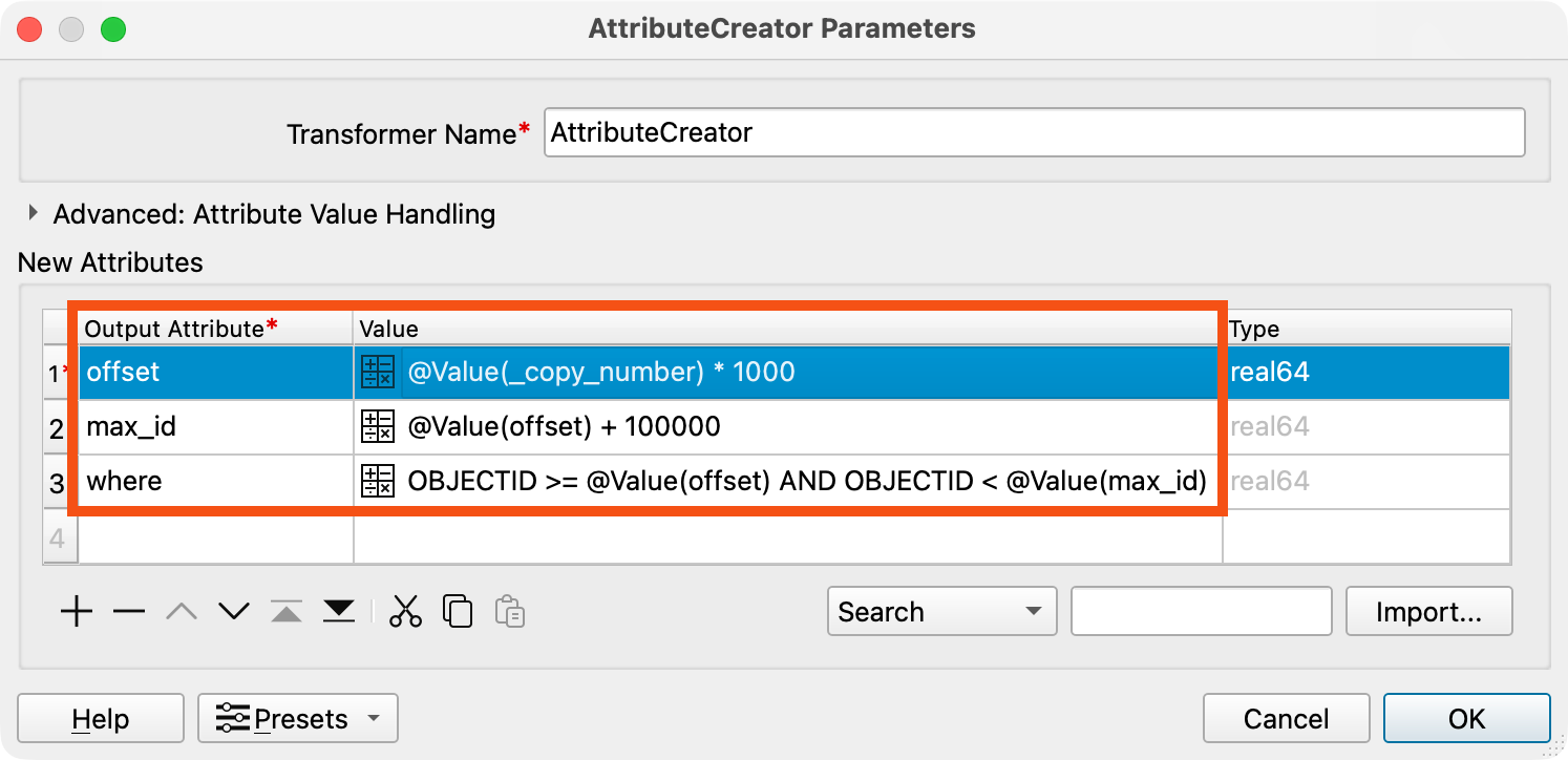

6. Build the WHERE clause per batch
Add an AttributeCreator and connect its Input port to the Cloner Copy output port. Open the AttributeCreator parameters and add the attributes and values in the arithmetic editor from the table below:
Output Attribute Value
offset _copy_number * 1000000
max_id @Value(offset) + 1000000
where OBJECTID >= @Value(offset) AND OBJECTID < @Value(max_id)

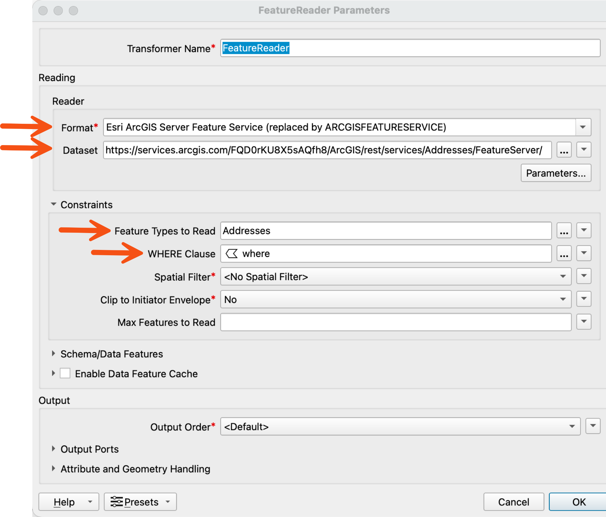

7.  Read in features using a FeatureReader
Add a FeatureReader transformer and connect its Initiator input port to the AttributeCreator Output port. In the FeatureReader parameters, set the following:
  • Format: Esri ArcGIS Server Feature Service
  • Dataset: <Your service URL>
  • Feature Types to Read: <Your feature types to read>
  • WHERE Clause: where
    • Click the ellipsis to select the where attribute previously created
The FeatureReader will execute one query per incoming feature, each retrieving a distinct 1,000,000-record batch.
