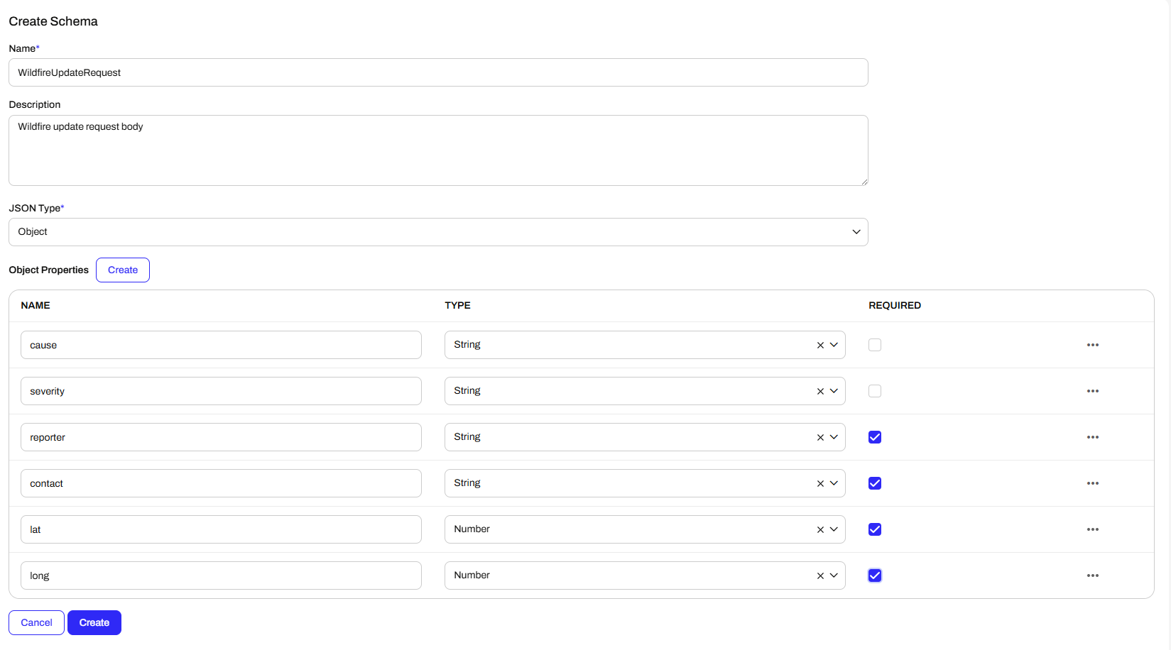

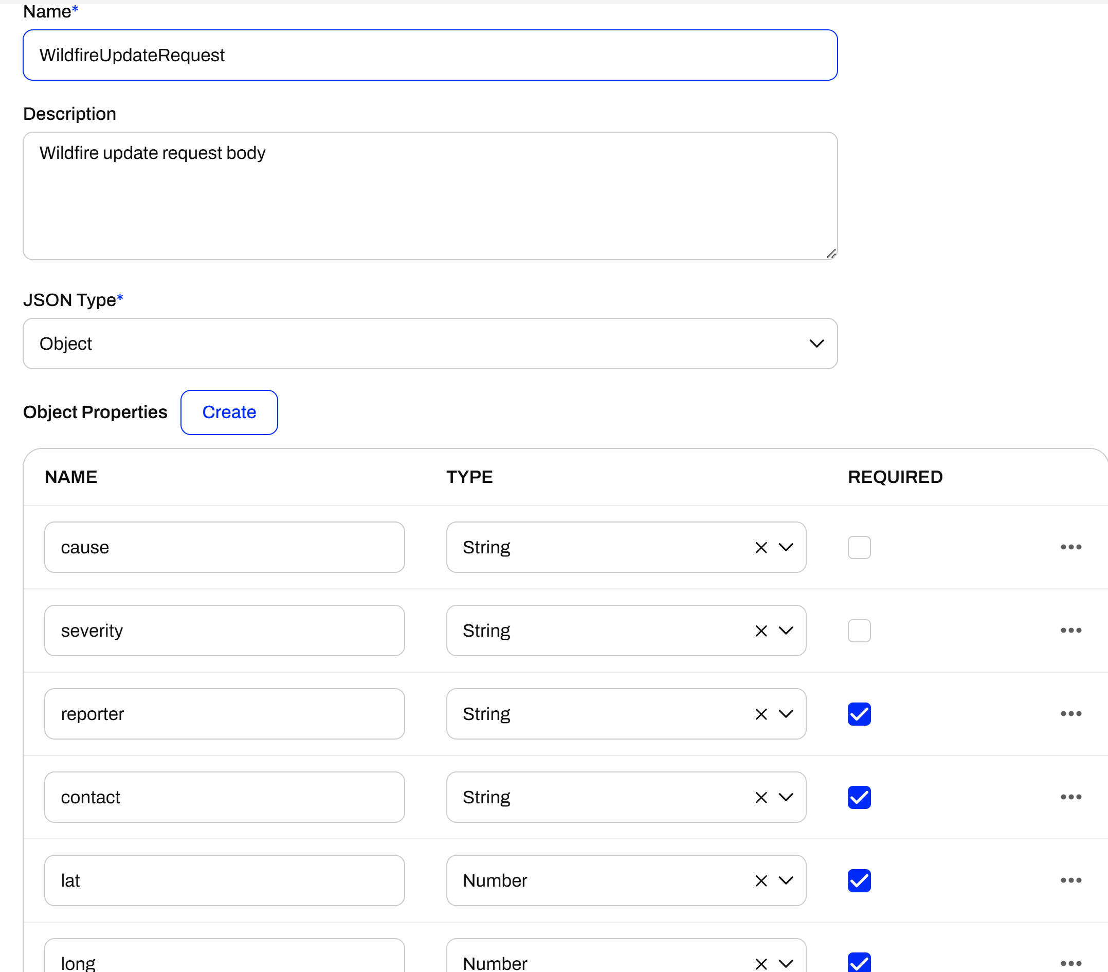

1. Create a Schema
Navigate to the Data Virtualization Environmental Impact and Response API in FME Flow. Open the Schemas tab.
Click Create to define a new schema.
  • Name: WildfireUpdateRequest
  • Description: Wildfire update request body
  • JSON Type: Object
  • Object Properties:
    • Click Create next to Object Properties. Enter the following values, clicking Create again after each property:
Name Type Required
cause String No
severity String No
reporter String Yes
contact String Yes
lat Number Yes
long Number Yes
Because PUT replaces the entire resource, the required fields mirror those of the original WildfireRequest schema. Optional fields like cause and severity may be omitted, but mandatory fields must be present for the updated record to remain valid.
When complete, click Create.

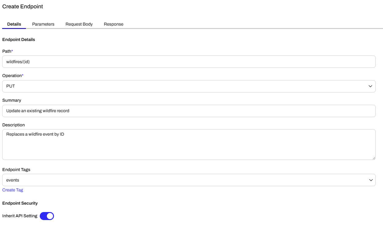

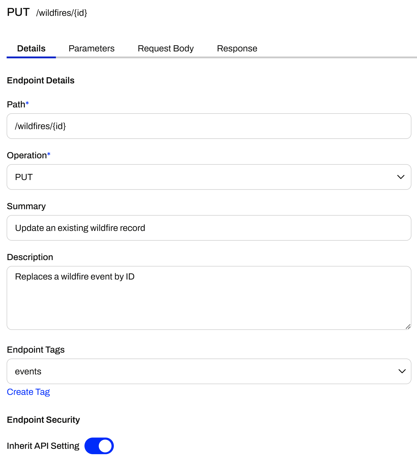

2. Create an Endpoint
Navigate to the Endpoints tab. Click Create to begin the PUT endpoint.
In the Endpoint Details, enter the following:
  • Path: wildfires/{id}
  • Operation: PUT
  • Summary: Update an existing wildfire record
  • Description: Replaces a wildfire event by ID
  • Tags: events
  • Security: Inherit
The {id} in the path is a path parameter. It tells the endpoint which wildfire record the client wants to update. FME extracts this value from the URL at runtime and makes it available as an attribute in the workspace.

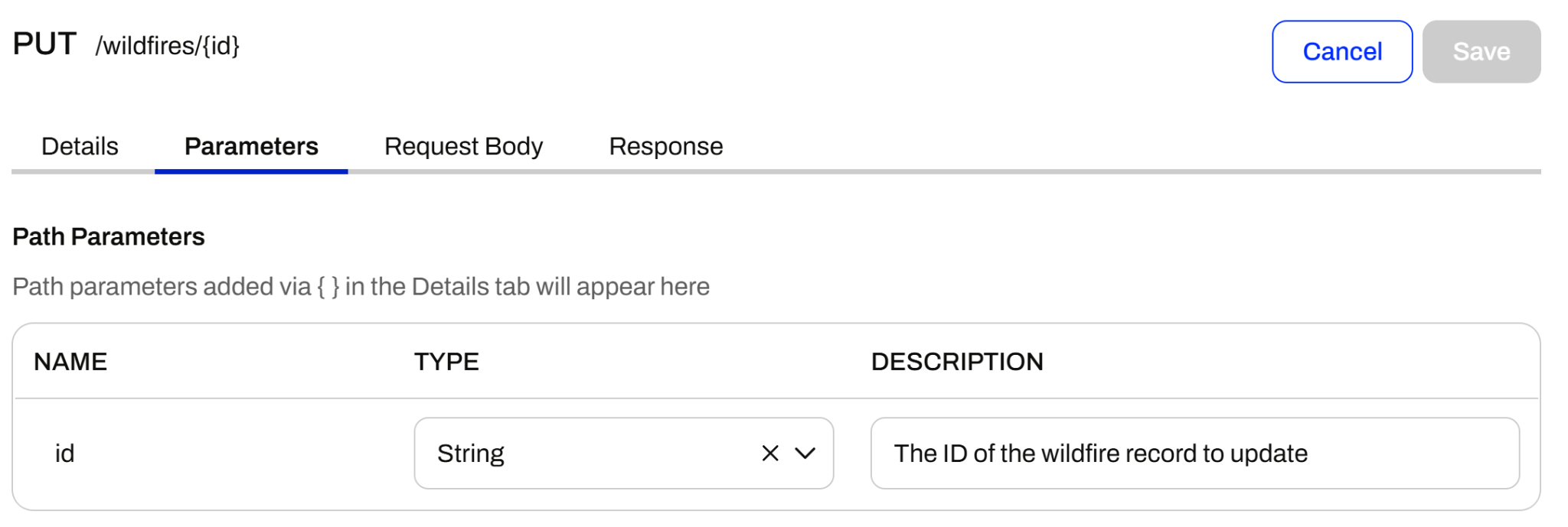

3. Configure the Path Parameter
Because the path contains {id}, a new Path Parameters tab is now available. Navigate to it.
Path parameters identify the specific resource to be updated. Without them, the endpoint would have no way to determine which record to modify.
Configure the path parameter with the following values:
  • Name: id
  • Type: String
  • Description: The ID of the wildfire record to update

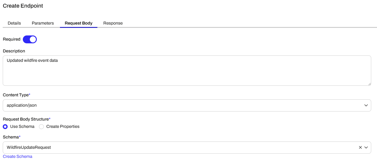

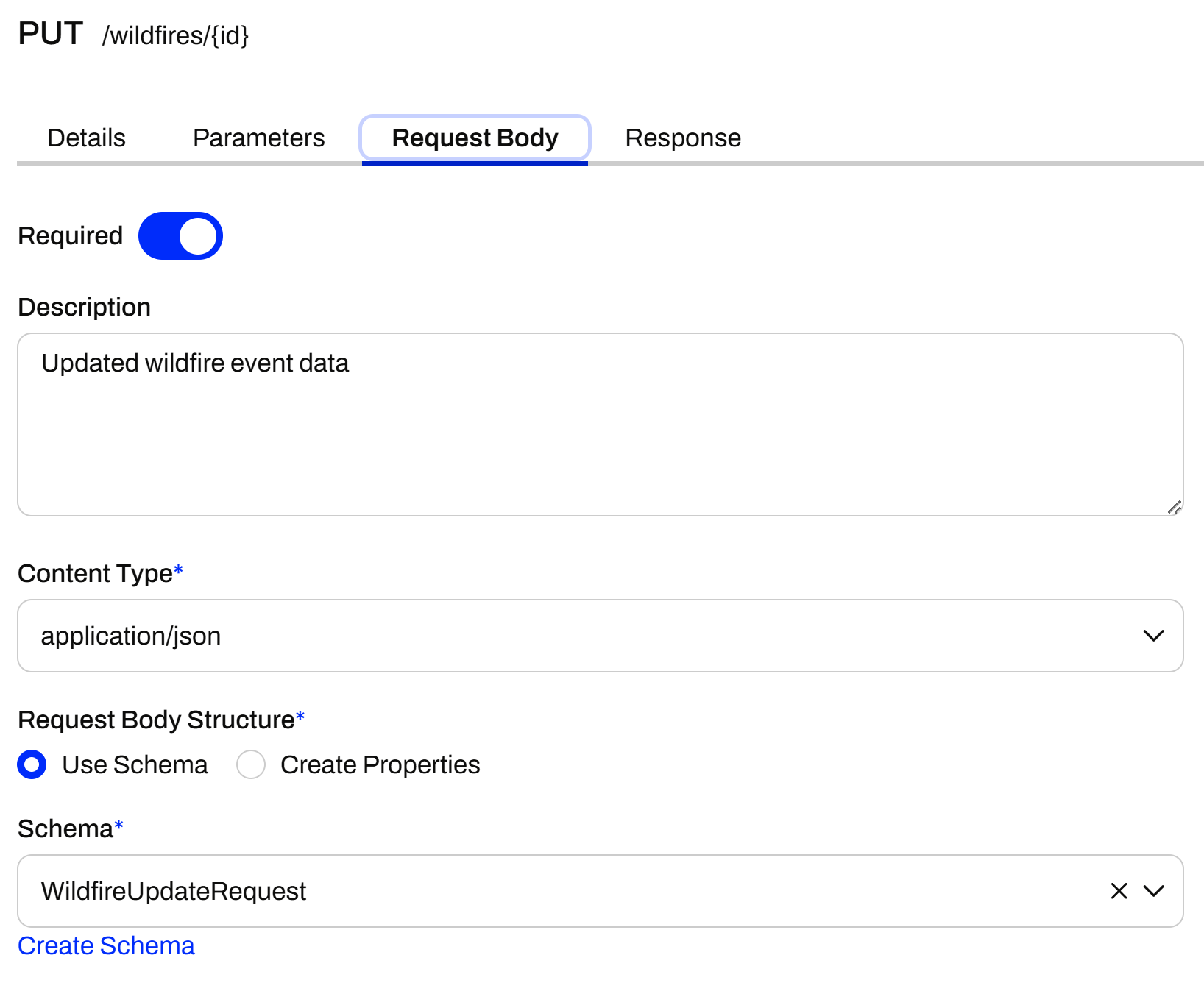

4. Configure the Request Body
Navigate to the Request Body tab.
Like a POST request, a PUT request includes a body carrying the updated resource data. Enable Required. Without a body, there is nothing to update.
Configure the remaining request body settings:
  • Required: Yes
  • Description: Updated wildfire event data
  • Content-Type: application/json
  • Input Type: Use Schema
  • Schema: WildfireUpdateRequest

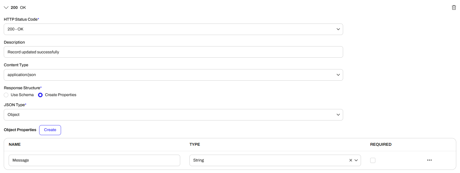

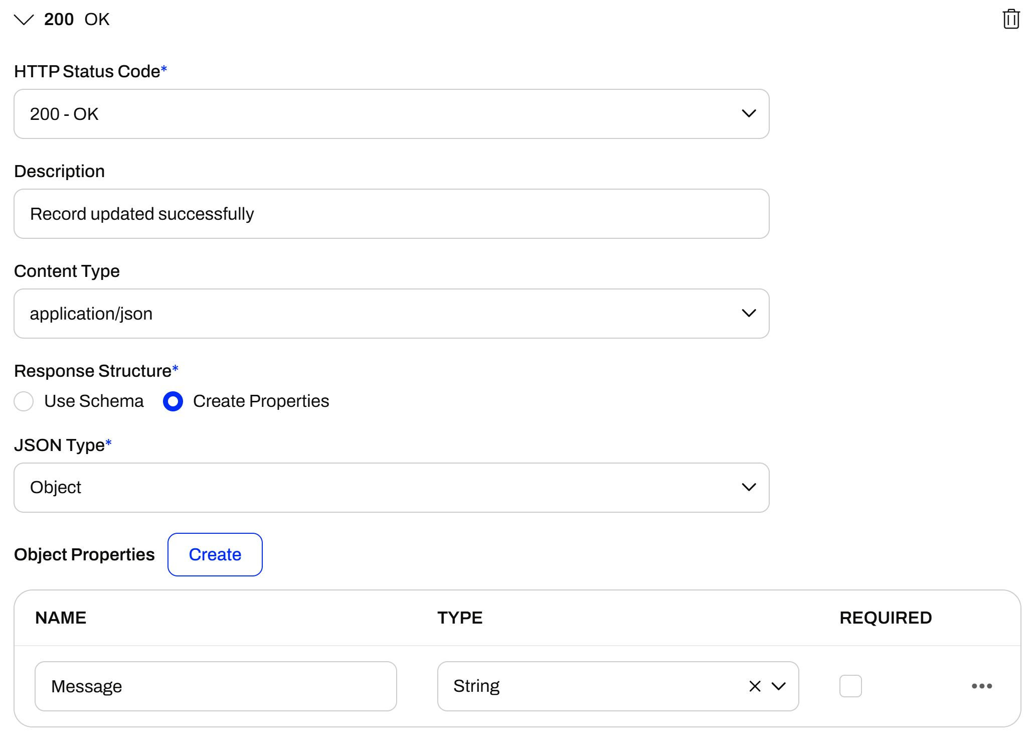

Click Add Status Code to define response codes. Add three status codes.
First, define a 200 – OK status code, which will be used when the record is updated successfully:
Field Value
HTTP Status Code 200 - OK
Description Record updated successfully
Content-Type application/json
Response Structure Create Properties
JSON Type Object
Property Name: Message, Type: String

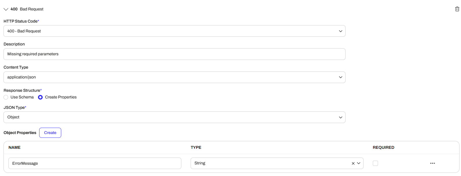

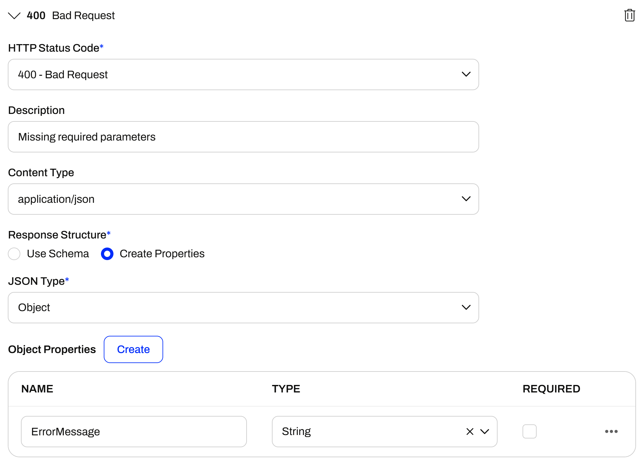

Add a second status code, 400 – Bad Request, for requests missing required fields:
Field Value
HTTP Status Code 400 - Bad Request
Description Missing required parameters
JSON Type Object
Property Name: ErrorMessage, Type: String

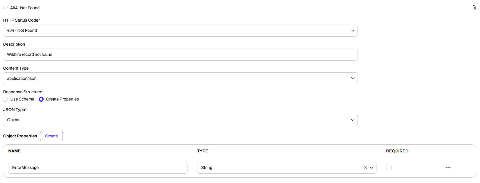

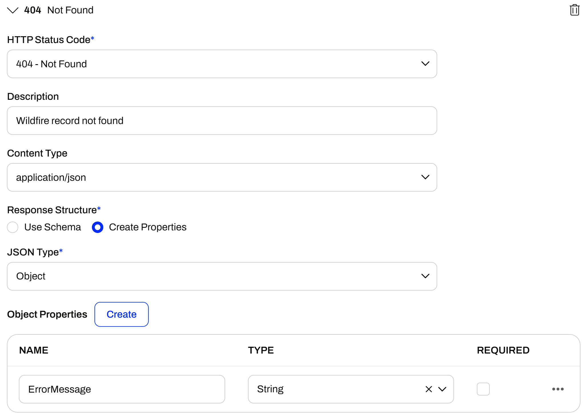

Add a third status code, 404 – Not Found, for requests targeting a record that does not exist:
Field Value
HTTP Status Code 404 - Not Found
Description Wildfire record not found
JSON Type Object
The 404 status code is unique to endpoints that target a specific resource. If a client references an ID that does not exist in the database, returning 404 is more informative than a generic error.

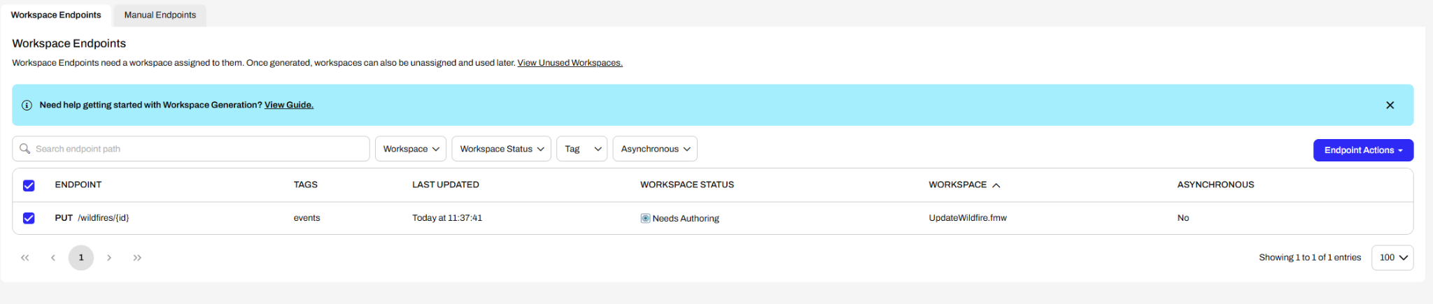

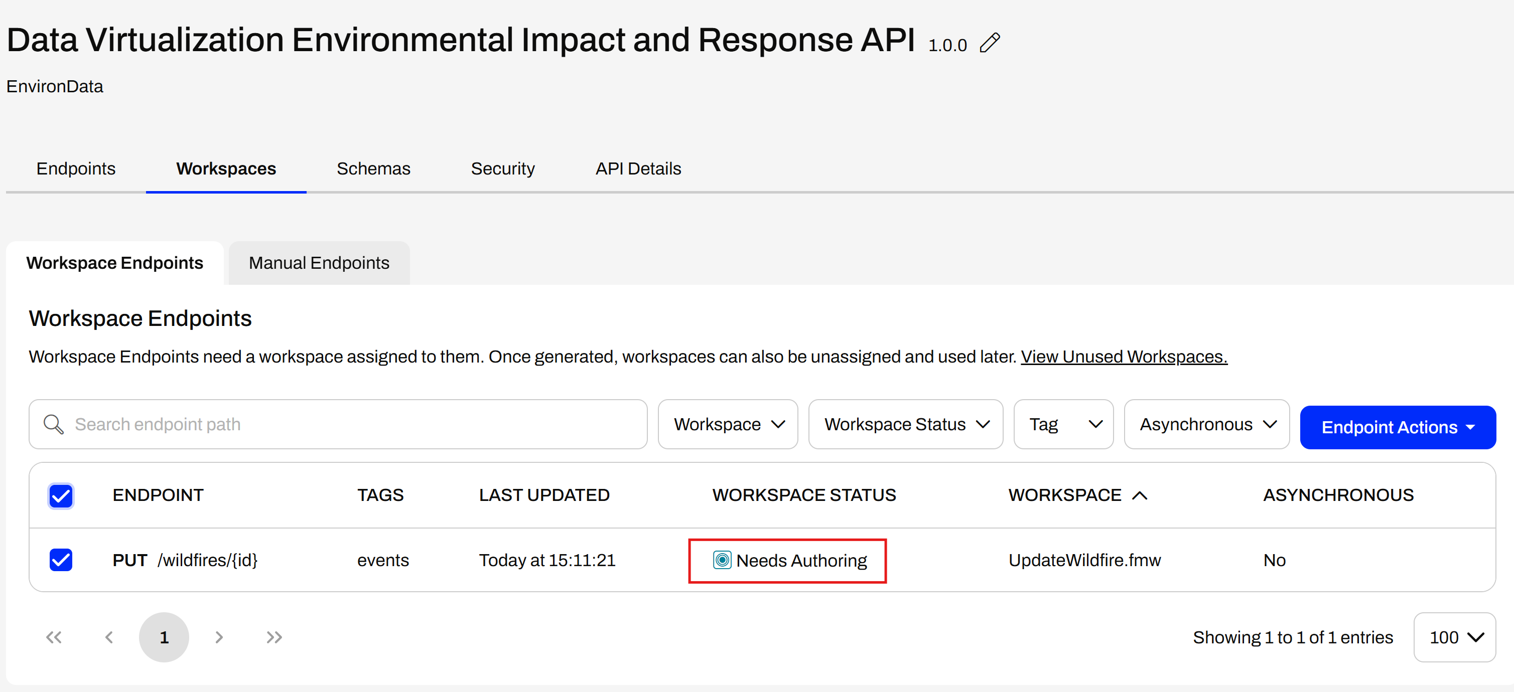

6. Assign a Workspace
Navigate to the Workspaces tab. The new PUT endpoint is listed with Workspace Status as Unassigned.
Click the PUT /wildfires/{id} endpoint and expand the Endpoint Actions menu. Click Generate Workspace.
  • Workspace Name: UpdateWildfire.fmw
Once assigned, the Workspace Status will update to Needs Authoring.

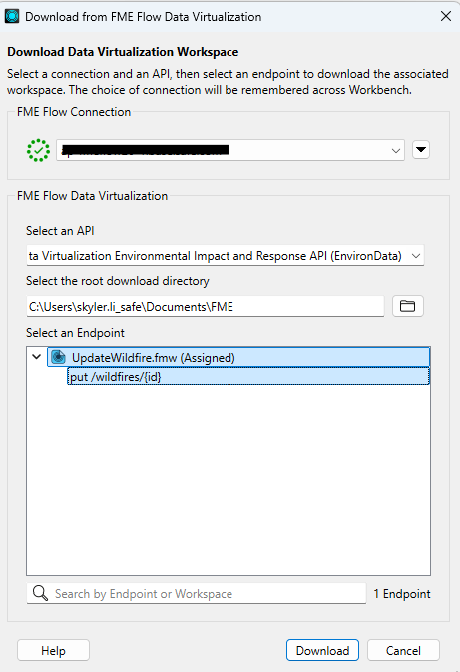

7. Download Workspace
In FME Workbench, open the Data Virtualization menu and click the PUT /wildfires/{id} workspace.
The workspace opens with a Data Virtualization reader of type PUT /wildfires/{id}.

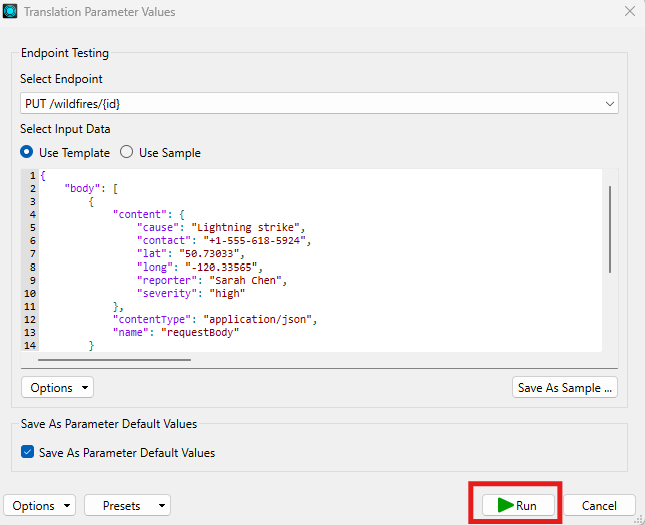

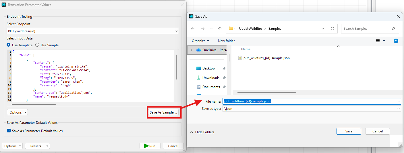

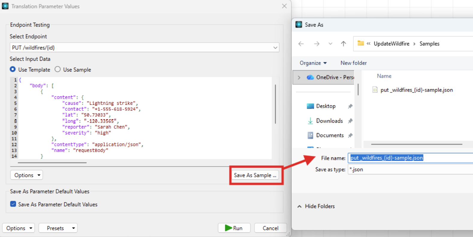

8. Use a PUT Template
Run the workspace.
In the Translation Parameter Values dialog, click Use Template and update the template with sample data:
   "body": [
         "content": {
            "cause": "Lightning strike",
            "contact": "+1-555-618-5924",
            "lat": "50.73033",
            "long": "-120.33565",
            "reporter": "Sarah Chen",
            "severity": "high"
         "contentType": "application/json",
         "name": "requestBody"
   "method": "PUT",
   "path": "/wildfires/{id}",
   "pathParameters": {
      "id": "FIR-101"
Then click Save As Sample and give the template a name, for example, put_wildfires_{id}-sample.json.

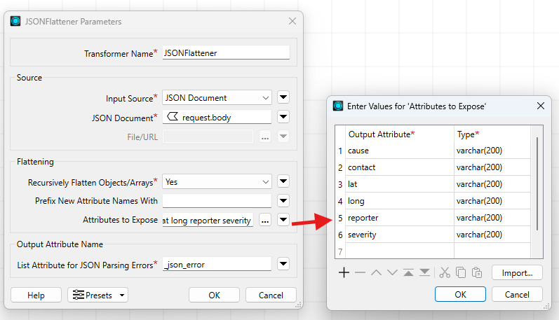

9. Parse the Body Contents
Add a JSONFlattener to the workspace and connect it to the PUT /wildfires/{id} feature type.
Double-click the JSONFlattener to configure its parameters. Under Source parameters, set JSON Document to the request.body attribute. Under Attributes to Expose, add all WildfireUpdateRequest schema properties:
  • cause
  • contact
  • lat
  • long
  • reporter
  • severity
Click OK to close.

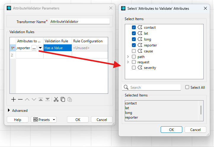

10. Check for Required Parameters
Add an AttributeValidator to the canvas and connect it to the JSONFlattener. Set the following parameters:
  • Attributes to Validate:
    • contact
    • lat
    • long
    • reporter
  • Validation Rule: Has a Value
Features that fail validation will be routed to the Failed port and return a 400 response.
Click OK to close.

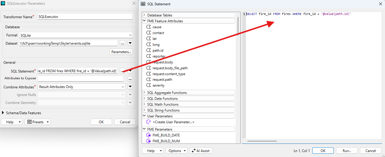

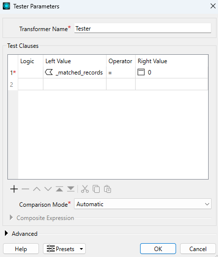

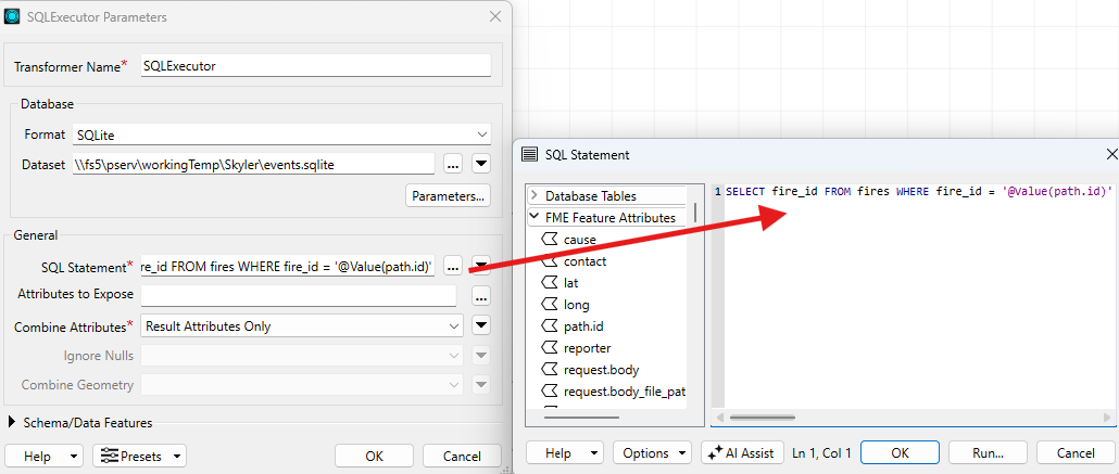

11. Check Whether the Record Exists
Before updating, the workspace must verify that the target wildfire record exists. If it does not, a 404 response should be returned rather than attempting a silent no-op update.
Add a SQLExecutor to the canvas and connect it to the Passed port of the AttributeValidator.
Double-click the SQLExecutor to configure its parameters. Set the connection to the events SQLite database. In SQL Statement, enter:
SELECT fire_id FROM fires WHERE fire_id = '@Value(path.id)'
This query returns a _matched_records attribute indicating how many matching rows exist.
Connect the Initiator port to a Tester. Double-click the Tester and configure the following clause:
  • Clause 1:
    • Left Value: _matched_records
    • Operator: =
    • Right Value: 0
Features that pass this test (no matching record found) will return a 404 response. Features failing it (record exists) proceed to the update step.
Click OK to close.

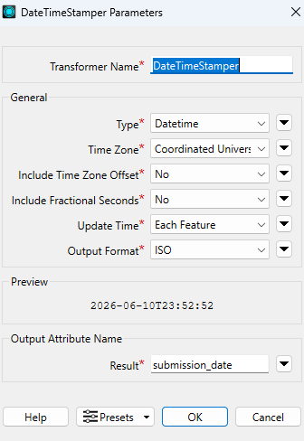

12. Add a Datetime Attribute
For a PUT operation, updating the submission_date reflects when the record was last modified.
Add a DateTimeStamper to the canvas and connect it to the Failed port of the Tester from step 11 (where _matched_records ≠ 0, meaning the record exists).
Double-click the DateTimeStamper to configure its parameters. Set Include Fractional Seconds to No. Rename the Result attribute to submission_date.
Click OK to close.

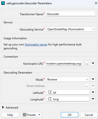

13. Geocode the Coordinates
Add a Geocoder to the workspace and connect it to the DateTimeStamper.
Double-click the Geocoder to configure its parameters. Use a Geocoder Service of your choice, or use the free OpenStreetMap service for this example. Set Mode to Reverse and set the Latitude and Longitude parameters to the lat and long attributes respectively.
Click OK to close.
The Geocoder creates an _address attribute that will be written to the location column.

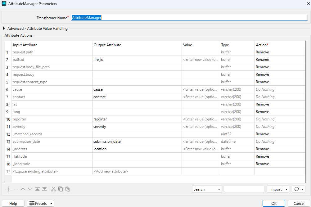

14. Filter the Attributes
Add an AttributeManager to the canvas and connect it to the Geocoder (or DateTimeStamper if you skipped the Geocoder). Double-click the AttributeManager and configure the following actions:
  • Rename the following attributes:
    • Input Attribute: path.id
      • Output Attribute: fire_id
    • Input Attribute: _address
      • Output Attribute: location
  • Remove the following attributes:
    • request.path
    • request.body_file_path
    • request.body
    • request.content_type
    • _matched_records
    • _latitude
    • _longitude
    • lat
    • long
Click OK to close.

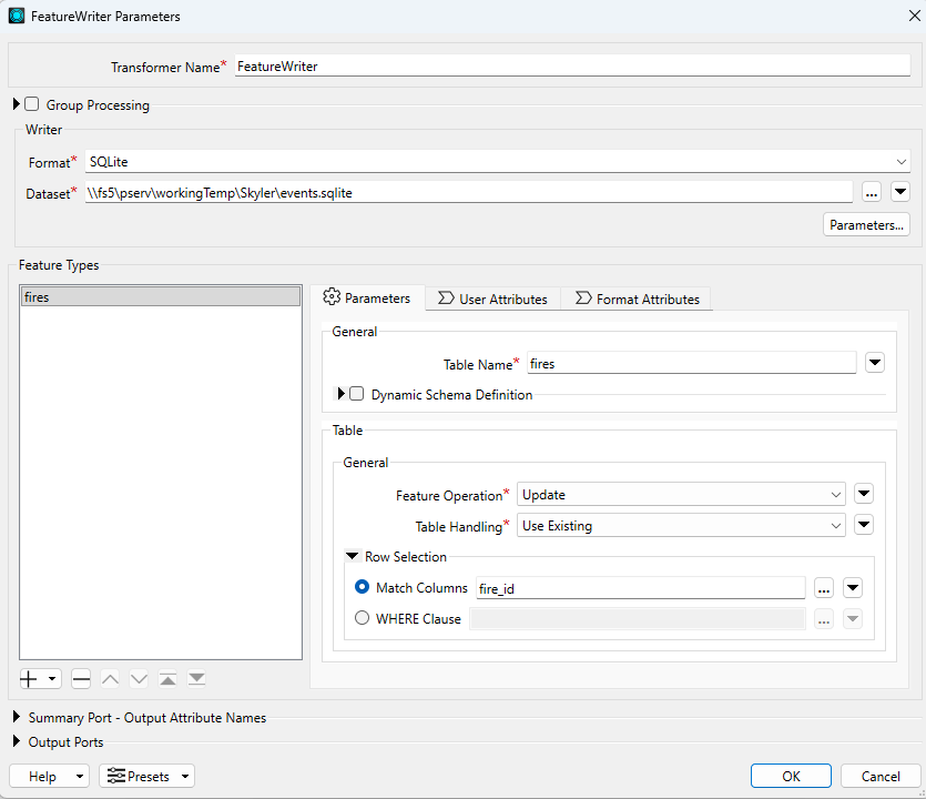

15. Update the Database Record
Add a FeatureWriter to the canvas and connect it to the AttributeManager. Double-click the FeatureWriter to configure its parameters. Set the connection to the events SQLite database.
Configure the following:
  • Table Name: fires
  • Table Handling: Use Existing
  • Feature Operation: Update
  • Match Columns: fire_id
The fire_id column is the WHERE clause key. FME will update only the row where fire_id matches the value from path.id.
Click OK to close.

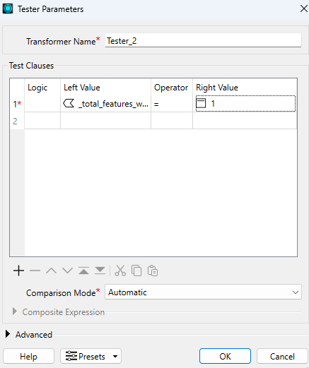

16. Test for a Successful Update
Add a Tester to the canvas and connect it to the FeatureWriter's Summary port. Double-click the Tester and configure the following clause:
  • Clause 1:
    • Left Value: _total_features_written
    • Operator: =
    • Right Value: 1
Click OK to close.

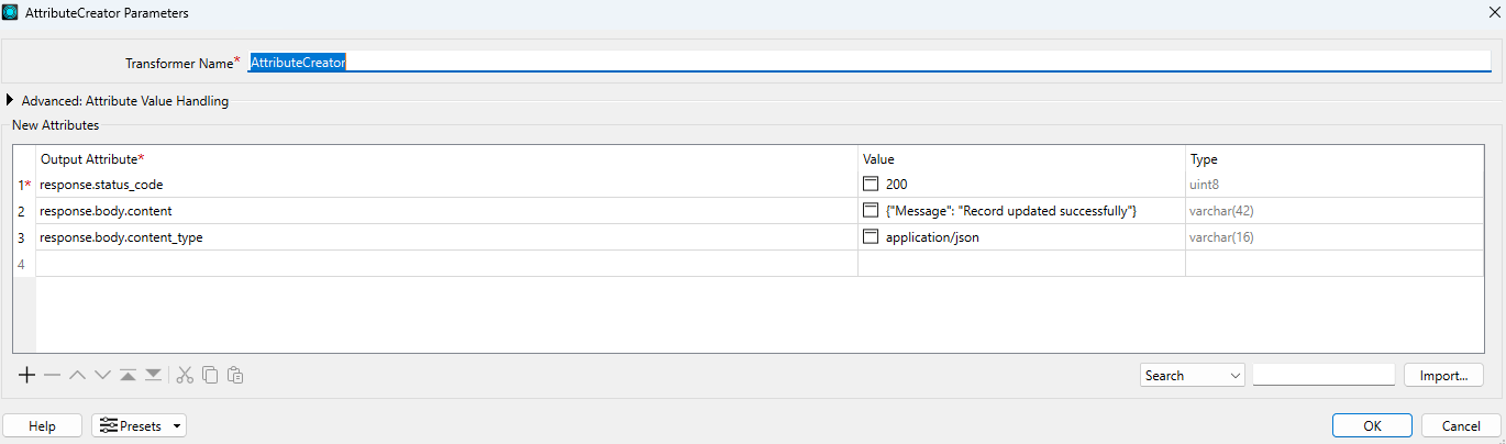

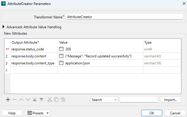

17. Format Successful Response Attributes
Add an AttributeCreator and connect it to the Tester's Passed port. Double-click the AttributeCreator and create the response attributes for the 200 status code:
  • Output Attribute: response.status_code
    • Value: 200
  • Output Attribute: response.body.content
    • Value: {"Message": "Record updated successfully"}
  • Output Attribute: response.body.content_type
    • Value: application/json
Connect this AttributeCreator to the Data Virtualization writer, http_response.
The successful (200) workflow is now complete.

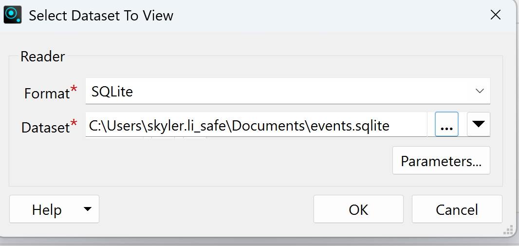

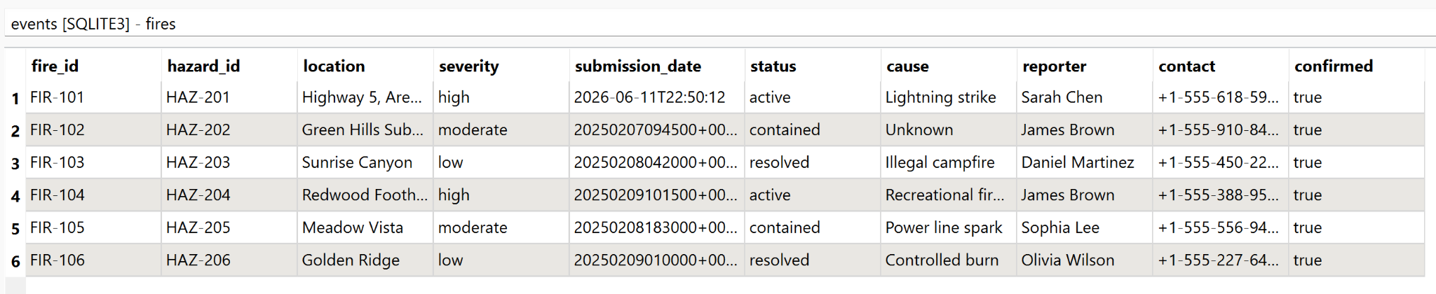

20. Test the Workspace
Run the workspace with the sample template from step 8.
To confirm the update, open the events.sqlite database in the FME Data Inspector and verify the modified values appear on the targeted row.
Save the workspace.

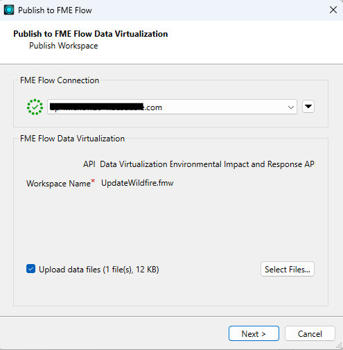

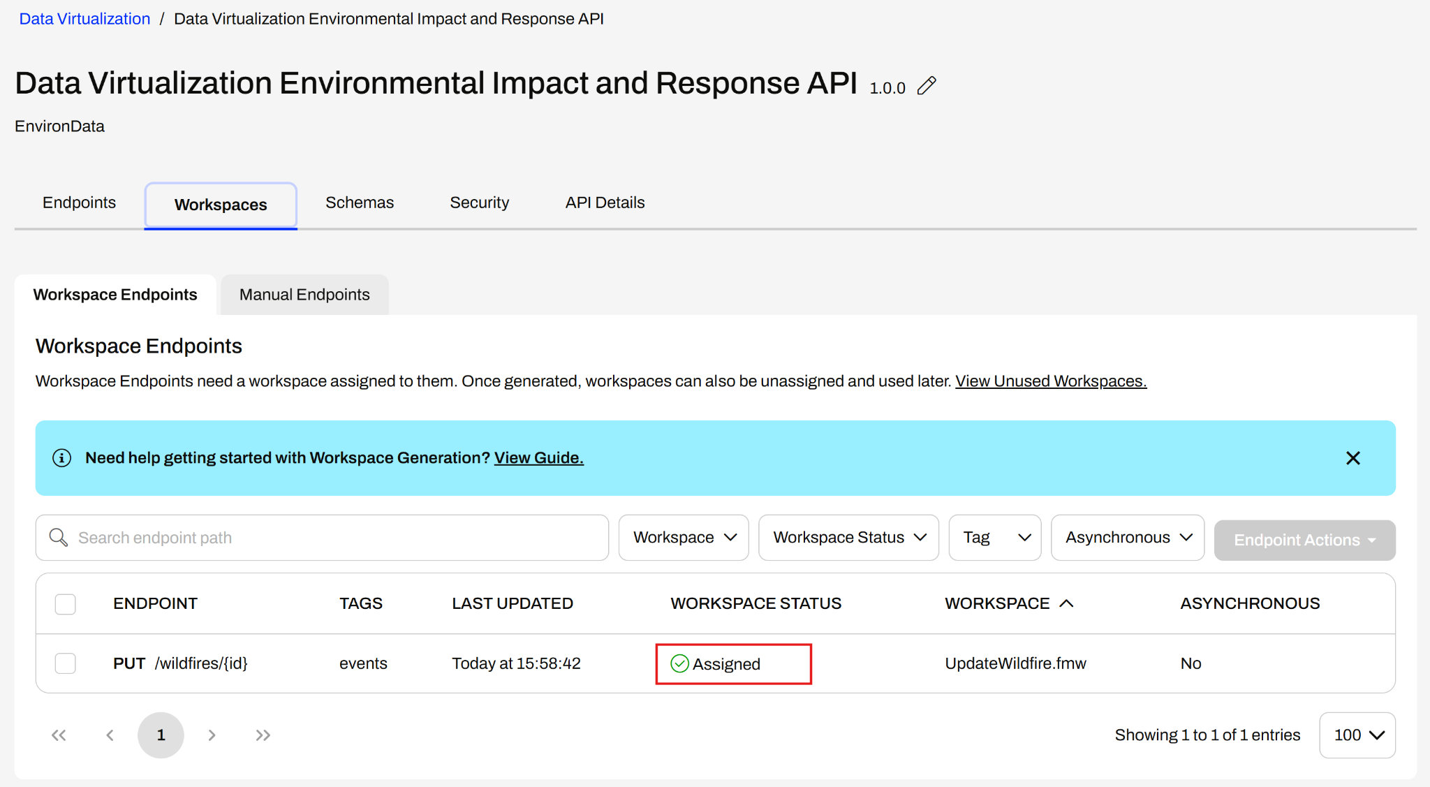

21. Publish to FME Flow
Publish the workspace to FME Flow, uploading the Geocoder package if used.
Confirm the PUT /wildfires/{id} Workspace Status is now Assigned.

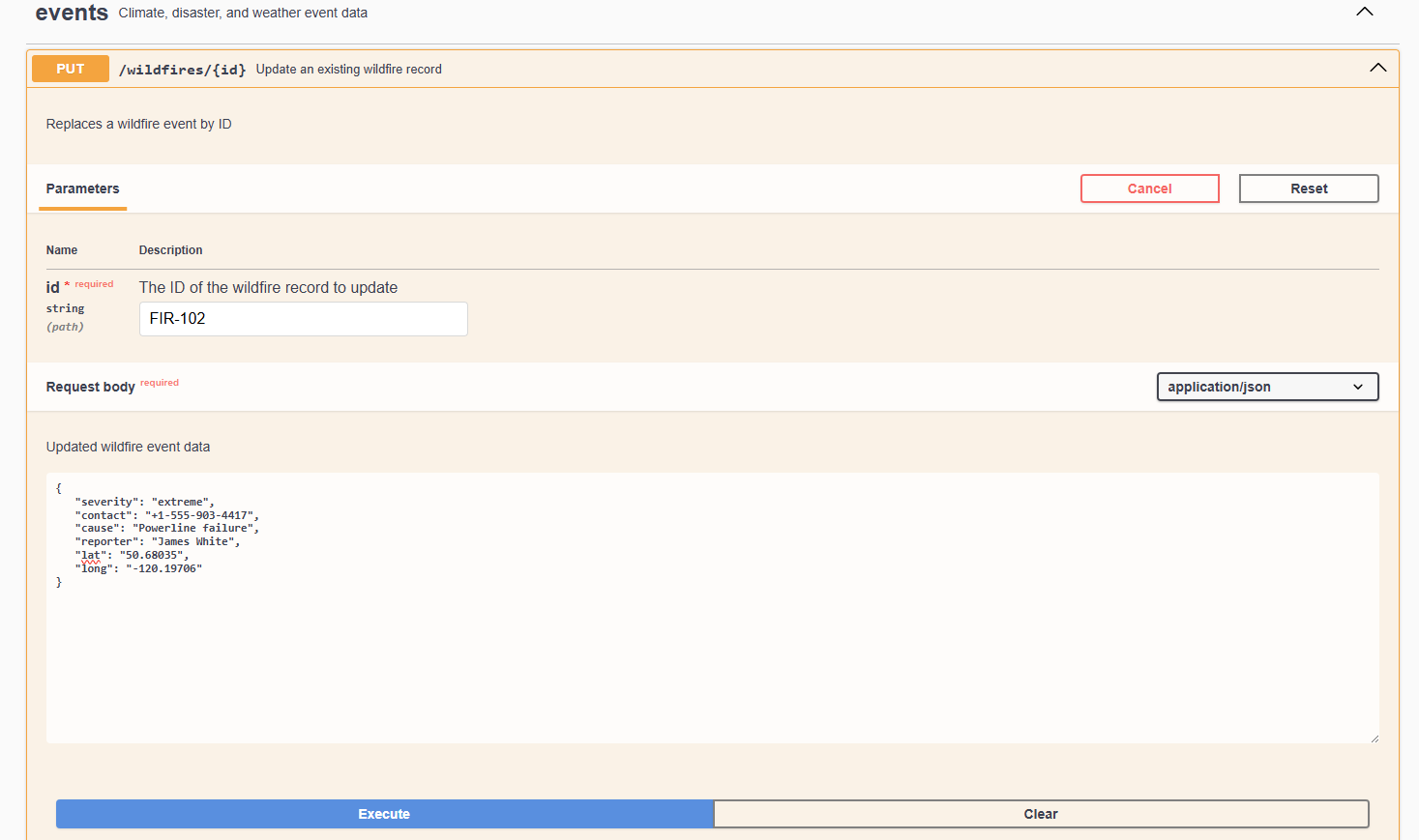

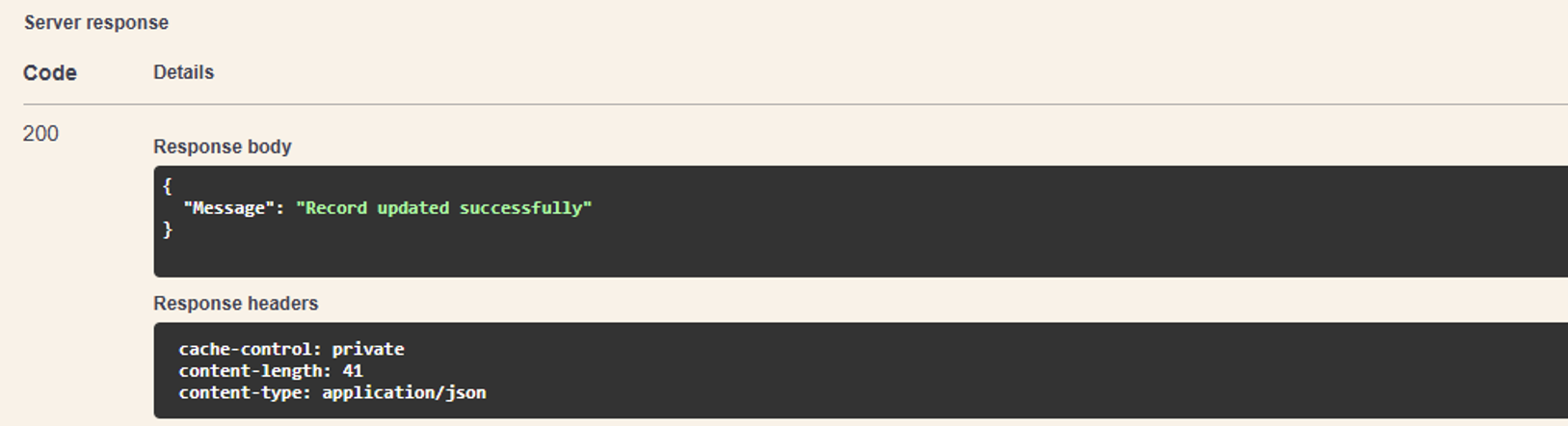

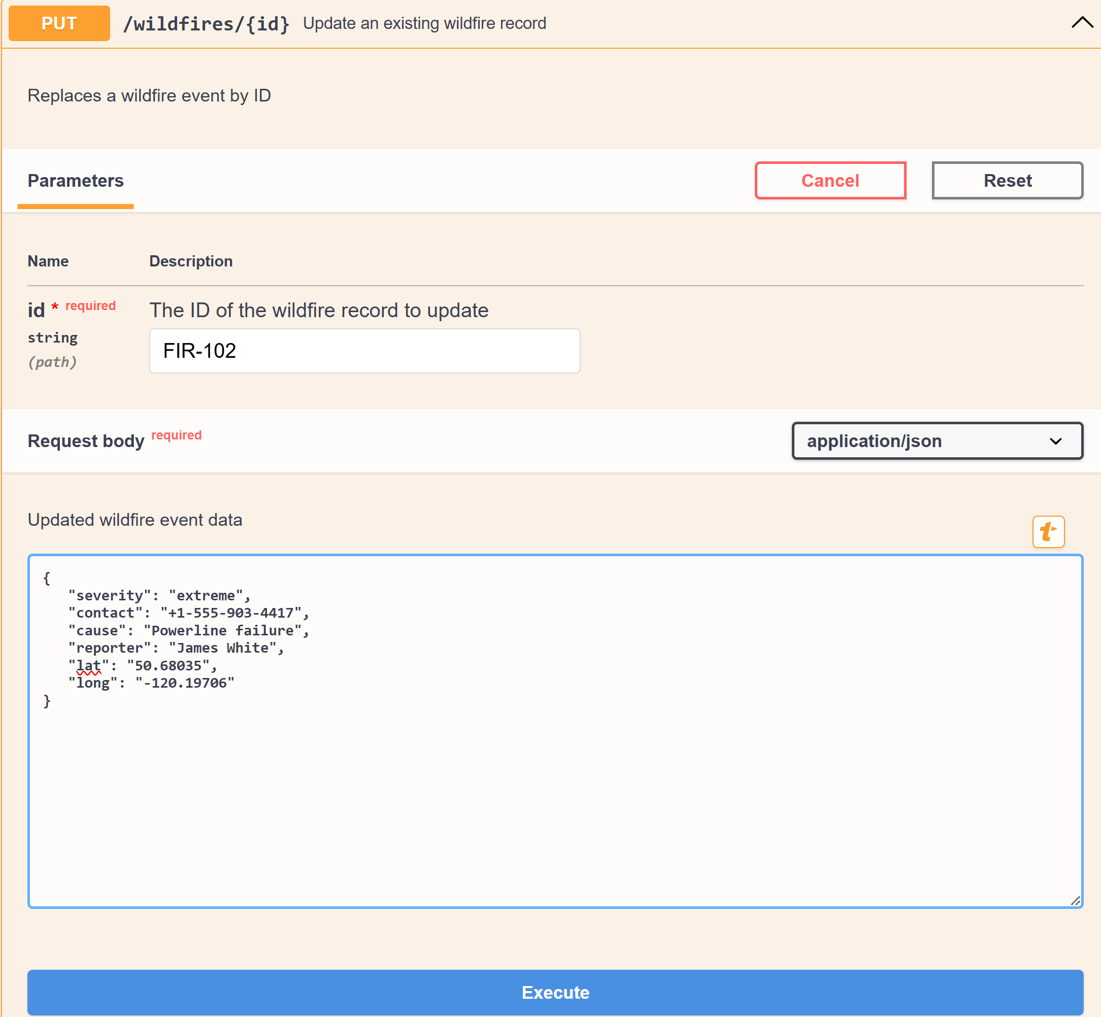

22. Test the Request from a Client
Find the PUT /wildfires/{id} endpoint in the EnvironData API Swagger documentation. Click Try it Out.
Set the id path parameter to an existing wildfire ID (for example, FIR-102). Replace the request body with the following sample:
   "severity": "extreme",
   "contact": "+1-555-903-4417",
   "cause": "Powerline failure",
   "reporter": "James White",
   "lat": "50.68035",
   "long": "-120.19706"
Click Execute.
A 200 – OK response confirms the PUT /wildfires/{id} endpoint is working correctly.
To test the 404 path, repeat with an ID that does not exist. To test the 400 path, omit a required field such as contact.
