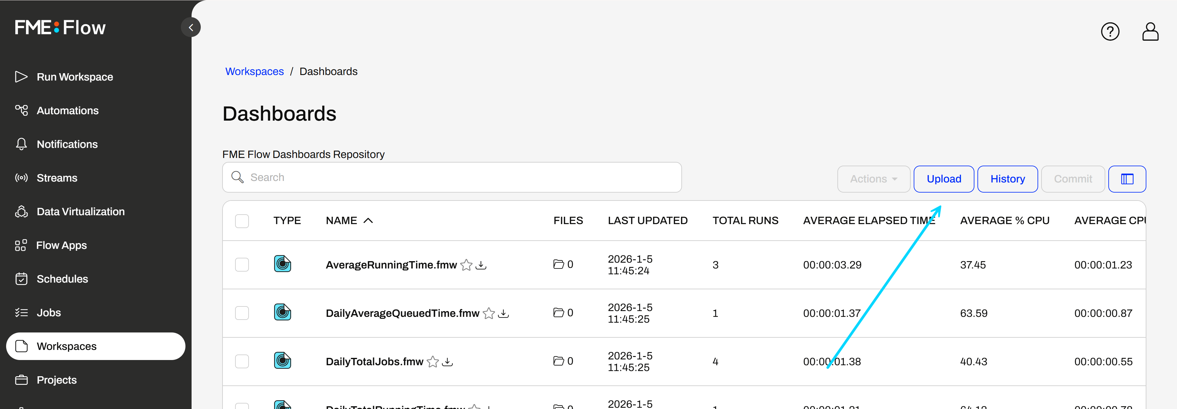

Download the zip file in Attachments, extract it, and publish the new workspaces to FME Flow.
This can either be done in the FME Flow UI:

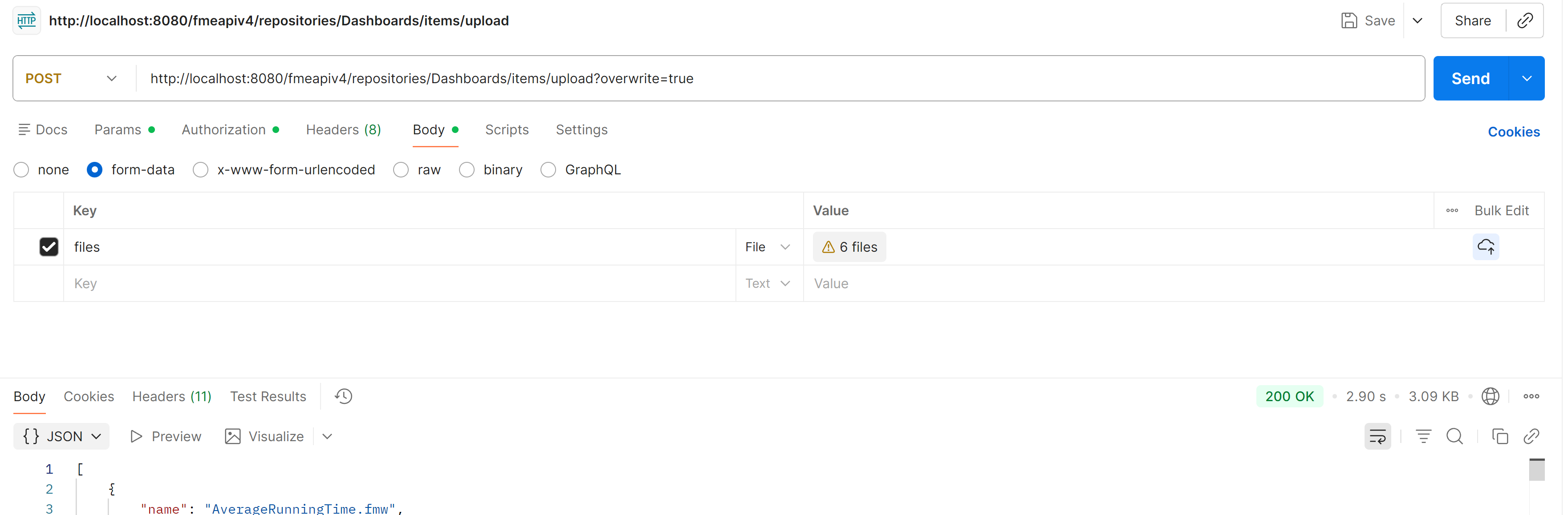

Or can be done in a single API call for each repository, using the endpoint POST /repositories/{repository}/items/upload?overwrite=true:
