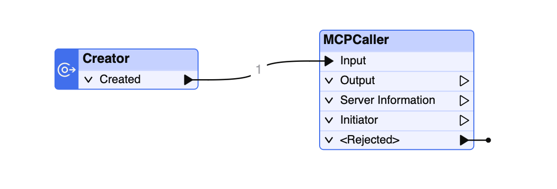

Add a Creator transformer to the canvas. The Creator generates a single feature that will trigger the MCPCaller request.

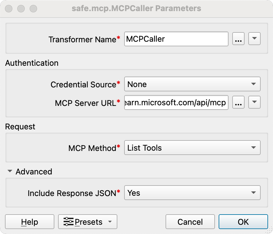

2. Add an MCPCaller Transformer
Add an MCPCaller transformer to the canvas and connect it to the Creator.
This first MCPCaller will connect to the MCP server and list the tools that are available.

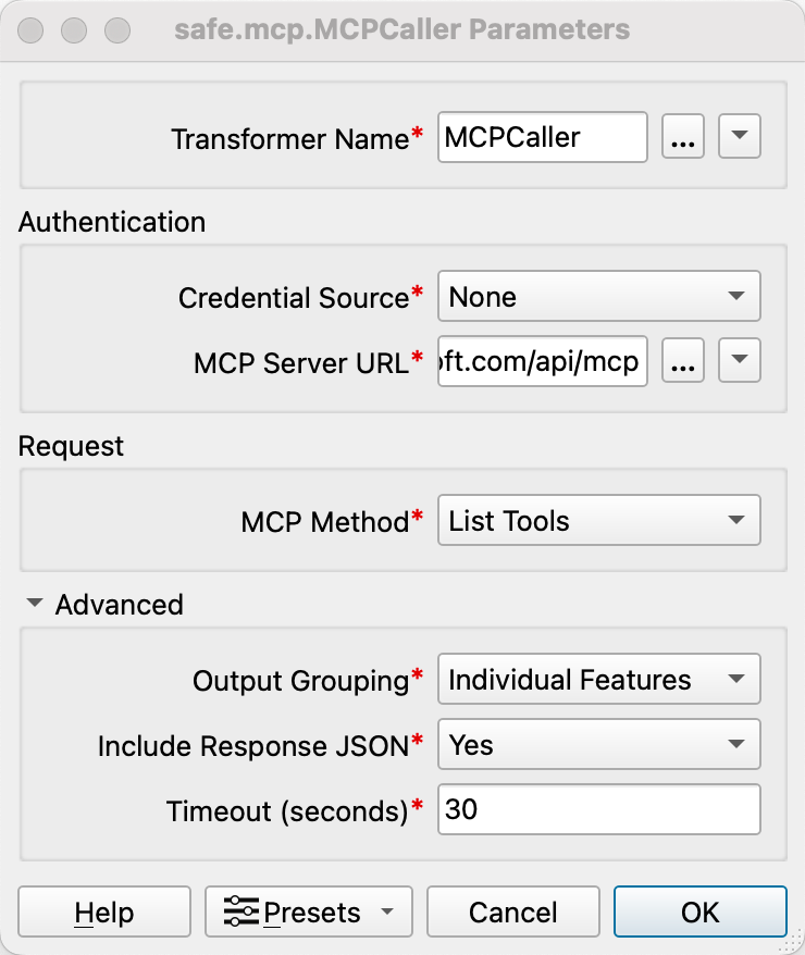

In the MCPCaller parameters, set:
  • Credential Source: None
  • MCP Server URL: https://learn.microsoft.com/api/mcp
  • MCP Method: List Tools
  • Output Grouping: Individual Features
  • Include Response JSON: Yes
  • Timeout: 30
Click OK.
Three parameters are grouped under Advanced for this MCP Method:
  • Output Grouping: Controls how the tool list is returned. Individual Features (default) outputs one feature per tool. Single Feature with List outputs a single feature with all tools in a _tools{} list attribute, which can be passed to an LLM so it can choose which tool to call at runtime.
  • Include Response JSON: Adds the raw server response as _json_response when set to Yes.
  • Timeout (seconds): Sets how long MCPCaller waits for the server to respond. Default is 30 seconds.

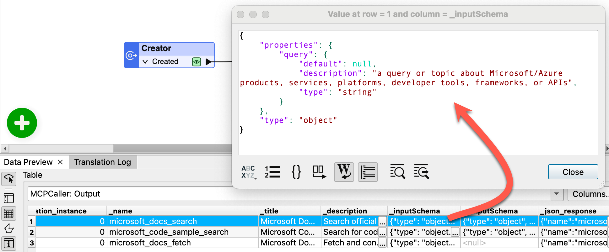

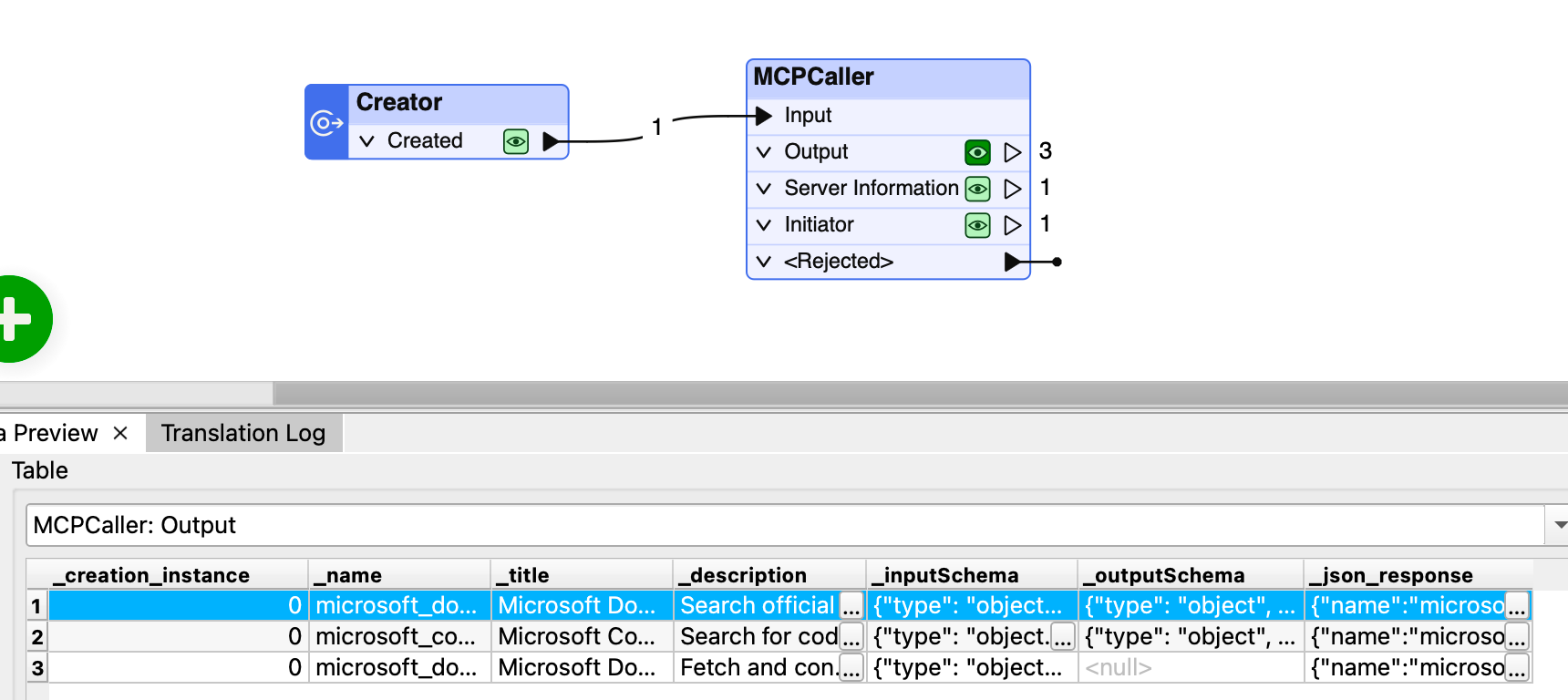

3. Run the Workspace
Run the workspace.
Open Visual Preview and inspect the output from MCPCaller. The transformer should return one output feature for each tool available from the MCP server.
The key output attributes are:
  • _name: The unique tool name used when calling the tool
  • _title: A user-friendly title, if provided by the server
  • _description: A description of what the tool does
  • _inputSchema: The JSON schema that defines the expected input for the tool
  • _outputSchema: The JSON schema that defines the output structure, if provided
  • _json_response: The full MCP response, if Include Response JSON is enabled
4. Review the Tool Name and Input Schema
Select a documentation search tool from the Visual Preview output. The tool name may appear as:
  • microsoft_docs_search
Review the _inputSchema attribute for that tool. The input schema tells you what JSON input is required when the tool is called.
For a search-style tool, the schema will typically include a text field for the search query.

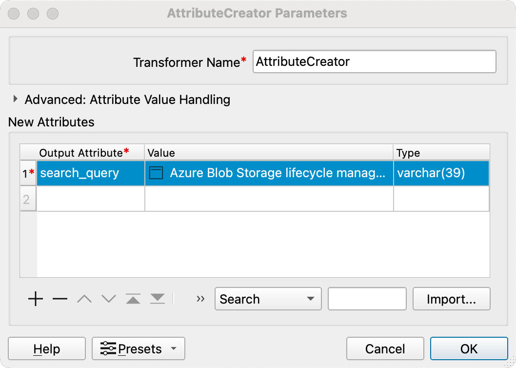

1. Add an AttributeCreator
Add an AttributeCreator transformer to the canvas and connect it to the Creator.
We will use this transformer to create a search query attribute. This attribute will be inserted into the MCPCaller JSON input.
In the AttributeCreator parameters, create the following attribute:
  • Attribute Name: search_query
  • Value: Azure Blob Storage lifecycle management
Click OK.
This value can be changed later to test other MCP tool inputs. For example:
  • "Azure Functions HTTP trigger"
  • "Microsoft Graph authentication"
  • "Power BI REST API"

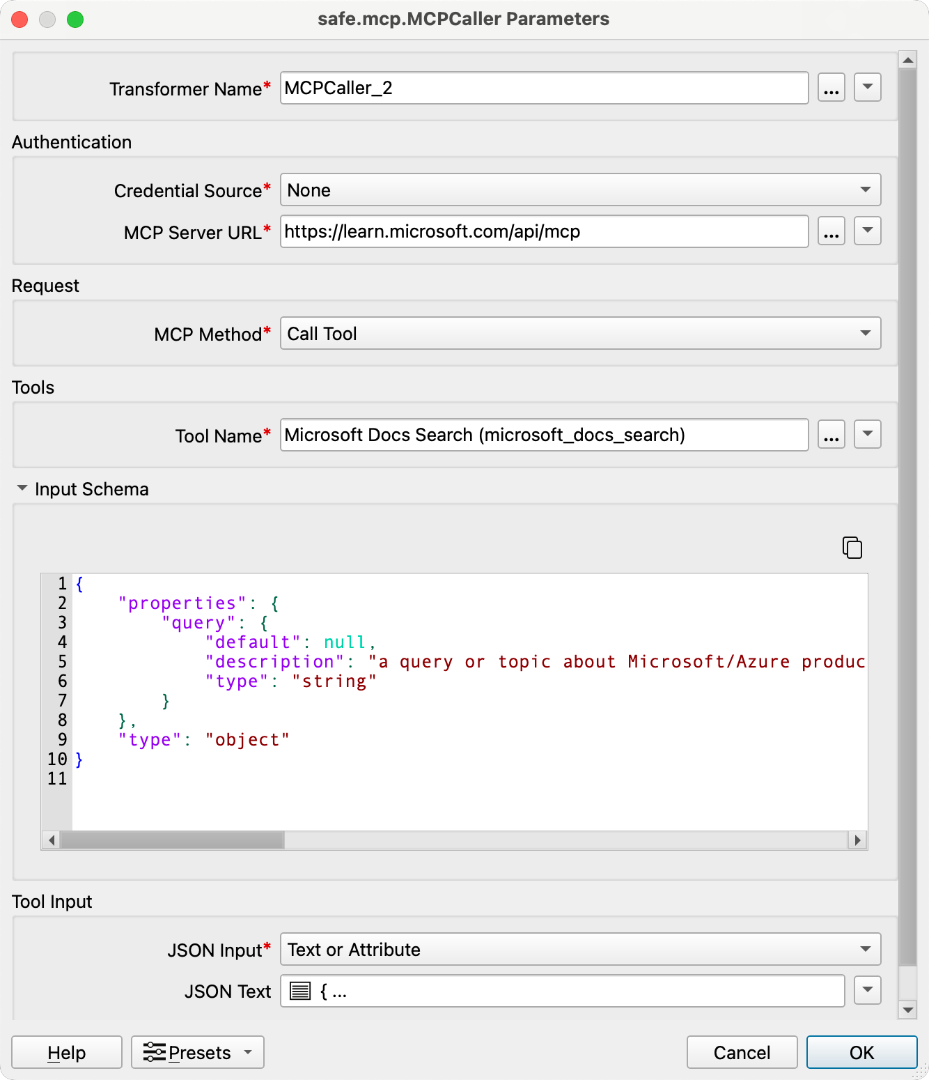

2. Add a Second MCPCaller Transformer
Add a second MCPCaller transformer to the canvas and connect it to the AttributeCreator.
This MCPCaller will call a specific tool instead of listing all available tools.
  • MCP Method: Call Tool
  • Tool Name: microsoft_docs_search
  • JSON Input: Text or Attribute

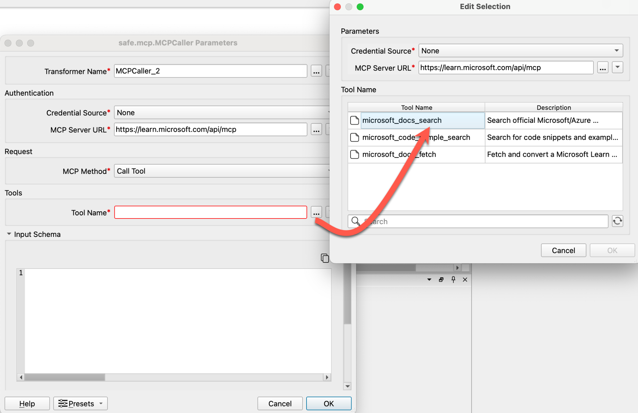

If the tool browse button is available, use it to select the tool from the MCP server instead of typing the tool name manually.
Click OK after configuring the transformer.

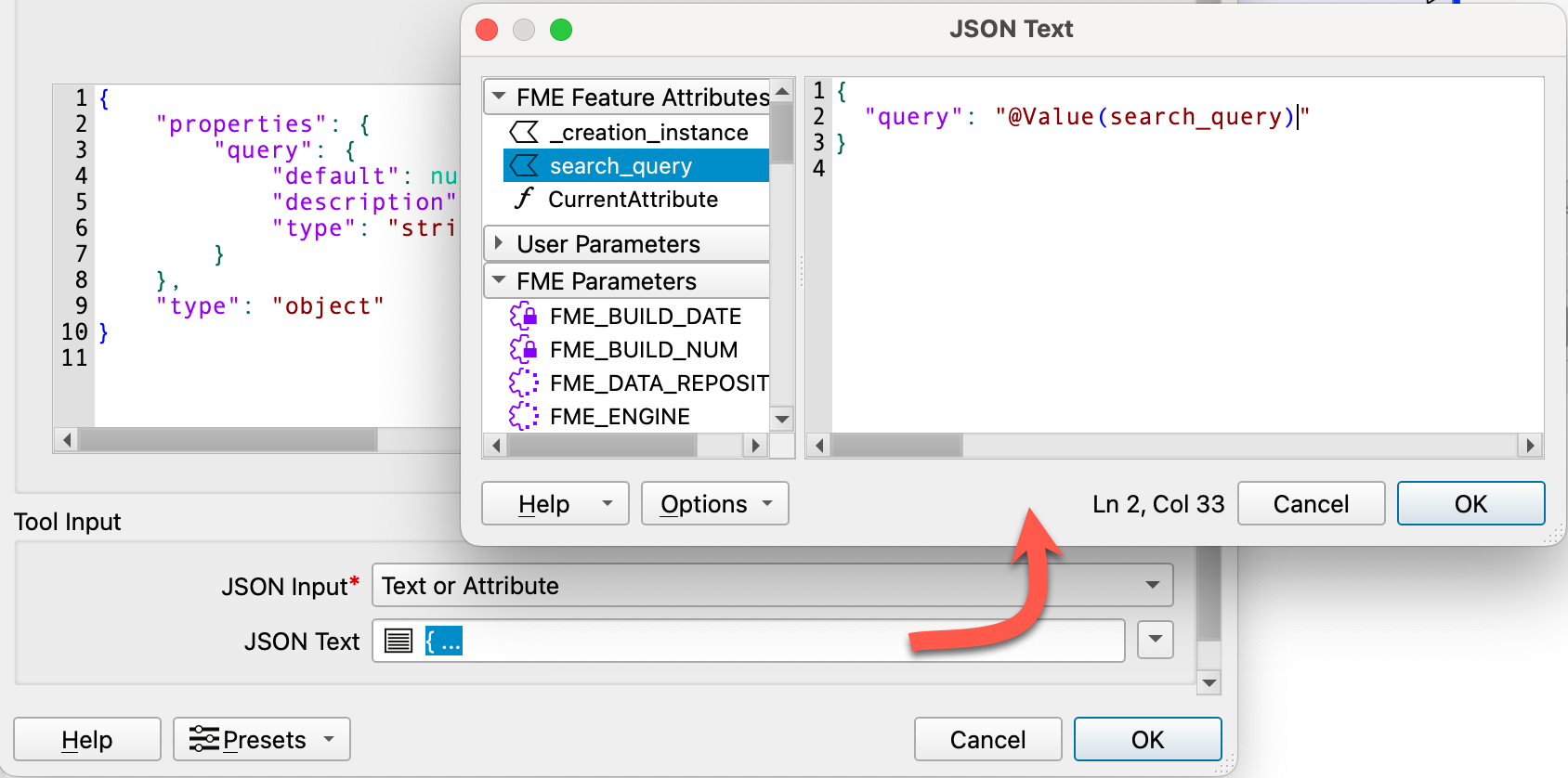

When a tool is selected, MCPCaller displays the tool’s Input Schema and may populate the JSON Text parameter with a template based on that schema. Use this template as the starting point, then replace static values with FME attribute references where needed.
3. Configure the JSON Input
In the JSON Text parameter, the input must be valid JSON and must match the schema expected by the selected MCP tool (as seen in Part 1).
For this example, use:
  "query": "@Value(search_query)"
The @Value(search_query) expression inserts the value from the search_query attribute created earlier.
Click OK.

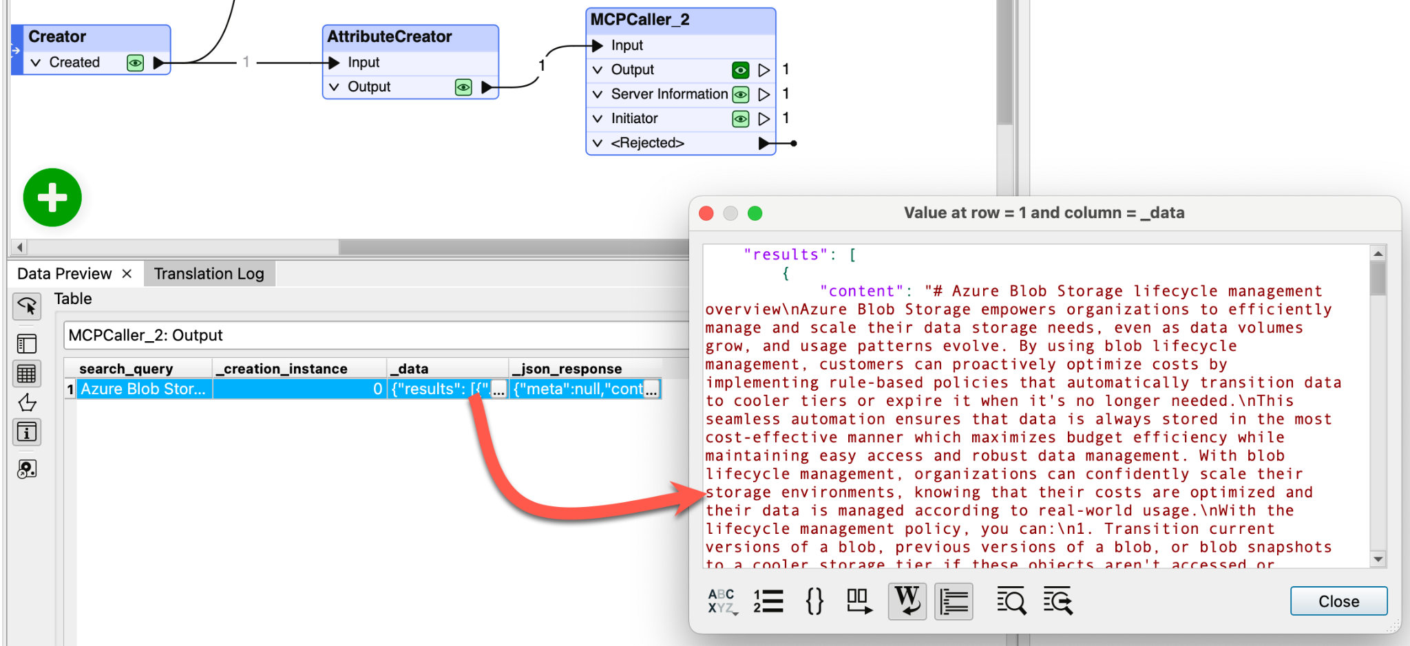

4. Run the Workspace
Run the workspace.
The second MCPCaller sends the JSON input to the selected MCP tool and returns the tool result through the Output port.
For this example, the main output attribute is:
  • _data: The JSON data returned by the tool
Open Visual Preview and inspect the feature from the Output port. The _data attribute contains the response from the Microsoft Docs Search tool. This is the data you will usually continue processing in the workspace.
Depending on the MCP tool and server response, additional content attributes may also be present, such as _content{} or _content{}.text. These attributes are used for MCP content blocks, such as text or other content returned by a tool. For this example, focus on _data.
If Include Response JSON is set to Yes, MCPCaller also returns _json_response, which contains the complete raw JSON response. This can be useful for troubleshooting or for inspecting fields that are not exposed directly as attributes.

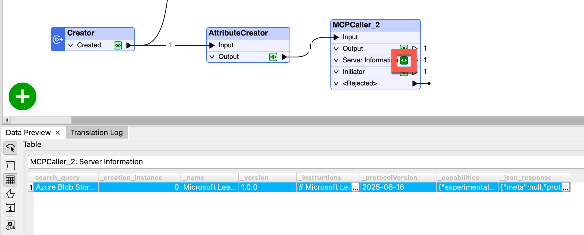

5. Review the Server Information Port
MCPCaller also outputs a feature through the Server Information port when it successfully connects to the MCP server.
The Server Information port does not contain the tool result. Instead, it contains metadata about the MCP server connection. This output is useful for confirming which MCP server responded and what capabilities it reported during initialization.
Server Information output attributes may include:
  • _name: The name of the MCP server
  • _version: The server version
  • _protocolVersion: The MCP protocol version used by the server
  • _instructions: Instructions provided by the server, if available
  • _capabilities: JSON describing the server’s declared capabilities
  • _json_response: The full server information response, if Include Response JSON is enabled
Open Visual Preview and inspect the feature from the Server Information port.
In most workflows, the Output port is the stream used for downstream processing. The Server Information port is mainly useful for validation and troubleshooting.

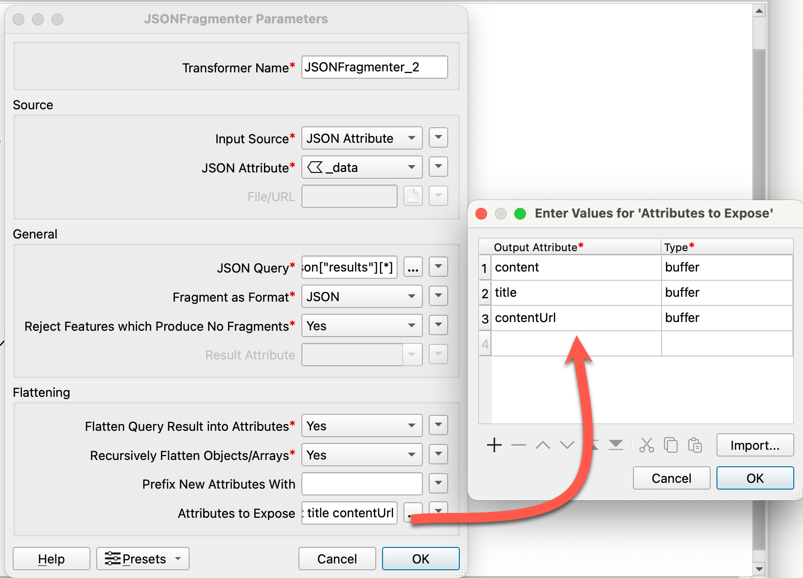

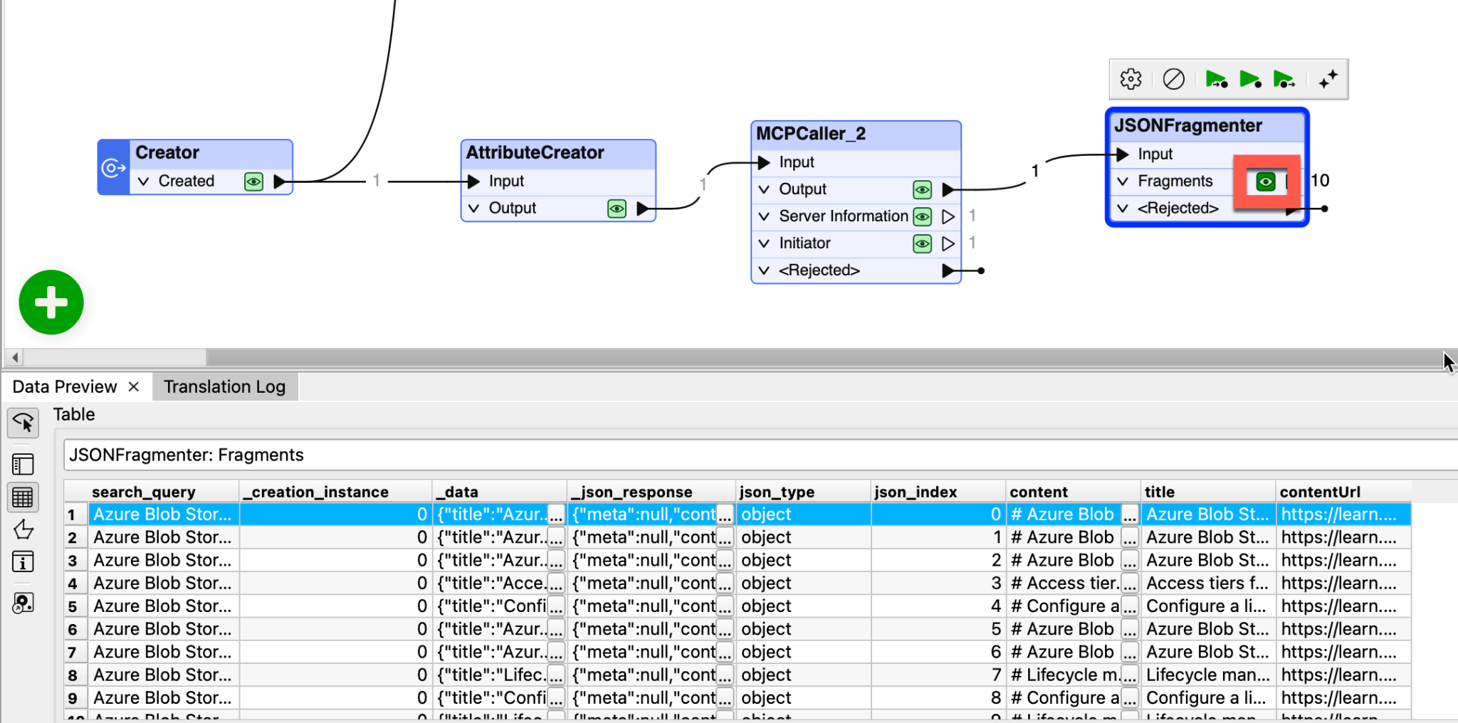

6. Parse the Tool Response with JSONFragmenter
The MCPCaller Output port returns the tool result in the _data attribute. In this example, _data contains a JSON object with a results array. Each item in the results array is one Microsoft Learn search result.
To make these results easier to use in FME, add a JSONFragmenter after the MCPCaller Output port.
Configure the JSONFragmenter parameters as follows:
  • JSON Attribute: _data
  • JSON Query: json["results"][*]
  • Flatten Query Result into Attributes: Yes
  • Recursively Flatten Objects/Arrays: Yes
  • Attributes to Expose: content, contentUrl, title
The JSON query tells FME to look inside the _data attribute, find the results array, and create one output feature for each result in that array.
Click OK.
Run to the JSONFragmenter.
In this example, the Microsoft Docs Search tool returns 10 results, so the JSONFragmenter creates 10 output features.
Each output feature represents one documentation search result. The useful values from each result include:
  • title: The title of the documentation result
  • content: The returned content excerpt or page content
  • contentUrl: The URL of the source documentation page
