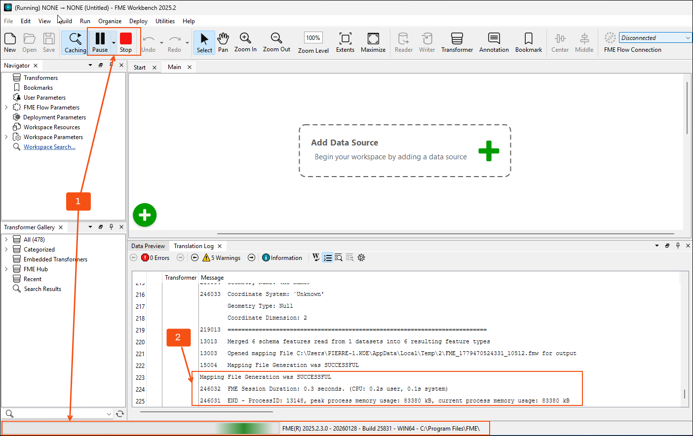

Using the MDB_ADO format in FME 2025.2 and older may cause FME Workbench to get stuck in a state of perpetual translation. Example below, when trying to add an MDB_ADO reader to FME Workbench, the issues are highlighted in orange with explanations:
  1. The translation will not end on its own. Clicking on Stop will cause an error message to appear, saying the translation failed.
  2. Log shows that the reader was successfully added to the workspace, though the FME session is still in progress. A similar issue occurs with Microsoft Access (ADO) readers in existing workspaces, where running the workspace will generate a log that reports that the FME translation was successful, yet FME Workbench itself shows the translation is still running.
At the point where the success message appears on the log, the workspace has finished executing its tasks, and it is safe to press the Stop button. Once clicked, FME will log an error message showing that the translation failed, but the process will already have completed. This will also affect existing workspaces that use the Microsoft Access ADO format.
