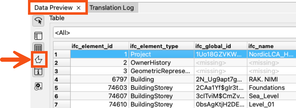

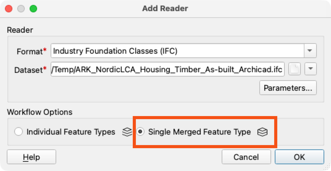

Drag the ARK_NordicLCA_Housing_Timber_As-built_Archicad.ifc file onto the canvas.
On the Add Reader dialog, choose Single Mergerd Feature Type
Click OK to finish adding the reader. Run the workspace with Data Caching enabled.
There are over 5000 features representing both physical (e.g., walls, doors, windows) and non-physical (e.g., project, owner) parts of the model.
We’ll use Data Preview in this article to review results as we go. To avoid lag, disable Graphics View, as shown below.

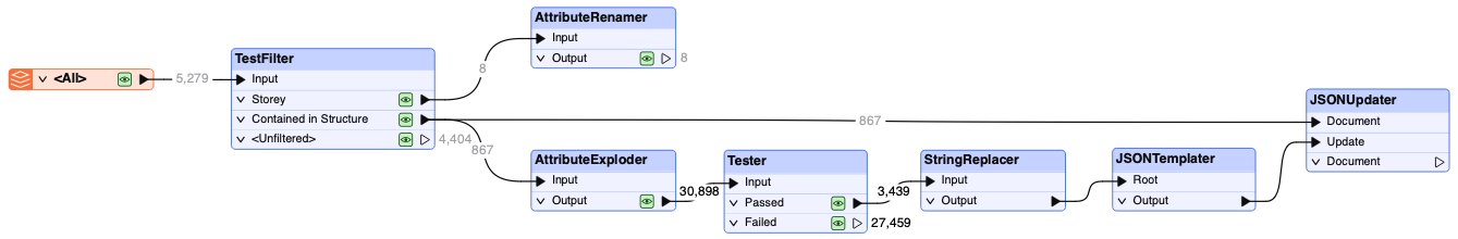

3. Filter Sample Records
For this example, we'll write only the physical elements contained in the building to Snowflake.

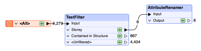

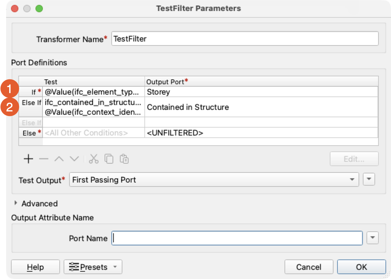

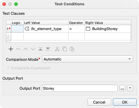

Add a TestFilter to the canvas and connect it to the IFCReader. Double-click the TestFilter to open the parameters. Create the following two tests and output the results to the ports indicated:
1. Click If, then Edit...
ifc_element_type = BuildingStorey
Output Port: Storey
Click OK.

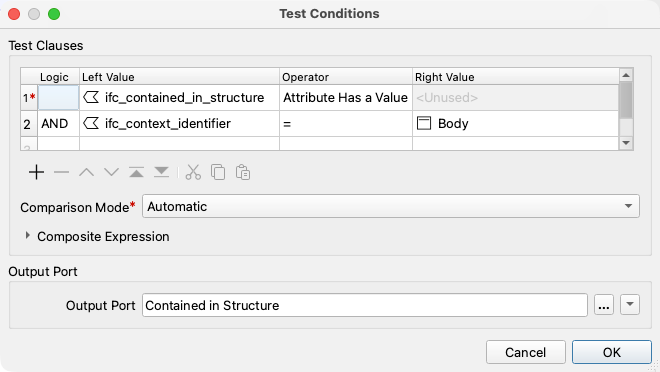

2. Click Else If, then Edit...
Ifc_contained_in_structure = Attribute Has a Value AND ifc_context_identifier = Body
Output Port: Contained in Structure
Click OK.

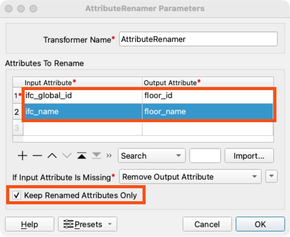

4. Thin the Storey Attributes
IFC files have a massive amount of attributes. Add an AttributeRenamer and connect it to the TestFilter’s Storey Output port. Open the parameters. Rename the following:
  • Ifc_global_id: floor_id
  • Ifc_name: floor_name
Click Keep Renamed Attributed Only to remove the other attributes. Click OK.
Run the workspace. There are 8 floors in the building that will later be joined to each building element.
5. Pivot Properties Into Features
Let’s get the properties for each building element. Each element type has its own property set (Pset), which makes them good candidates to store in a Snowflake Variant.
All of the property sets are currently stored as attributes. We need to pivot the attributes to features so we can work with them in FME.

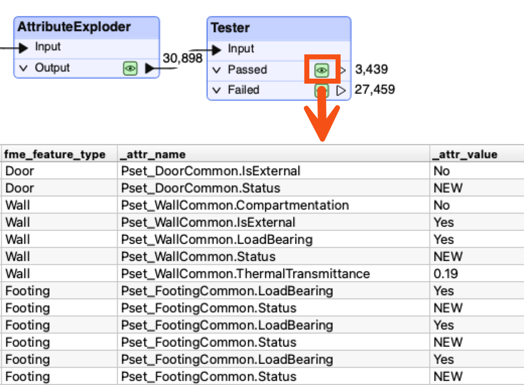

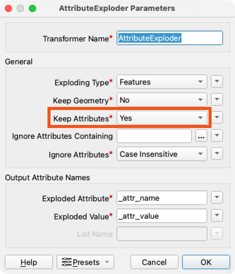

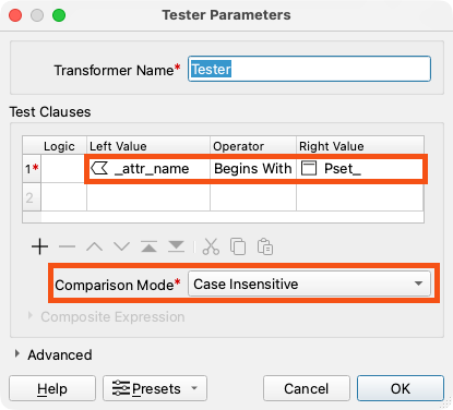

Add an AttributeExploder to the canvas and connect it to the TestFilter’s Contained in Structure Output port. In the AttributeExploder parameters, set Keep Attributes to Yes. Click OK.
Connect a Tester to the Output port of the AttributeExploder and open the parameters. Test for _attr_name Begins With Pset_. Set the Comparison Mode to Case Insensitive. Click OK
Run the workspace up to the Tester and inspect the Passed features in Data Preview. Given there are so many attributes, you may need to scroll far to the right in Data Preview until you see the attributes for the property sets.
6. Create the JSON Fragments

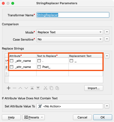

The _attr_name values will become JSON keys. Let’s clean them up a bit first. Add a StringReplacer to the canvas and connect it to the Tester’s Passed port. Open the parameters and add the following two string replacements for _attr_name:
  1. Text to Replace: . Replacement Text: _
  2. Text to Replace: Pset_ Replacement Text: (leave empty)
Click OK.

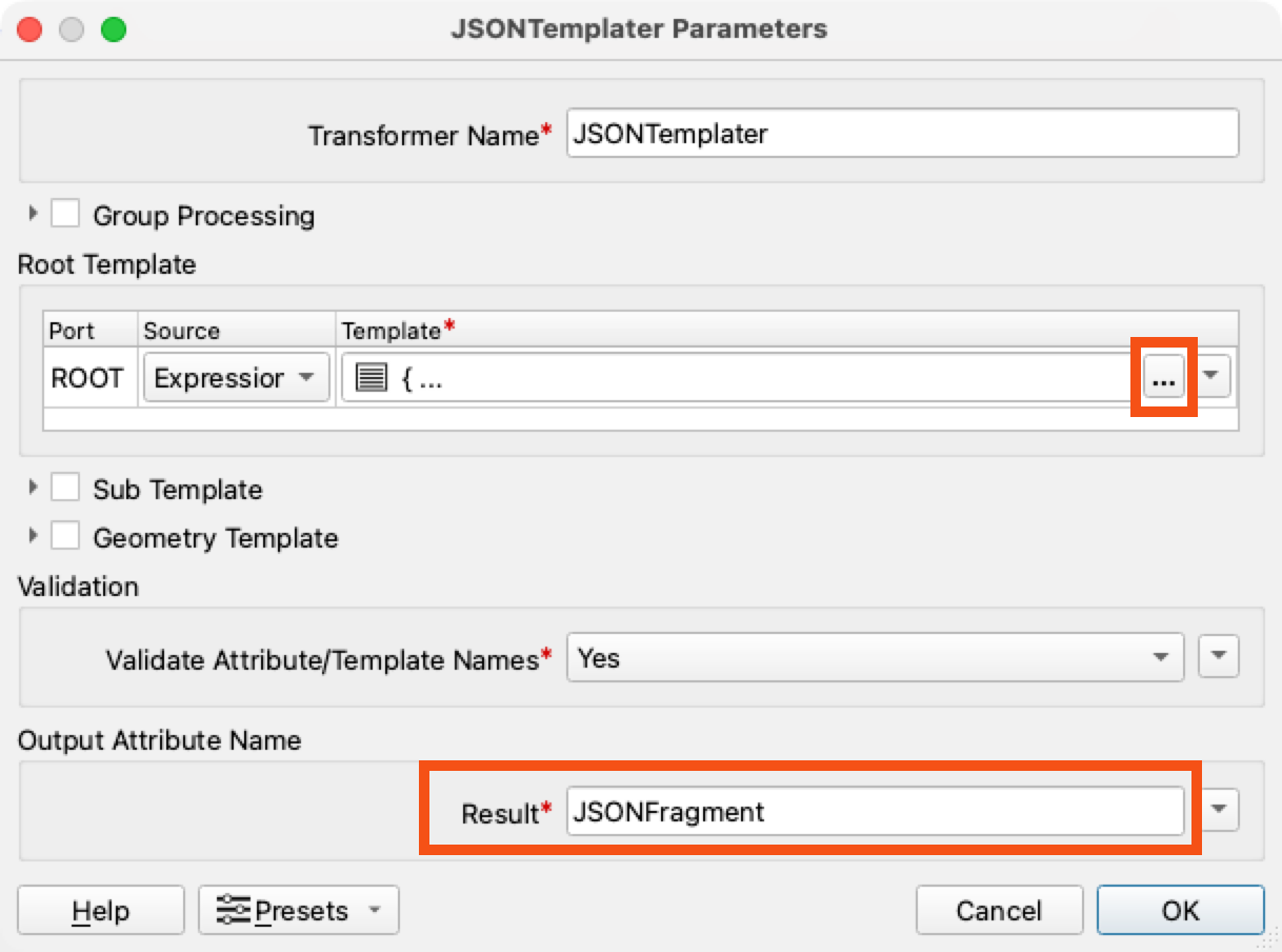

Add a JSONTemplater to the canvas and connect it to the StringReplacer’s Output port. Open the parameters. Click [...] to open the editor and then add the template expression below:
    fme:get-attribute("_attr_name"): fme:get-attribute("_attr_value")
Click OK to close the editor.
Name the Output Attribute JSONFragment and click OK to close the JSONTemplater.

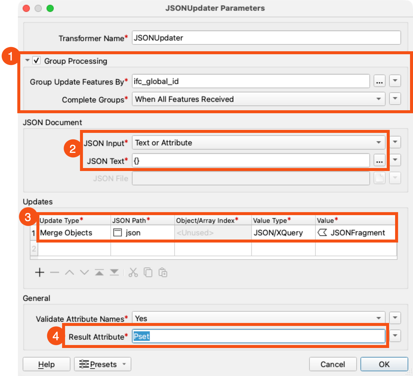

7. Create the JSON Property Set
All of the JSON fragments can now be merged into a single JSON object for each IFC building element. Add a JSONUpdater to the canvas. Connect the JSONTemplater Output port to the Update port. Connect the TestFilter’s Contained in Structure Output port to the Document port. The FME Workbench canvas should look like this:
Open the JSONUpdater parameters. Set them as follows:
  1. Group Processing: Enabled.
    Group Update Features by ifc_global_id
  2. JSON Document:
    JSON Input: Text or Attribute
    JSON Text: {} (empty object)
  3. Updates:
    Update Type: Merge Objects
    JSON Path: json
    Value Type: JSON/XQuery
    Value: JSONFragment
  4. Result Attribute: Pset
Click OK.
Run the workspace to the JSONUpdater and inspect the Document features in Data Preview. Scroll to the right and look for the Pset attribute. Double-click a Pset value to view it. Click the Syntax Highlighting button and choose JSON to pretty-print the results.
We now have a JSON object created from IFC data to write to Snowflake.

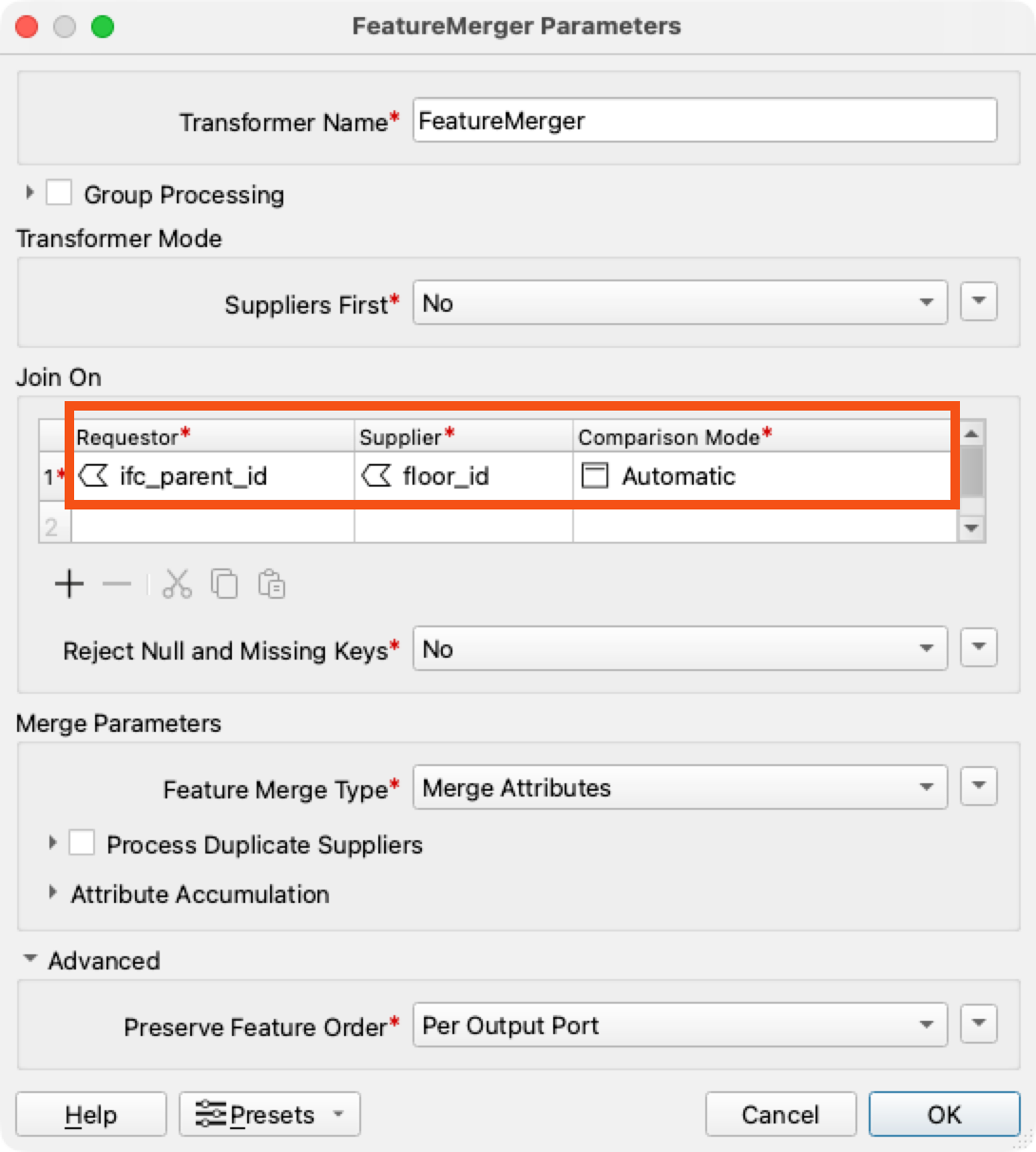

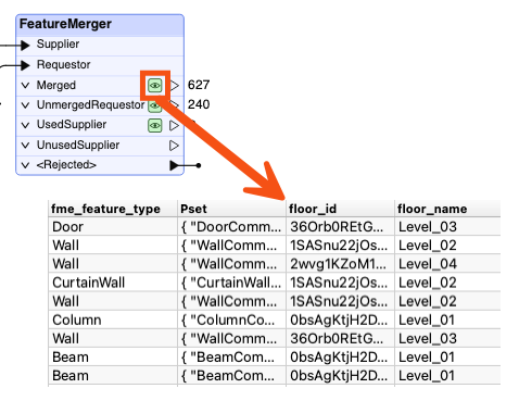

Let’s add the floor information to each building element. Add a FeatureMerger to the canvas and connect the JSONUpdate’s Document port to the FeatureMerger’s Requestor port. Connect AttributeRenamer’s Output port to the FeatureMerger’s Supplier port. The connections will cross on the canvas - to fix this, right-click the Supplier port and choose Move Up
Open the FeatureMerger parameters. Join on Requestor (the building element) ifc_parent_id and Supplier (the floor) floor_id. Leave Comparison Mode as Automatic.
Click OK.
Run the workspace up to the FeatureMerger. The UnmergedRequestor port shows there are building elements without a floor id. These are elements linked to IFC spaces, which we didn’t include in this example. Inspect the Merged features in Data Preview - the floors have been merged to the building elements.

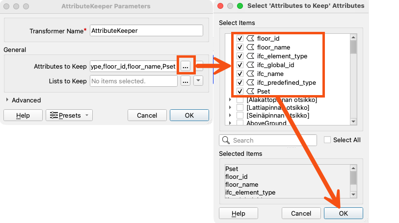

Before writing to Snowflake, let’s clean up the schema. Add an AttributeKeeper to the canvas. In the parameters, click [...] and then search for and select these attributes:
  • floor_id
  • floor_name
  • ifc_element_type
  • ifc_global_id
  • ifc_name
  • ifc_predefined_type
  • Pset
Click OK to select the attributes
Click OK again.

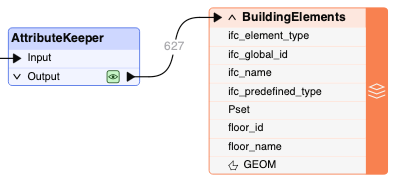

Run the workspace up to the AttributeKeeper and inspect the Output. We now have a much more manageable schema to write.

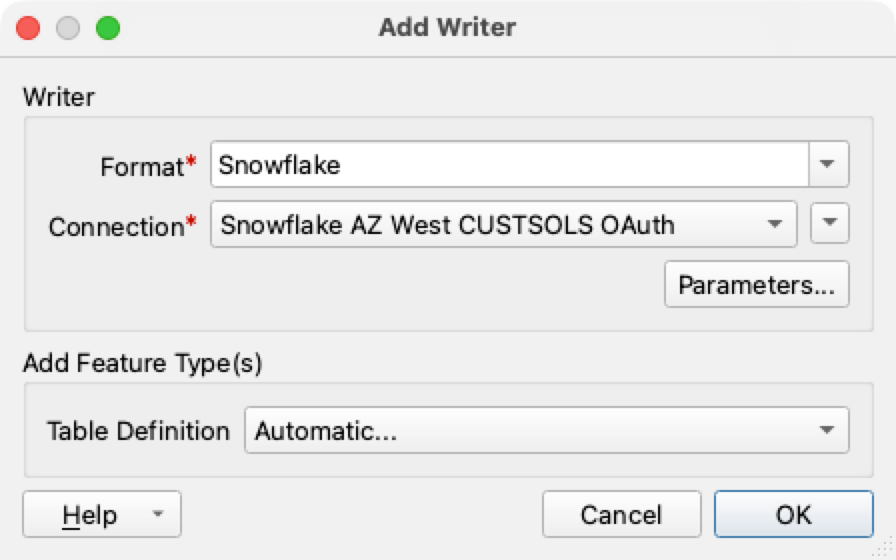

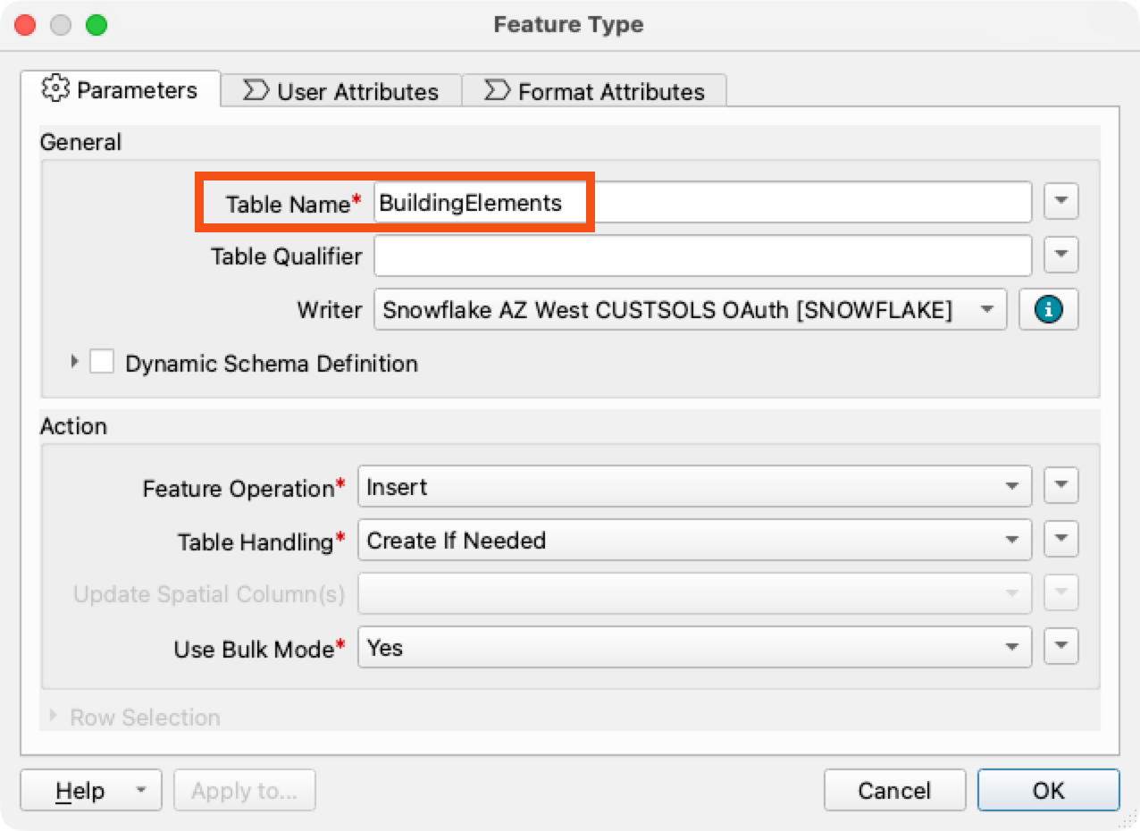

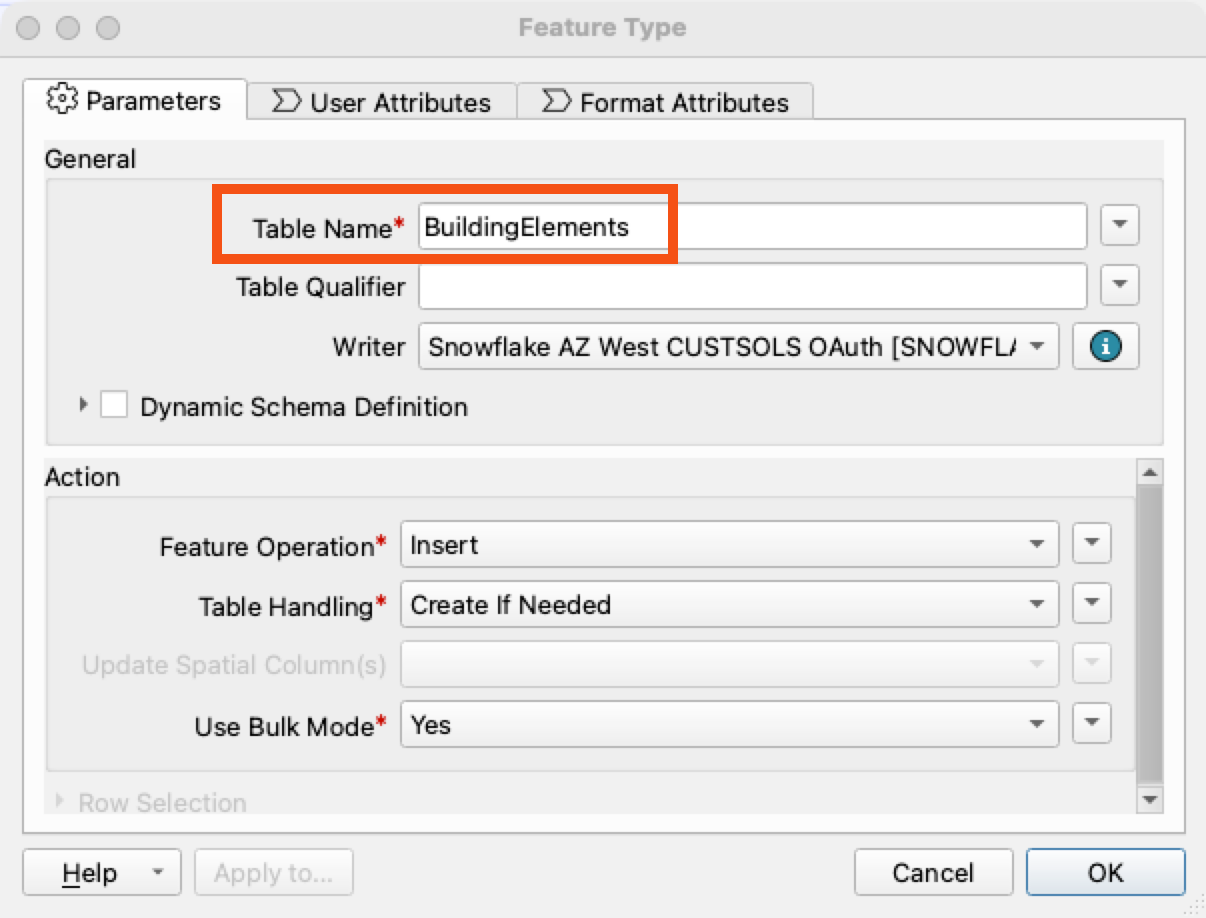

Add a Snowflake Writer to the canvas, choose your Snowflake connection, and leave Table Definition as Automatic. Click OK. If you don’t have a Snowflake connection, please see Connecting to Snowflake.
Name the table BuildingElements and leave the other defaults. Click OK.
Connect the Snowflake Writer to the AttributeKeeper’s Output port. Since the writer’s Table Definition is Automatic, the schema is populated.

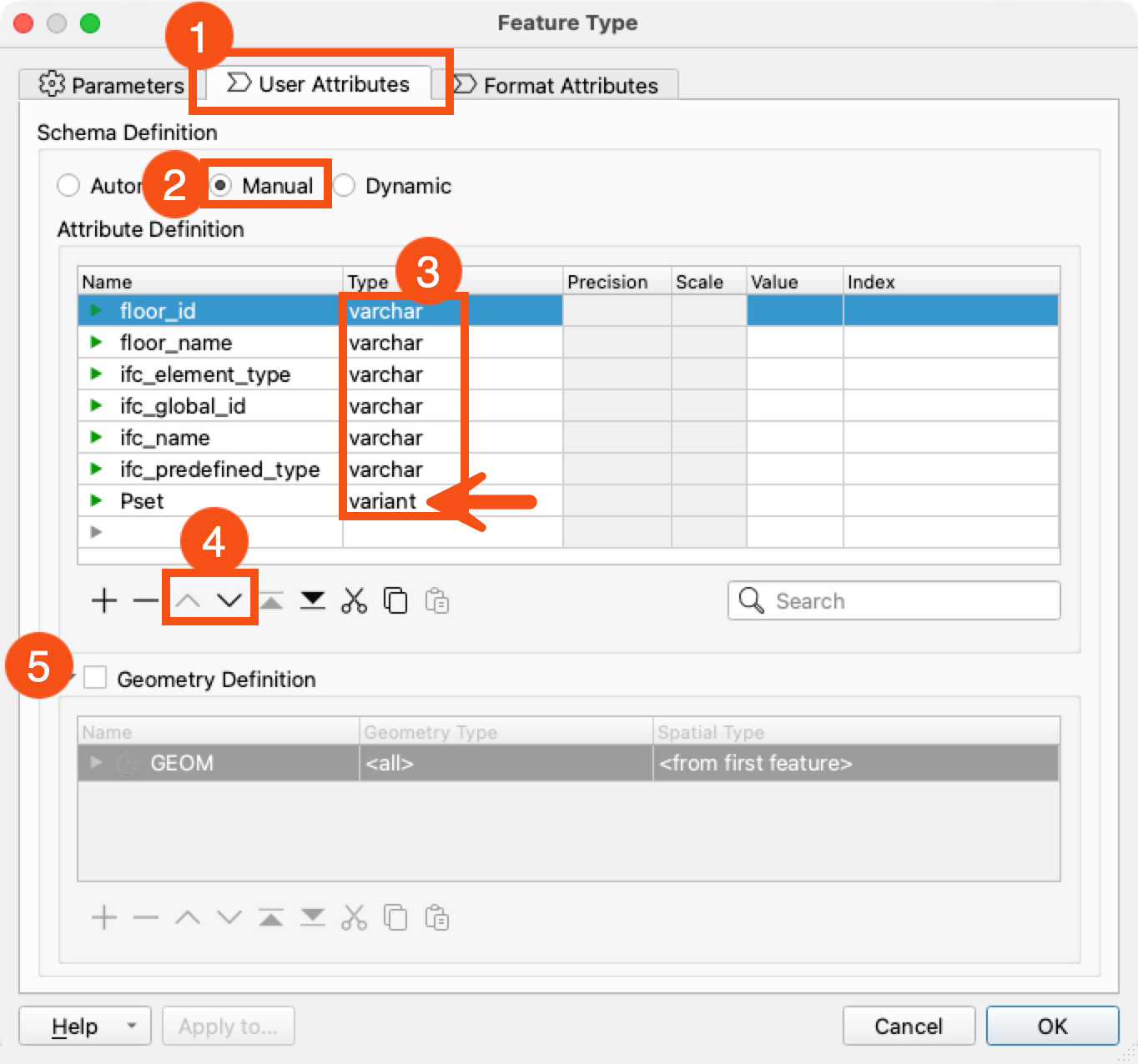

Double-click the BuildingElements feature type to edit the parameters.
  1. Click the User Attributes tab
  2. Change the Schema Definition to Manual so we can make some changes
  3. Change the Pset type to variant. Change the other types to varchar (no length) to avoid any future write issues.
  4. If you’d like, rearrange the order of attributes using the up and down arrows. In the screenshot below, the floor_id and floor_name attributes are moved to the top.
  5. Disable the Geometry Definition.
Click OK.

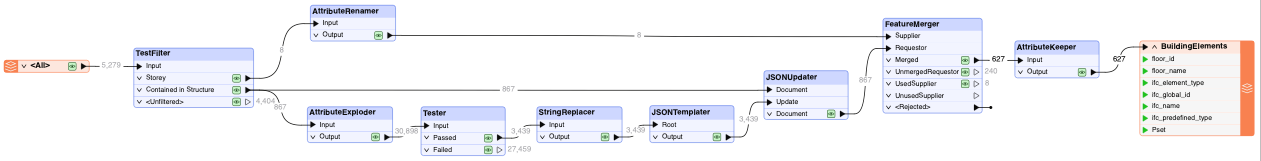

The workspace should look like this:

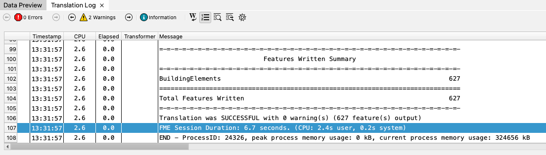

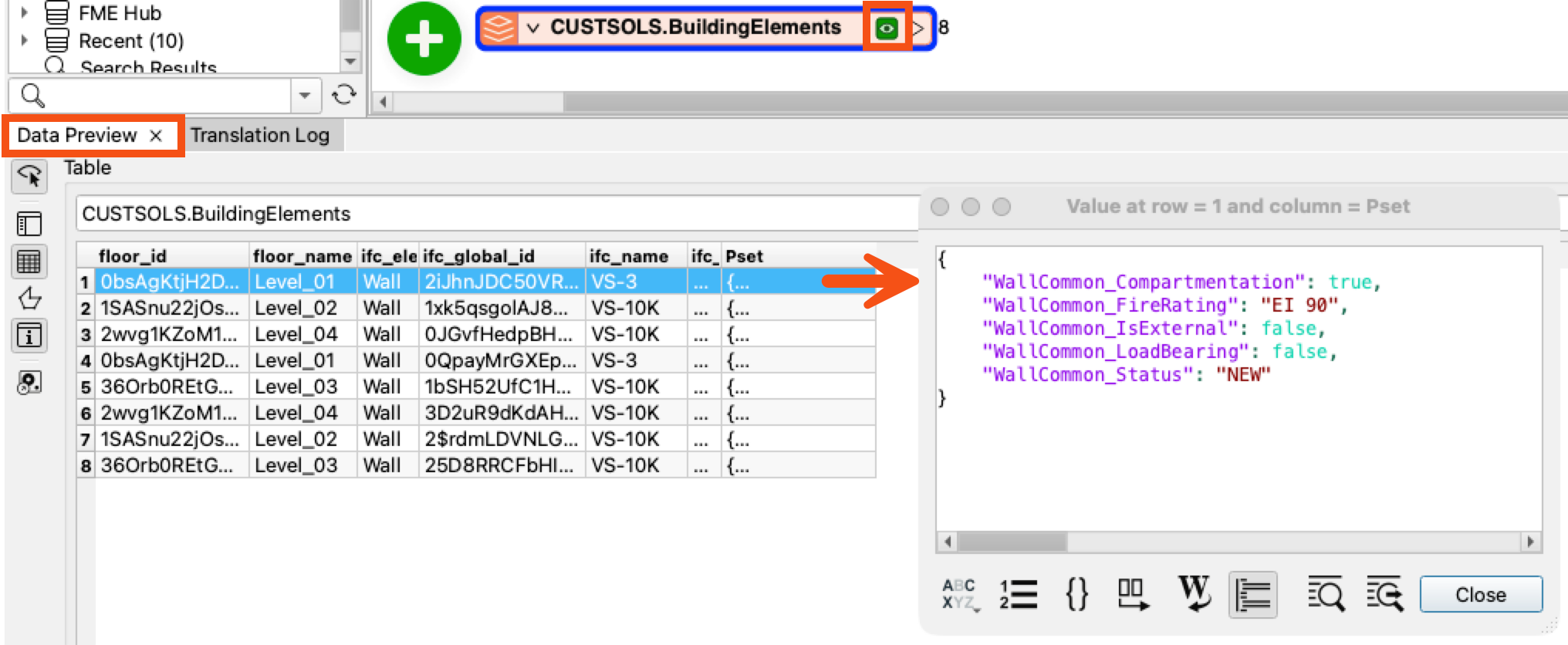

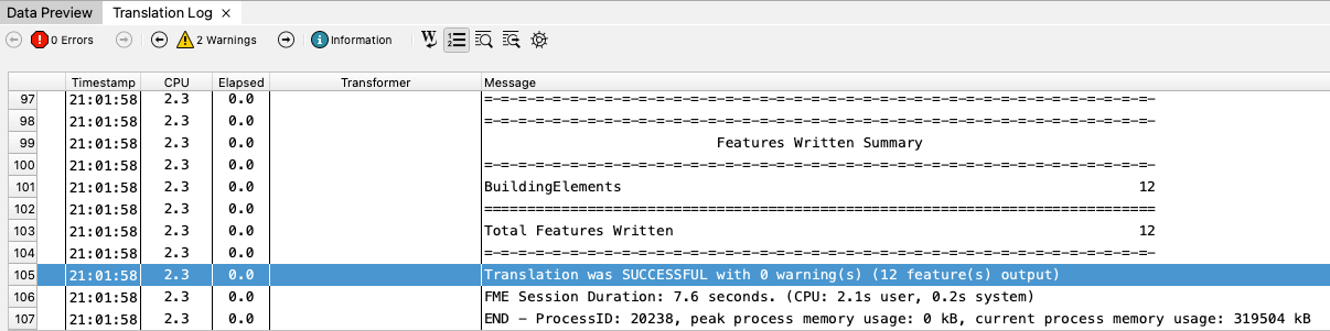

We’re now ready to write the data to Snowflake. Run the workspace. Check the Translation Log to make sure there were no errors and features were successfully written.

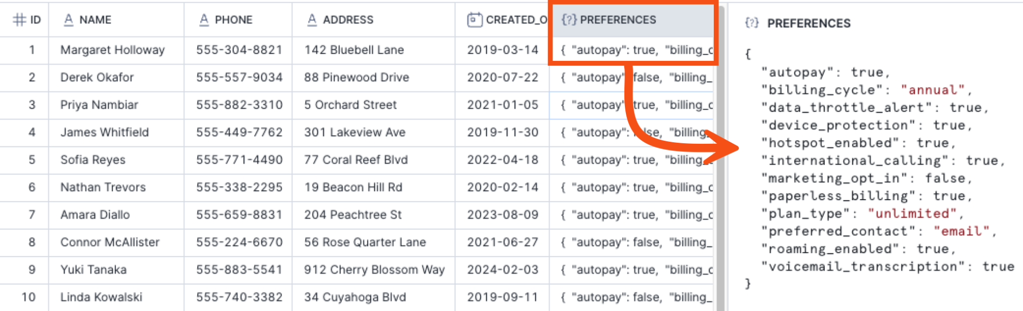

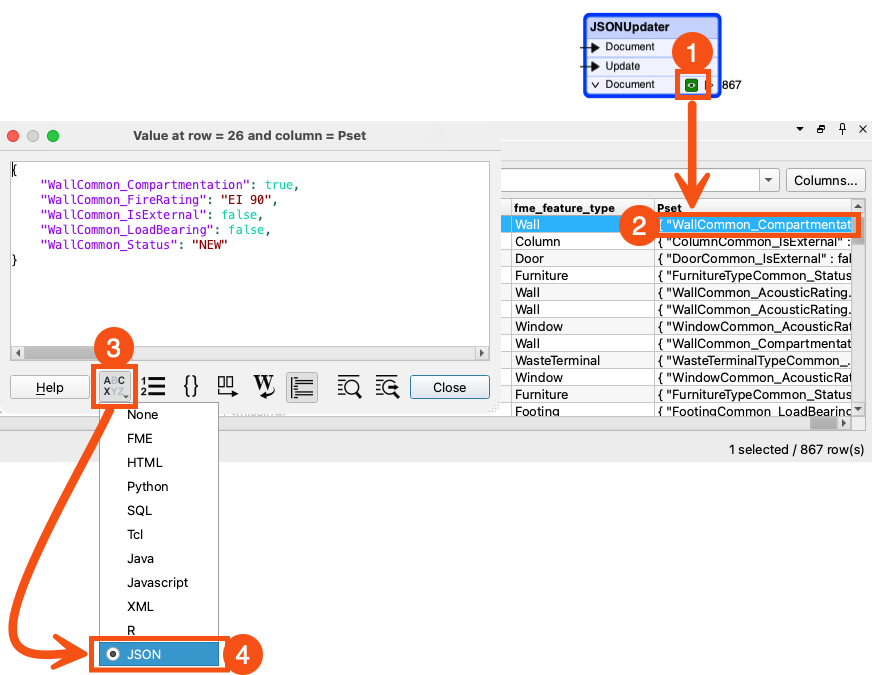

10. Review Results in Snowflake

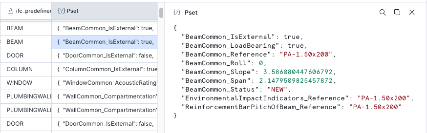

Log into Snowflake and query the BuildingElements table:
Select * from "BuildingElements"
Click on a value in the Pset column to view the JSON.
JSON has been created at run time using BIM data in the IFC format and written to a Snowflake Variant! The Variant can now be queried in Snowflake or FME, as shown in the next part.

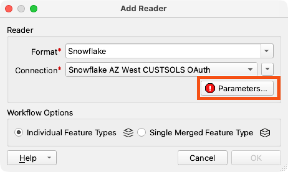

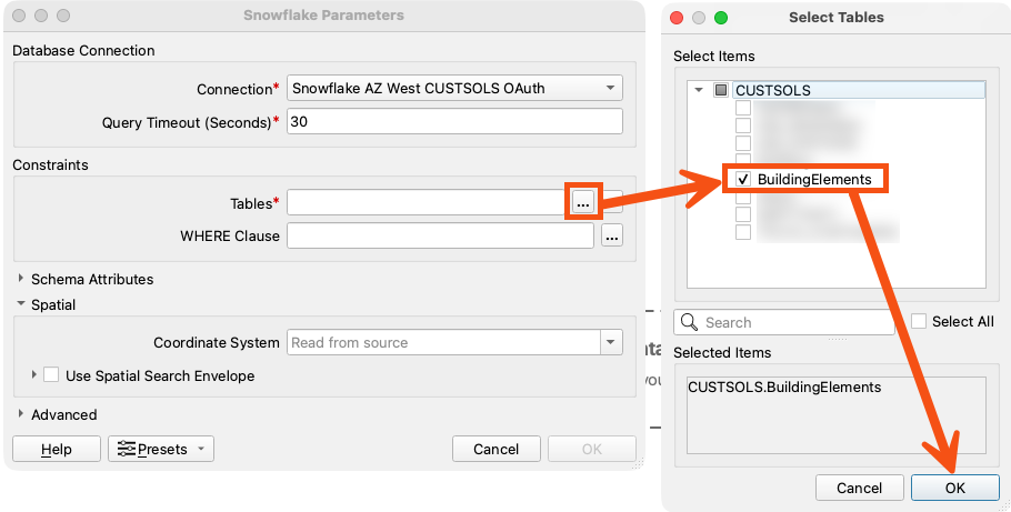

2. Add a Snowflake Reader to the Canvas

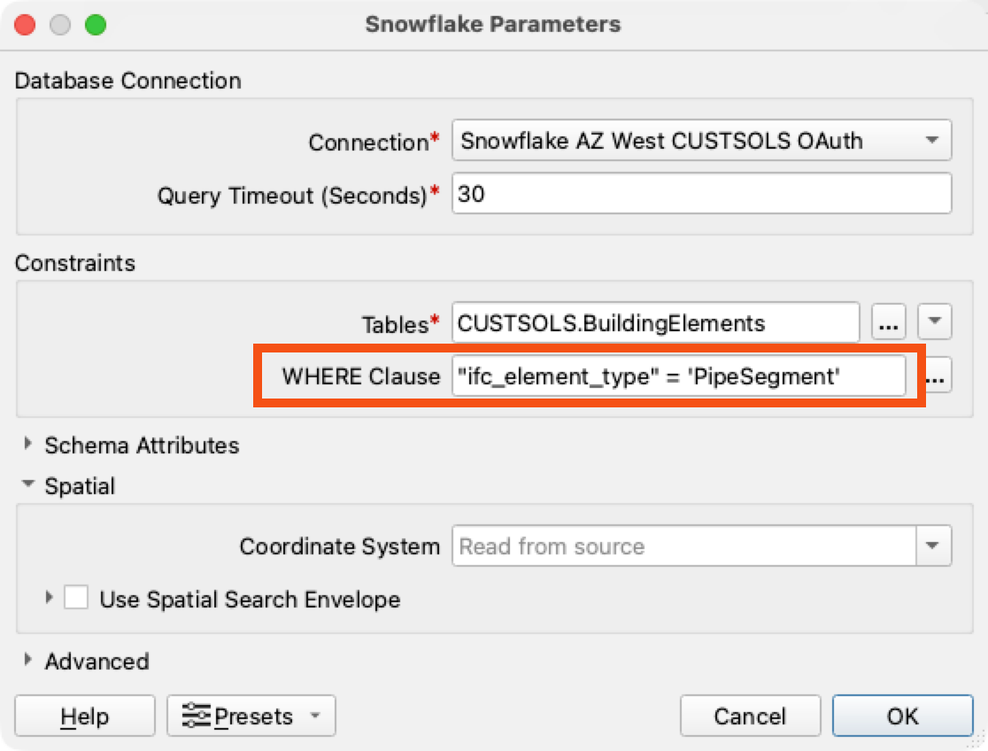

Choose the same Snowflake connection used in Part 1. Click Parameters.
In the reader parameters, select the BuildingElements table created in Part 1. Click OK.
Click OK again to add the reader to the canvas. Run the workspace with Data Caching enabled.
All records in the BuildingElements table are read.

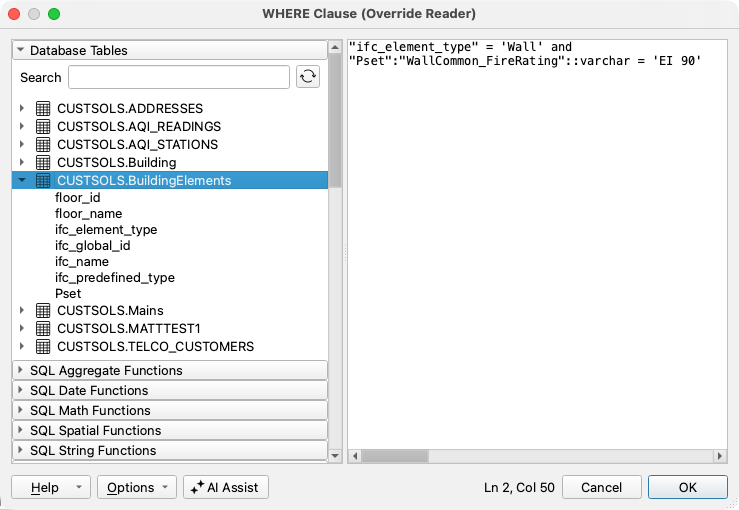

3. Add a Where Clause to Filter by Variant Keys

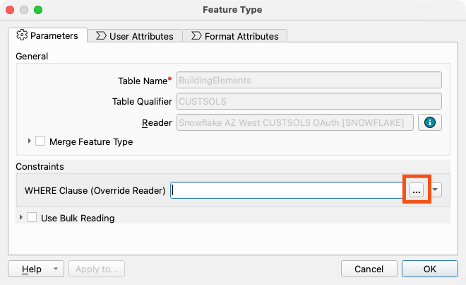

The feature type WHERE Clause is one place you can query a variant. Let’s query walls with a fire rating of EI 90, meaning the wall will prevent the passage of flames for at least 90 minutes in the event of a fire.
Double-click the BuildingElements feature type to edit the parameters. Click [...] next to WHERE Clause to open the editor.
The syntax we’ll use for querying a Snowflake Variant is “column_name”:”key_name”::datatype. The datatype is optional, but recommended to avoid the query failing silently (returning no results) due to a type mismatch. Enter the statement below:
"ifc_element_type" = 'Wall' and
"Pset":"WallCommon_FireRating"::varchar = 'EI 90'
Click OK.
Run the workspace again. This time, only records matching the where clause are returned. Inspect the reader’s output and double-click a Pset value in Data Preview to view it.

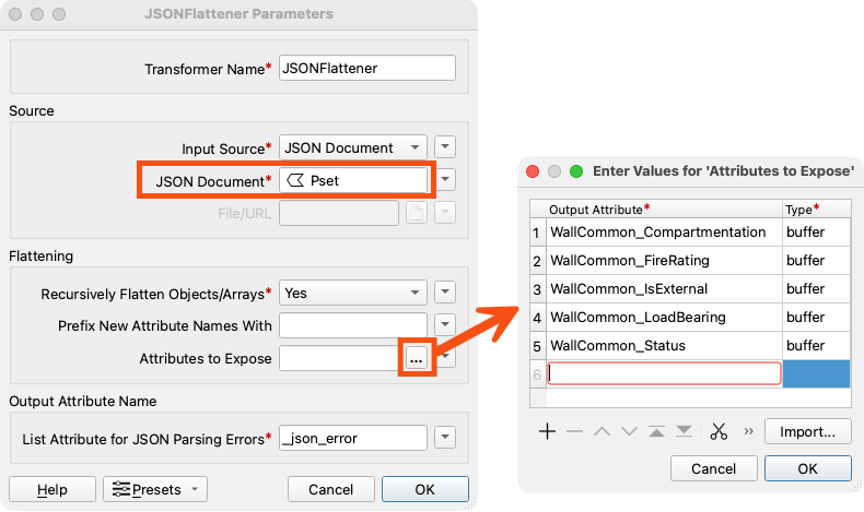

4. Extract Variant

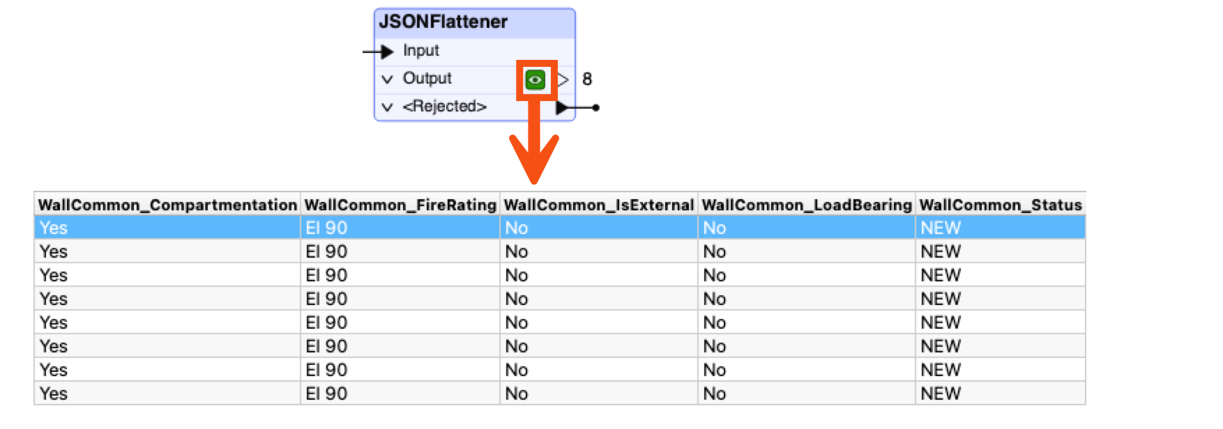

Variant data can be extracted for further analysis or transformation within FME. Add a JSONFlattener to the canvas and connect it to the Snowflake Reader. Open the parameters and choose the Pset attribute as the JSON Document. For the Attributes to Expose, enter all JSON keys from the Pset and click OK.
Click OK to close the JSONFlattener. Run the workspace and inspect the JSONFlattener Output in Data Preview. The Pset JSON has been flattened into attributes.

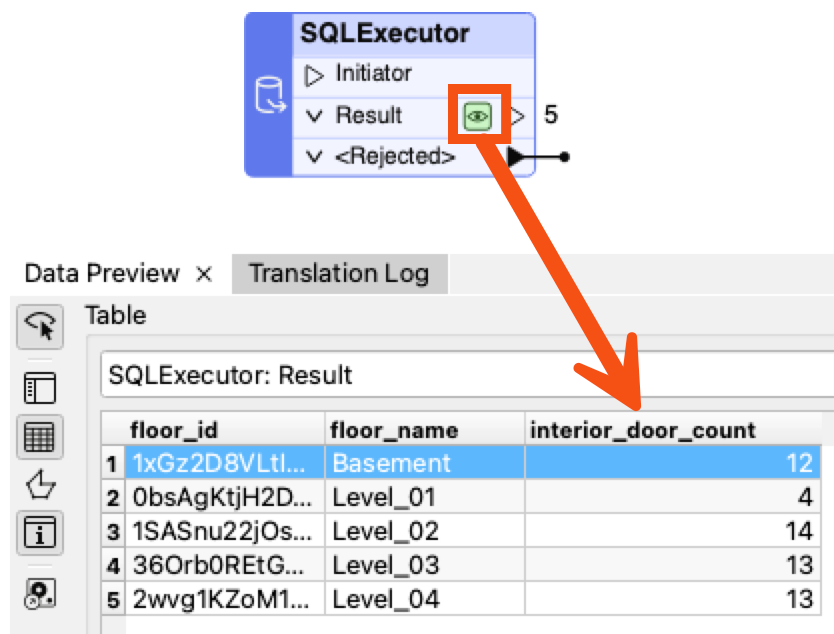

5. Query Snowflake Variant Using SQL Transformers
FME’s SQL transformers also let you query Snowflake data, including variants. For example, the SQL statement below gets the count of interior doors per building floor. The IsExternal property is part of the DoorCommon property set variant.
SELECT BE."floor_id", BE."floor_name", COUNT(BE."ifc_global_id") AS "interior_door_count" from "BuildingElements" BE
WHERE BE."ifc_element_type" = 'Door'
    AND BE."Pset":"DoorCommon_IsExternal"::boolean = 'false'
GROUP BY BE."floor_id", BE."floor_name"
ORDER BY BE."floor_name"

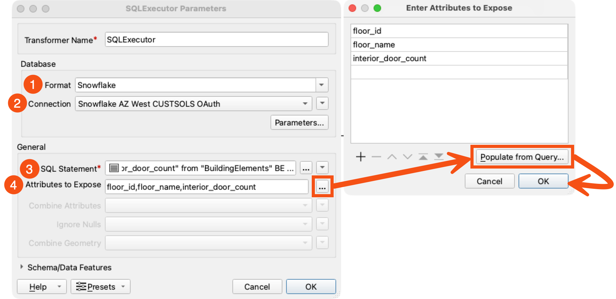

To run this query in FME, add a SQLExecutor to the canvas. In the parameters, set:
  1. Format: Snowflake
  2. Connection: Your Snowflake database connection
  3. SQL Statement: The statement above
  4. Attributes to Export: Click [...] and then click Populate from Query. Click OK.
Click OK. Run the SQLExector and inspect the results in Data Preview.

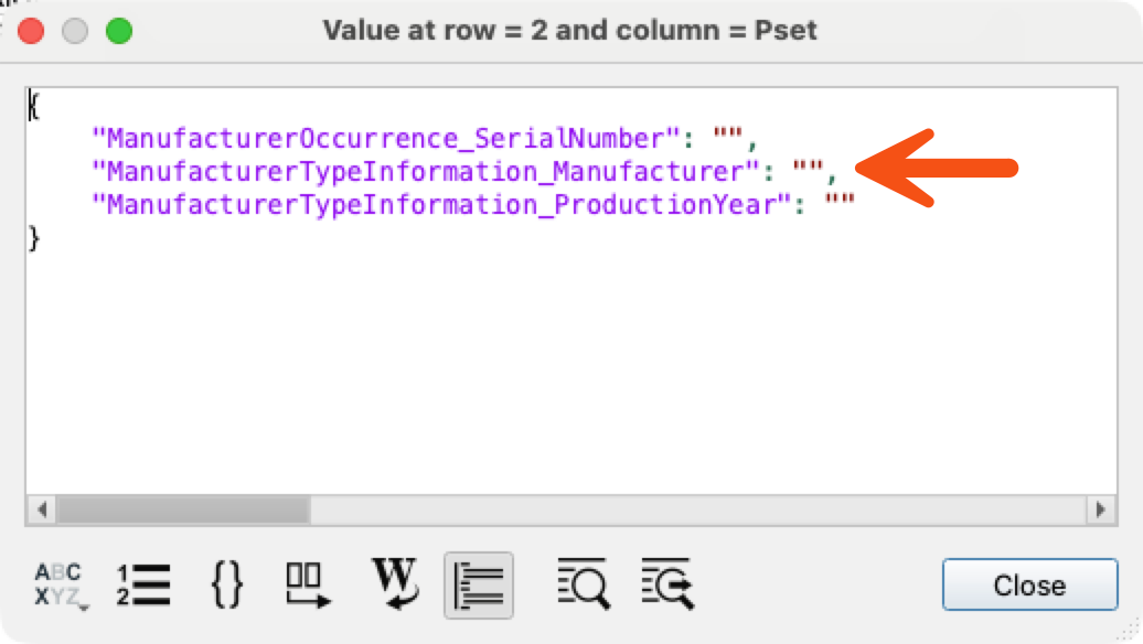

Click OK again to add the reader to the canvas. Run the workspace with Data Caching on. Only the building’s pipe segments should be returned.

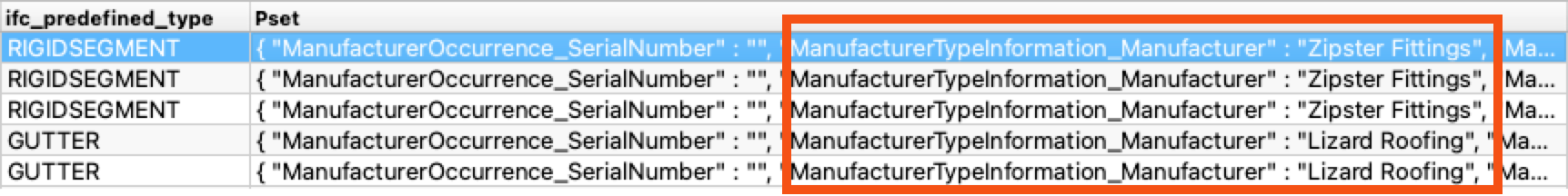

Inspect the output and view a Pset value. The ManufacturerTypeInformation_Manufacturer property is missing.

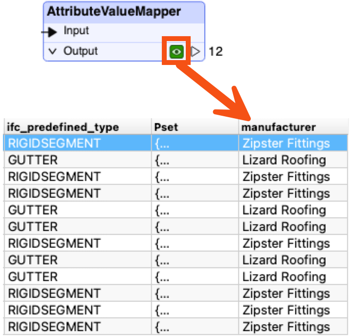

3. Add Values to Update
In a real-world solution, manufacturer values would likely be read from a database or other system, but for simplicity, we will manually add them based on each pipe segment’s type.

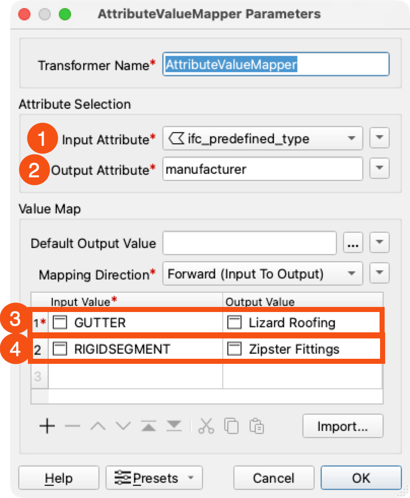

Add an AttributeValueMapper to the canvas and connect it to the Snowflake Reader. Open the parameters and set them as shown below:
  1. Input Attribute: ifc_predefined_type
  2. Output Attribute: manufacturer
  3. Input Value 1: GUTTER
Output Value1: Lizard Roofing
  1. Input Value 2: RIGIDSEGEMENT
Output Value 2: Zipster Fittings
Click OK.
Run the workspace and inspect the AttributeValueMapper’s output. All features now have a manufacturer value that can be added to the associated Pset JSON.

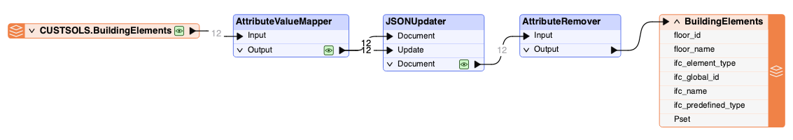

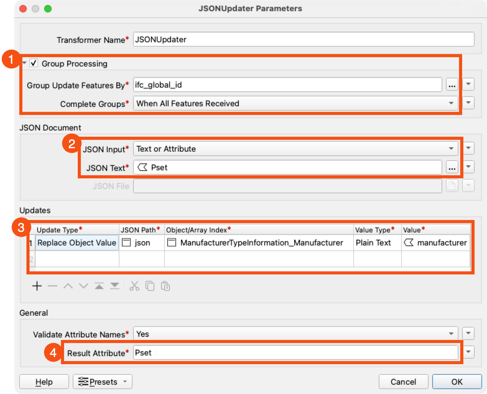

4. Update the Propert Set JSON

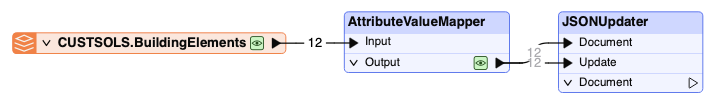

Add a JSONUpdater to the canvas. Connect the AttributeValueMapper’s Output to both the Document and Update ports of the JSONUpdater.
Open the JSONUpdater’s parameters and set them as shown below:
    Group Update Features by: ifc_global_id
  2. JSON Document:
    JSON Text: Pset
  3. Updates:
    Update Type: Replace Object Value
    JSON Path: json
    Object/Array Index: ManufacturerTypeInformation_Manufacturer
    Value Type: Plain Text
    Value: @Value(manufacturer)
Click OK.

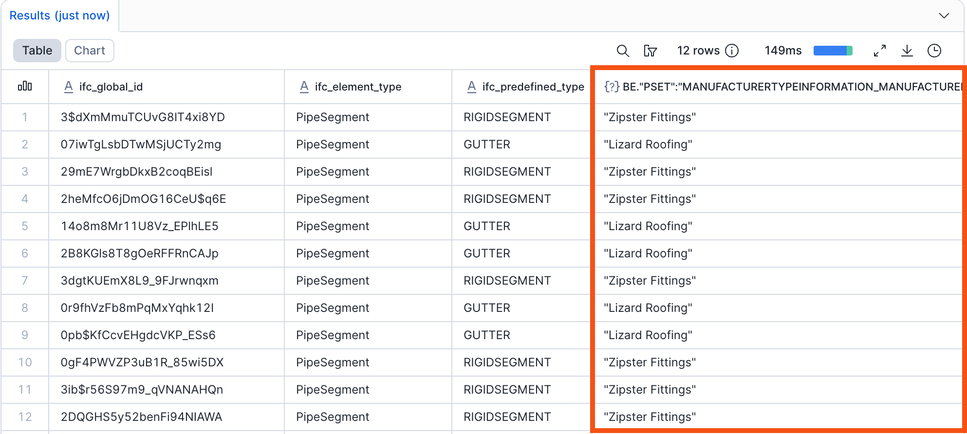

Run the workspace and inspect the JSONUpdater Output. The Pset JSON has been updated

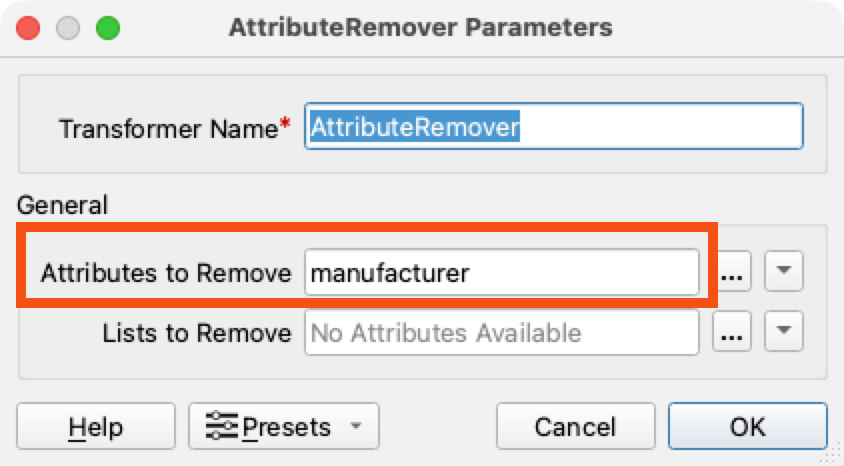

5. Remove Manufacturer Attribute
Now that the Pset JSON has been updated, we can remove the manufacturer attribute before writing to Snowflake.
Add an AttributeRemover to the canvas and connect it to the JSONUpdater’s Document output port. Set Attributes to Remove to manufacturer.
Click OK.

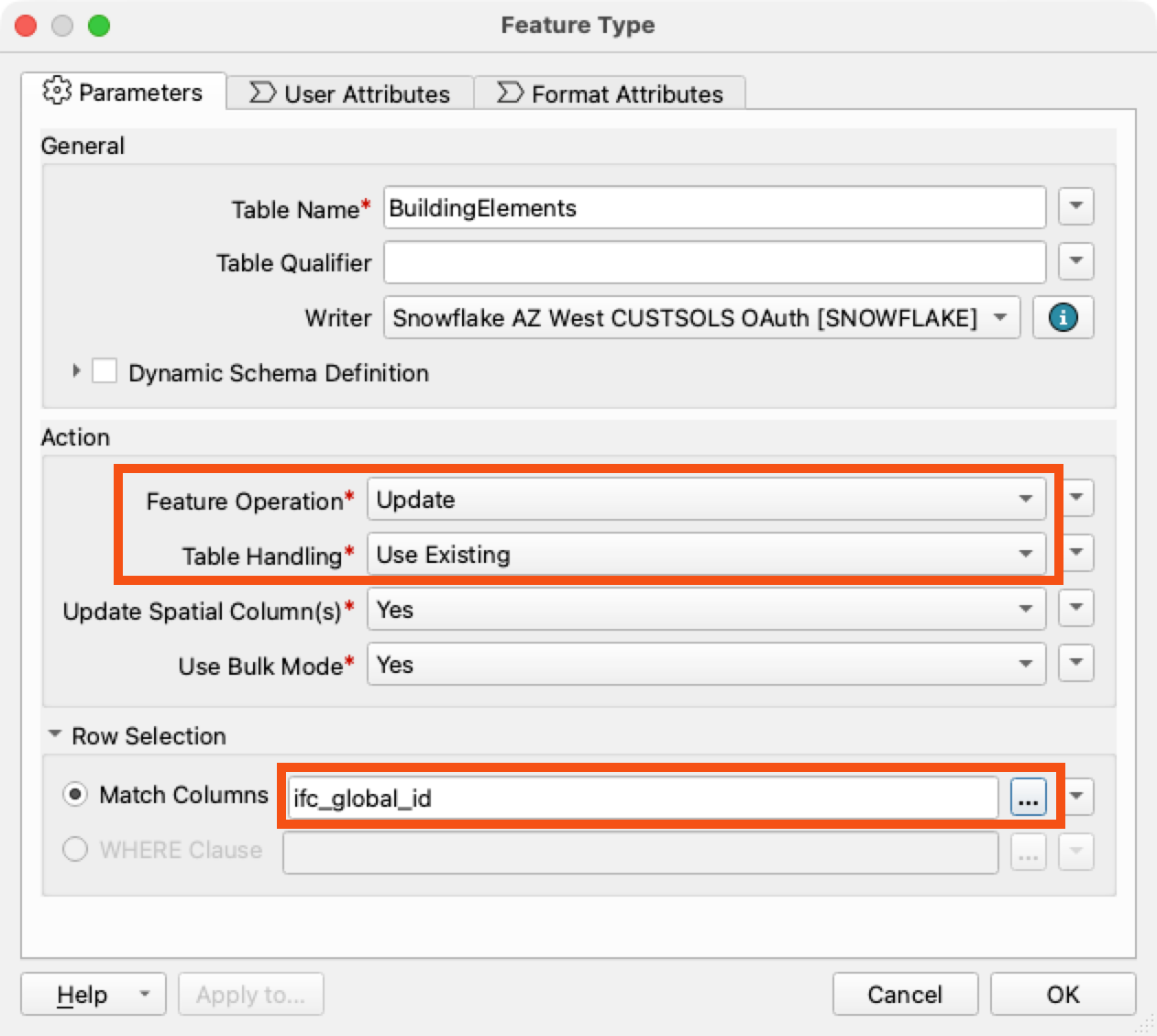

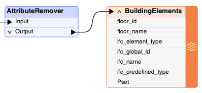

6. Write to Snowflake
Enter the existing table name BuildingElements. Click OK.
Connect the AttributeRemover to the BuildingElements feature type.
Now that the Snowflake Writer is connected to a transformer providing a schema, it can be fully configured. Double-click the BuildingElements feature type to reopen the parameters. Change the Feature Operation to Update. For Table Handling, choose Use Existing. For the Match Columns, which is the update key, click [...] and choose ifc_global_id.
Click OK.

We’re now ready to update the pipe segment JSON variants in Snowflake. Run the workspace. Check the Translation Log to make sure there were no errors and features were successfully written.
7. Review Results in Snowflake
SELECT BE."ifc_global_id", BE."ifc_element_type", BE."ifc_predefined_type", BE."Pset":"ManufacturerTypeInformation_Manufacturer"
FROM "BuildingElements" BE
WHERE BE."ifc_element_type" = 'PipeSegment'
This concludes the introduction to working with Snowflake Variants and JSON in FME.
