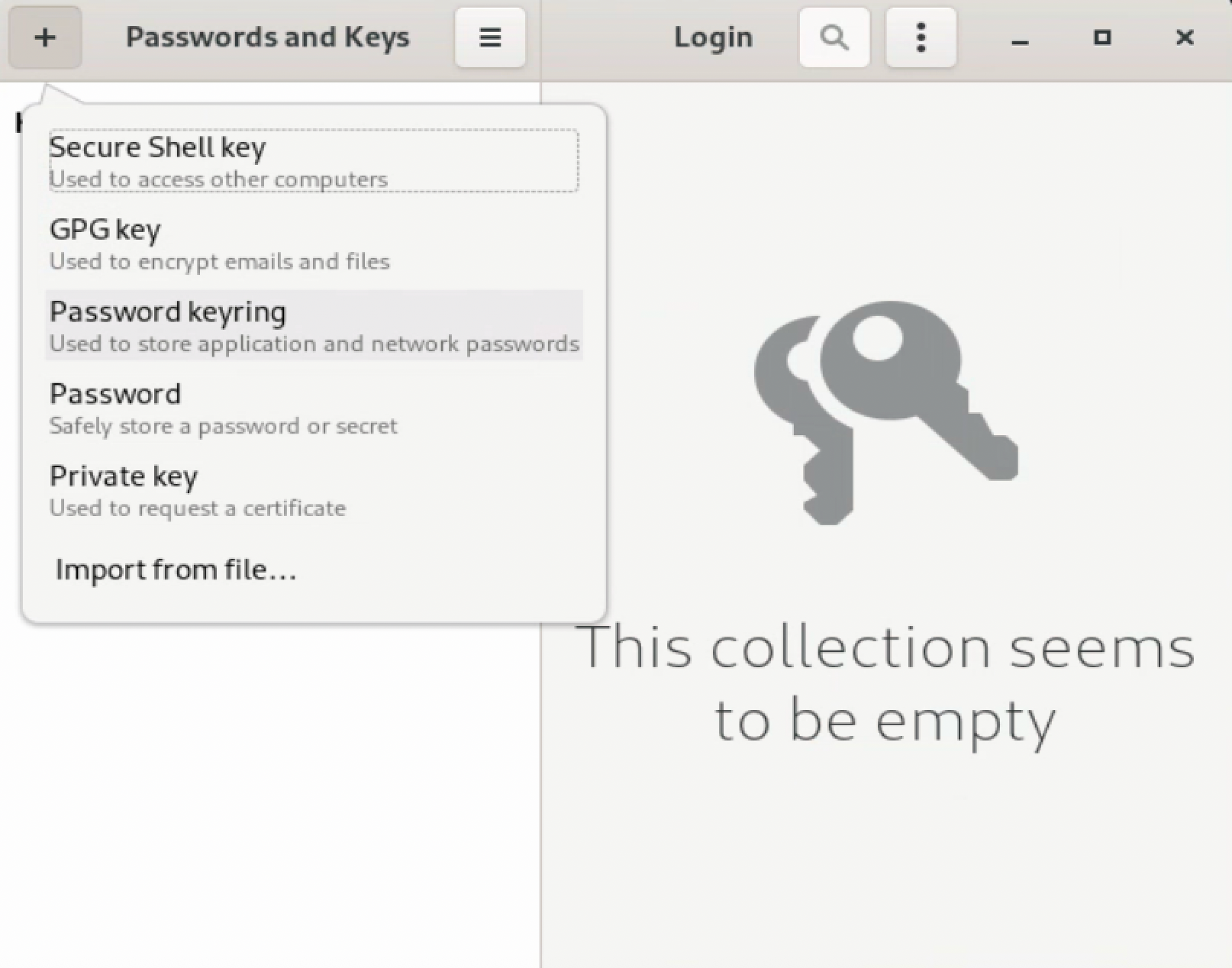

Once the application is installed, open Seahorse and create a Password keyring named Login

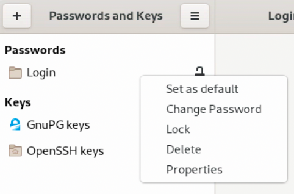

Set the Login keyring as the default here:
FME may then prompt you for the keyring’s set password when you install a package, but it should install successfully now.
