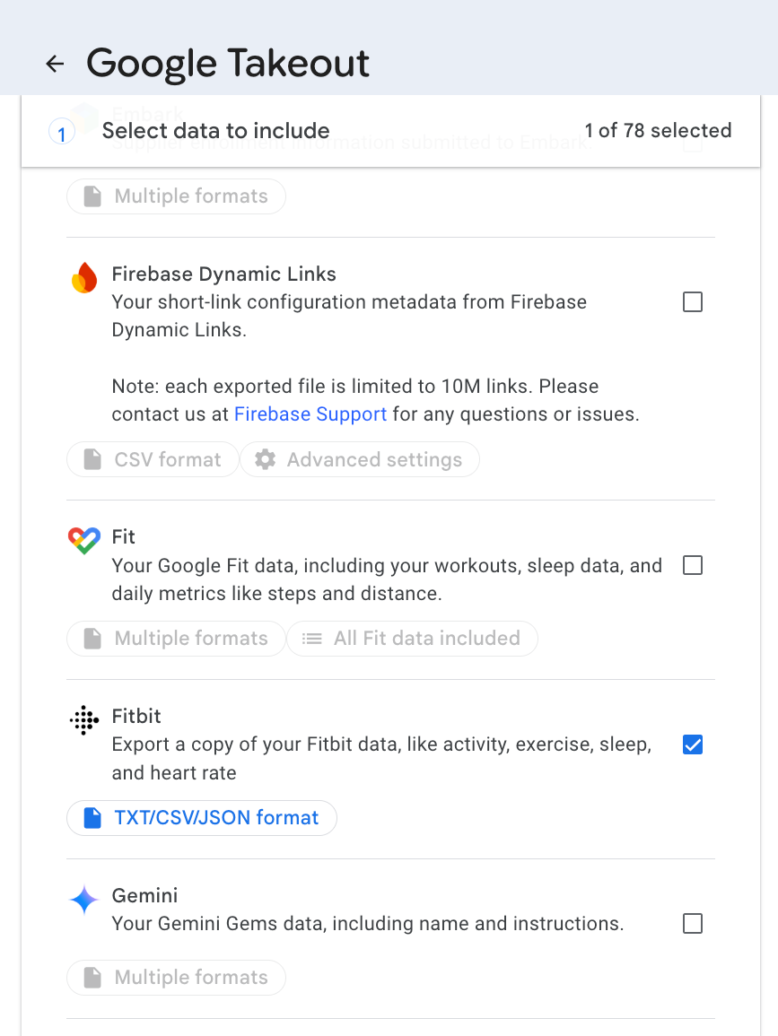

1. Export Data with Google Takeout
You can use the Fitbit app to export your personal data via Google Takeout, but it is more convenient to go straight to the source on your computer. Navigate to https://takeout.google.com. Deselect All at the top (so you don't download your entire Gmail and YouTube history!). Scroll down to Fitbit. Check the box for Fitbit.
Google Takeout data download selection
Click Next Step. Choose your destination, select Export once, your preferred archive format, and the file size. My full archive was about 360Mb, so any size should work. Click Create export. This will initiate the export process, and in a few hours (it took 5 hours in my case), you will receive an email with a link to a single ZIP file containing a folder structure with thousands of JSON and CSV files covering your entire account history. My archive consisted of over 24,000 files—a complete record of every single piece of information Fitbit ever logged about me.
Fitbit data

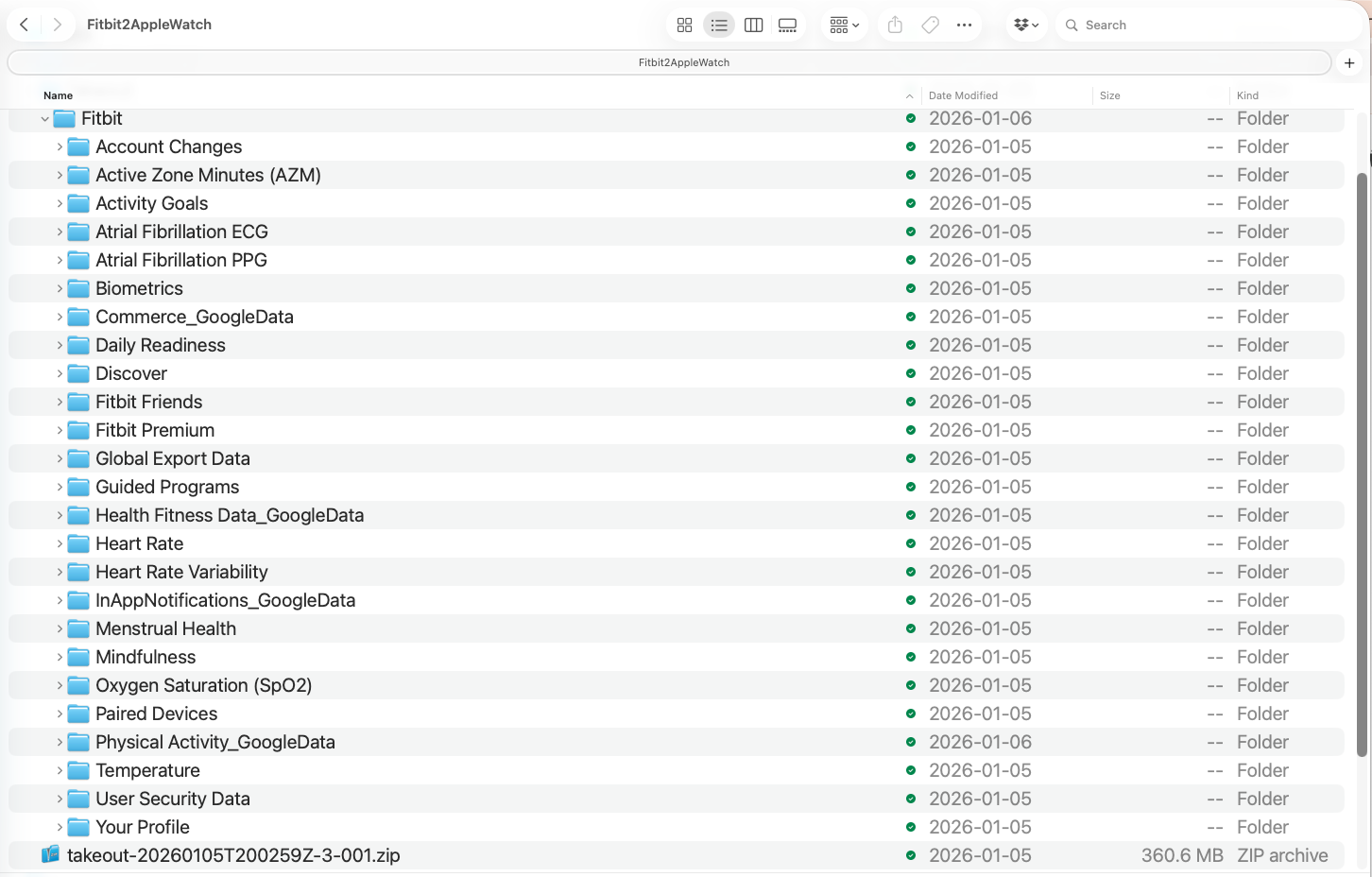

Fitbit stores all kinds of activity files in monthly CSVs in the Physical_Activity_GoogleData folder. For example, altitude, gps_location, sedentary_period, steps, floors, heart_rate etc.

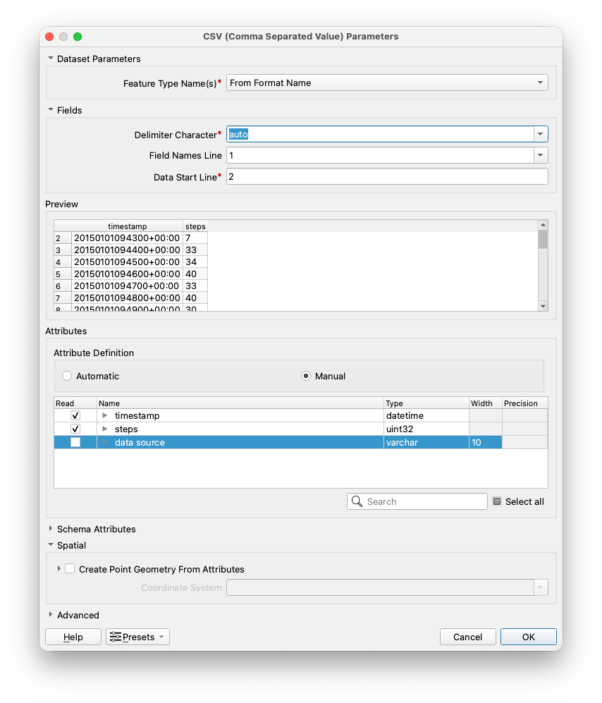

We will begin by reading the step data. The step files have steps_YYYY-mm-dd name format (for example, steps_2024-11-01.csv).

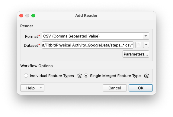

1. Add CSV Reader
Add a reader to a blank workspace in FME Workbench.
  • Format: CSV (Comma Separated Value)
  • Dataset: /Physical Activity_GoogleData/steps_*.csv
    • Use asterisk (*) to read all the files beginning with the steps_
  • Workflow Options: Single Merged Feature Type
Then click on Parameters.
Reading CSV with step data
 In the CSV (Comma Separated Value) Parameters:
  • Delimiter Character: Auto
  • Field Names Line: 1
  • Data Start Line: 2
  • Attributes:
    • Attribute Definition: Manual
    • data source: unchecked
Then click OK twice to finish adding the reader.
Step data CSV parameters

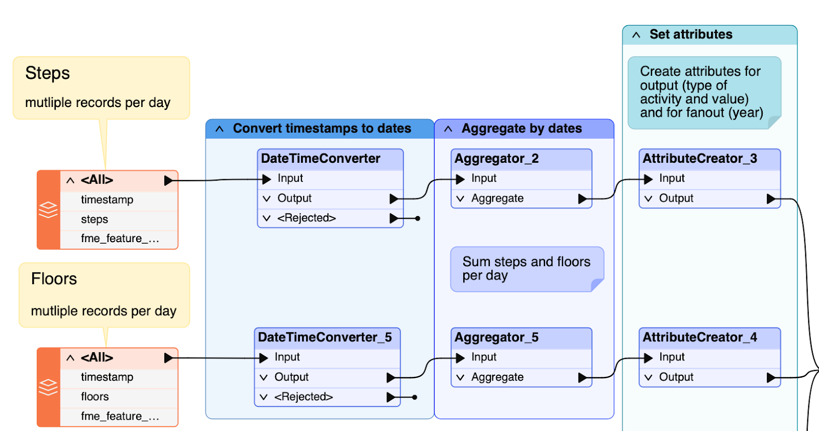

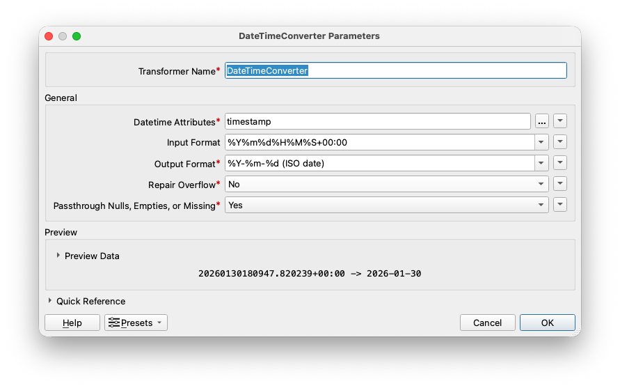

2. Format datetime
The files can contain thousands upon thousands of records (I had  over 1.2 million of step lines) - Fitbit saves step count updates very frequently. We want to move only the daily step count to Apple Health; this is why we need to group our steps by date. For this, we use DateTimeConverter to format Fitbit datetime values (e.g. 2024-11-01T22:13:00Z) to date only (2024-11-01):
  • Datetime Attributes: timestamp
  • Input Format: %Y%m%d%H%M%S+00:00
  • Output Format: %Y-%m-%d (ISO date)
  • Repair Overflow: No
  • Passthrough Nulls, Empties, or Missing: Yes
DateTime parameters

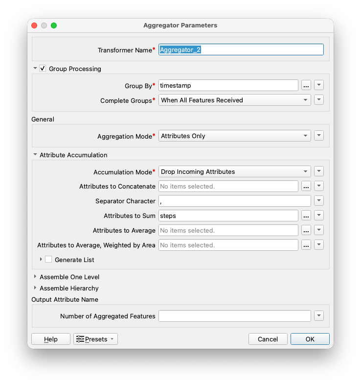

 3. Aggregate Step Records to Daily Sums
Next, we will aggregate the step records to daily sums using an Aggregator.
  • Group Processing: Enabled
    • Group By: timestamp:
  • Aggregation Mode: Attributes Only
  • Attributes to Sum: steps
Aggregator parameters

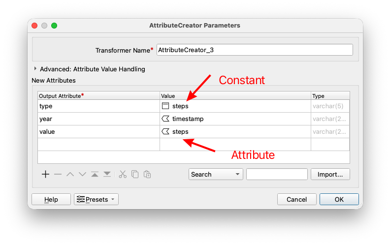

4. Create Attributes
Add an AttributeCreator and create the following three attributes that we will use for JSON creation:
Output Attribute Value
type steps
year @Value(timestamp)
value @Value(steps)
For the type attribute, this is a constant value of "steps," whereas the other two attributes are the values of the attributes.
Setting attribute values

Do not read the granular "Heart Rate" files in Global Export Data folder (my dataset contained over 12,000,000 records). Look for resting_heart_rate-*.json.

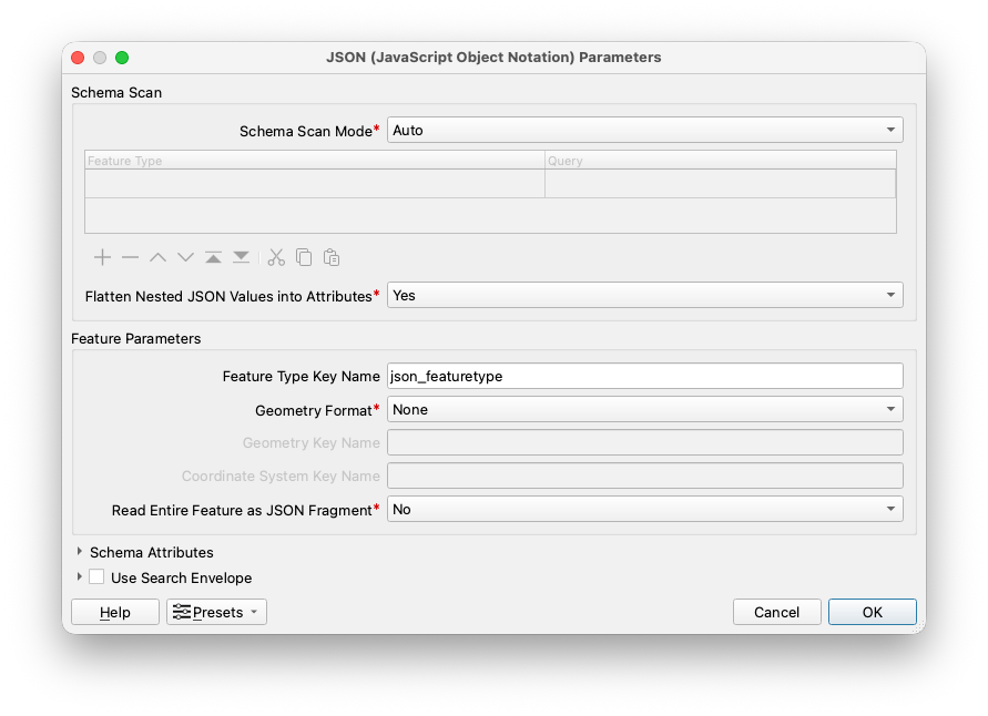

1. Add a JSON Reader
In the same workspace, add a third reader.
  • Format: JSON (JavaScript Object Notation)
  • Dataset: /Global Export Data/resting_heart_rate-*.json
    • Use an asterisk (*) to read all the files beginning with the resting_heart_rate-
  • Parameters:
    • Flatten Nested JSON Values into Attributes: Yes
Reading RHR JSON

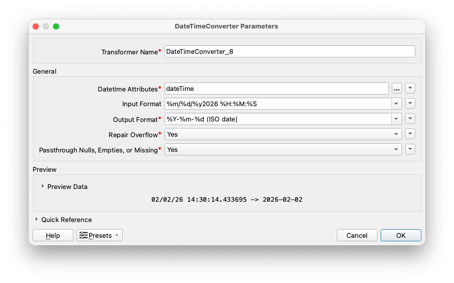

2. Convert datetime for Heart Rate
We need to create the same set of attributes for heart rate as we made for steps and floors. The dateTime attribute has a bit different format. Using the DateTimeConverter, we'll transform dates looking like %m/%d/%y2026 %H:%M:%S (for example, 12/31/20 00:00:00) to the same date-only format:
  • Datetime Attributes: dateTime
  • Input Format: %m/%d/%y2026 %H:%M:%S
  • Repair Overflow: Yes
Convert datetime to date for RHR

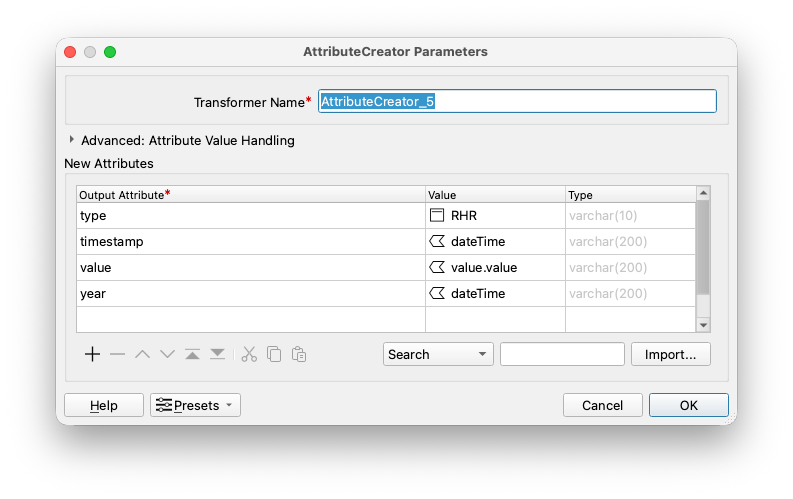

type RHR
timestamp @Value(dateTime)
value @Value(value.value)
year @Value(dateTime)

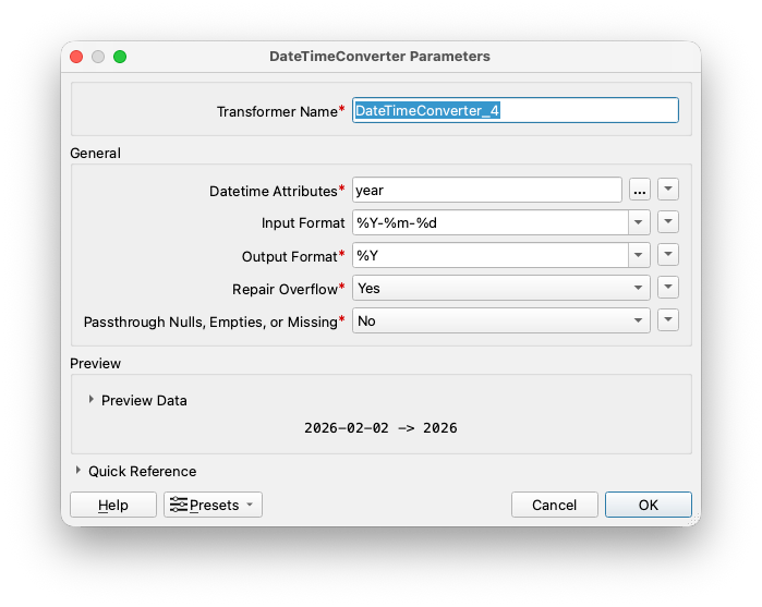

5. Convert year
Now, in a new DateTimeConverter, we need to transform the year attribute containing the full date to years only. We will use this attribute for creating separate JSONs later.
  • Datetime Attributes: year
  • Input Format: %Y-%m-%d
  • Output Format: %Y
Setting year for fanout

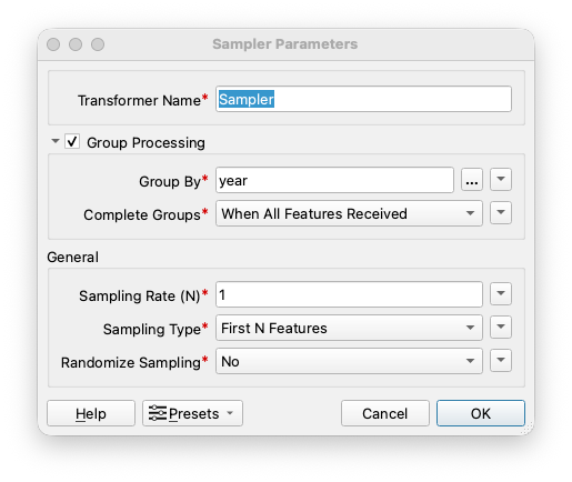

6. Separate Data by Year
Our data is ready to be formatted as a JSON, but since we need separate files by year, we need a single feature each year to be a root node in the JSONTemplater. The easiest way to create unique features from a dataset is to use Sampler with Group By attribute. Here we will use the year attribute we just created:
    • Group By: year
  • Sampling Rate (N): 1
  • Sampling Type: First N Features
Sampler for selecting one feature per year

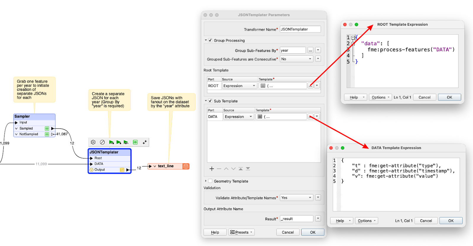

7. Add a JSONTemplater
Add a JSONTemplater. The single unique year features will go to the Root Template, and all features go into the DATA port we add as the Sub Template. Connect the Sampler Sampled port to the Root input port. In the parameters:
    • Group Sub Features By: year
  • Root Template:
    • Port: ROOT
    • Source: Expression
    • Template:
        "data": [
          fme:process-features("DATA")
  • Sub Template: Enabled
    • Click the plus sign to add a new sub template
    • Port: DATA
    • Template:
       "t": fme:get-attribute("type"),
       "d": fme:get-attribute("timestamp"),
       "v": fme:get-attribute("value")
Now close the JSONTemplater and connect the DateTimeConverter_4 Output port to the newly created DATA port.
JSONTemplater setup

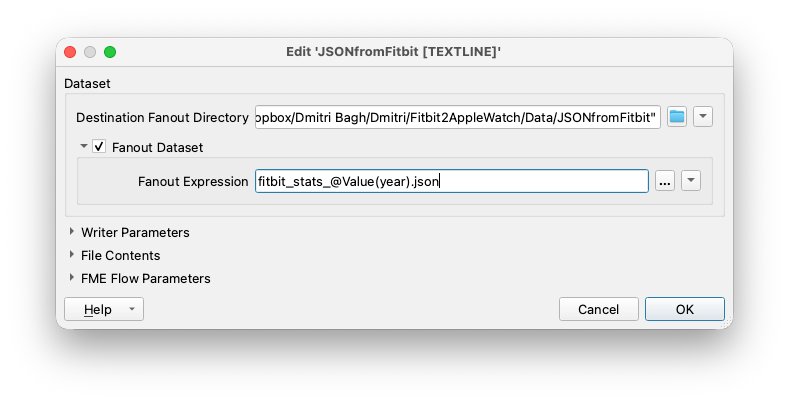

2. Set Fanout Expression
In Navigator, expand JSONfromFitbit, then double-click on Fanout Expression.
In the Edit dialog:
  • Fanout Dataset: Enabled
  • Fanout Expression: fitbit_stats_@Value(_year).json
Fanout setup

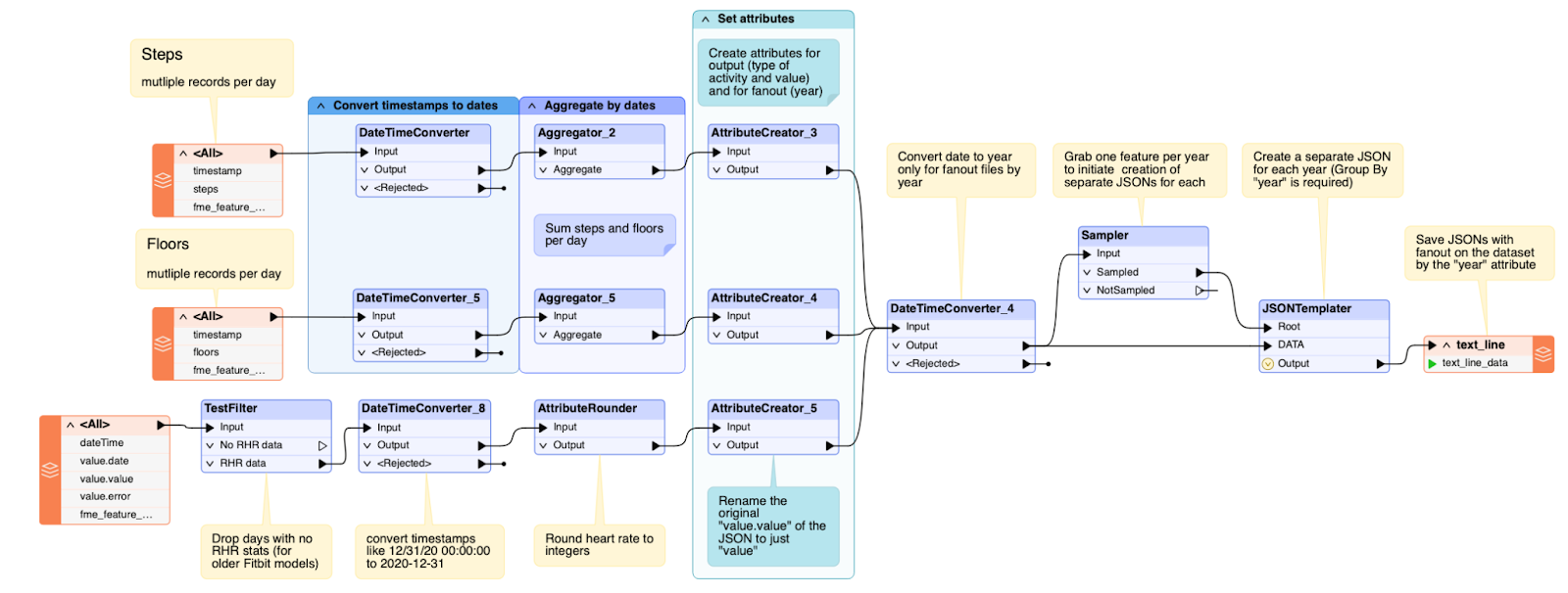

Here is the screenshot of the full workspace. If we run it, we get a series of json files with steps, floor, and resting heart rate data by year. In my case, 11 files, 11 years of data.
Full workspace

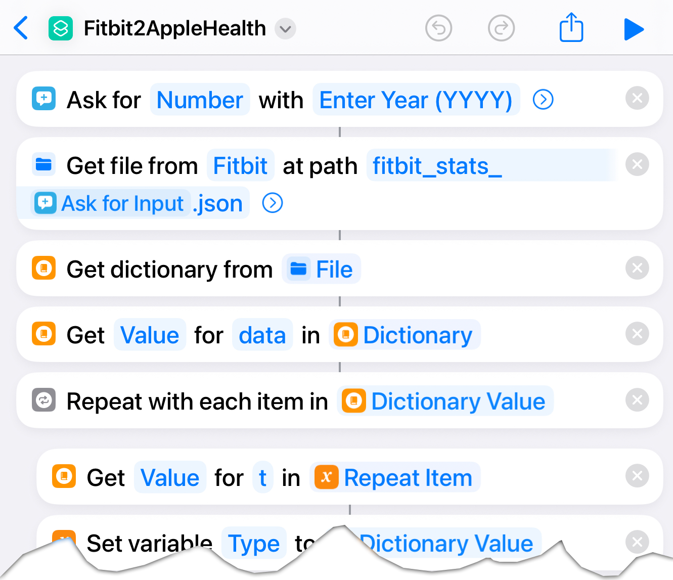

The Logic & The "Gotchas"
The logic is simple:
  • Get File (e.g., fitbit_data_2016.json)
  • Parse JSON
  • Loop through days
  • Write to Health
Shortcut fragment
However, there are two specific traps I fell into:
1. The "Magic Variable" (The Silent Failure)
This was the part that cost me the most time. In my early attempts, the script would run successfully, but zero data would show up in Apple Health.
  • My Experience: When you add an action like "Get Dictionary Value," Shortcuts tries to be helpful by automatically linking it to the previous step. However, I found that these automatic links often passed the data as generic "Text" rather than the actual number or date object. When the script tried to write "Text" into a numeric Health field, it just gave up without an error message.
  • The Fix: I stopped trusting the automatic connections entirely. I used the "Select Magic Variable" feature for every single step. By manually tapping the specific output bubble from the JSON parsing step, I forced Shortcuts to pass the correct data type.
2. The Date Parser
Do not use the generic "Date" action; it is brittle.
  • The Fix: Use the action "Get Dates from Input". It is a smart detector that correctly interprets YYYY-MM-DD strings.
