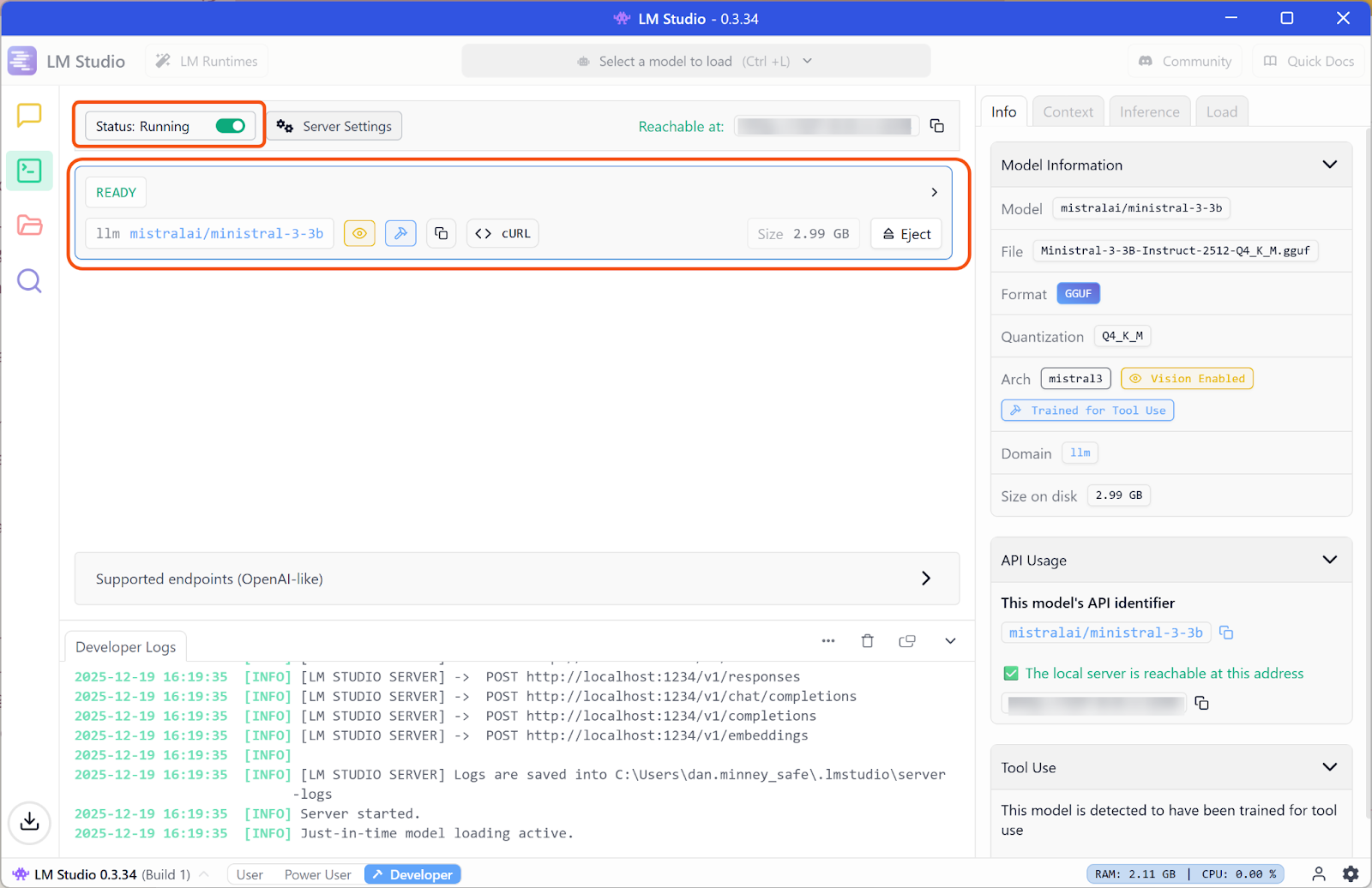

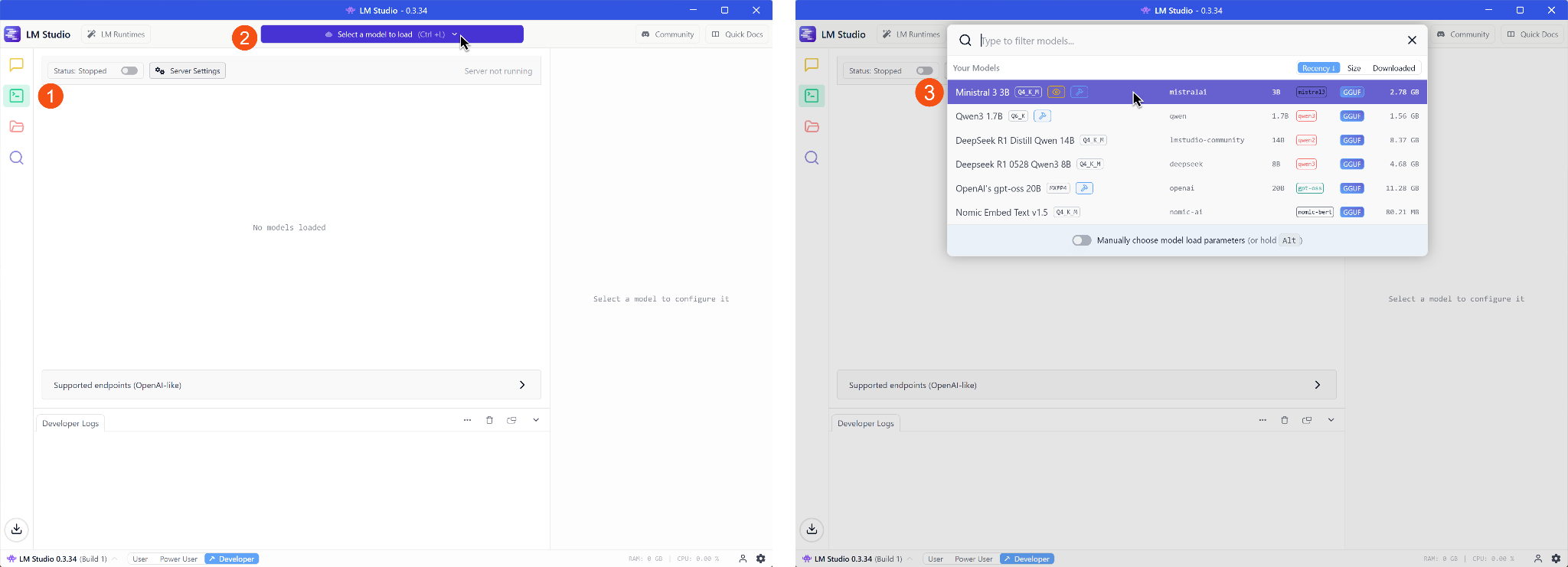

1. Open LM Studio and Load a Model

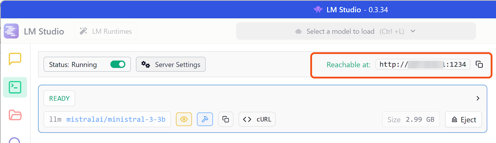

Open LM Studio on your machine. Make sure you’re in Developer mode by clicking on the Developer button at the bottom-left of the window.
Go to the Developer tab by clicking on the green button on the left side of the LM Studio window. Next, click the "Select a model to load" button at the top of the window to choose the model you want to use.
Once ready, click on the toggle next to the Status button. This will begin running LM Studio as a server.

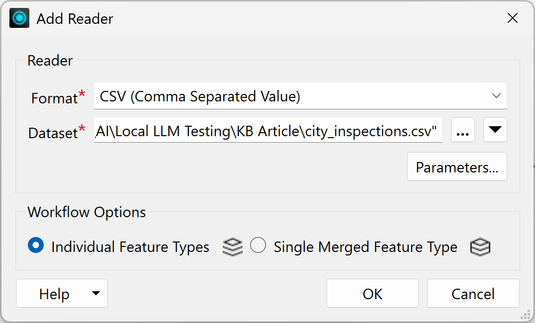

3. Add and Configure a CSV Reader
In this example, we will be using a dataset of public works service requests. We will utilize AI to assess the severity of these issues and categorize them based on their descriptions.
Add a Reader to the workspace and set the parameters as follows:
  • Format: CSV (Comma Separated Value)
  • Dataset: download the CSV file from this article and provide its file path.
Click OK to add the reader to the workspace.

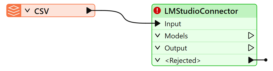

4. Add and Configure a LMStudioConnector
Next, add an LMStudioConnector to the workspace. When prompted, download the transformer from the FME Hub. Alternatively, download the transformer from the FME Hub and install it with your preferred version of FME.

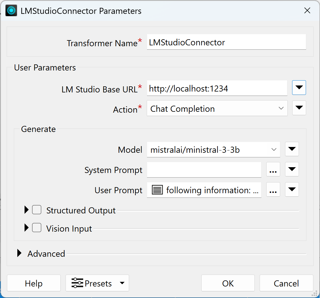

Open the LMStudioConnector and configure the parameters as follows:
  • LM Studio Base URL: enter your base URL. This can be found from within LM Studio in the Developer tab.
    • If running LM Studio locally, you can use http://localhost:1234
  • Action: Chat Completion
  • Model: enter the name of the model you want to use
    • In this tutorial, we are using a lightweight model - mistralai/ministral-3-3b
  • User Prompt:
You are a dispatcher for the City of Vancouver. Categorize this service request: '@Value(description)'. Return the following information:
- department (Transportation, Parks & Rec, or Engineering)
- priority (1 for Emergency, 2 for Urgent, 3 for Routine)
- equipment (what specific tool, if any, is needed for the task?)
Click OK to accept the new parameters.

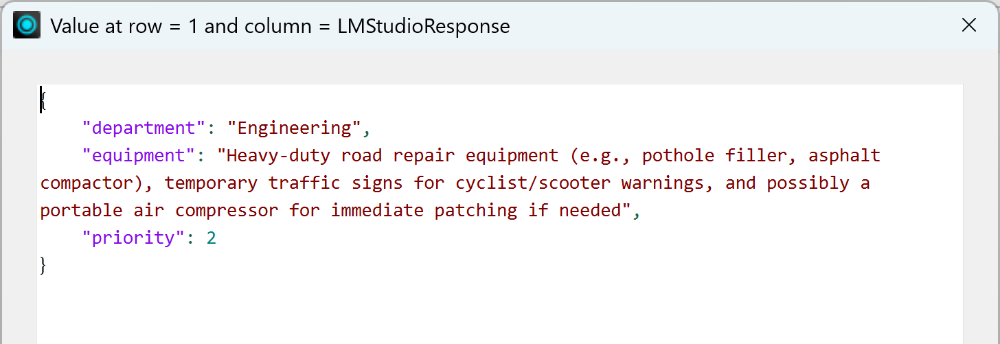

5. Run the LMStudioConnector and Inspect the Output

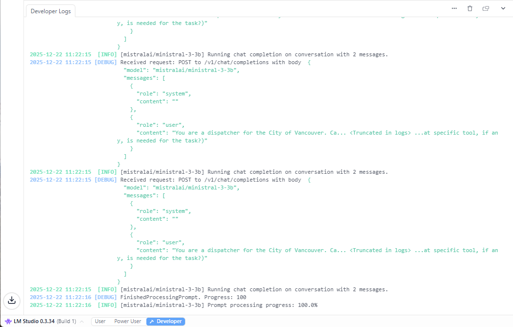

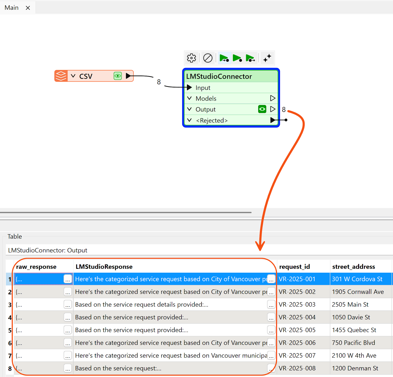

With data caching enabled, run the workspace. In LM Studio, you should see that it receives the API request from FME and is processing the results.

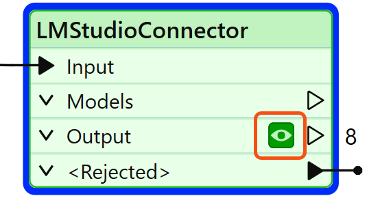

When the workspace has finished running, click the LMStudioConnector Output port to open the Data Inspector window.
In the Table view, you can see the LMStudioResponse attribute that includes the response from the LLM. The Output also includes the raw_response attribute, which contains the raw JSON response from the LLM.

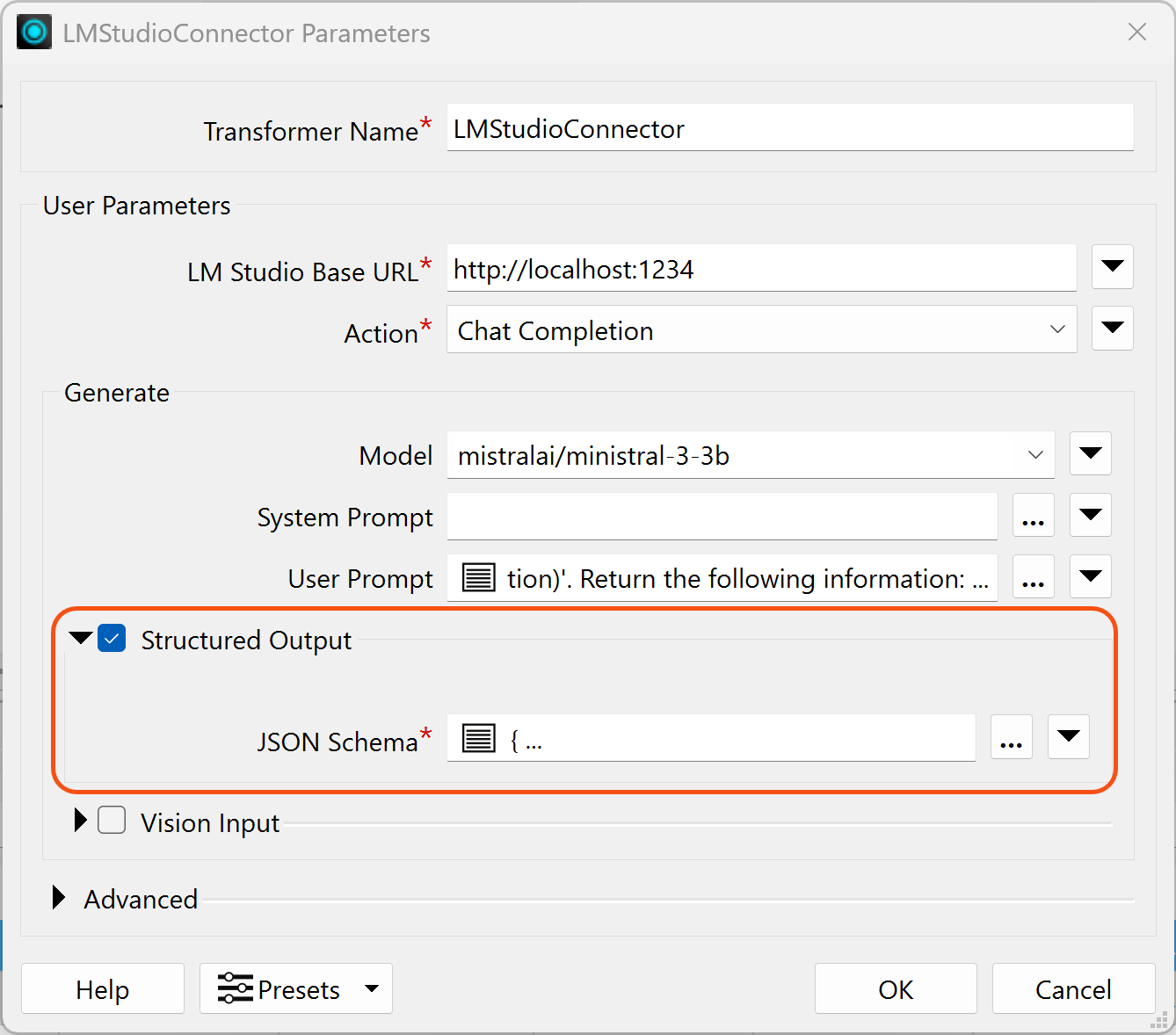

6. Using a JSON Schema
To obtain a more structured response, we can provide a JSON Schema to the LLM, informing it of our expected output structure. This allows for predictable responses and is a best practice when using an AI connector in FME.
Open the LMStudioConnector parameters, enable Structured Output, and then provide the following value for the JSON Schema:
Again, with data caching enabled, run the workspace and inspect the output. This time, you will see that the LMStudioResponse attribute contains a structured JSON output.

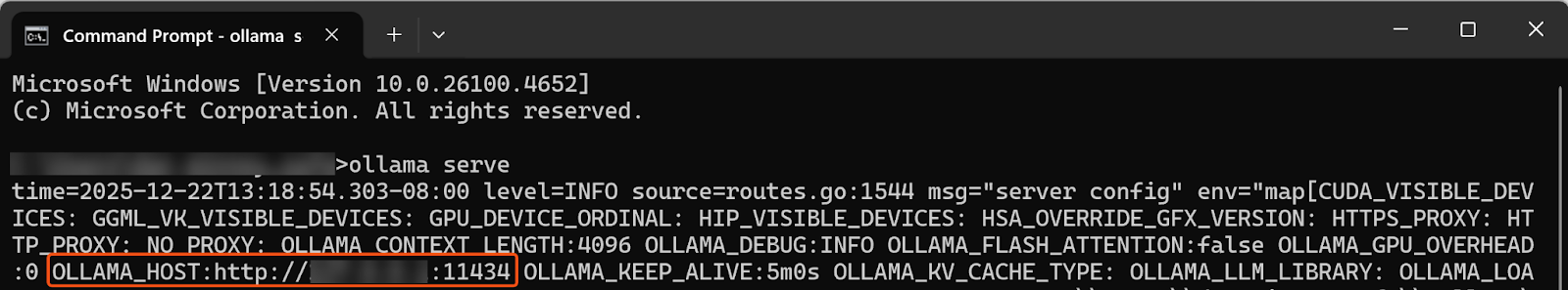

1. Start Ollama as a Server
Open a Command Prompt window on your machine. Enter the following command to start the Ollama Server.
ollama serve
You should see some log messages as Ollama initializes. You’re now ready to send requests to any of the LLMs you’ve downloaded in Ollama.

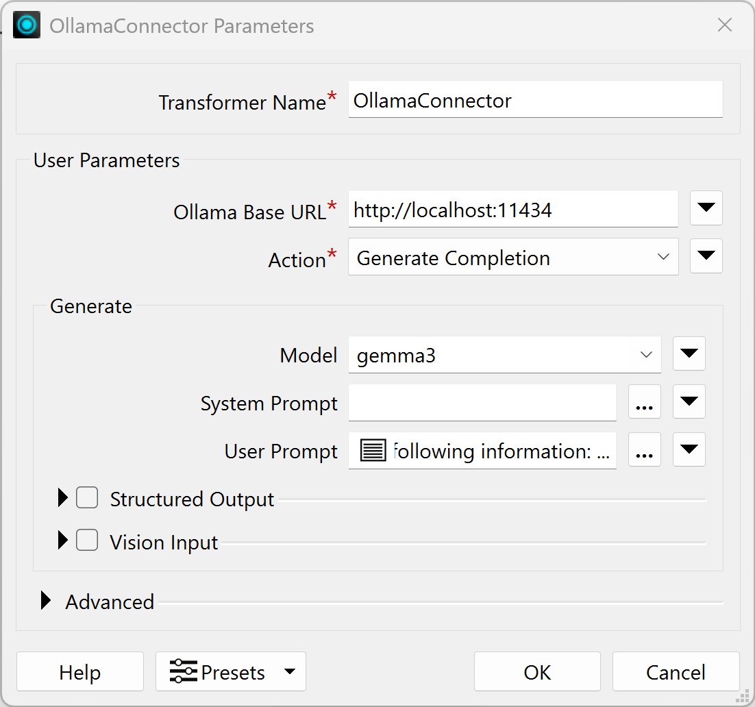

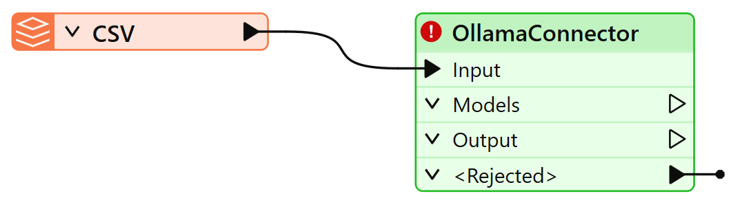

4. Add and Configure an OllamaConnector
Next, add an OllamaConnector to the workspace. When prompted, download the workspace from the FME Hub. Alternatively, download the transformer from the FME Hub and install it with your preferred version of FME.
Open the OllamaConnector and configure the parameters as follows:
  • Ollama Base URL: enter your base URL.
    • This can be found in the Command Prompt window after entering the ollama serve command.
    • Note: the default value is http://localhost/11434
  • Action: Generate Completion
    • In this tutorial, we are using a lightweight model by Google called gemma3
  • User Prompt:

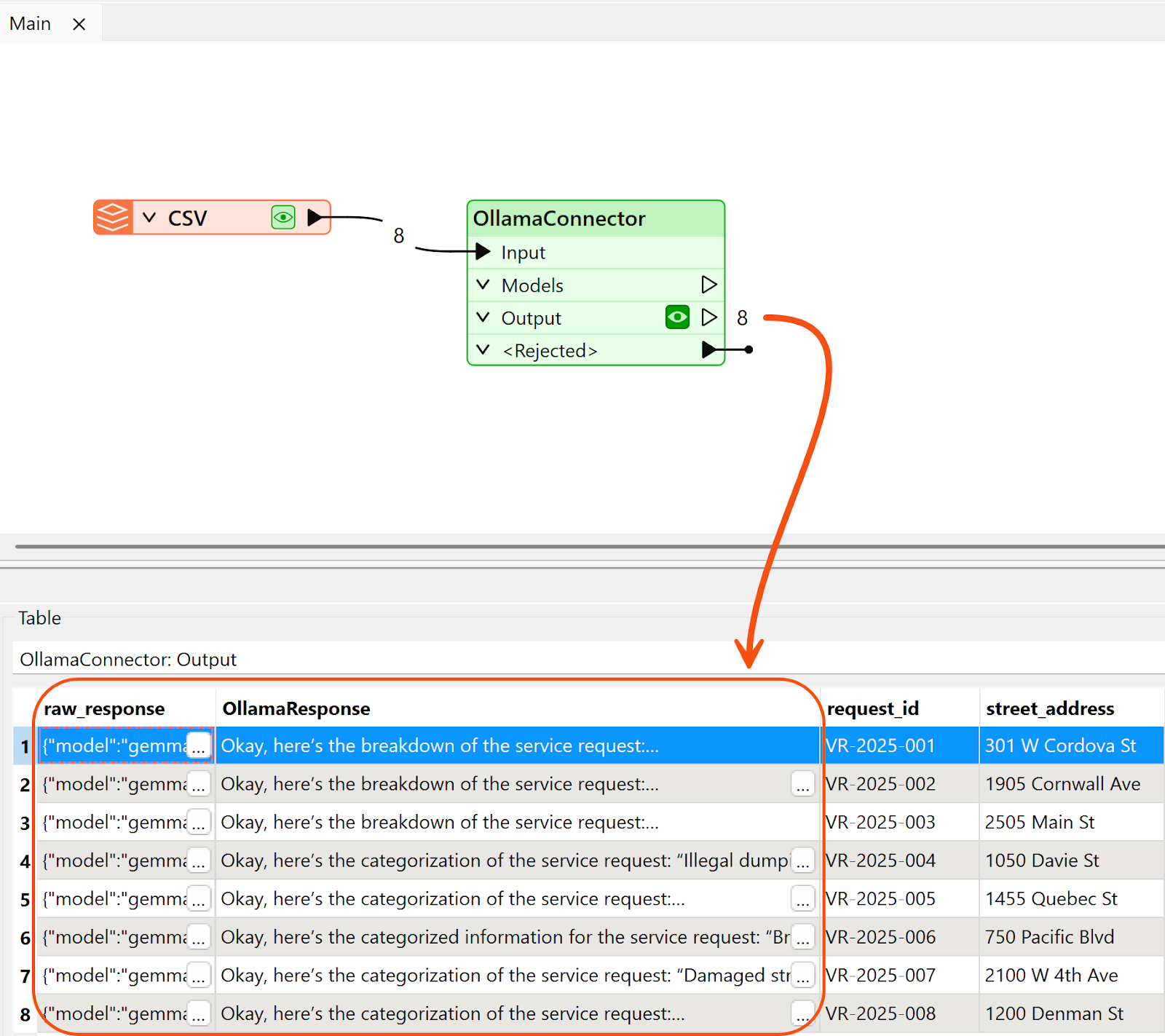

5. Run the OllamaConnector and Inspect the Output
With data caching enabled, run the workspace in FME Workbench.

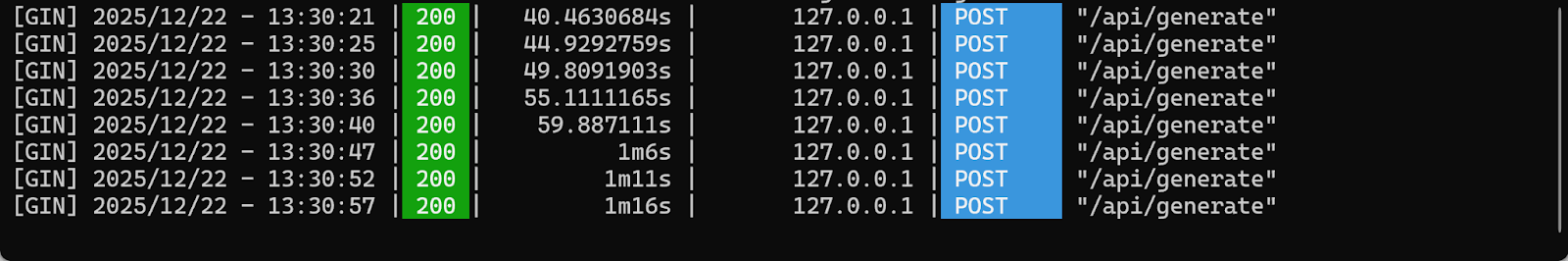

In the Command Prompt window, you will see that Ollama has received the API request and is processing the results.

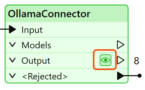

Once all records have been processed, the OllamaConnector will output the response in FME Workbench.
Click on the OllamaConnector Output port to open the data inspector window and view the results.

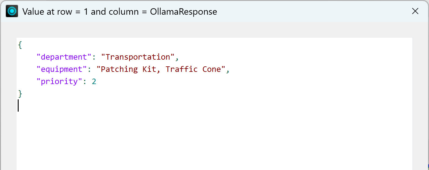

In the Table view, you can see the OllamaResponse attribute that includes the response from the LLM. The Output also includes the raw_response attribute, which contains the raw JSON response from the LLM.

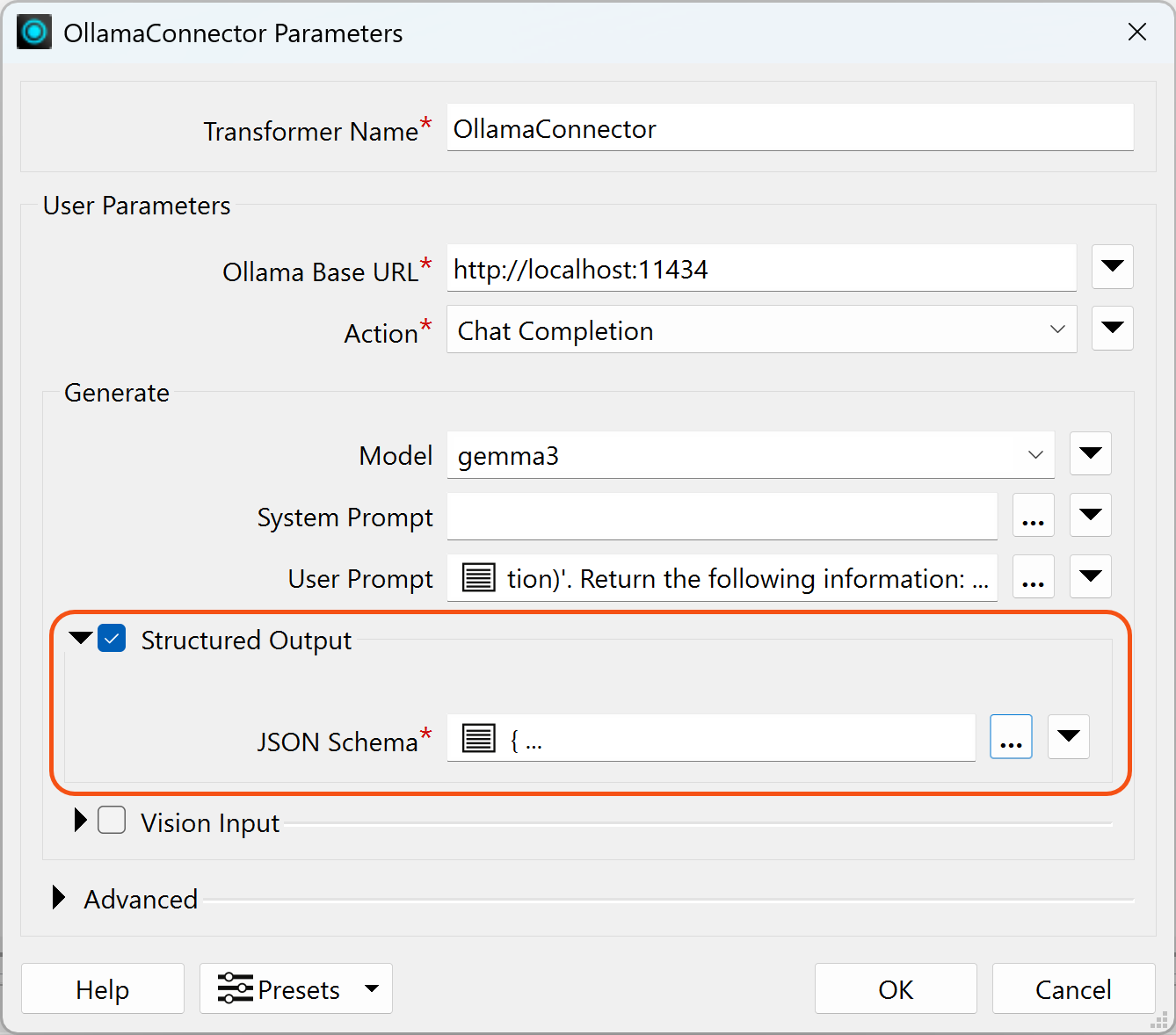

To obtain a structured response, we can provide a JSON Schema to the LLM, which will inform it of the expected output format. This allows for predictable responses and is generally a best practice when using any AI connector in FME.
Open the OllamaConnector parameters, enable Structured Output, and then enter the following value for the JSON Schema parameter:
Again, with data caching enabled, run the workspace and inspect the output. This time, you will see that the OllamaResponse attribute contains a structured JSON response.
To extract information from the response, you can use one of FME’s many JSON parsing transformers, such as the JSONExtractor, JSONFlattener, or JSONFragmenter. For more information, check out the following tutorial: Transforming JSON using the JSONExtractor, JSONFlattener, and JSONFragmenter

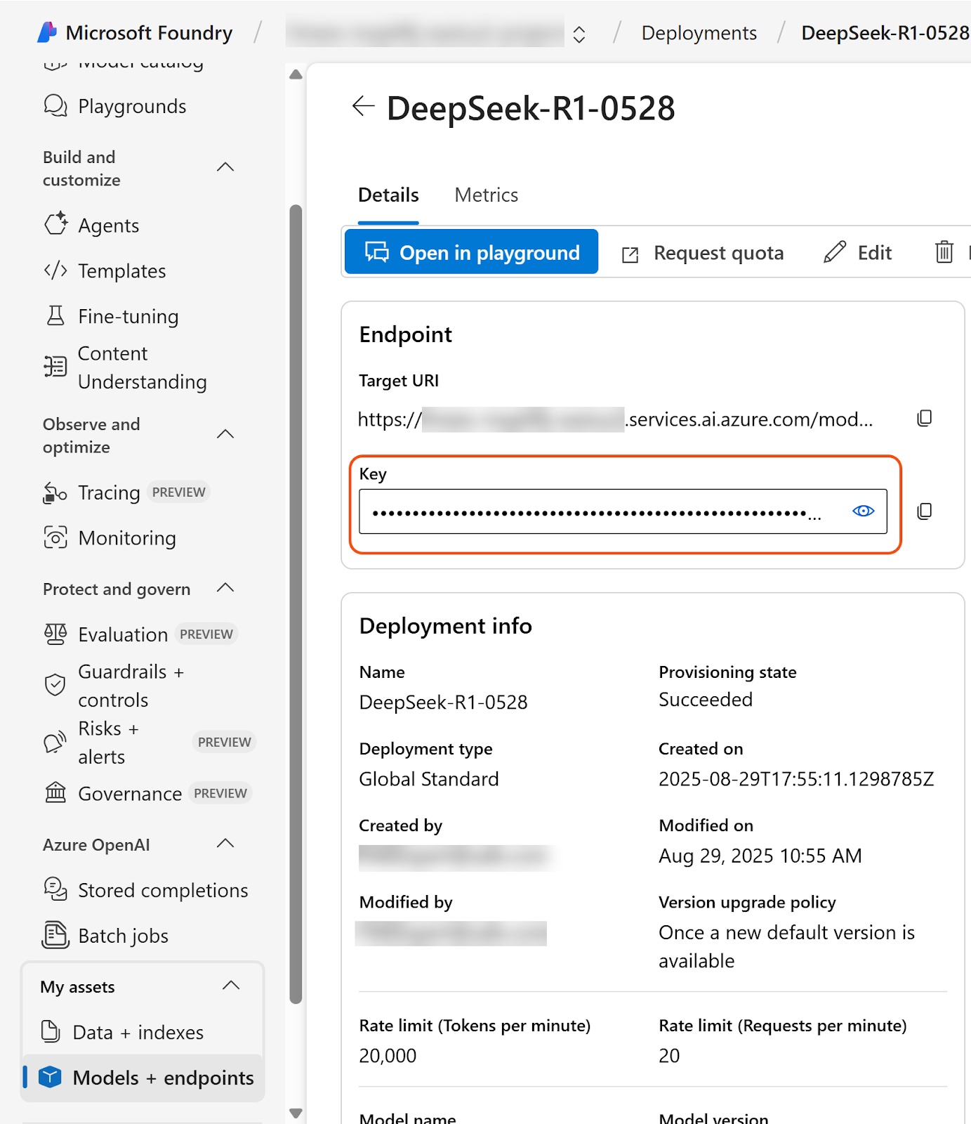

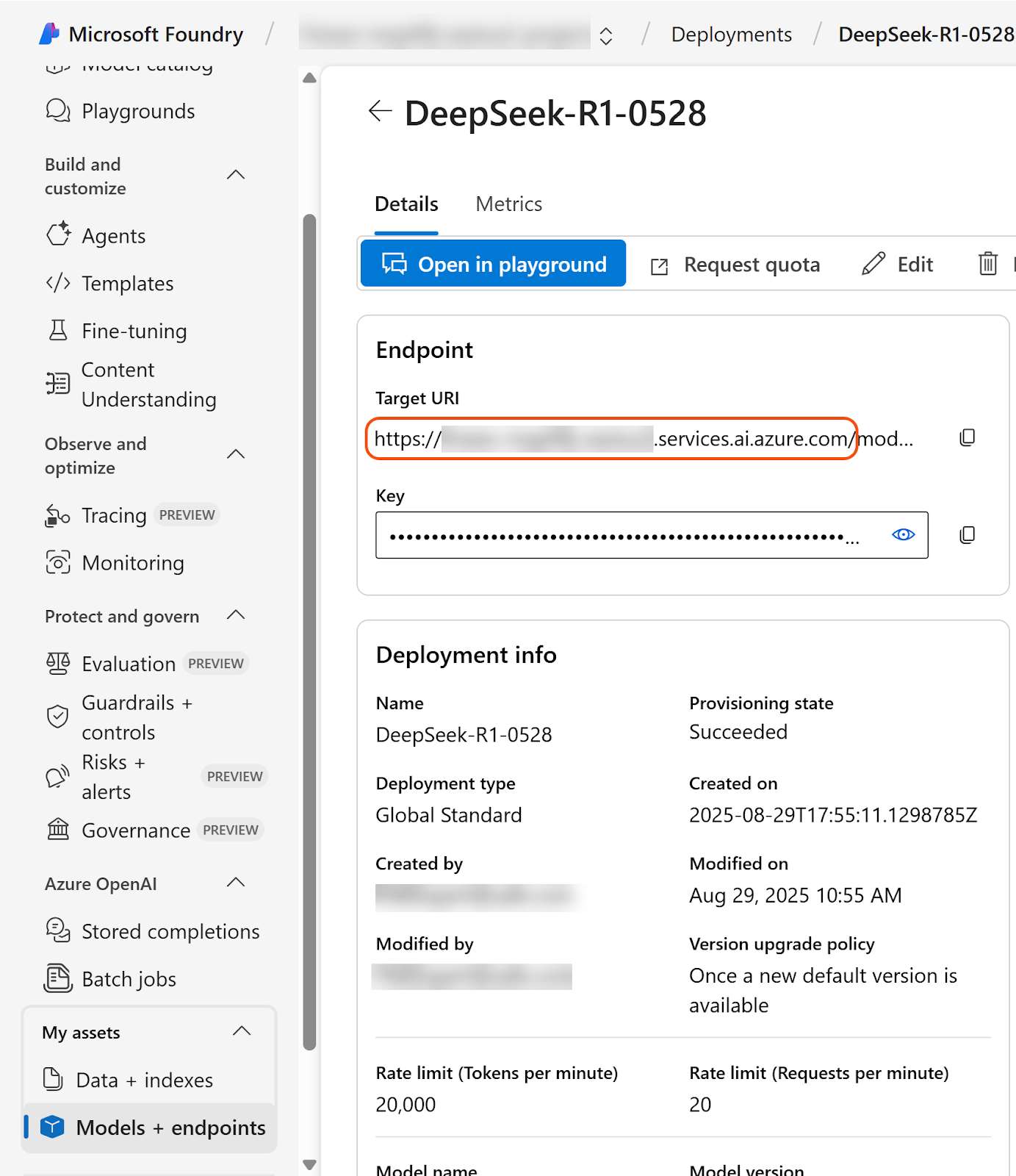

1. Retrieve the Model API Key from Azure AI Foundry
In Azure AI Foundry, go to the “Models + endpoints” page to view your model deployments. Click on the model you want to use. Keep this window open as we will need the API Key and the Target URI later.
In this tutorial, we will be using DeepSeek-R1-0528; however, any model that supports the Chat Completion endpoint will work.

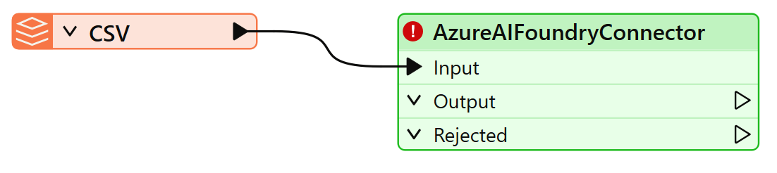

4. Add and Configure an AzureAIFoundryConnector
Next, add an AzureAIFoundryConnector to the workspace. When prompted, download the workspace from the FME Hub. Alternatively, download the transformer from the FME Hub and install it with your preferred version of FME .

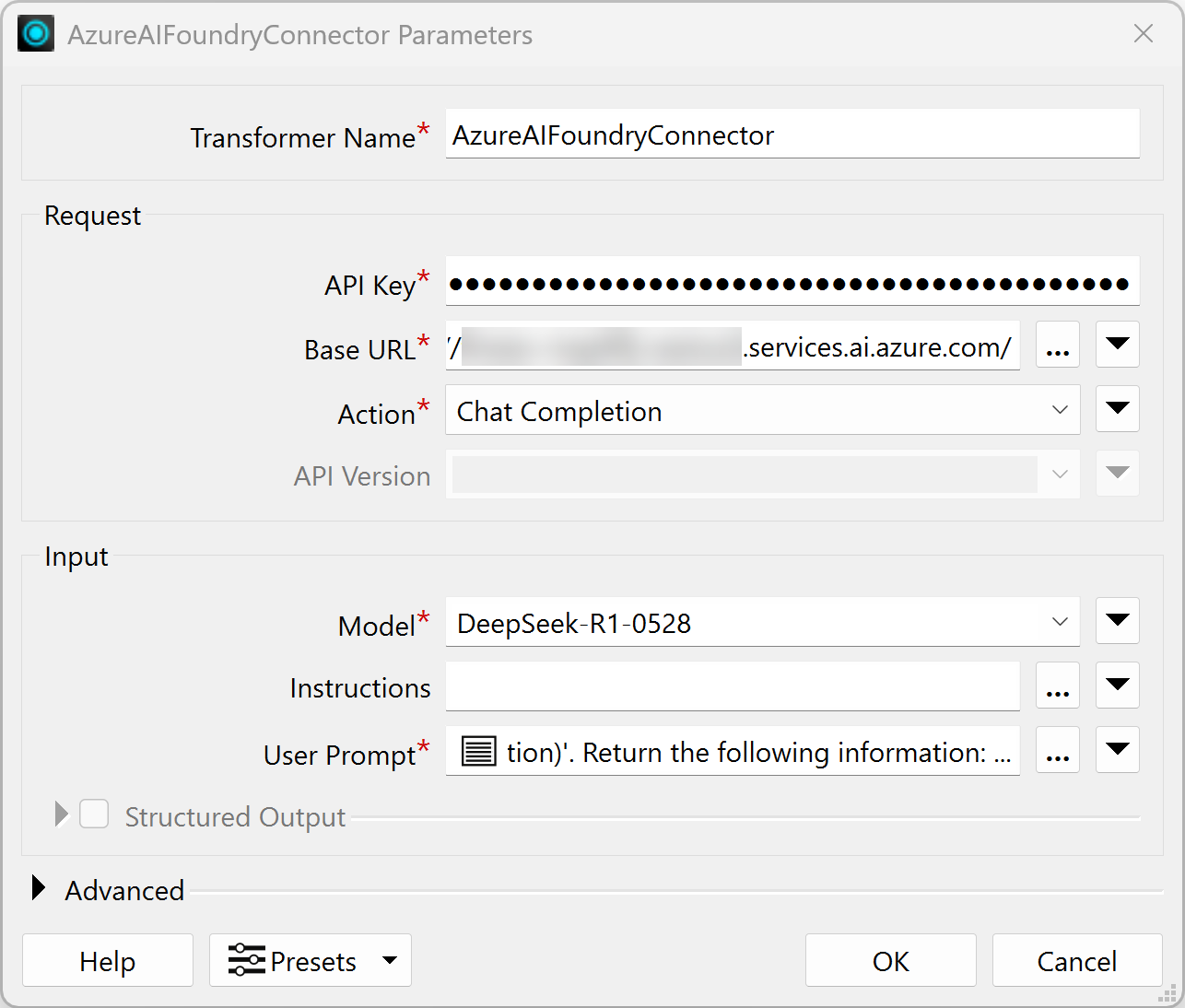

Open the AzureAIFoundryConnector and configure the parameters as follows:
  • API Key: enter the API Key for the model that you selected in Step 1.
  • Base URL: enter your base URL. For example: https://yourorganization.services.ai.azure.com/
    • This can be found in the Target URI of the model in Azure AI Foundry. Example below:
    • In this tutorial, we are using DeepSeek-R1-0528
  • User Prompt:

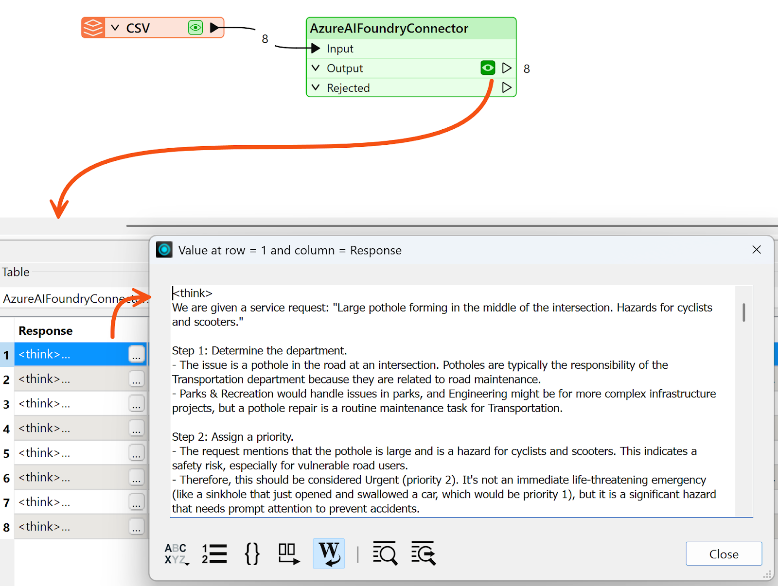

5. Run the Workspace and Inspect the Output
When the workspace has finished running, click on the AzureAIFoundryConnector Output port to open the Data Inspector window.
In the Table view, you can see the Response attribute that includes the response from the LLM.
