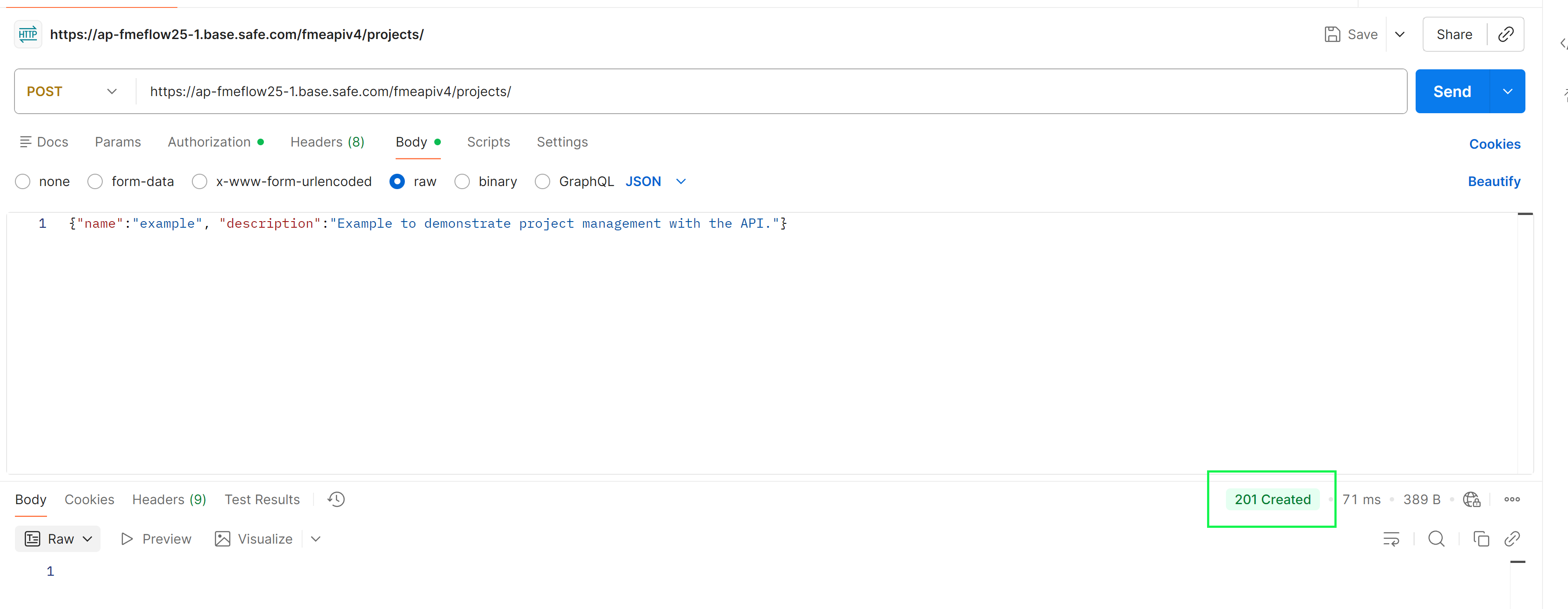

1. Create New Project
 Send a POST request to /projects with a body such as {"name": "example", "description": "Example to demonstrate project management with the API."}.
A 201 response should be returned:

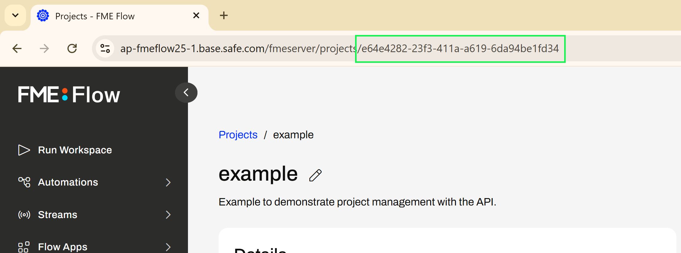

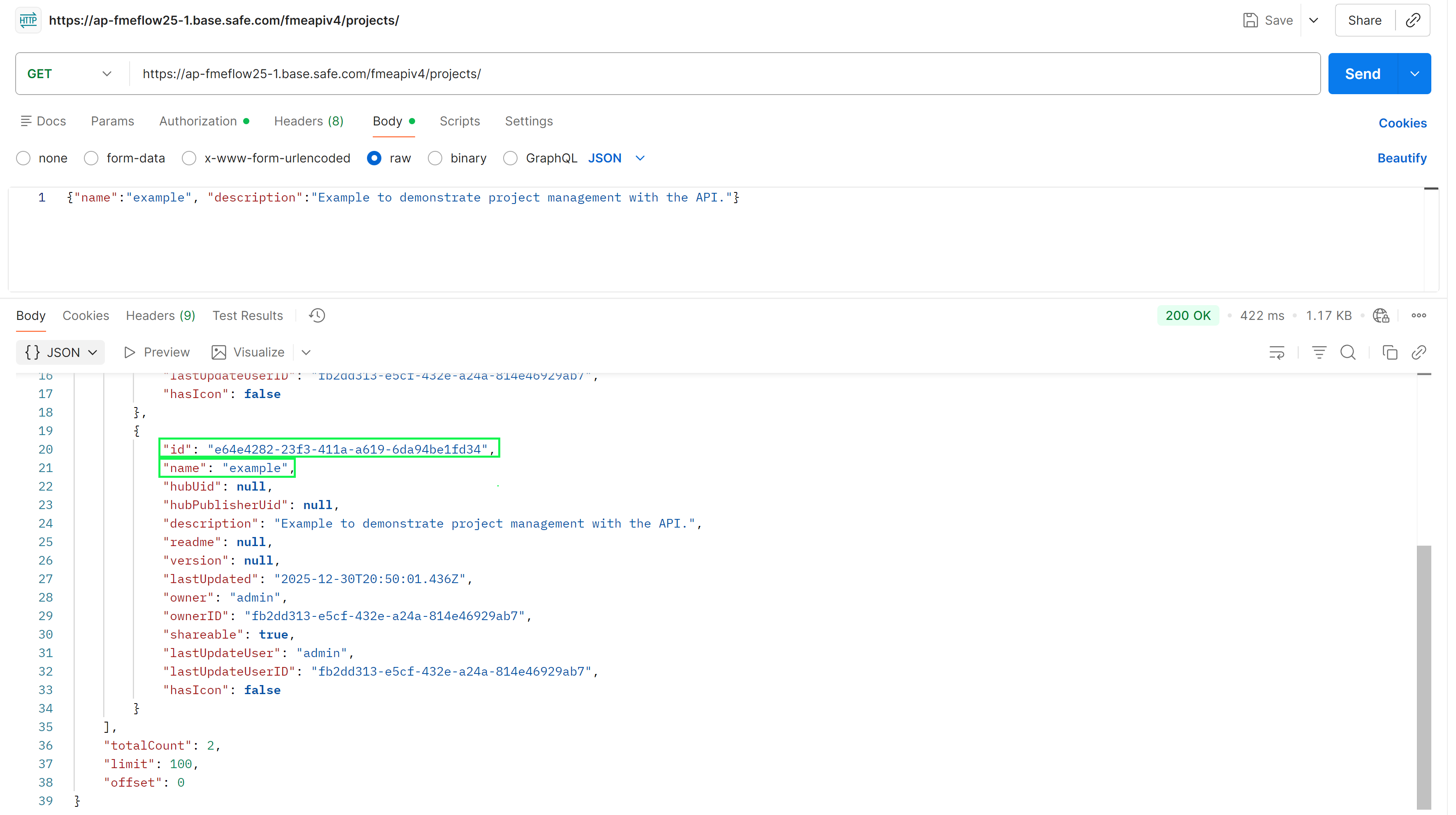

2. Get the New Project's ID
Send a GET request to /projects and note the ID corresponding to the name just specified.
This ID also appears in the URL of the project when accessed in the FME Flow UI:

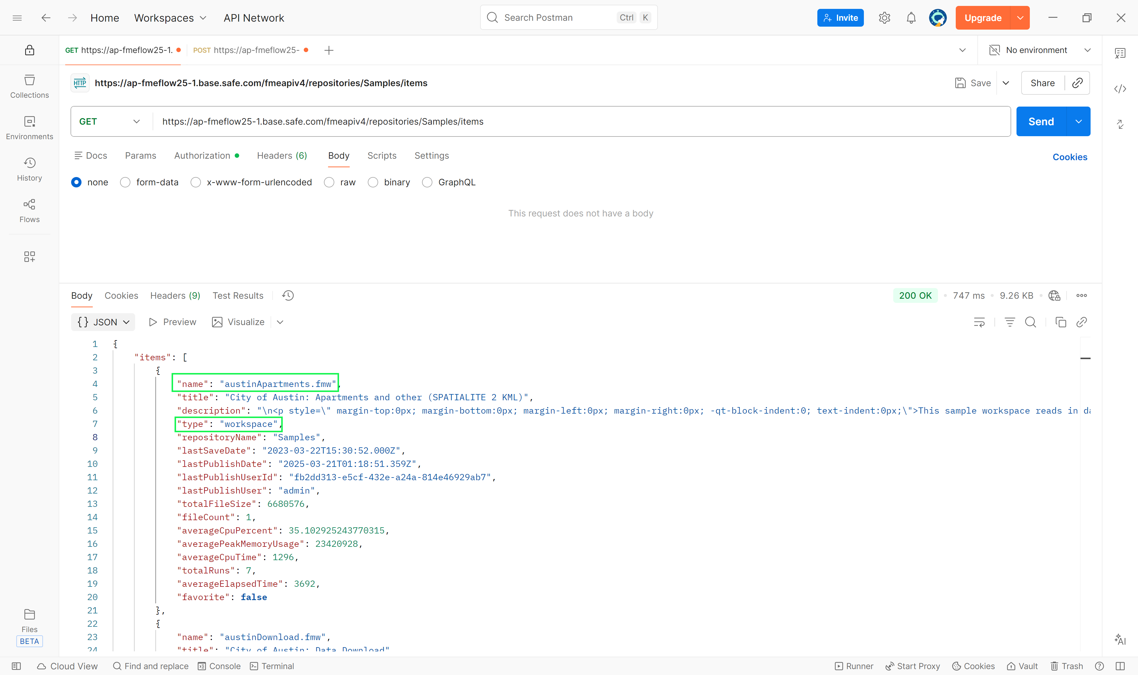

3. Get IDs of Items to Add to the Project
The API endpoints needed for this step differ depending on the item type - see the API docs for details. In this example, workspaces from the Samples repository will be used, so just one API request is required: GET /repositories/Samples/items.
In FME Flow, item IDs take different forms. Since this is repository/workspace.fmw for workspaces, names must be gathered to construct the workspaces' IDs.
Item type should also be gathered at this stage - this is required in the next step.
For this example, the ID is Samples/austinApartments.fmw.

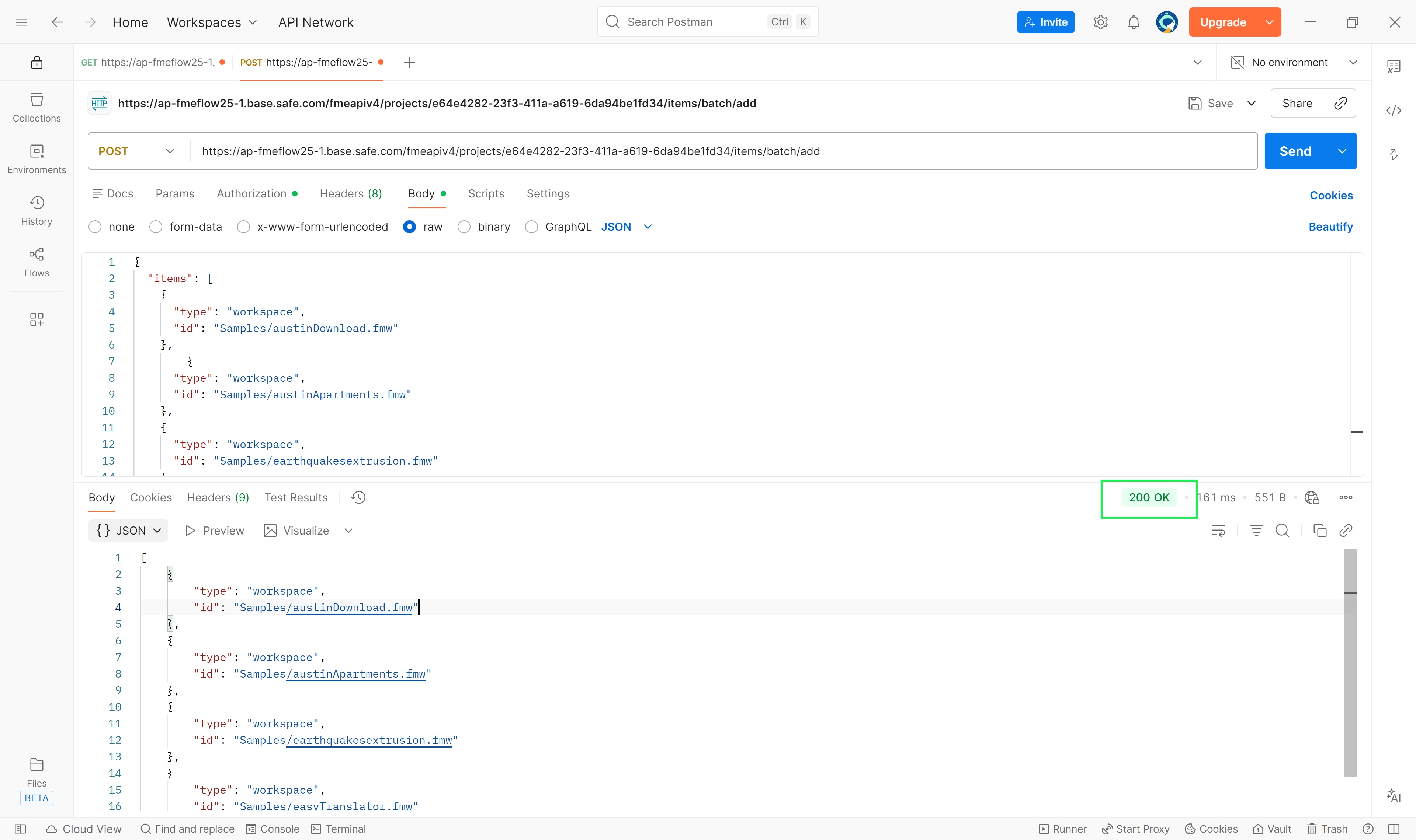

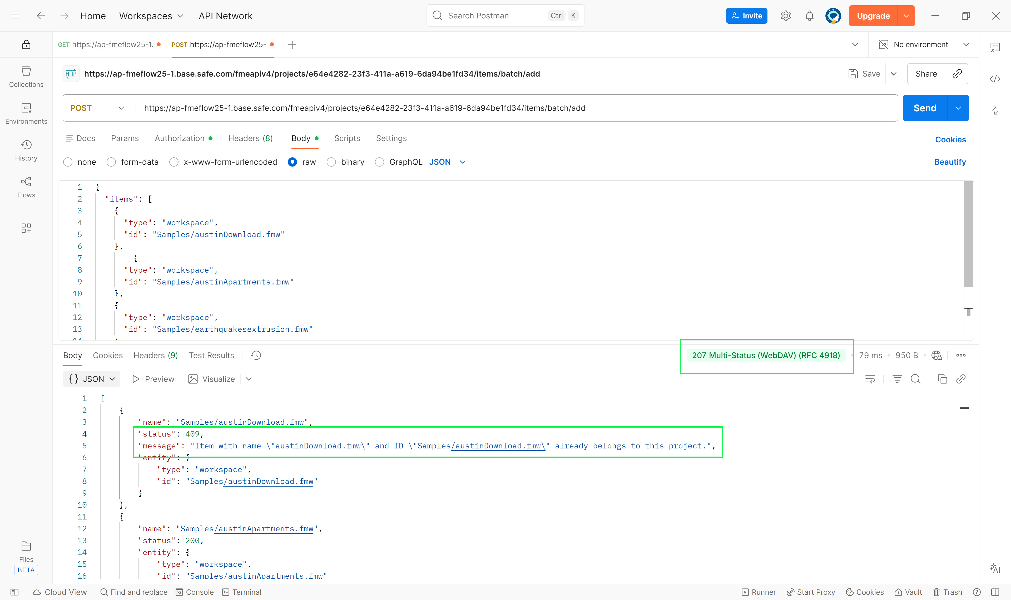

Send a POST request to /projects/{id}/items/batch/add with the body just constructed. {id} is the project ID found in step 2.
If successful, the response status code will be 200:
If something went wrong, the response will be 207 and the errors will be shown within the response:

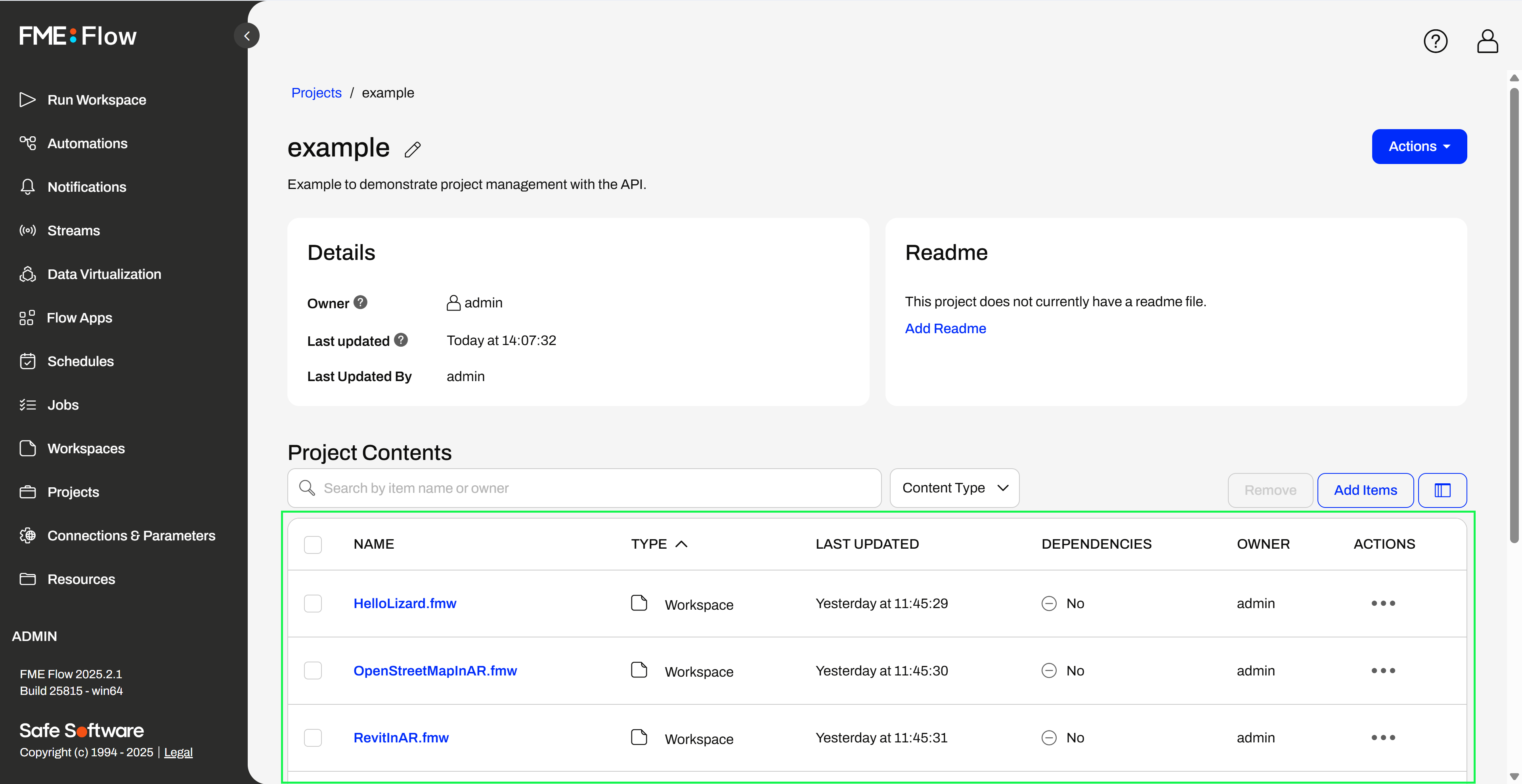

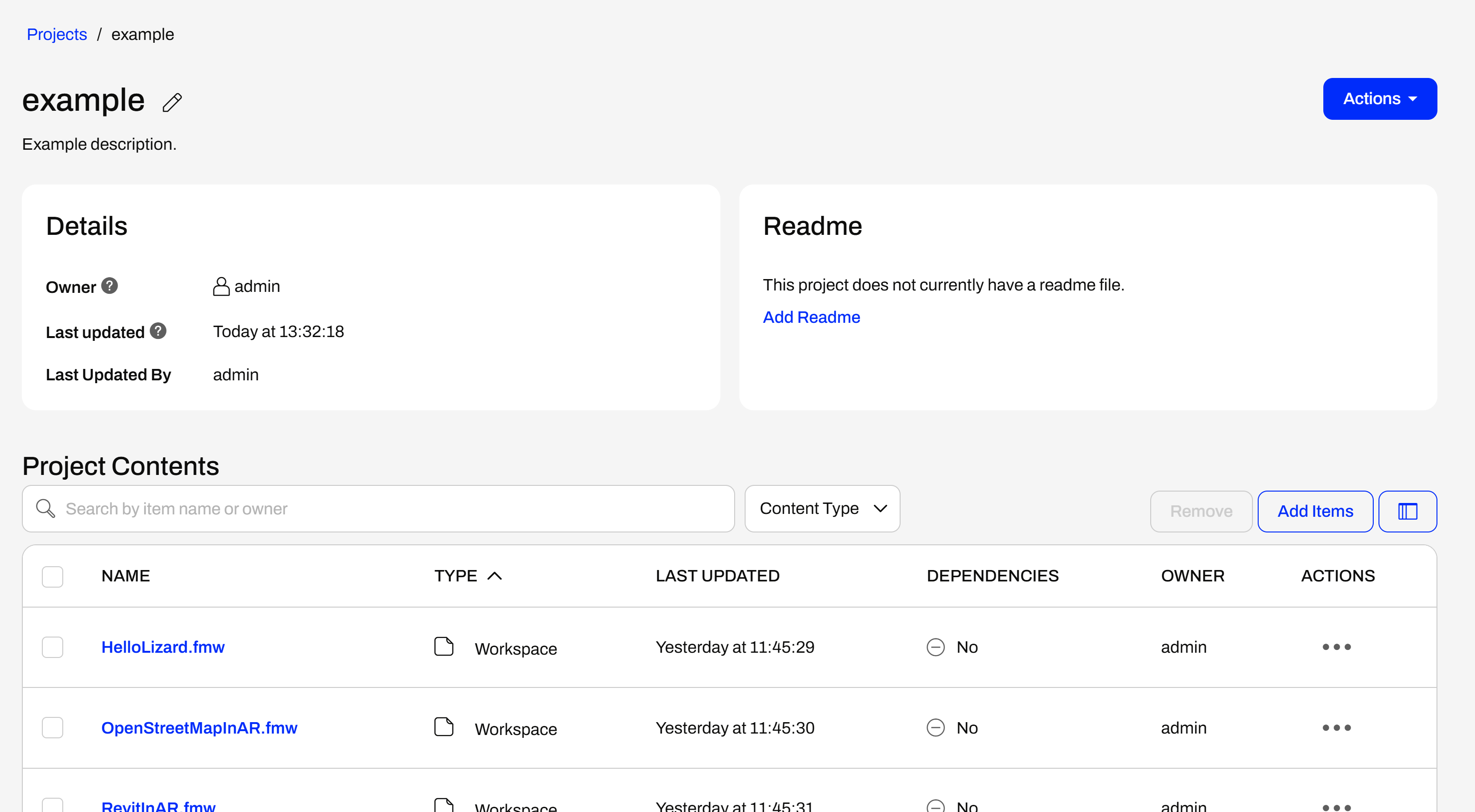

5. Verify the Items were Added Successfully.
This can either be done by sending a GET request to /projects/{id}/items or within the FME Flow UI.

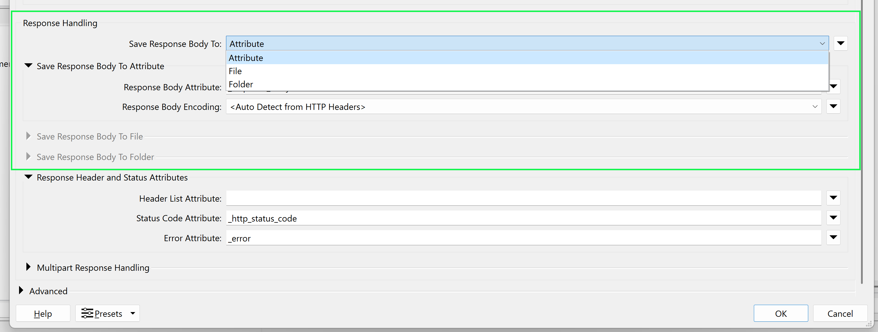

To export as a download, use POST /projects/{id}/export/download. Calling this from within an HTTPCaller in Workbench, the response can either be saved to a file, attribute or folder:
An example request body is {"exportPackageName":"example.fsproject"}. Consult the endpoint's schema for more information on this.

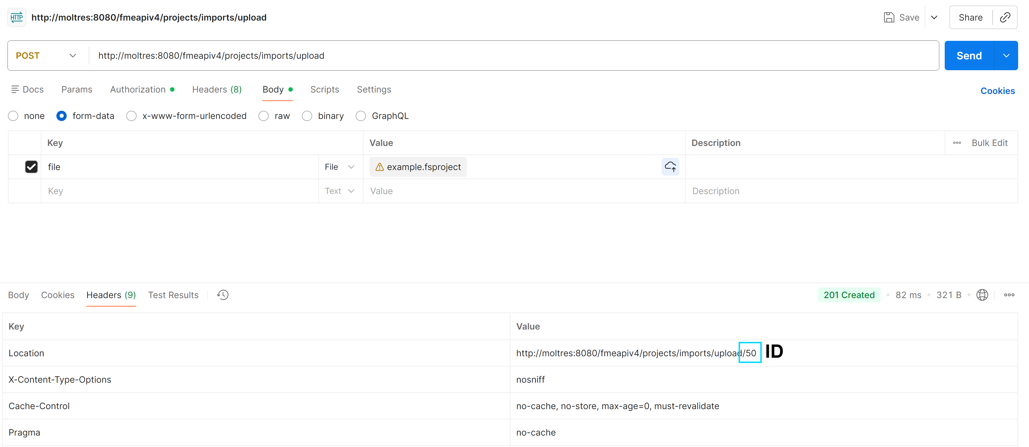

  1. Upload the project file using POST /projects/imports/upload or POST /projects/imports/resource. Get the job ID from the response header.

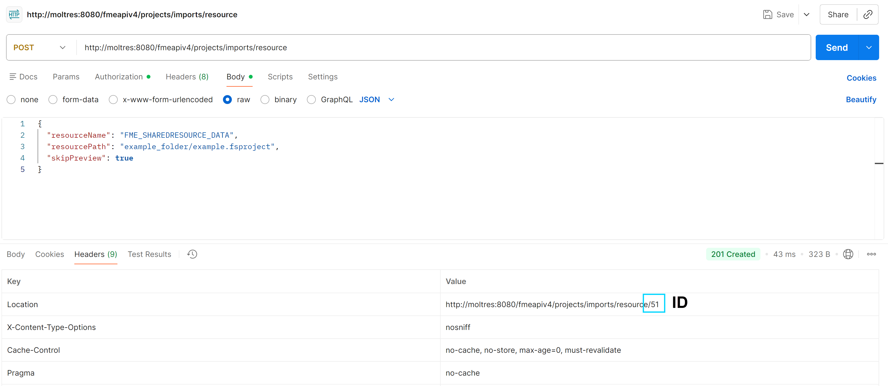

If uploading from outside of FME Flow, use POST /projects/imports/upload?skipPreview=true with the project file in the body:
If importing from Resources, use POST /projects/imports/resource with a body of the following format:
  "resourceName": {resource connection},
  "resourcePath": {path to .fsproject from within connection},
  "skipPreview": true
Parse the ID from the Location header, highlighted in both screenshots above.
This header does not appear in the API documentation, so it is subject to change without notice. See the Troubleshooting section for guidance on an implementation suitable for production environments.

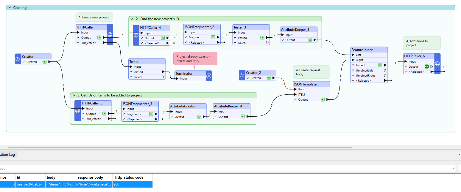

The attached workspace api_project_management.fmw runs through the three tasks mentioned. Here's how to use it:
1. Download and Open the Workspace
Download api_project_management.fmw and open in FME Form.

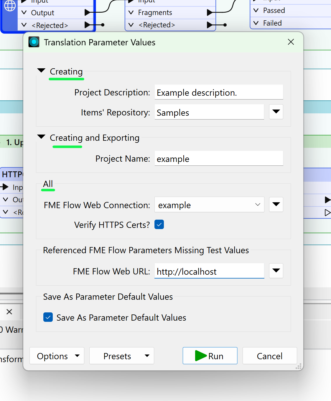

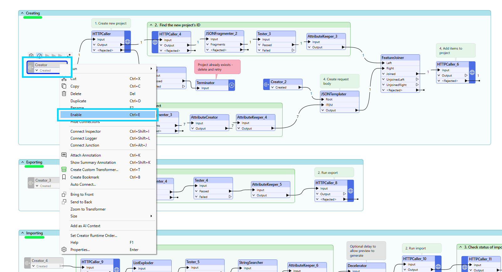

2. Enable the Relevant Creator
Choose which task to run (Creating, Exporting or Importing), and enable the relevant Creator. To enable, right-click and press Enable:
3. Set User Parameters
Press Run, and set the relevant parameters by looking at the headers. Some of them may have default values, which can be kept. Set FME Flow Web URL to the domain of your FME Flow instance (without /fmeserver).

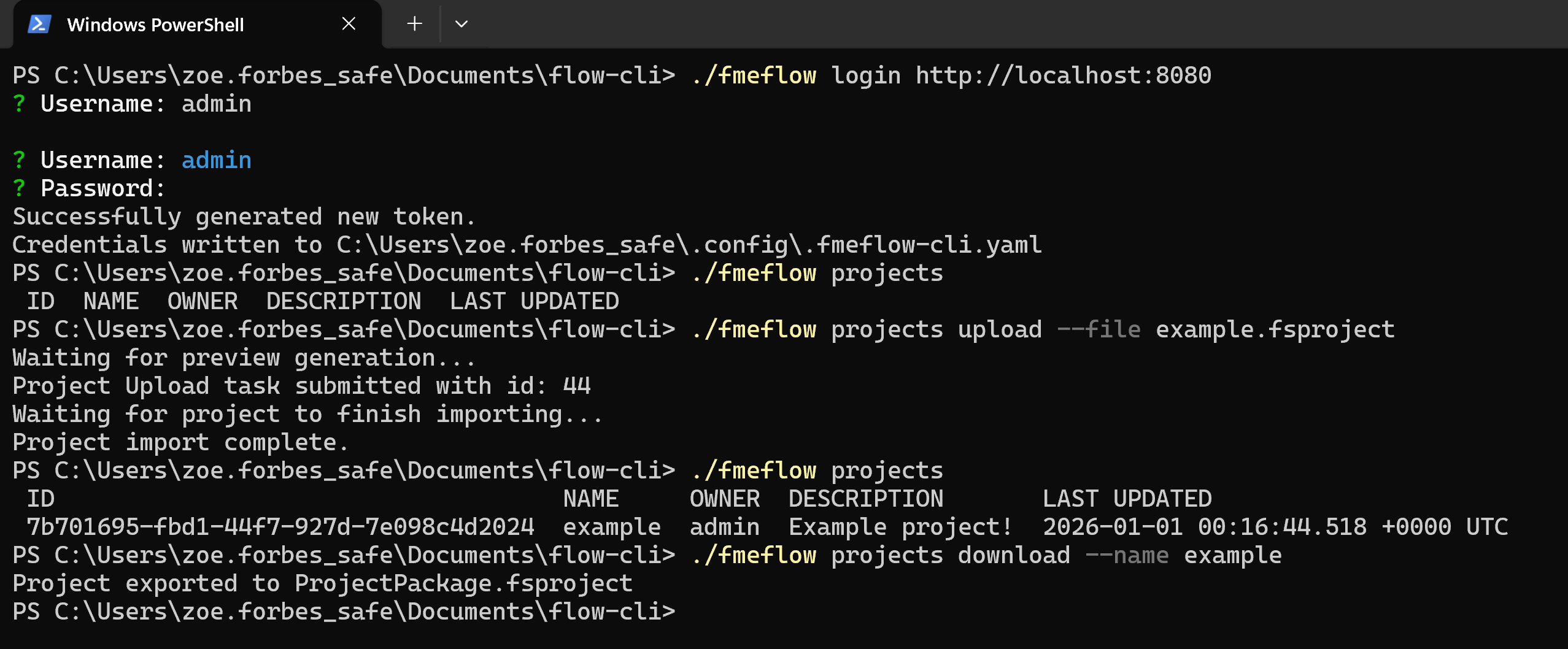

Simpler Alternative: Using the CLI
Depending on the use case, it might be preferable to use the FME Flow Command-Line Interface instead of the REST API. The following commands can be used to achieve some of the tasks covered above.
  • To create a project, use the API. This isn't currently possible with the CLI.
  • To export a project, use fmeflow projects download --name [project name]
  • To import a project, use fmeflow projects upload --file [name.fsproject]
Here's an example of the CLI used for project management. In the screenshot, the user authenticates, imports and exports a project. The command fmeflow projects is used to list projects currently on FME Flow.

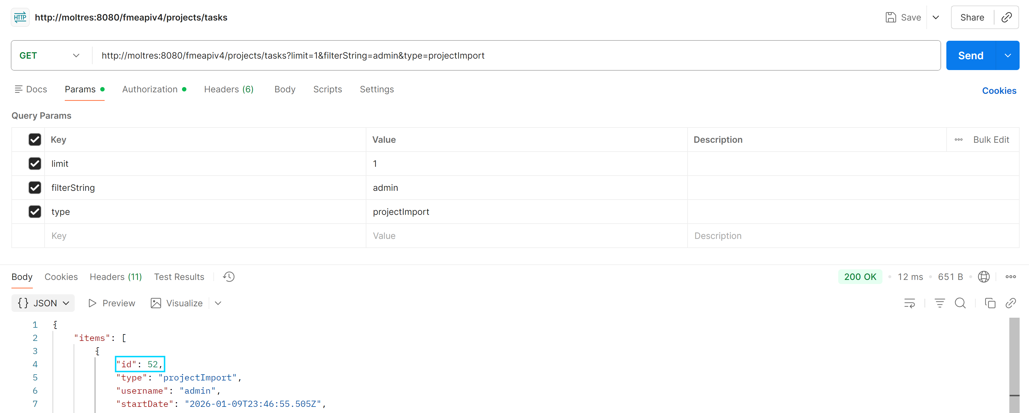

1. Upload the file as before, using POST /projects/imports/upload?skipPreview=true or POST /projects/imports/resource.
2. Find the ID of the most recently uploaded project by the current user, using the request GET /projects/tasks?limit=1&type=projectImport&filterString={username}.
The query parameters in step 2 aren't strictly necessary, but they prevent the wrong ID being fetched by simultaneous tasks on FME Flow.

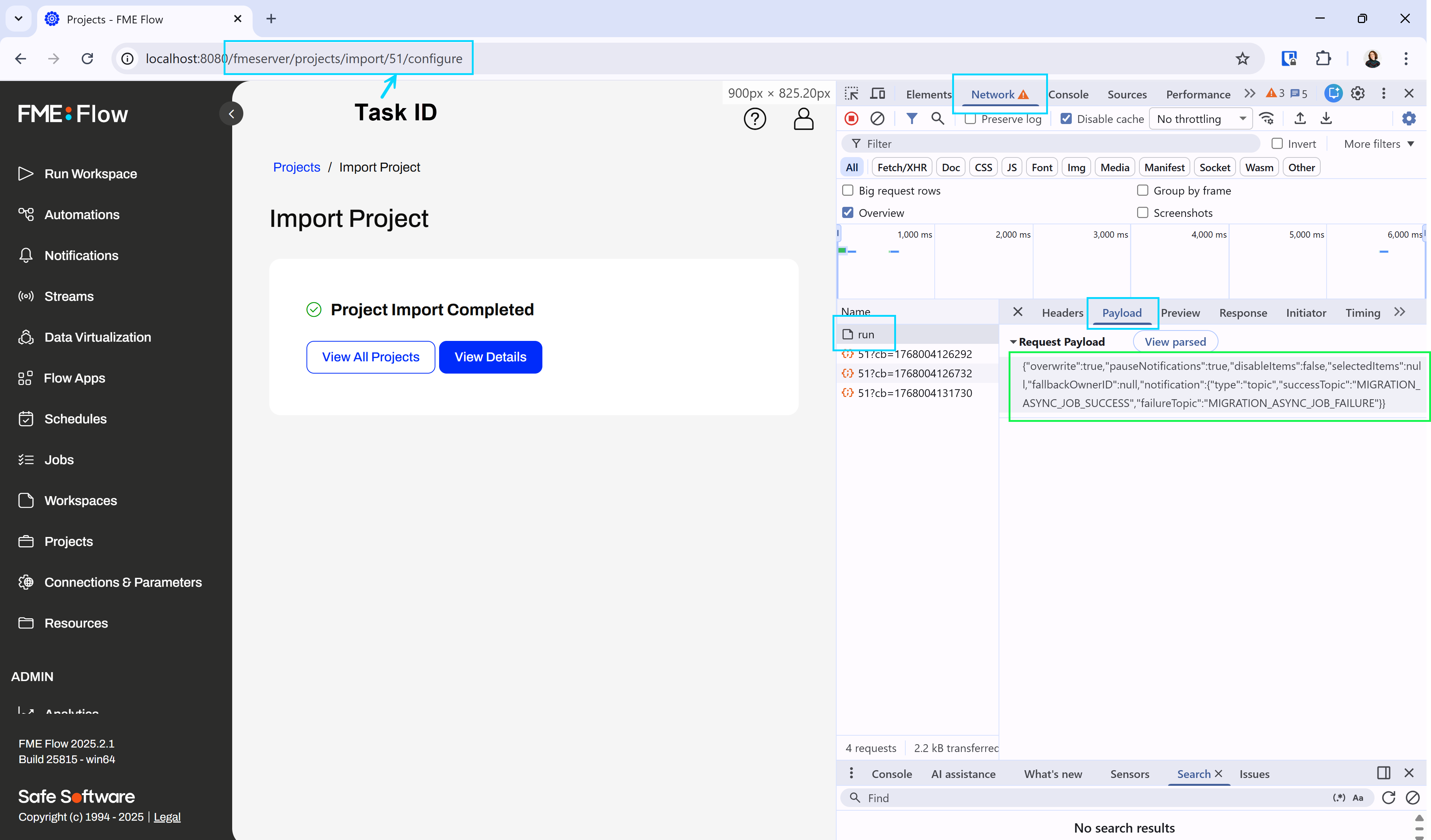

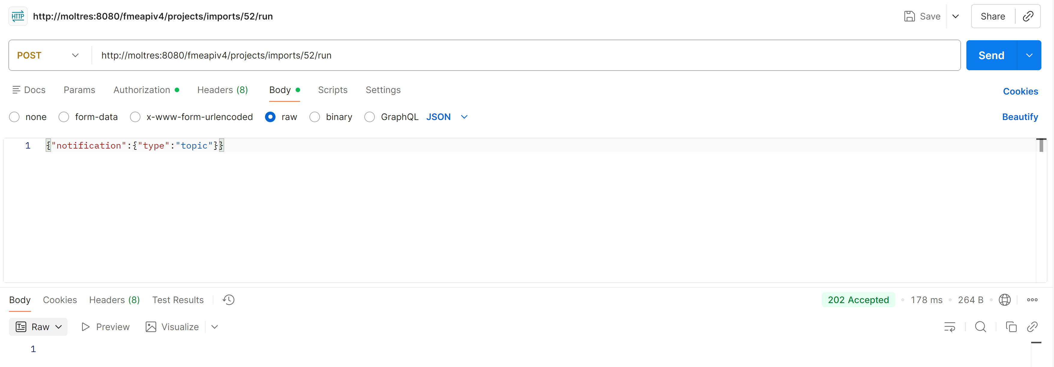

500 errors when running an import
The endpoint /projects/imports/{id}/run is known to return generic 500 errors for valid requests. This is a known issue FMEFLOW-27108.
For most versions of FME Flow, using the request body {"notification":{"type":"topic"}} will import the project successfully.
If this doesn't work, inspect and copy the request body sent by FME Flow in DevTools:
