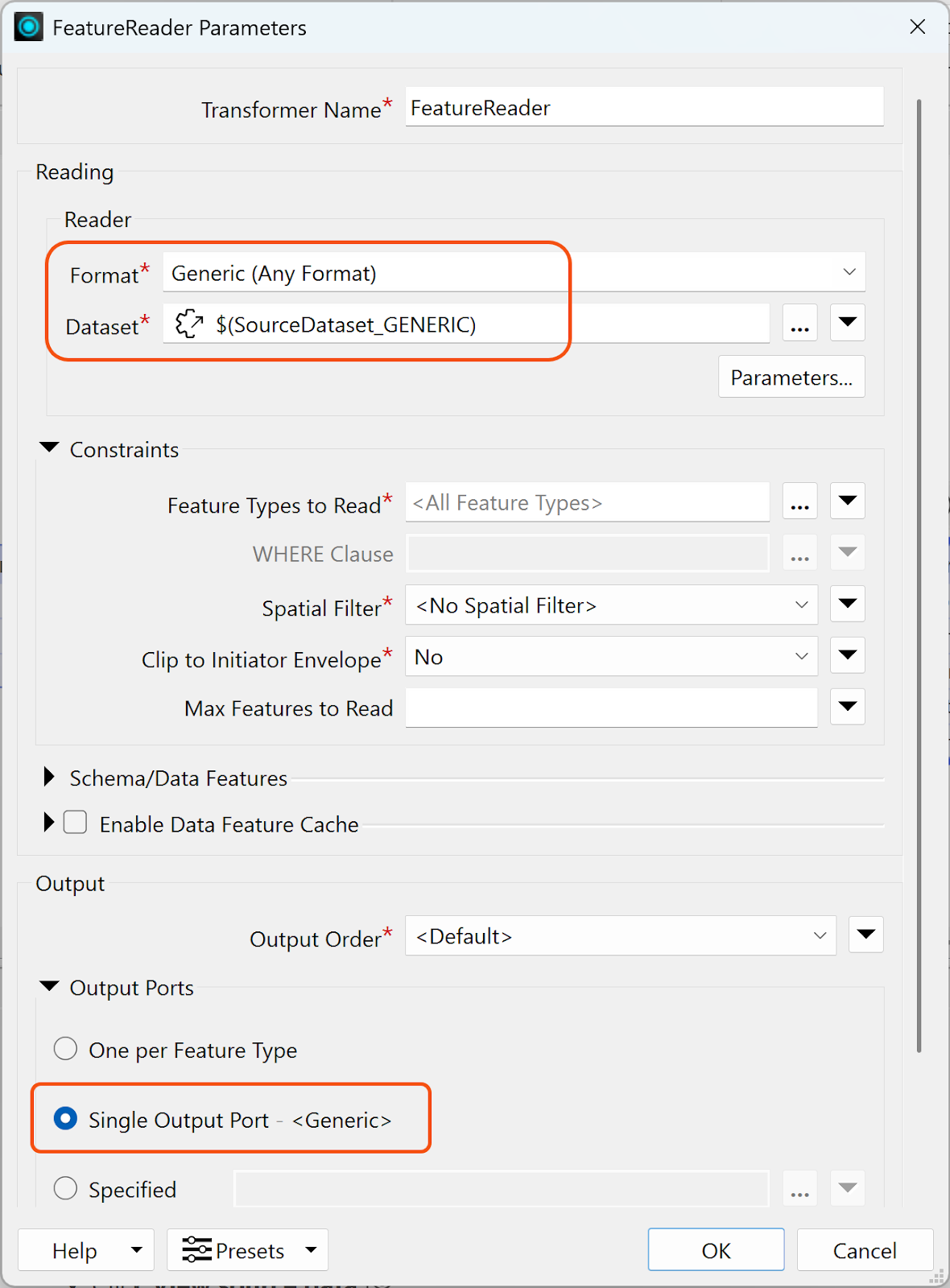

1. Add a Generic FeatureReader
Open FME Workbench and continue with your workspace from Part 1 of this series.
Add a FeatureReader to the workspace and set the parameters as follows:
  • Format: Generic (Any Format)
  • Dataset: click the drop-down arrow > User Parameter > select SourceDataset_GENERIC
    • While adding a second generic reader may seem redundant, a separate reader instance is required to enforce the correct order of operations. It ensures the mapping file is fully generated before the workflow attempts to read and map the records.
  • Output Ports > Single Output Port - <Generic>
Click OK to accept the new parameters.

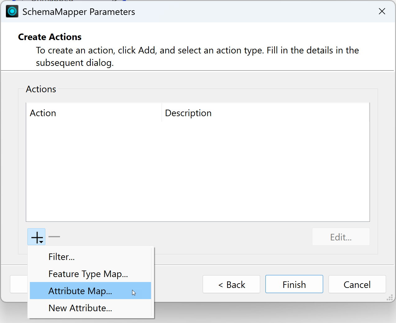

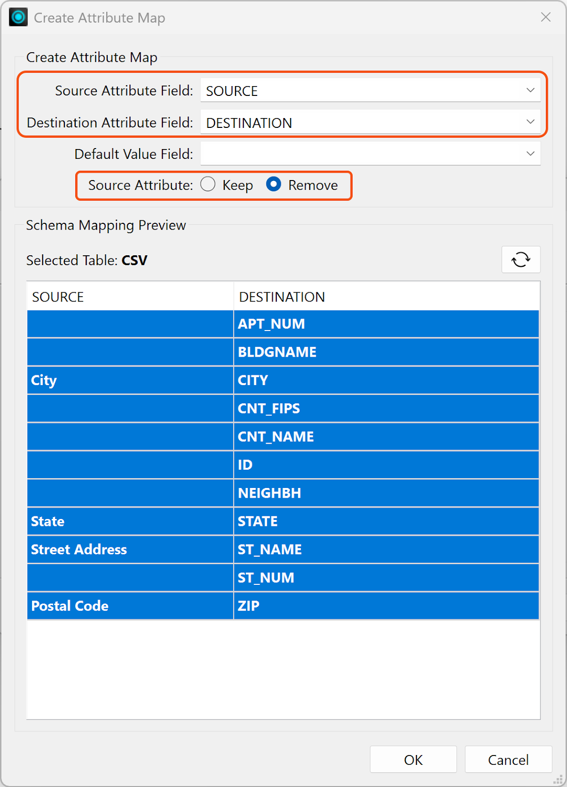

Click Next. In the next dialog, select the plus button > Attribute Map
  • Source Attribute Field: SOURCE
  • Destination Attribute Field: DESTINATION
  • Source Attribute: Remove
Click OK. Then click Finish to finalize the parameters.

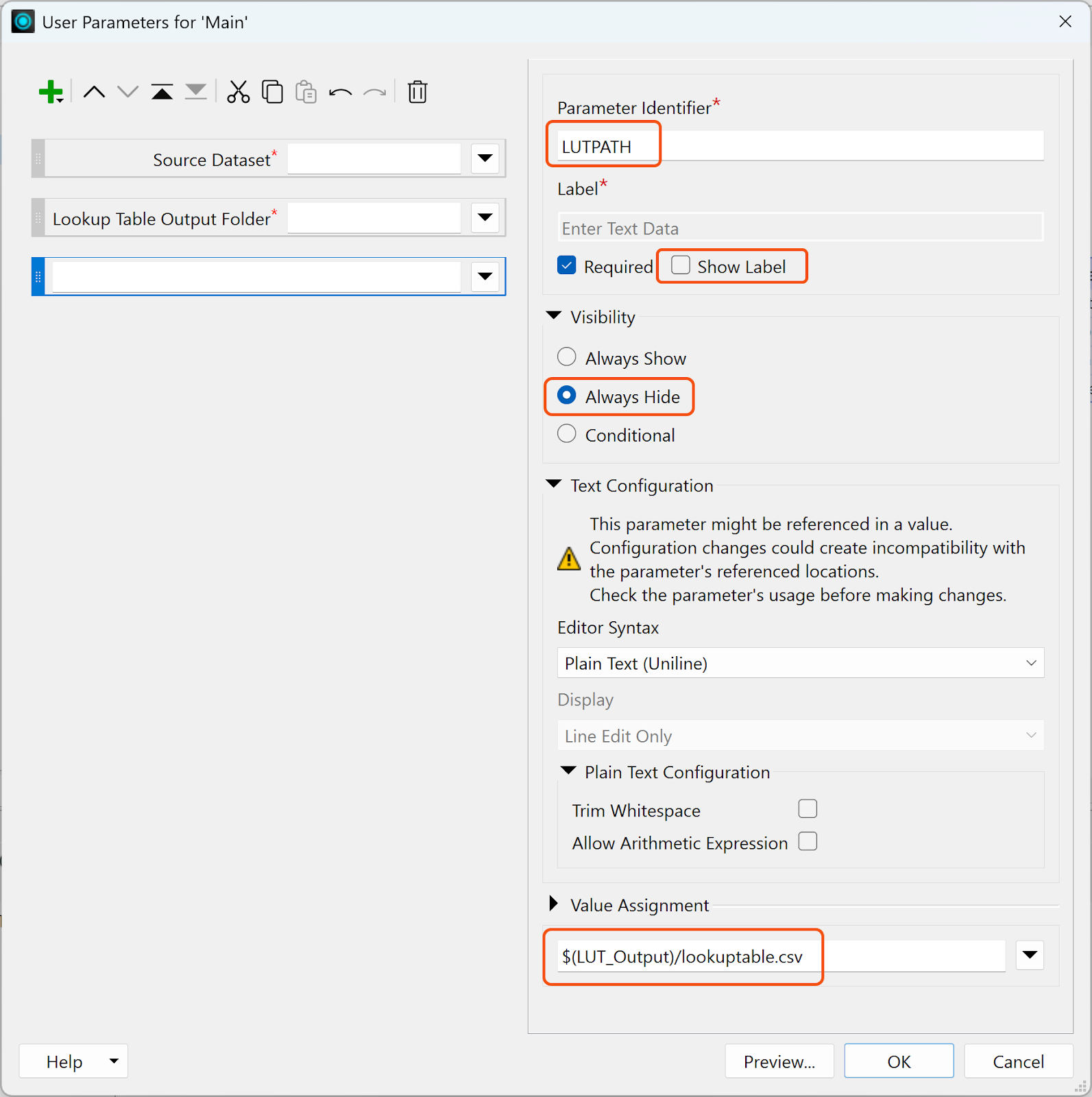

3. Configure the Lookup Table Path
Next, we need to create a user parameter to pass the location of the lookup table created by AI and written out by the FeatureWriter to the SchemaMapper.
Open the User Parameter Manager. Create a new Text parameter. Set the parameters as follows:
  • Parameter Identifier: LUTPATH
  • Disable “Show Label”
  • Visibility: Always Hide
  • Default Value: $(LUT_Output)/lookuptable.csv
Click OK to close the User Parameter Manager.

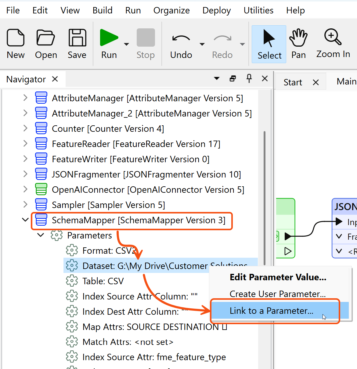

In the navigator window, expand the Transformers section, expand the SchemaMapper, and then expand the Parameters.

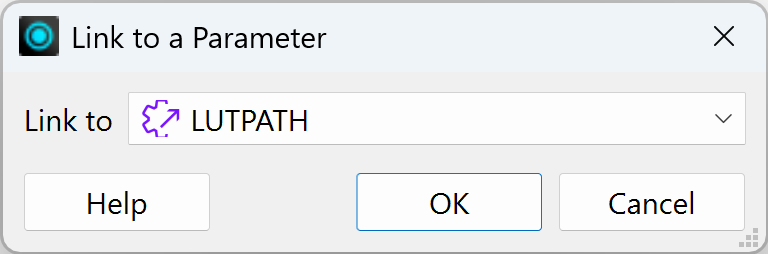

Right-click on the Dataset parameter and then select Link to a Parameter…
In the Link to a Parameter dialog that appears, select the LUTPATH parameter you just created. Click OK.

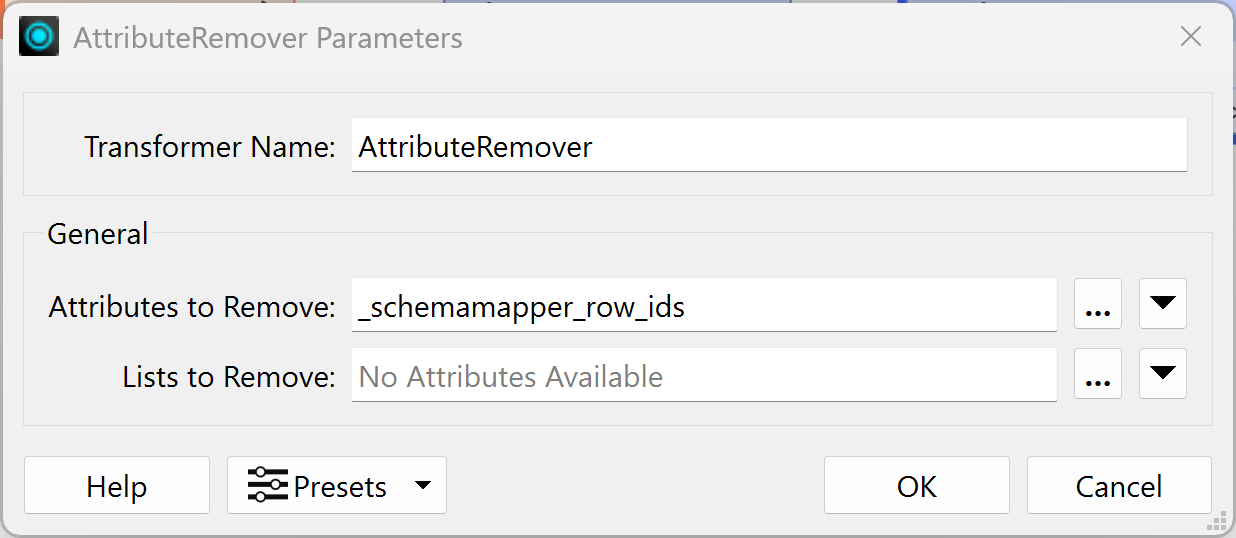

4. Add an AttributeRemover
We need to remove an attribute created by the SchemaMapper. Add an AttributeRemover to the workspace and connect it to the SchemaMapper “Mapped” output port.
Open the parameters and set them as follows:
  • Attributes to Remove: _schemamapper_row_ids
Click OK to accept the parameters.

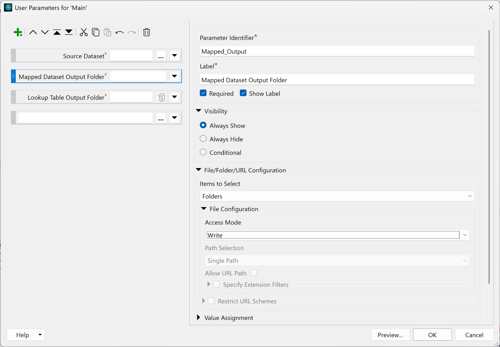

Before adding the FeatureWriter, we need to create a User Parameter that allows the user to specify a folder for outputting the mapped dataset.
In the Navigator window, right-click on User Parameters and select Manage User Parameters. Add a new File/Folder/URL parameter. Set the parameters as follows:
  • Parameter Identifier: Mapped_Output
  • Label: Mapped Dataset Output Folder
  • Visibility: Always Show
  • Items to Select: Folders
  • Access Mode: Write

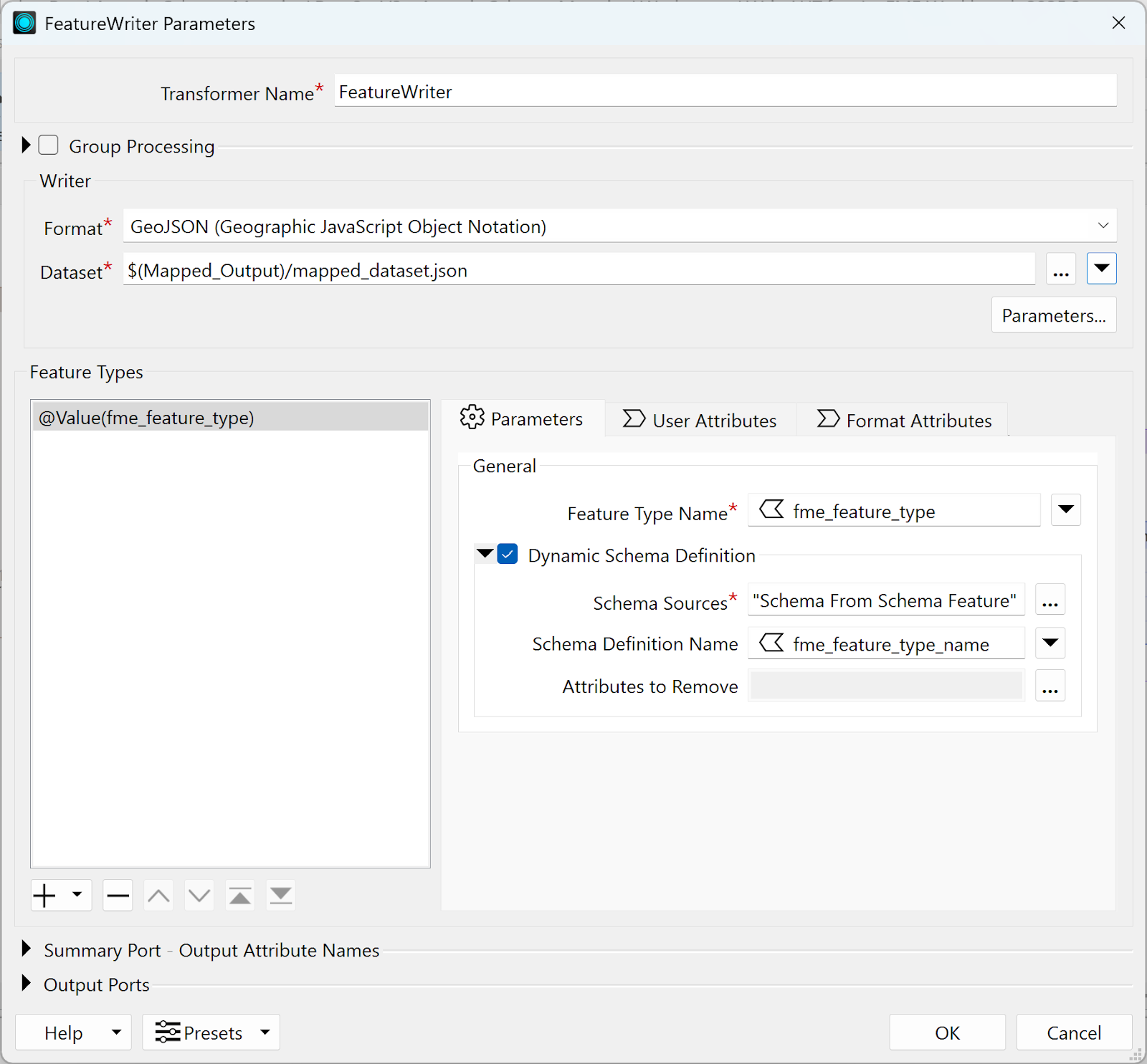

Lastly, we will add a writer to format the text as we want it to be written. In this case, we will write to a GeoJSON file.

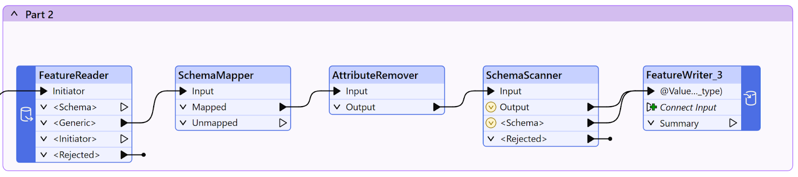

Add a FeatureWriter transformer to the workspace. Connect both the SchemaScanner Output and <Schema> output ports to the FeatureWriter. Open the FeatureWriter parameters and set them as follows:
  • Format: GeoJSON (Geographic JavaScript Object Notation)
  • Dataset: $(Mapped_Output)/mapped_dataset.json
Next, enable Dynamic Schema Definition and set the parameters below as follows:
  • Schema Sources: “Schema From Schema Feature”
  • Schema Definition Name: fme_feature_type_name
Go to the User Attributes tab and remove any attributes that are present. This will prevent additional attributes from being written to the output.
Click OK to accept the new parameters. Your workspace should now resemble this.

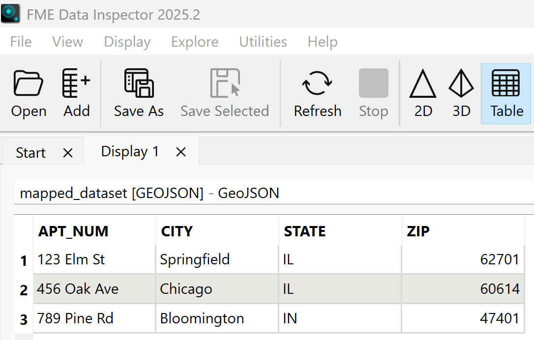

After finishing, navigate to the output folder and inspect the resulting GeoJSON file. You can open the file in FME Data Inspector to verify that the schema has been mapped correctly.
