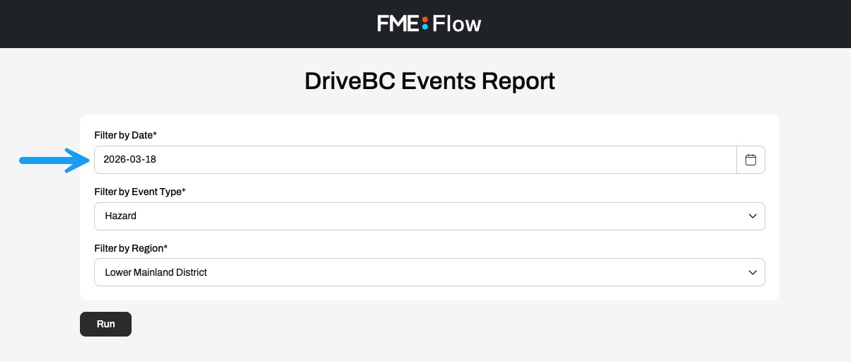

Static Parameter Configuration

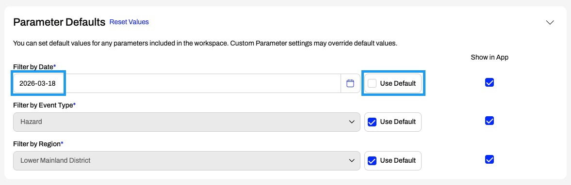

If you would like parameter defaults to be constant for all users at all times, Parameter Defaults can be used.
To demonstrate this, open the Workspace App settings described above and expand the Parameter Defaults section. Uncheck Use Default for the "Filter by Date" parameter, and change it to a custom date.
Save and refresh the live workspace app page. The default date will be updated.

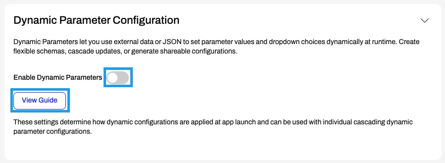

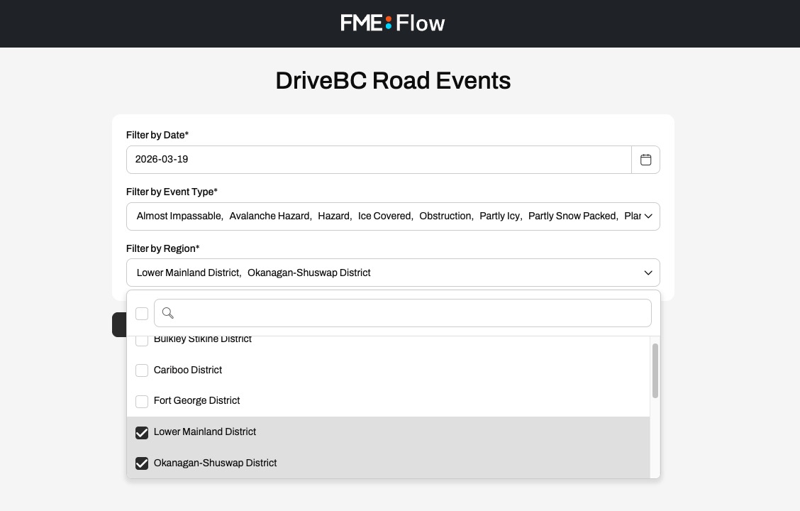

1. Enable Dynamic Parameters
In the Workspace App's settings under Parameter Defaults, enable Dynamic Parameters. For more technical requirements for dynamic parameters and testing tools, click View Guide.
Setting Parameters with Query Strings
The first way to dynamically set Workspace App parameters is with query strings. This allows authors to launch Workspace Apps with different default values based on the URL. This can be generated manually or programmatically by an external application.
Step-by-step Instructions

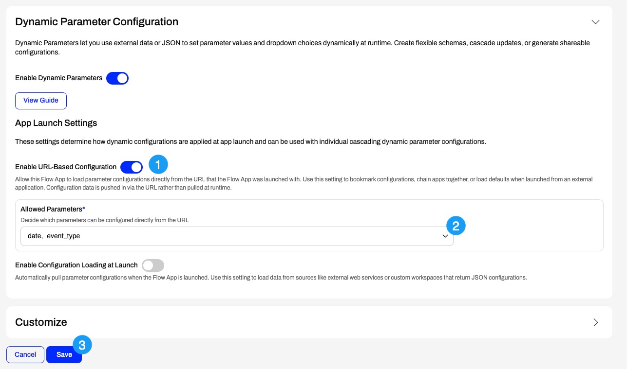

1. Enable URL-Based Configuration and set Allowed Parameters
Toggle on Enable URL-Based Configuration, and under Allowed Parameters select the "date" and "event_type" parameters. Click Save and return to the Workspace App's settings.

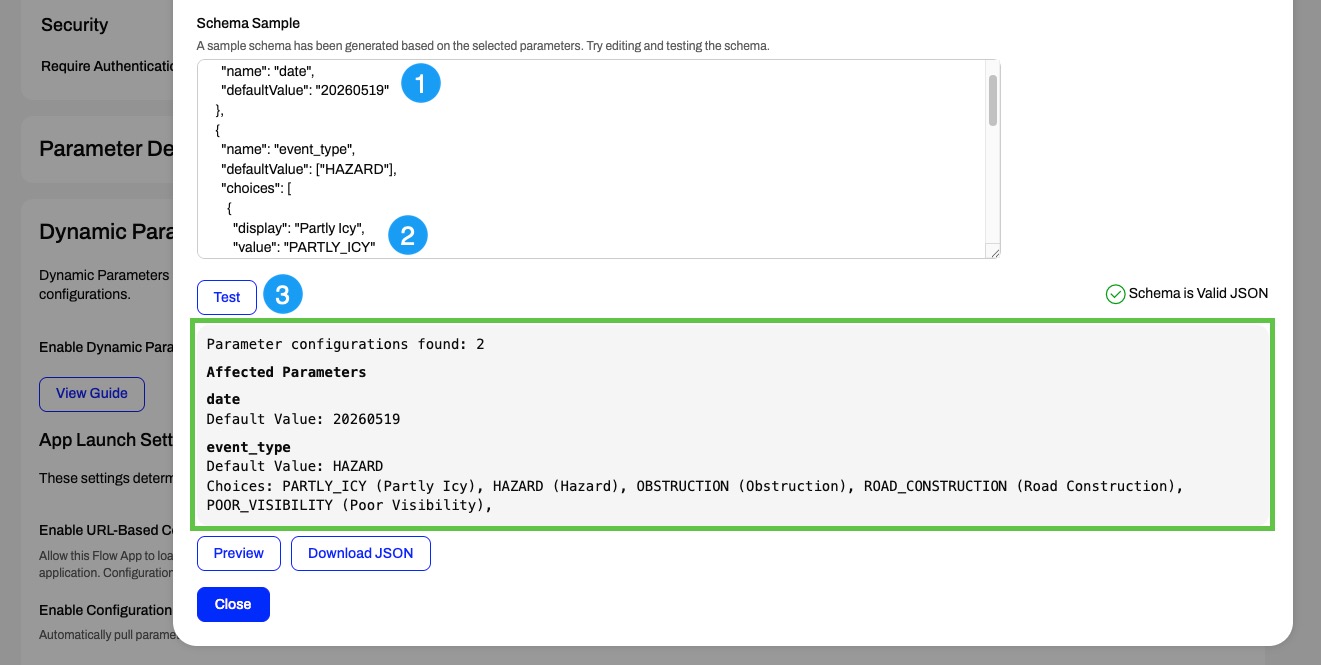

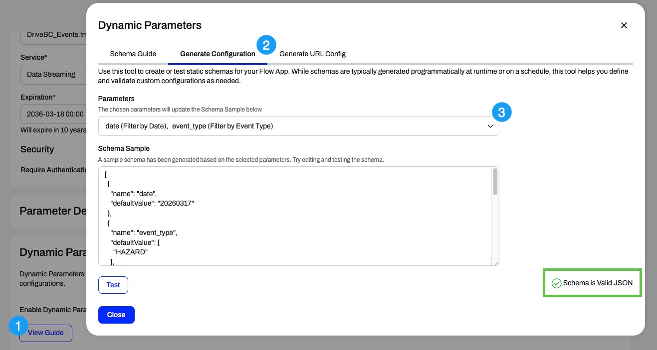

2. Generate a Schema Sample
Click View Guide and navigate to the Generate Configuration tab.
For this example, select the "date" and "event_type" parameters. A schema containing the current parameter values will appear and be marked as valid JSON. This tool lets you generate, test, and validate JSON parameter schemas.
3. Edit the schema
Change the default value of "date" from "20260317" to a different date (e.g., "20260518").
  "name": "date",
  "defaultValue": "20260518"
Add a new choice to "event_type" by adding a new object to the choices array. Set its display attribute to "Partly Icy" and its value attribute to "PARTLY_ICY".
    "name": "event_type",
    "defaultValue": ["HAZARD"],
    "choices": [
        "display": "Partly Icy",
        "value" : "PARTLY_ICY"
        "display": "HAZARD",
Click Test to make sure your changes are parsed correctly. Also, click Preview to see how the parameters will appear to the end user.

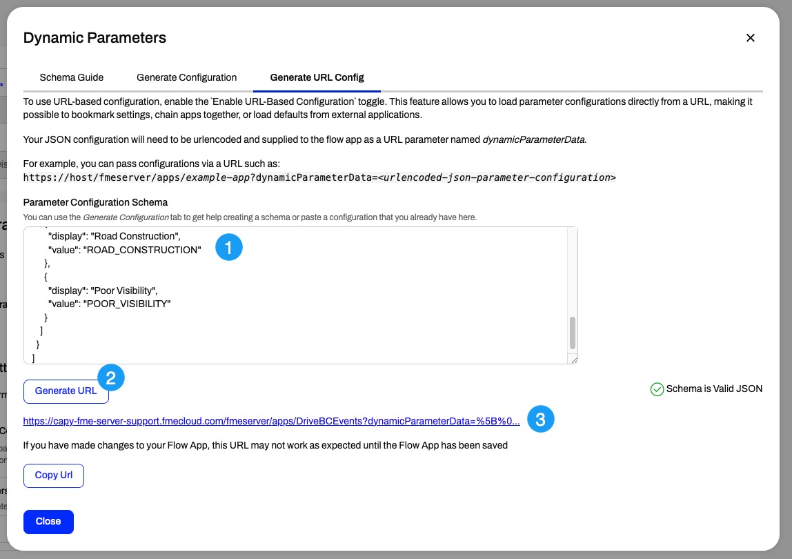

4. Generate the URL
To configure the URL-encoded query string, copy the JSON from the Generate Configuration tab, open the Generate URL Config tab, paste the JSON into the text box, and click Generate URL.
Open the URL to see the JSON schema reflected in the Workspace App's default parameters. If they do not appear, save the Workspace App settings and try again.
This URL can now be edited directly or, using the steps above, generate another set of default parameters. No further changes to the Workspace App are required.

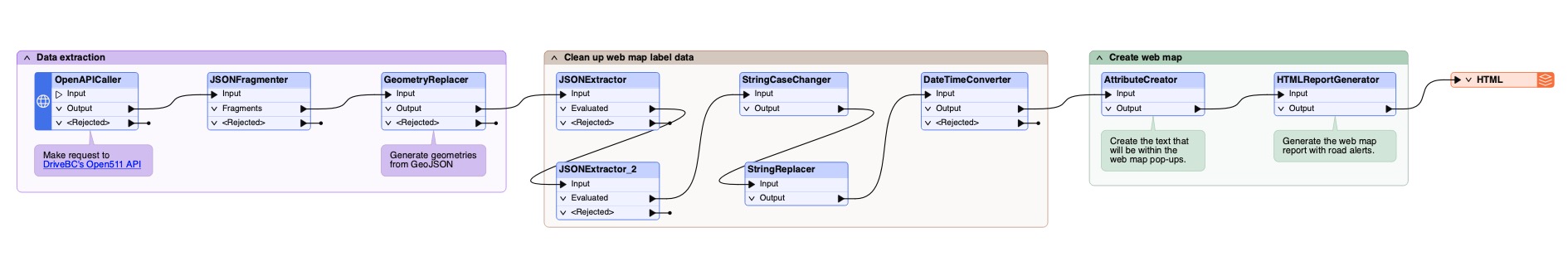

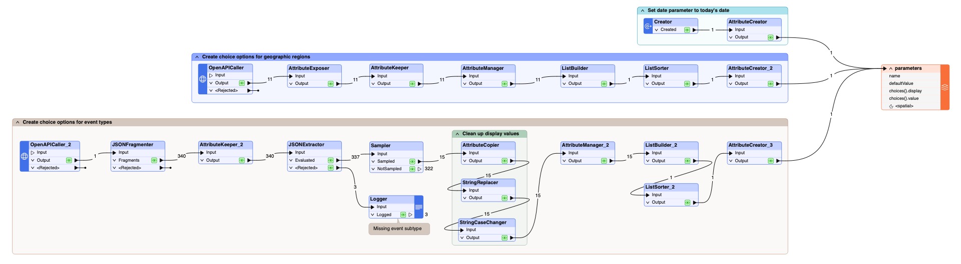

1. Download and Inspect the Helper Workspace
From the article attachments, download DriveBC_DynamicParameters.fmw and open it in FME Workbench. Test the workspace by running it. The workspace creates the JSON schema by gathering the following information:
a. Sets the default value of the "Filter by Date" parameter to today's date.
b. Gets all possible regions in B.C. to populate the "Filter by Region" parameter.
c. Gets the types of currently active alerts available for selection in the "Filter by Event" parameter.
There are a few important considerations when designing a workspace for dynamic parameters:
  • Minimize the workspace runtime by simplifying the workspace. Avoid making the end user wait too long for the workspace to run and return the parameter configuration.
  • To get a list of unique values from attributes, use transformers like the Sampler, DuplicateFilter, or Aggregator.
  • For choice parameters, the ListBuilder is necessary to create a choice array in the final JSON output.
  • Before the JSON writer, the "name" attribute must be created to designate the parameter being modified and optional default value(s).
  • When setting up the JSON writer, in the Parameters, disable "Write Feature Type Key" and "Write Geometry" to create the correct schema. The name of the JSON writer feature type and output file name do not matter.

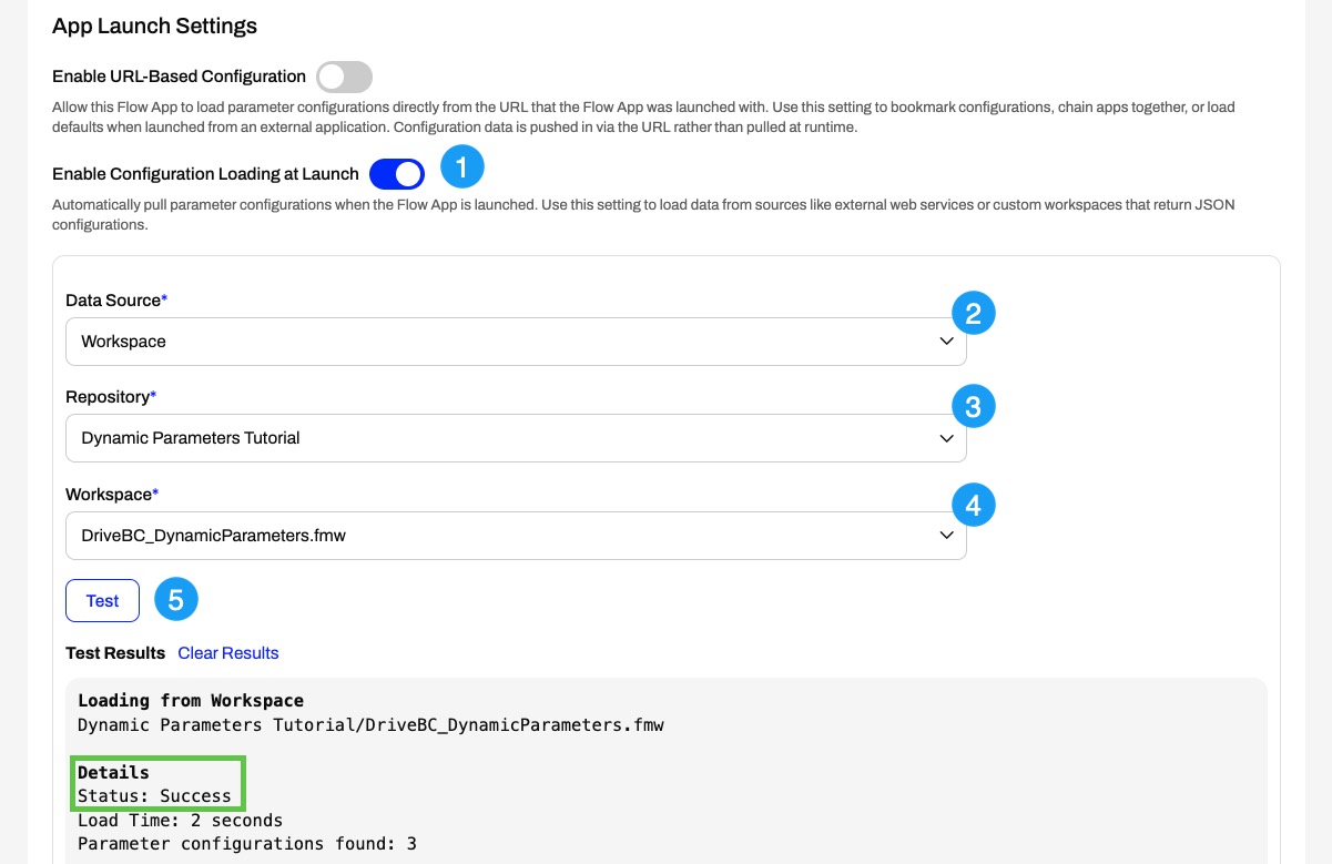

3. Configure the Workspace App and Test
Back in the Workspace App settings, edit the Dynamic Parameter Configuration as follows:
  • Enable Dynamic Parameters: Yes
  • Enable Configuration Loading at Launch: Yes
  • Data Source: Workspace
  • Repository: Dynamic Parameters Tutorial
  • Workspace: DriveBC_DynamicParameters.fmw
Click Test to make sure the workspace was parsed correctly.

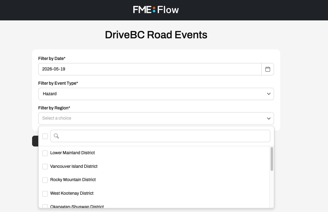

4. Save and Open the Workspace App
Save these settings and open the Workspace App. The "Filter by Date" parameter will now always display the current date, and the "Filter by Event" and "Filter by Region" parameters will reference up-to-date data from DriveBC's Open511 API whenever the Workspace App is launched.

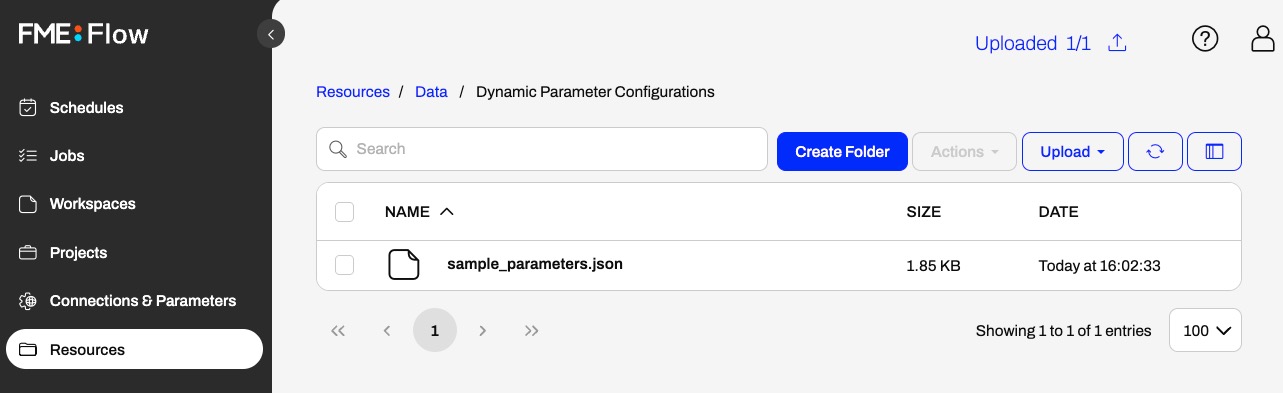

1. Create a New Resource Folder
Go to FME Flow's Resources > Data. Create a new folder named "Dynamic Parameter Configurations".
2. Upload the JSON Configuration
From the article attachments, download the sample_parameters.json file and upload it to the newly created Resource folder.

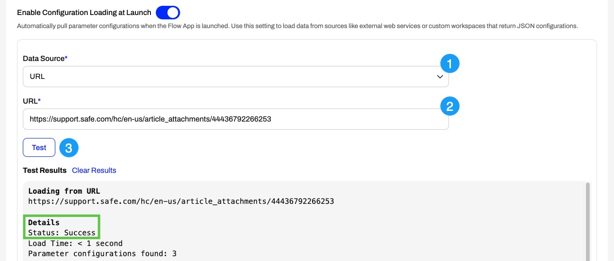

Getting Parameters from a URL (2025.2+)
The last method for dynamically setting Workspace App parameters is to make a web request for the JSON configuration. This involves making a request to an external URL, API, or system that hosts or returns a valid JSON schema.
1. Configure the Workspace App and Test
In the same Workspace App, edit the Dynamic Parameter Configuration:
  • Data Source: URL
  • JSON URL: https://support.safe.com/hc/en-us/article_attachments/44436792266253
2. Save and Open the Workspace App
Save these settings and open the Workspace App. All three fields should have the default values and choice options as seen in the test results. Compare these to the parameters in the original DriveBC_Events.fmw workspace and see how the values have been replaced.
