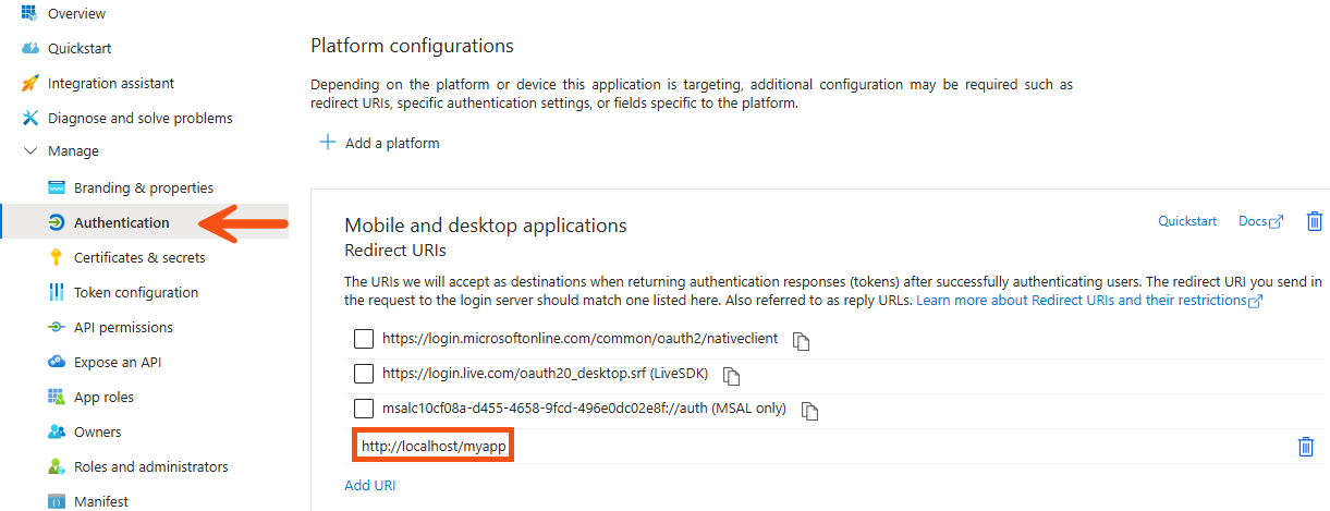

The Redirect URI is set on the Authentication page, where the platform is also configured:

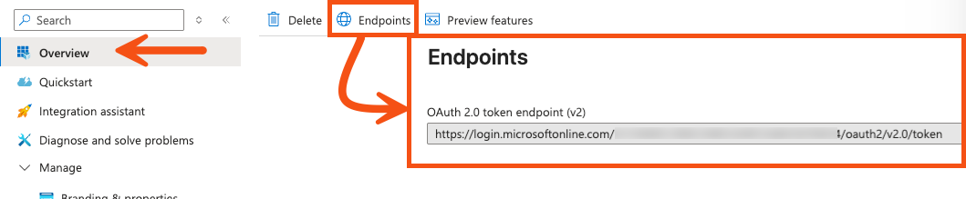

From the Overview tab, click Endpoints to get the Token Endpoint URL. Use the endpoint named "OAuth 2.0 token endpoint (v2)".

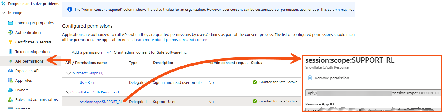

The value for Scope is found under Manage> API permission page. Click on the application permission granted to your app registration (not the delegated permission, if you have multiple) and copy the value.
Since this is an Azure client credentials grant type, there is no user consent step, so the default scope should be used in the FME. This tells the Microsoft identity platform to issue a token with the direct admin-granted application permissions you have configured in your app registration. See Microsoft's documentation for more information.
Replace the scope with .default.
For example, if this is the scope in Azure:
api://80886434-57ab-1234-a705-54321f052c00/session:role:CUSTSOLS_RL
Replace session:role:CUSTSOLS_RL with .default.
api://80886434-57ab-1234-a705-54321f052c00/.default

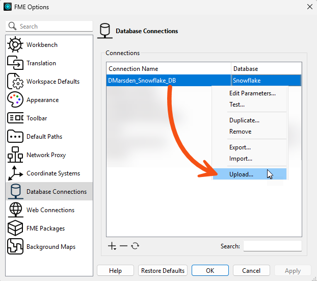

1. Upload and View the Database Connection

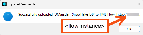

Right-click on your newly created Snowflake database connection and select Upload:
This will prompt you to upload to your Flow instance:

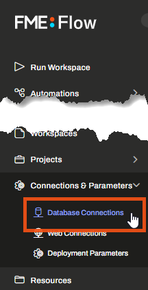

In your Flow instance web browser UI, navigate to
  • Connections & Parameters > Database Connections
Double-click on your database connection to view and optionally edit the Snowflake connection details, including the authentication type and OAuth connection.
