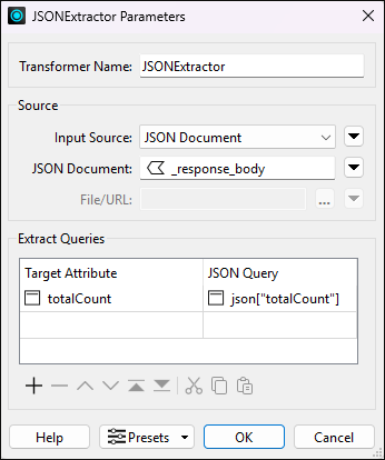

3. Extract the Total
Add a JSONExtractor to the canvas and connect it to the output port of the HTTPCaller. Open the parameters and set the following:
  • Input Source: JSON Document
  • JSON Document: _response_body
  • Extract Queries:
    • Target Attribute: totalCount
    • JSON Query: json["totalCount"]

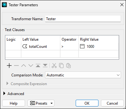

4. Test the totalCount
The response has a maximum limit of 1000; therefore, if there are fewer than 1000 responses, we only need one call and no pagination, and can parse the JSON right away. If there are more than 1000 responses, then we need pagination. To determine if we need pagination, we can use a Tester transformer. Add a Tester to the canvas and connect it to the JSONExtractor.
In the parameters, enter this logic:
  • Left Value: totalCount
  • Operator: >
  • Right Value: 1000
Click OK to accept the parameters

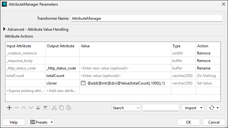

5. Pagination through Cloning
Add an AttributeManager to the canvas and connect it to the “Passed” port of the Tester. Manage the attributes by removing any that are not required. We will keep the totalCount attribute and add an additional one named cloner.
Set the following parameters in the AttributeManager
  • Remove Attribute:
    • Input Attribuite:_creation_instance
      • Action: Remove
  • Remove Attribute:
    • Input Attribute: response_body
      • Action: Remove
  • Remove Attribute:
    • Input Attribuite:_http_status_code
      • Action: Remove
  • Add Attribute:
    • Output Attribute: cloner
      • Value: @add(@int(@div(@Value(totalCount),1000)),1)
The value of the cloner attribute ensures that the value has no decimals (int) after being divided, and includes the original plus the pagination (add, 1).
Click OK to accept the parameters.

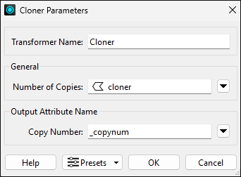

6. Add a Cloner to the Canvas
The number of copies will equal the attribute cloner. To achieve this, we will use a Cloner.

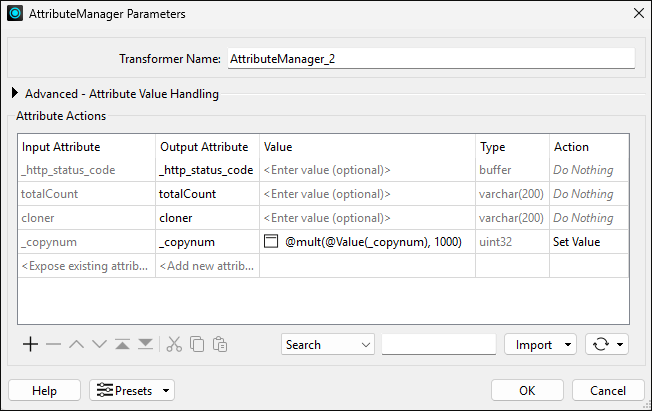

Add another AttributeManager to the canvas and connect it to the Cloner output port. We need to set the value of the _copynum attribute to multiply the value by a thousand. This will be the offset for the HTTPCaller.
  • Set Value:
    • Output Attribute: _copynum
      • Value: @mult(@Value(_copynum), 1000)

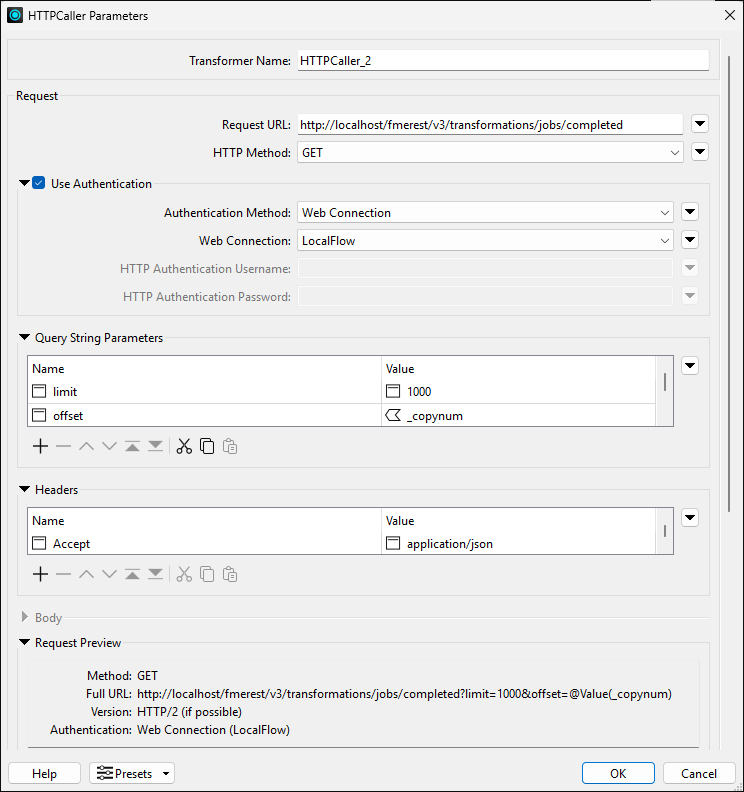

7. Final Call
Duplicate the HTTPCaller, and connect it to the last AttributeManager. Change the query string parameter offset to the newly created _copynum attribute.

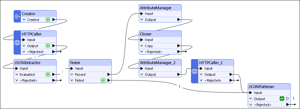

9. Run the Entire Workspace
Run your workspace, and it should look like the image below.
