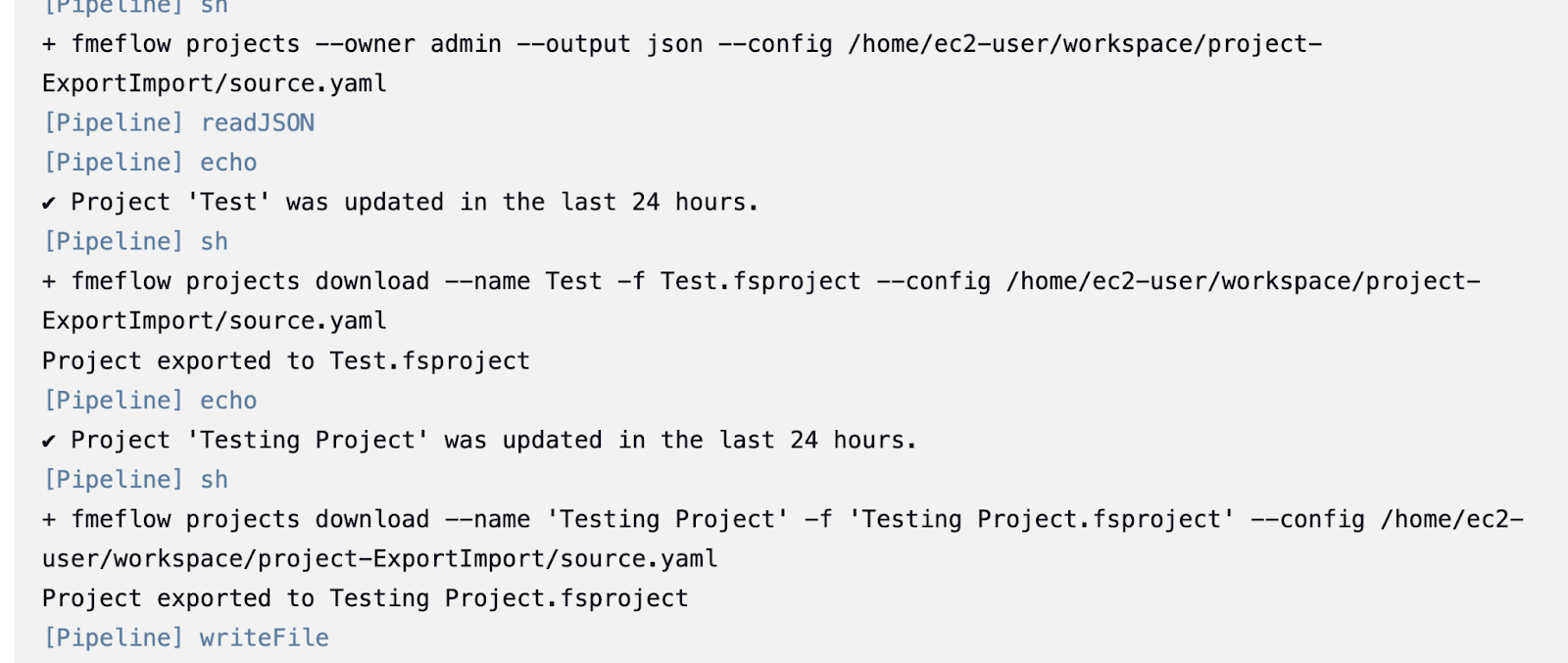

Find and Download Updated Projects
fmeflow projects --owner admin --output json --config ${env.SOURCE_CONFIG}
This retrieves all projects owned by the user admin in JSON format.
fmeflow projects download --name '${project.name}' -f '${project.name}.fsproject'
It then filters for projects updated in the last 24 hours, downloads each one as an .fsproject file and then writes project names to updatedProjects.txt.
