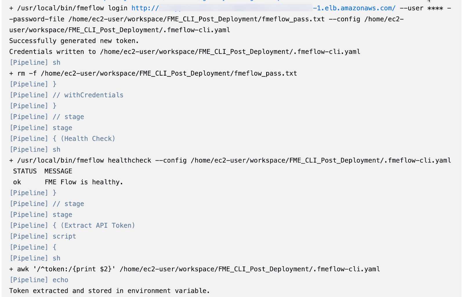

Log in to FME Flow
fmeflow login <url> --user <user> --password-file ... --config ...
This step logs in using the CLI and creates a YAML file with a new API token for subsequent commands. This avoids using plaintext passwords in every command and stores a session token for reuse.
Health Check
fmeflow healthcheck --config ...
This step confirms that the target FME Flow is up and API endpoints are functional. It is useful for early error detection before making changes.
Extract API Token
awk '/^token:/{print \$2}' .fmeflow-cli.yaml
This grabs the generated API token from the YAML file and saves it to an environment variable for raw curl commands used later. CLI handles most operations, but some might require API calls instead.

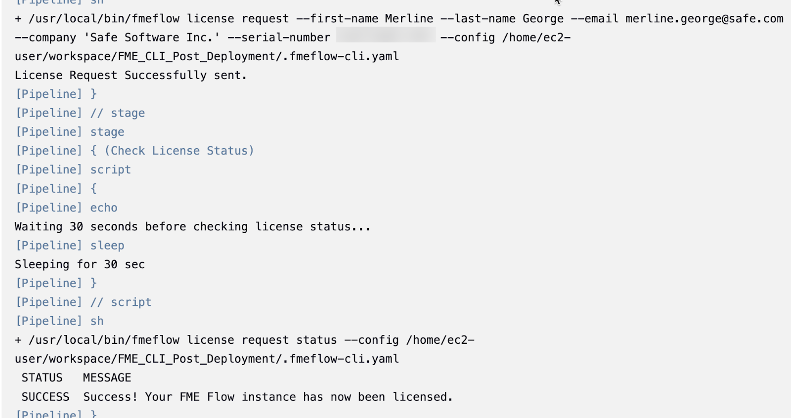

Request License
fmeflow license request --first-name ... --serial-number ...
This triggers a license request with the provided user and organization information.
Check License Status
It waits 30 seconds and checks the status of the license request. The FME Flow backend needs time to complete licensing. This polling pattern helps confirm whether the license was successfully activated.

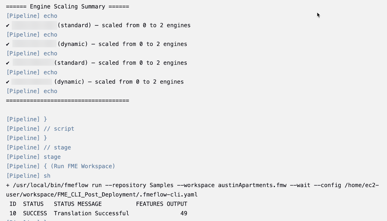

Scale & Summarize Engine Hosts
This step queries available engine hosts, scales each one to the desired count for both standard and dynamic engine types and summarizes scaling in the console log.

Run FME Workspace
fmeflow run --repository Samples --workspace austinApartments.fmw --wait ...
This step executes a known sample FME workspace as a test to validate that the system is functioning properly post-license and post-engine-scaling.
