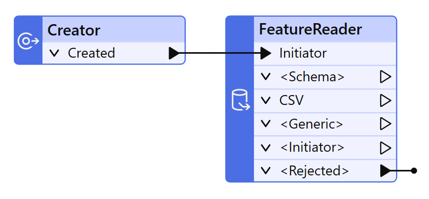

2. Add an AttributeCreator
Add an AttributeCreator to the workspace and connect it to the FeatureReader’s CSV output port. Open the AttributeCreator parameters and set them as follows:
  • Output Attribute: “record_data”.
  • Value: “@Value(pipe_id),@Value(material),@Value(diameter_mm),@Value(condition),@Value(install_date),@Value(status),@Value(start_manhole),@Value(end_manhole)”
Your workspace should now look like the following screenshot.

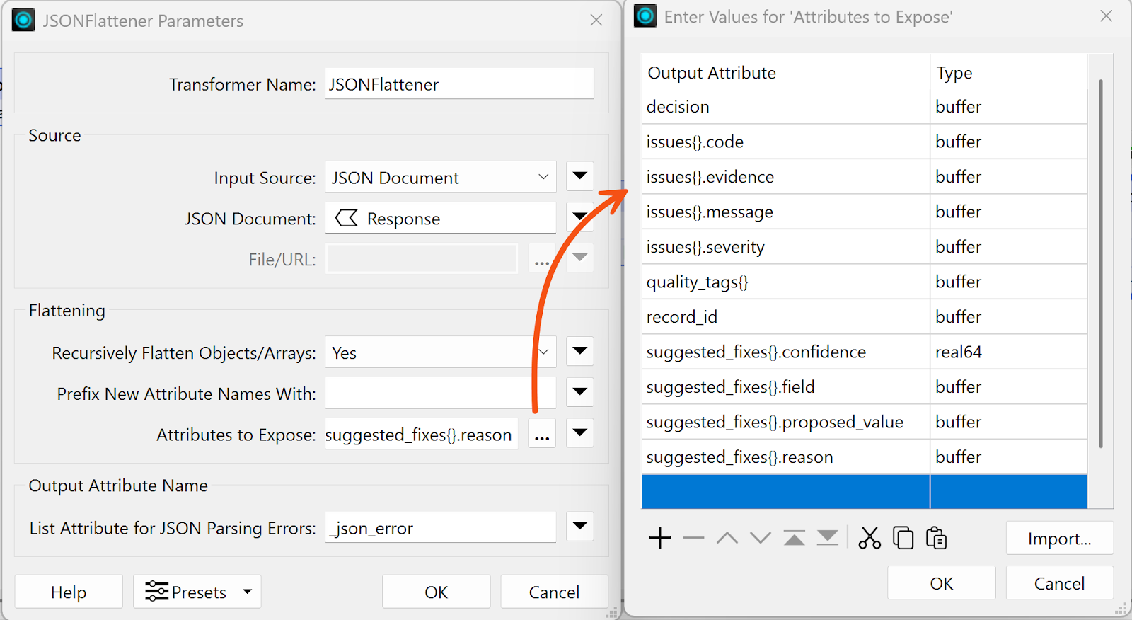

2. Extract JSON & Validation Results
Add a JSONFlattener to your workspace. Connect it to the OpenAIConnector Output port. Open the JSONFlattener parameters and set them as follows:
  • JSON Document: click the drop-down arrow and select the Response attribute
  • Attributes to Expose:
    • decision
    • issues{}.code
    • issues{}.evidence
    • issues{}.message
    • issues{}.severity
    • quality_tags{}
    • record_id
    • suggested_fixes{}.confidence
    • suggested_fixes{}.field
    • suggested_fixes{}.proposed_value
    • suggested_fixes{}.reason
Click OK to accept the parameters.

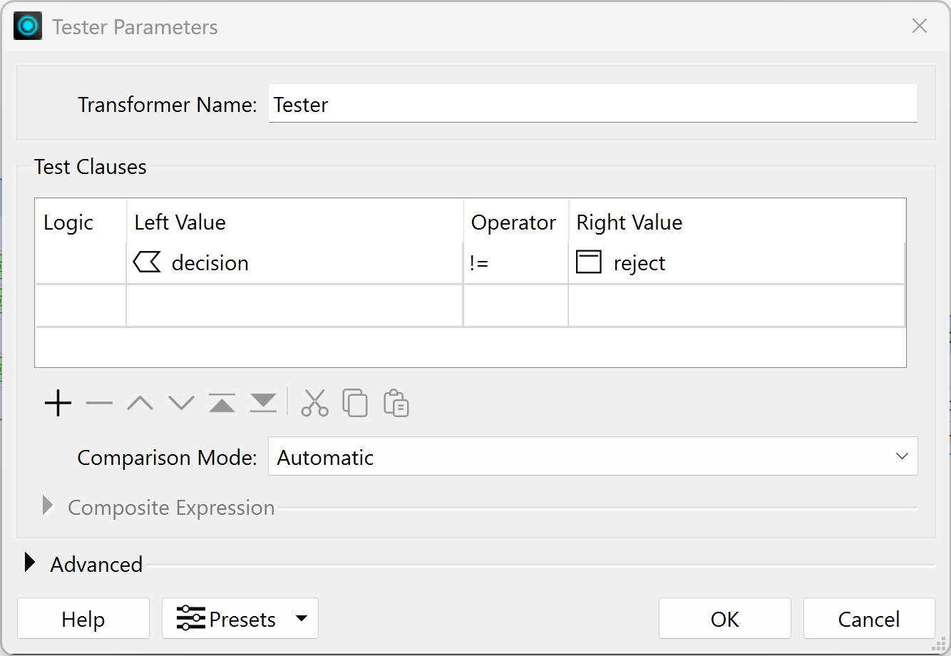

3. Add a Tester
Add a Tester to the workspace and connect it to the JSONFlattener Output port. Open the Tester parameters and set them as follows:
  • Left Value: decision
  • Operator: !=
  • Right Value: reject

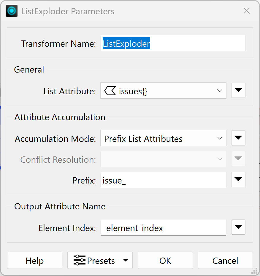

4. Add a ListExploder
To expose the remaining attributes from the JSON, we will use a ListExploder. Add a ListExploder and connect it to the Tester “Failed” output port. Open the ListExploder parameters and set them as follows:
  • List Attribute: issues{}
  • Accumulation Mode: Prefix List Attributes
  • Prefix: issue_
Click OK to accept the transformer parameters.

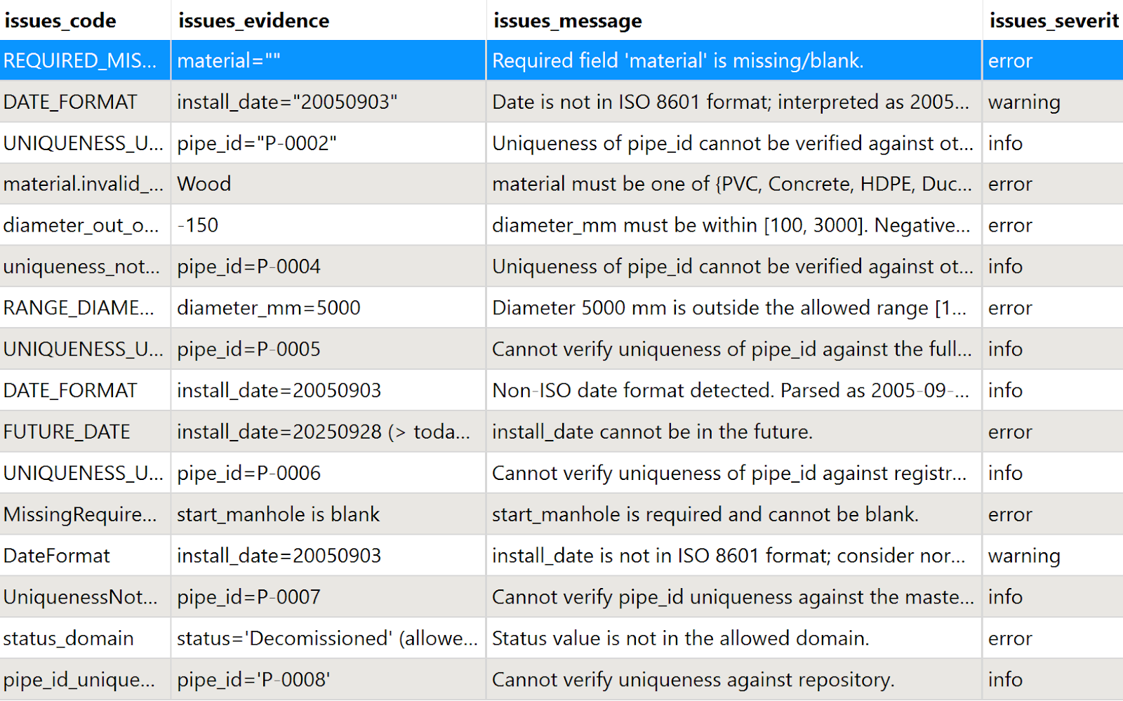

5. Run the Workspace and Inspect the Data
With data caching enabled, run the workspace and inspect the output from the ListExploder in the Data Preview window. You should see the results from the AI reasoning model, such as the evidence, message, and severity columns.
Each provides detailed information on why the row failed validation.

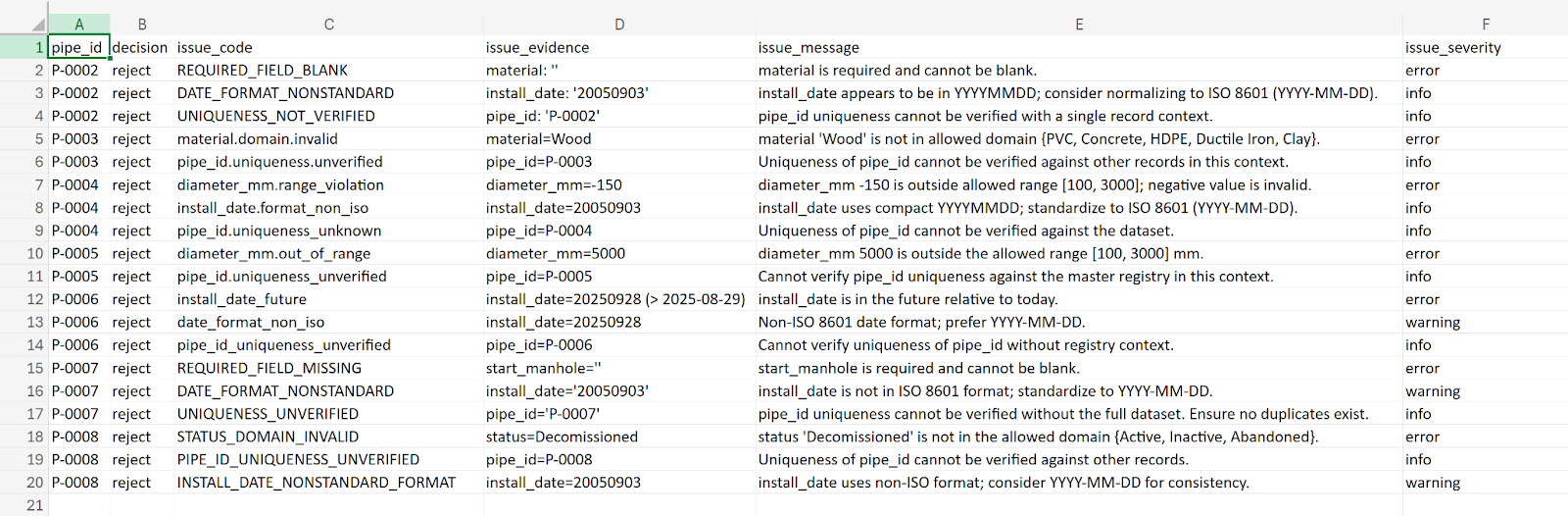

2. Add an Excel Writer
Add a Writer to the workspace and set the parameters as follows:
  • Format: Microsoft Excel
  • Dataset: specify an output dataset
    • Click on the ellipsis to select a location on your computer
Click OK to add the writer to the workspace. Connect it to your AttributeKeeper output port.
Run the workspace to output the Excel file and view the results in Microsoft Excel. To increase visibility, the report could be emailed or shared with stakeholders.
