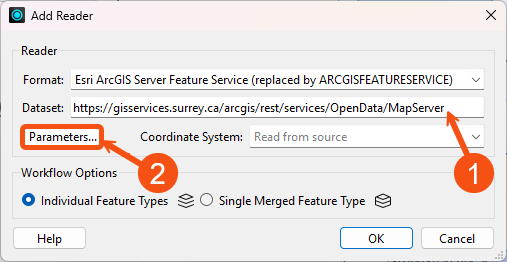

2. Add an Esri ArcGIS Server Feature Service Reader
The source data contains road center lines, the road name, and speed limit. In order to read it into the workspace, we must add an Esri ArcGIS Feature Service Reader:
  • Format: ArcGIS Server Feature Service
  • Dataset: https://gisservices.surrey.ca/arcgis/rest/services/OpenData/MapServer
  • Parameters:
    • Feature Service: https://gisservices.surrey.ca/arcgis/rest/services/OpenData/MapServer
    • Layers:
      • Select Layers: Road Centrelines (151)

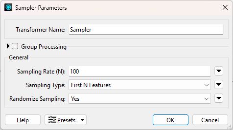

Optional Step: Add a Sampler Transformer
To improve the processing speed and reduce any API delays, we can use a Sampler transformer. The Sampler is also especially useful at the workspace testing stage, before we commit to processing 10,000+ features.

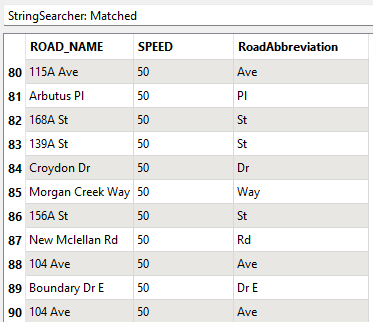

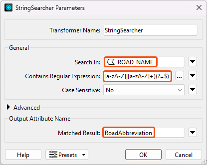

3. Find Street Name Abbreviations
Add a StringSearcher transformer and connect the Road Centralines (151) dataset to its input port. Set the following parameters to extract all street name abbreviations that appear in the road names into the RoadAbbreviation attribute:
  • Search In: ROAD_NAME
  • Contains Regular Expression: (?<=\b)([a-zA-Z]+\s+[a-zA-Z]|[a-zA-Z]+)(?=$)|([A-Za-z]+)(?=\)$)
  • Output Attribute Name: RoadAbbreviation
The Regular Expression (REGEX) is designed to extract only the relevant parts of the road name. In our case, we’re taking the last one or two words of the string.

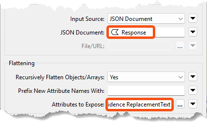

6. Flatten the OpenAI JSON Response into Attributes
The JSON response from the OpenAI API needs to be flattened to use as attributes in the workflow. Add a JSONFlattener transformer with the following parameters set:
  • JSON Document: Response
  • Attributes to Expose:
    • Confidence
    • ReplacementText

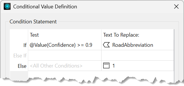

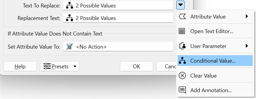

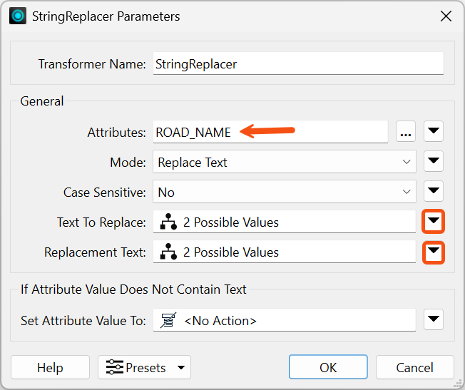

Add a StringReplacer transformer to replace the abbreviations with the full word. We can set a condition to only apply this replacement if the confidence given by the OpenAI API is above 90%. Set the following parameters:
  • Attributes: ROAD_NAME
  • Text To Replace:
    • Click the drop-down arrow and select Conditional Value
      • Test If:
        • Left Value: Confidence
        • Operator: >=
        • Right Value: 0.9
        • Text To Replace: RoadAbbreviation
      • Test Else:
        • Text to Replace: 1

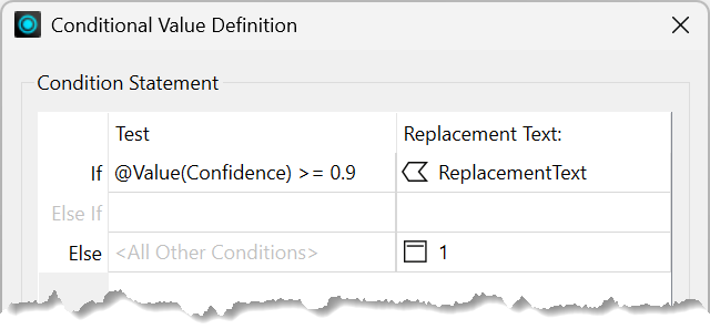

    • Replacement Text:
        • Test If:
          • Operator: >=
          • Right Value: 0.9
          • Text To Replace: ReplacementText
        • Test Else:

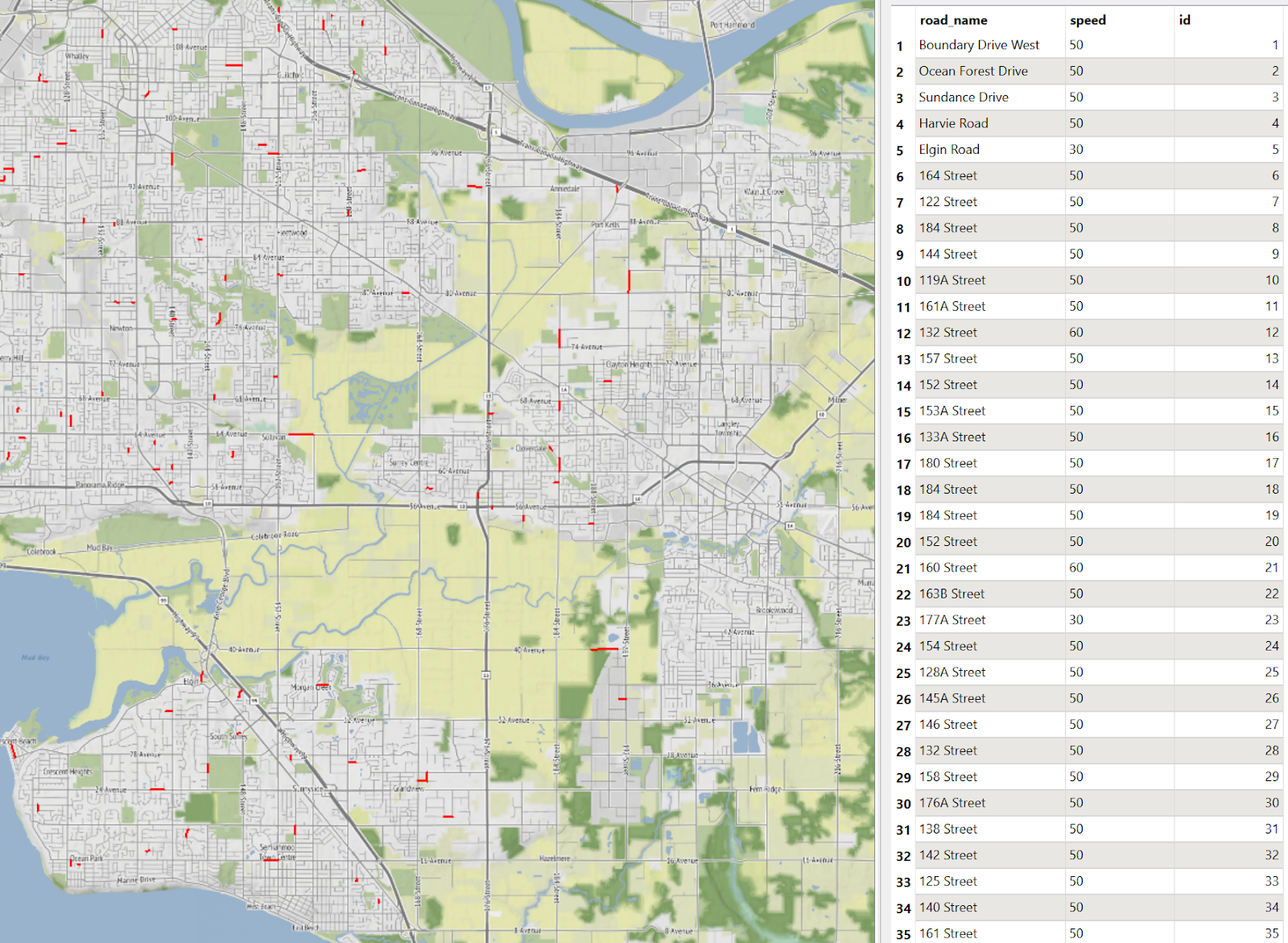

10. Add a GeoPackage Writer
After adding and connecting the GeoPackage writer, we can run the workspace. Open the GeoPackage output in the Data Inspector to preview the cleaned data. The screenshot below shows only a sample of the Road Centrelines from the original dataset. The road names are now fully unabbreviated with the help of AI!
You have successfully used the OpenAI API within FME Form to clean your data!
