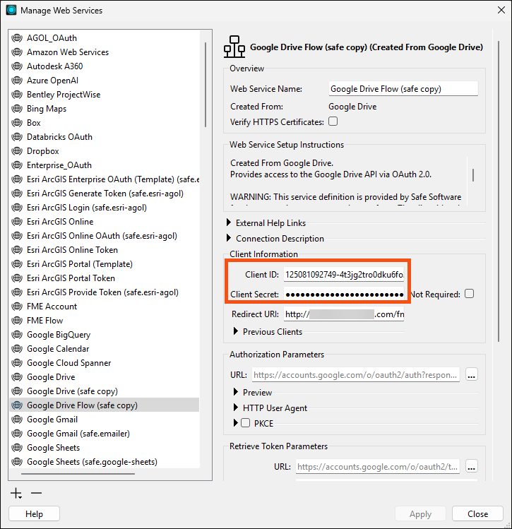

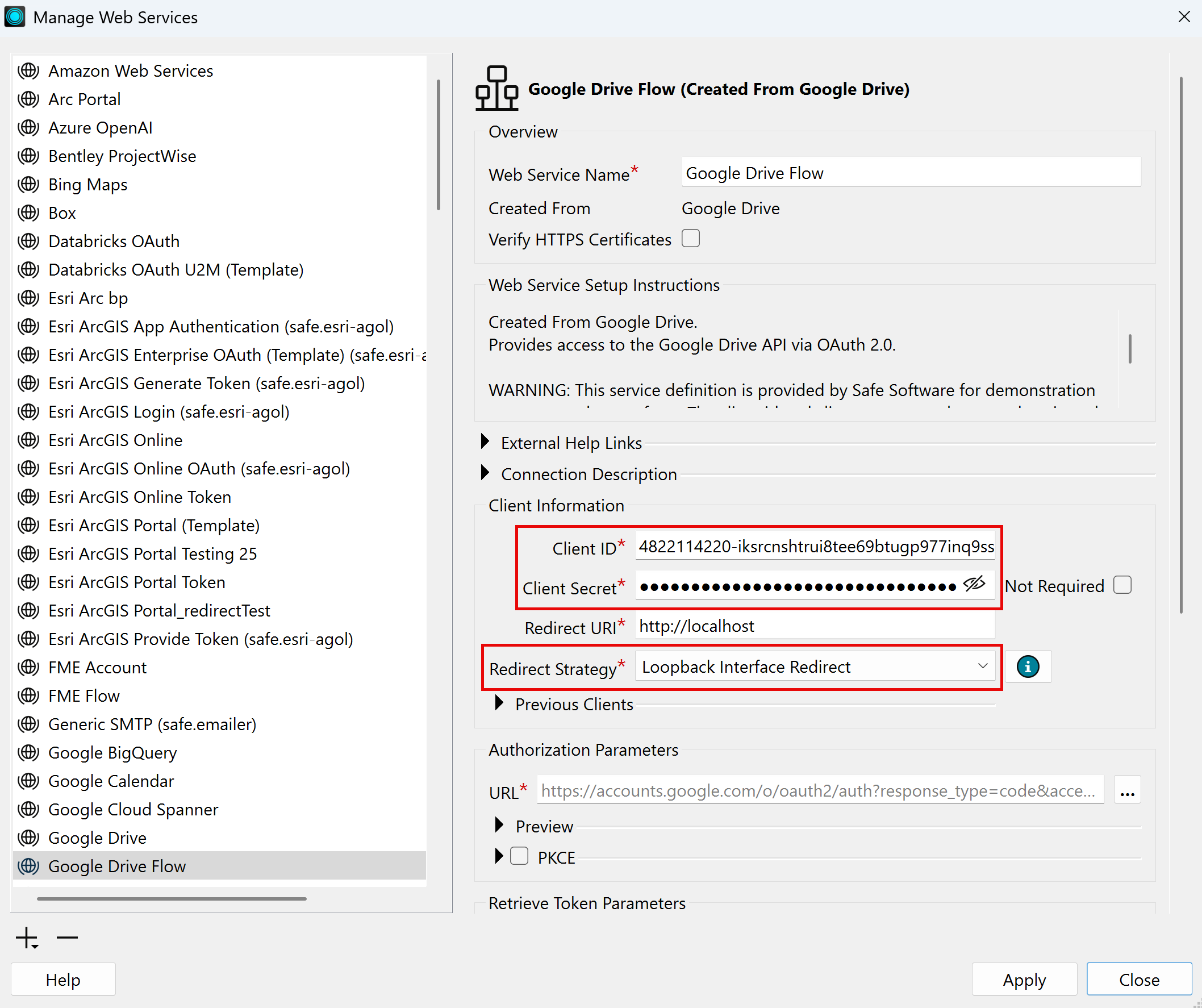

Click on the drop-down arrow button on the bottom left of the Manage Services Window and select Create From > Google Drive. A copy of the web service will be created, which you can edit
Next, we need to edit the copy of the web service we created. You can rename the web service to indicate this one is for Flow, but you must replace the Client ID and Client Secret with the ones you created in part 1.
Additionally, choose a redirect strategy between Loopback Interface Redirect and Proxy Redirect. To read more about the Redirect Strategy, please see: External Browser Authentication in FME Form.
After updating those fields, click Close.

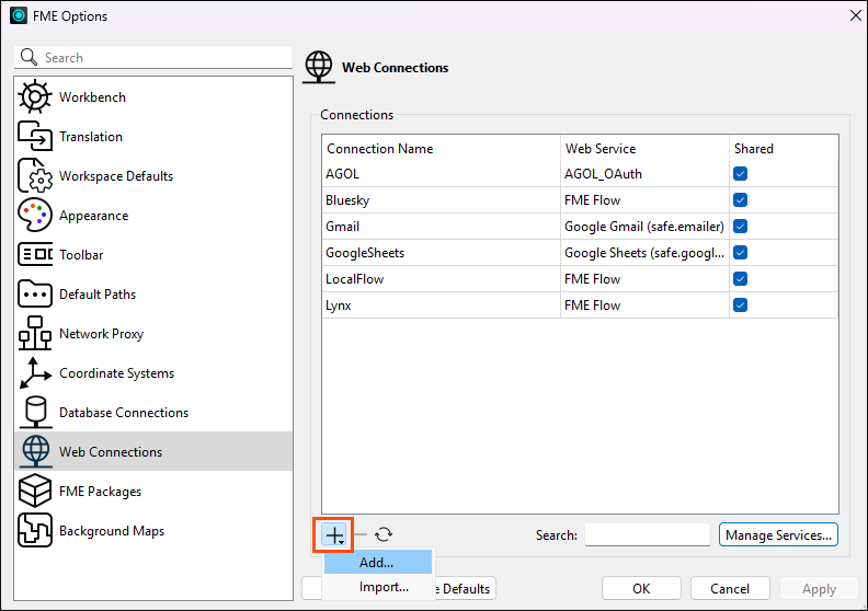

Back in the FME Options Web Connections window, click on the plus sign to add a new web connection.

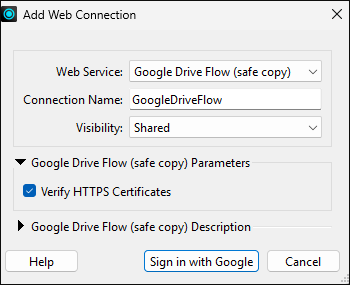

Set the following parameters in the window:
  • Web Service: Google Drive Flow (your copy)
  • Connection Name: GoogleDriveFlow
  • Visibility: Shared
    • This may differ depending on your organization and how connections are stored and shared
Click Sign in with Google, and then authenticate the web connection with your own Google credentials.

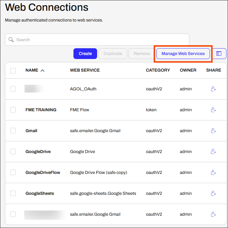

Next, log in to your FME Flow web UI. Select Connections & Parameters > Web Connections from the main page in the left menu.
You should see all your uploaded web connections, including the GoogleDriveFlow connection. If you do not see this connection, please try uploading the connection from FME Form again.
Click on Manage Web Services to set the service details of the web service.

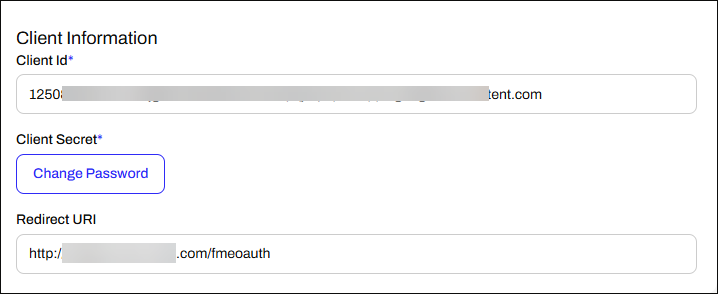

On the Service Details page, scroll down to the Client Information section. Please make sure the Client ID is the same as the one you created in step 1. If the ID is incorrect, you must update the Client Secret.
Set <yourFMEFlow>/fmeoauth as the Redirect URL.

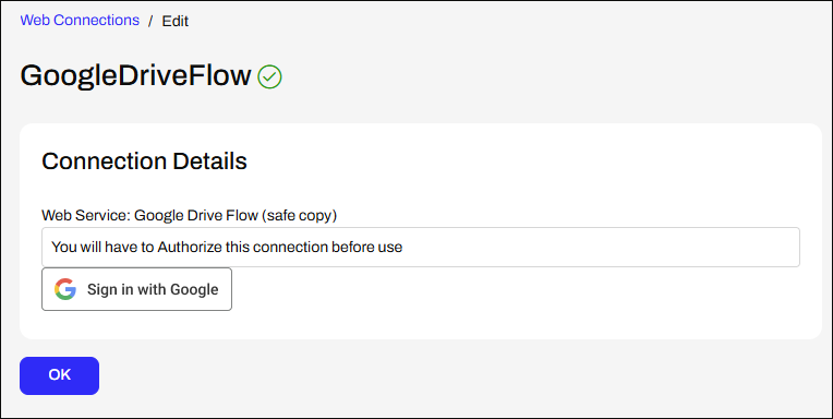

Click on the name of the web service you want to authenticate, in this case, GoogleDriveFlow. If the Validate button is greyed out, repeat the previous step of setting up the service details. If there is a Sign in with Google button, click it to finish authorizing the connection.
After you sign in with Google, you can use your Google Drive connection on FME Flow.
