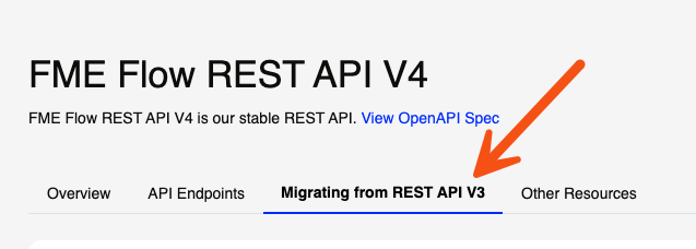

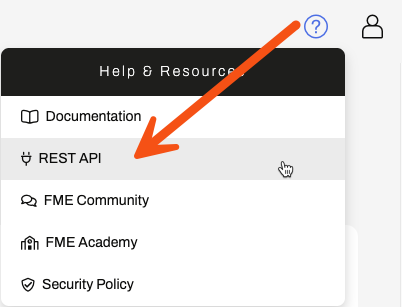

The V4 REST API offers enhanced security and usability, including new and reorganized endpoints, and the removal of some endpoints. For information on migrating from V3 to V4, please log into FME Flow, click the question mark in the top right corner, select REST API, and then click the Migrating from REST API V3 tab.
Alternatively, you can go to http://<yourFMEFlowHost>/fmeapiv4/docs/index.html and replace <yourFMEFlowHost> with the appropriate hostname.
